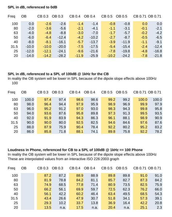

Erratum
Sorry, these above and wrong data would rather fit a closed box with a 12dB/oct slope. OB instead do have a 6dB/oct slope. And I also took a wrong graph for theirs extrapolation. So the (now hopefully!) correct values for this OB system are as follows:
Open Baffle (-6dB/Oct):
20Hz / 105.0dB / 50 Phone (approx values)
25Hz / 106.9dB / 65 Phone
32Hz / 109.1dB / 79 Phone
40Hz / 111.0dB / 89 Phone
50Hz / 112.9dB / 100 Phone
Same principle, but for Closed Box (-12dB/Oct)
25Hz / 108.8dB / 70 Phone
32Hz / 113.1dB / 85 Phone
40Hz / 117.0dB / 100 Phone
Hope, this better fits reality now.

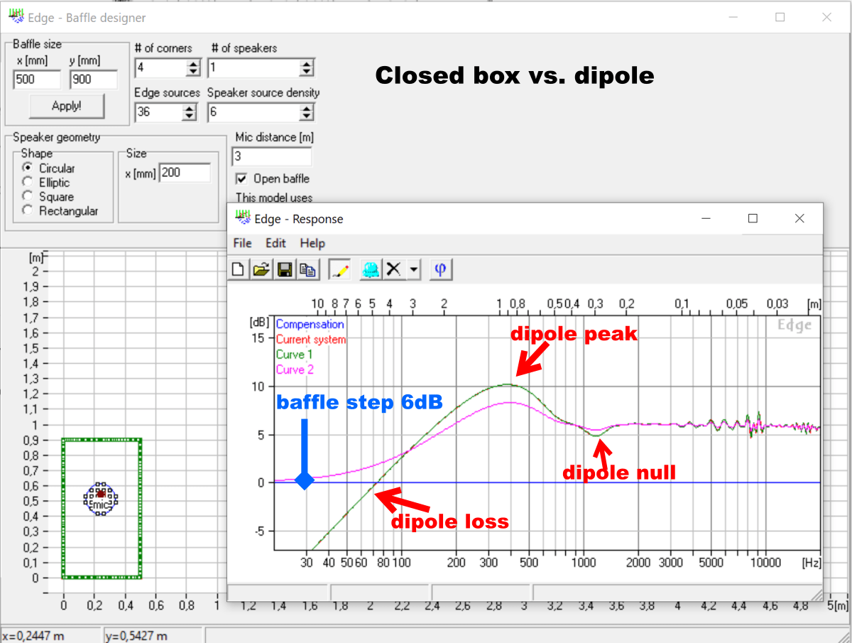

For OB woofers that will be used below 100Hz, you really should include the droop of the driver's free-air response. This happens well above Fs, actually. The OB loading is essentially like the driver is in free air, so the MFG TS parameter values (e.g. Qts) can be taken as the Q value of the response before any EQ is applied. You can estimate the SPL loss from the response droop by putting the driver in any box modeler for a closed box, but set the box volume parameter as high as possible, e.g. 99999 liters or whatever. You will see that these losses are not insignificant.
Here is a quick online calculator web page that you can use for this estimation.
http://www.mh-audio.nl/Calculators/CBCV.html
I put in the values:
Fs=30 Hz
Qes=0.35
Qts=0.4
Vas=180 liters
Vdr=0.2 liters
Vb=999999 liters (just ignore the warning that is should be 0-1000 liters)
This produces a curve that is:
-2.6 dB @ 70 Hz
-4.2 dB @ 50 Hz
-5.7 dB @ 40 Hz
-8.0 dB @ 30 Hz
-12 dB @ 20 Hz
below the passband level. Higher Qts drivers will have less of these losses above Fs. Lower Q drivers (I used 0.4, which is higher than any pro driver) will have even higher losses. Use the calculator and plug in the correct values for your intended driver. Keep in mind, like Juhazi mentioned, that these losses are in addition to the dipole losses (the 6dB downslope from dipole cancellation).

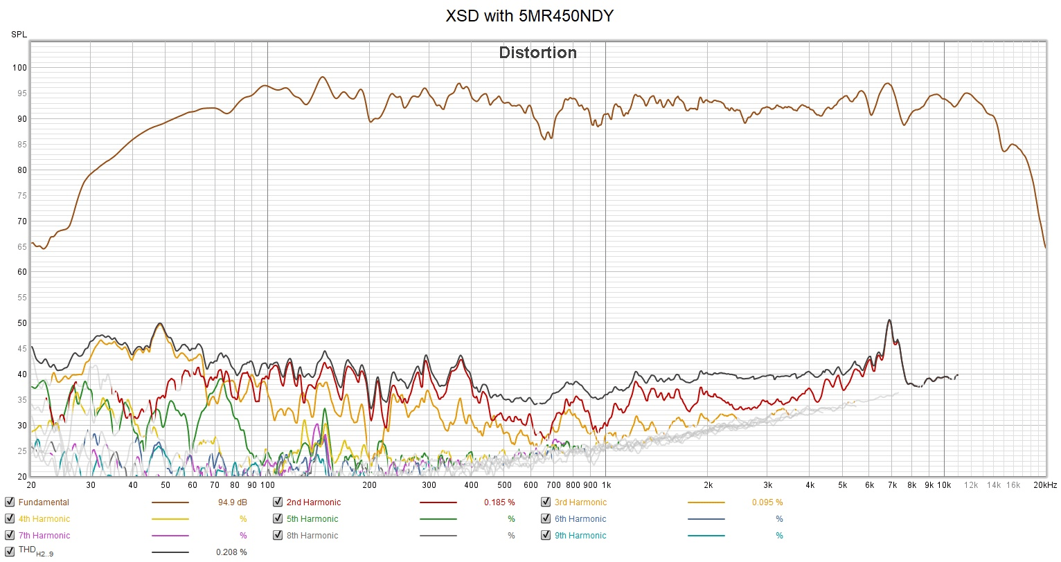

Based on the sheer number of systems shown, this person seems to make a new speaker every couple of weeks. Lots of enthusiasm. Many of his designs include some serious flaws. You can tell just by looking at them, what drivers are used, how large the drivers are, etc. You can't escape physics.
Also, very very light on measurements (essentially none) and I did not see much details in terms of crossover design, etc. Anyone can slap together some drivers in whatever configuration and use some DSP to "make it work" by using their ear (the worst way to design any type of loudspeaker except a simple fullranger). It's a recipe for what you see here, never satisfied and continually trying something new.
Although a couple of the systems with nude drivers on a "stick" above a compound dipole woofer setup have some merit I see little mention of how the crossovers were designed and implemented. Oh, I see now, this quote kind of sums it up:
Guy seemingly has no clue how to do anything properly. It's just random stuff that he tries based on whatever...In case any of you are wondering, I am not into crossover design and had always driven the woofers actively Behringer Ultracurve.
This should serve more as an example of how NOT to design and build speakers!
Great thread. Thanks for the link. I have seen his work before as he used the PRV 5MR450 for a while - a driver I really like. I think from his bizziliion experiments which arrived at a COTS mini monitor from Focal on top of isobaric woofers in bafflesss config, says something about a good 2 way to convey soundstage and image and leave the bass duties to a large OB woofer.
Thank you Juhazi and CharlieLaub for your objections. You are right.
I have some corrected and extended data, computed as CharlieLaub suggested, same driver data, same online program. The results also show the consequences of StigErik's comments about the H-Baffle and the discussion about Qts 0.3 vs. 0.4.
