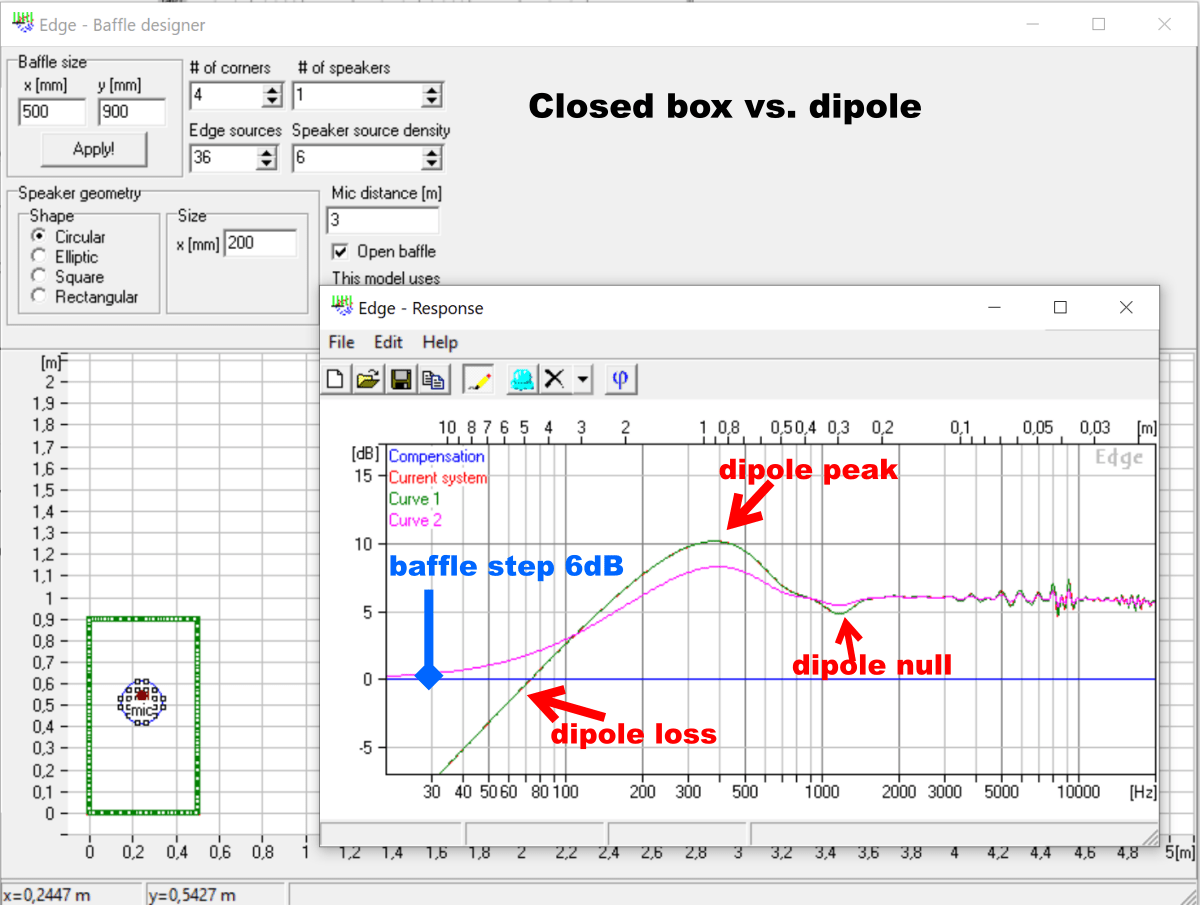

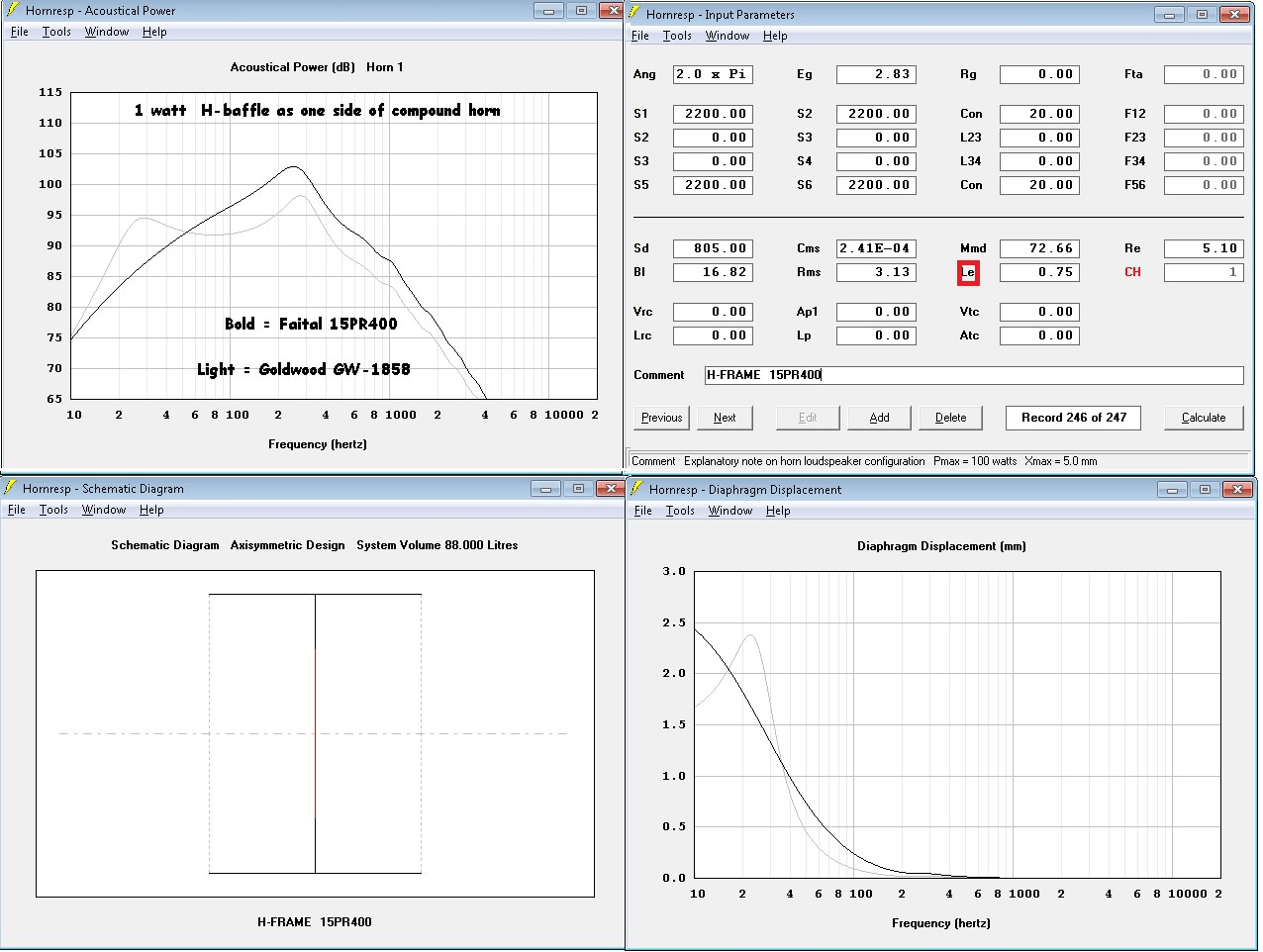

It's worth mentioning that the required cone excursion in OB increases 8 times for each octave you go below the dipole peak. Two octaves means 8 x 8 = 64 times. However - the bigger the baffle, the more low bass you can achieve.
I managed no more than 105 dB @ 20 Hz with less than 10% THD on my giant H-baffle towers, that had sixteen 21" woofers.... so ... unless you are willing to go completely mad, just forget it.

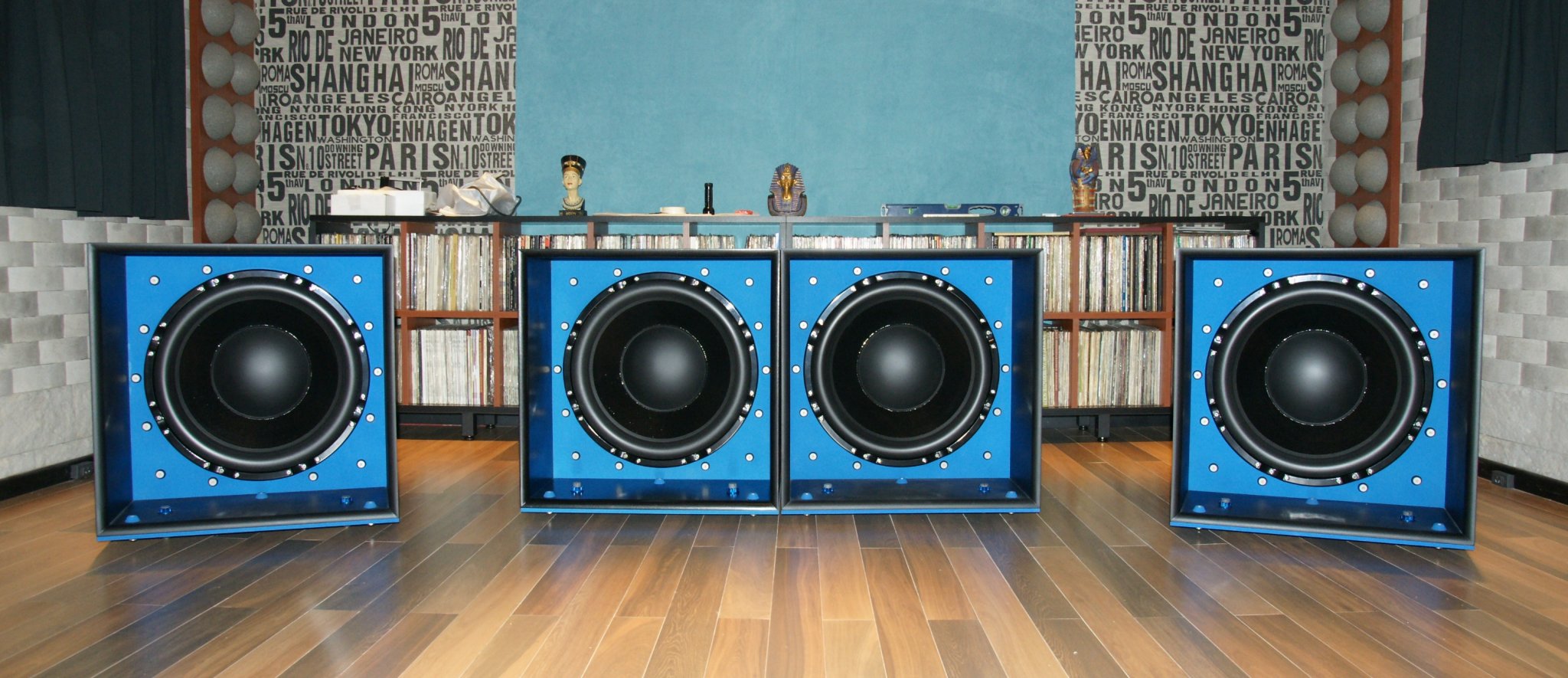

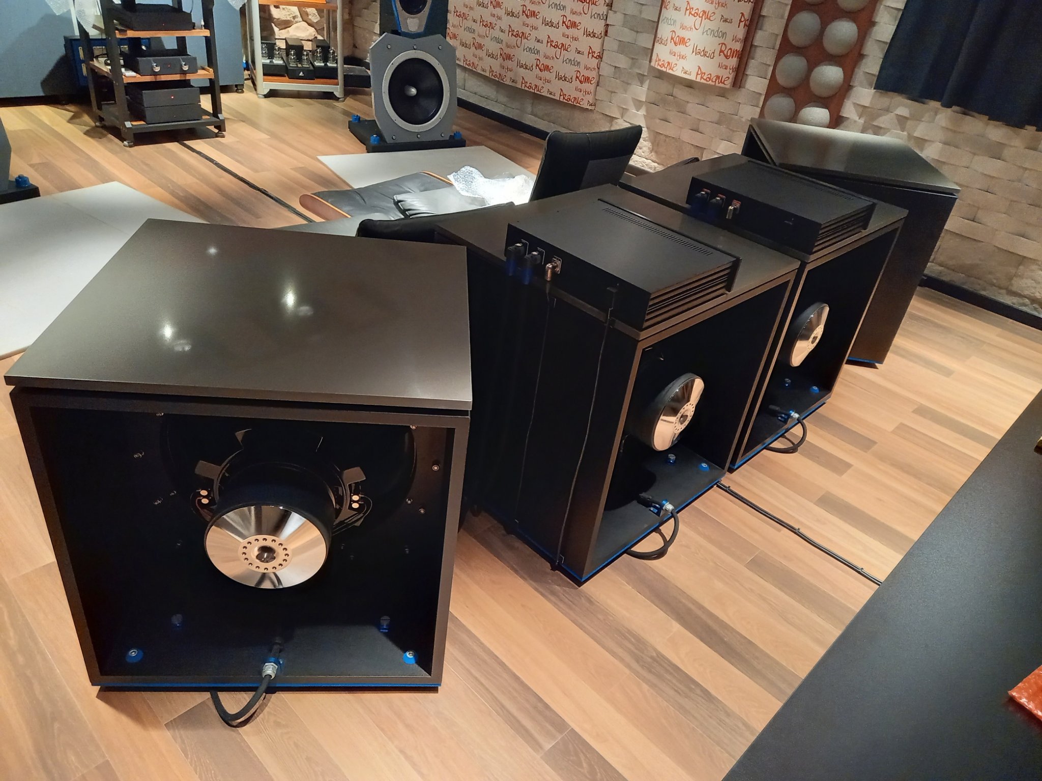

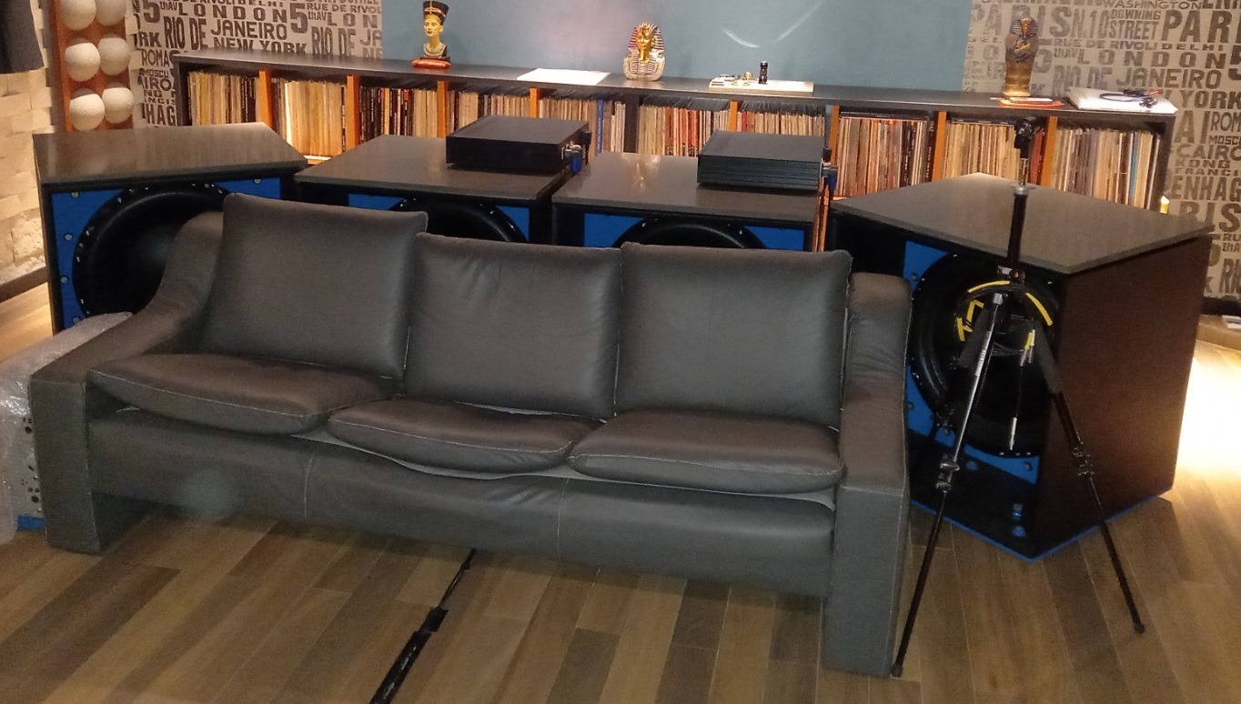

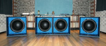

Agree Scott. Thanks to posts like yours I decided to go for H-Frames in the very near field.
As far as I read it is not necessary to stay as close as 1.5 feet, if you seat within one driver diameter is enough. I once read from Kreskovsky (and from Mr. Laub too) in subs arrangement like this, you are basically listening mostly to the monopole radiation and I would add, without the resonances they have.
This are Stereo Integrity SH24 24" drivers, Qts 0.4, not the ideal 0.5 but close. The rest of the Klippel verified parameters are fine for the application, they are also super silent.
The subs are crossed @ 70Hz (LR4) to a AE Dipole-18 and to match sensitivity all the subs had to be attenuated 20dB (which was great for vinyl). The subs are delayed 5.3mS to the main speakers.
Still having one amp per channel (one amp per each pair of subs), I plan to feed each sub with a single amplifier, this will give additional flexibility in the delay and EQ. However I am not sure this to be necessary. Amps are Hypex UcD 2K. All XO/EQ is done with one Xilica XD4080 per channel.

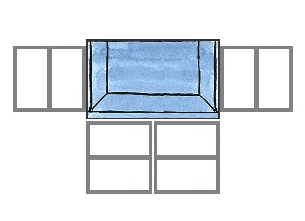

Of course, both subs in the outer position are not within the near field. I am still tempted to use a smaller sofa and install the external subs as shown in the sketch, but this would be rather extreme, all considered, the bass is gorgeous.
My experience and measurements tell me it's close enough if you are within a meter.
I'm not at all surprised, you ticked all the boxes. Your neighbours would like the system too. Bass in their place will be >20dB lower with your system compared to a conventional sub setup.
Well done! (y)
One of the nicest systems I've seen on Diyaudio! (y)Congrats! :cheers:
