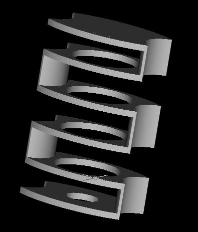

Here is one dipolewoofer concept I scetched some time ago. It's drawn to four 12" Peerless SLS woofers that should give plenty of output down to 30Hz or so. Structures outer walls are missing so the inner configuration is visible. Woofers are stacked on their back where lowest woofers magnet is sunked into to bottomplate. Naturally such system could use separated bottomplate with proper spikes and stuff. This is just the operational part.
Box is shrunk as small as possible to obtain good looks and high WAF. Operational part is 725mm (28,5") tall, 470mm (18,5") deep (resulting 470mm/18,5" "D") and 340mm (13,4") wide at the widest. So it's pretty much as narrow as possible. Drivers are connected in Linkwitz recommended push-pull configuration with force cancellation advantages. And with this configuration the only direction drivers even can move the cabinet is up and down.
But the openings are pretty small. Just 200mm x 125mm (8" x 5") slots. There are two 540cm2 cones pushing air from each vent creating under 1:4 ratio to opening size vs conearea. This causes some pressure in the cabinet. I don't know how relavant that issue is. At least the openings are very open compared to some vented cabinet vents so there shouldn't be any air turbulance noise with that ratio.
Downside is the configuration itself. It's very compact so it has to be build with the drivers already installed. No space to replace them without tearing whole thing apart. And the drivers are on their backs causing hang effect to the cones (which increases 2nd harmonic distorsion).
At least the physical appearance is pretty different to normal box like W-baffles. Would it suit together with my mains, I don't know. At least they would be in sizescale that I could consider placing between mains and sidewalls without closing all the gap between them. But then again they are about 80-90 litre cabinets from the outside. Plenty of output thought so I don't know could similar size monopole sources do that much better and these should allow a bit higher cross with gentler slope than the monopoles. But there is no space to manouver with them. Success or bust basically. And those SLS woofers don't suit that well to any other solution (than dipole).
What do you think?
Jussi

I really like the look of the ellipsoid style! Using the theoretical SPL worksheet that SL has on his website, I came up with a possible extension of 20 Hz. This is of course with the woofers at their spec'd max excursion of 8mm. For comparison, SL eq's his sealed 12" XLS down to 25 Hz, I think. 20 Hz is pretty good considering. I highly doubt that you would ever want anything more.
If so, I would definately go to sealed box. I hate even turning on my subwoofer, it is so incredibly boomy as it is a vented box. I plan on making a new sealed box and installing a biquad before the plate amplifier soon.
In any case, the design is awesome looking. I'd love to make it just to see it!

I like the styling of the 4 SLS dipole. With small exit area, Fs may be lowered, but that might not be a bad thing. Don't remember who, but someone found a way to model ripoles and this seems like a close relative.
Cavities always seem to present problems with higher xo, so why do you say this dipole would allow higher xo than monopole? Still, monopole should excel below 30Hz. Another way to help reduce vibration would be single downfiring woofers in heavy cabinets.

Paul W said:Cavities always seem to present problems with higher xo, so why do you say this dipole would allow higher xo than monopole? Still, monopole should excel below 30Hz. Another way to help reduce vibration would be single downfiring woofers in heavy cabinets.
Measured in octaves they are at least in the same line. Same radiation pattern should allow dipole a bit higher and gentler crossover than monopole. For example 100Hz 2nd order like the one in Beethoven. However Stereophiles measurements on Beethovens woofercolumns weren't that great. Those cavityresonances run pretty close to usable range and the crossover (even with notchfilter) can't kill them to very low levels.

Stereophile's dipole measurements are pretty worthless. They don't have an anechoic chamber so they close-mic everything below 300 Hz or so and splice it into the graph. Obviously that's no good for a dipole. As well, they did some of their measurements of the Beethoven without the active crossover which also applies some EQ.However Stereophiles measurements on Beethovens woofercolumns weren't that great.
catapult said:Stereophile's dipole measurements are pretty worthless. They don't have an anechoic chamber so they close-mic everything below 300 Hz or so and splice it into the graph. Obviously that's no good for a dipole. As well, they did some of their measurements of the Beethoven without the active crossover which also applies some EQ.
With some aspects I agree. But the cavity resonances that I was referring to are very visible there and it doesn't need a anechoic chamber to measure them. How audible are they is another mather. At least they aren't that much down as most resonances require. But the frequencyrange is also different. I guess resonance artifacts from say cone breakup at upper midrange sound a lot worse than these. But still those resonances don't make things better. Naturally radiation patterns need far field measurements from different angles.
