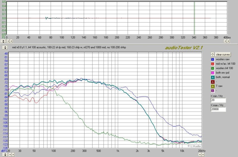

Hi Jussi,
first, you've done a lot of thinking on this and in many ways I recognize my own meanderings in my 6 yr+ dipole journey... So I'll try to give a few comments about my experiences.
Some history: I started with a fullrange dipole in '99 or so, augmented by 2x 10" woofers on a slim and shallow W-F-W U-shaped panel. It all started with SL's website, but at the time he only had the Phoenix and I had other ideas about form factor and wanted to keep the mids-highs full range, etc. So I designed my own. Later I added a tweeter. Then I rebuilt the panel into a 24" wide 48" high 7.5" deep WWMT U-frame with a SS8543 6.5" mid and Seas 27TBFCG tweeter, and push-pull 10" Vifa woofers on the bottom. This is what it is now, though I keep on fiddling with the x-o points (100 and 1700 Hz as of now) which is easy with my MOX variable X-O, and generally yields only minor audible differences.
Surprisingly, while the system did improve over the various iterations in construction and optimization, even the drastic changes in driver choice over time did not alter the general characteristics or balance. It keeps on getting more precise and more polished, but it was pleasurable even at a time when I did not fully understand or correct some issues. There is still isues - more output capability on the low end, more modern woofers for instance - so there is still room for more optimization. One possible conclusion is that suboptimal dipoles will sound good enough to lure many DIYers into never tying to really reach their full potential, in the way SL's Orion is optimized to the last little detail. Conclusion 2 IMO is that *all* of SL's x-o and filtering techniques are required for serious consideration, because the address real issues that other, different dipole systems, will also have. Ignore at your peril, SL does know his stuff.
Now for the details, in random order
- rear tweeter: I tried that briefly. Intriguing at first (more depth), deemed unnecessary and distracting after a week or so of listening. But did not try to optimize it.
- waveguide: likely the power response deviation has more drawbacks than the gain in radiation pattern matching. It just doesn't seem to be much of an issue if M and T differ in 2 or 3 dB at 45 or 60 degrees. The global power response accuracy however is a beautiful thing. My dipoles always astonished me in this respect. Off axis and in a different room, that's when they sound at their most puzzlingly realistic. I can't explain why, I find this highly ironic. Ha. So, my conclusion is that power response actually matters more than on axis smoothness.
- never noticed a major difference between WFW and WWMT in their vertical patterns in-room. Vertically accurate dispersion does not seem to matter all that much to me.
- however, floor bounce does show up strongly in measurements.
- however again, this is not something the ear seems to notice as a spectral imbalance - notching it out does make sound things thinner, but not more accurate. The typical delay of say, 6-10 ms of the floor bounce, is enough for the ear to recognize it as a reflection, I wouldn't bother making major design decisions dependent on the floor bounce issue.
- the opposite is true for the 200-100 floor gain: don't forget SL's 200-100 shelving HP. Without it, the bass *does* sound bloated, even though it *measures* quite flat (!) (at least, when *I* measure it). This, I can't explain it.
- On the low end I just can't hear much difference between setting the rolloff at 20-sh , vs say, at 40-ish Hz. There does not seem to be enough content below say, 35-40 Hz, to bother and optimize everything around optimal output in the bottom octave
- however, low distortion and high ouput capability seems to matter a lot in the 80-200 range
- for instance I just measured my woofer's distortion and realized these "lowly" older Vifas are cleaner up until 140 Hz, than the expensive SS8543's (which are really great from 200 up though). Unless I made some mistake. The larger drivers are just less stressed in this range, and this translates into less HD.
- in other words, it seems a good idea to run the large drivers as high as possible, even though they will be less accurate than the smaller drivers in terms of energy storage.
- when I measured my woofers I found *more* 2nd and *less* 3rd HD in push pull, compared to a single woofer at the same SPL. I can't explain it. Push pull may not always give the expected results.
- one thing you should address with accuracy is the dipole peak before rolloff. IME it exists and does matter for detail, though it seems benign on measurements, and in the 200-400 range where it occurs for typical baffles it is hard to measure because floor bounce also falls in this region. Once you manage to pinpoint it and notch it out, things do improve quite a bit in clarity.
- metal baffles: not sure if the rigidity advantage offsets possible problems with ringing, not to mention difficulty in construction and therefore difficulty to remedy mistakes.
Ahem, running out of energy now. It's late here. I'll write more if more comes to my mind ...

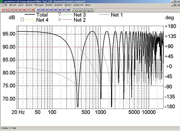

MBK said:The typical delay of say, 6-10 ms of the floor bounce, is enough for the ear to recognize it as a reflection, I wouldn't bother making major design decisions dependent on the floor bounce issue.
May I ask how you got this 6-10ms?
Even the 6ms delay means 2m extra distance. With 2m listening height (me on a small stool) and 5m listening distance I get about 38 degree bounce angle with 1,5m extra distance which leads to under 5ms delay. At least my listening position isn't even close like that. With 2m listening height there is also a bigger problem from the ceiling unless the room is over 4m high.
With 1,5m distance from speaker to front wall I can have 3m extra distance and therefore 9ms delay for dipoles rear radiation. This should be heard as reflection, not direct sound.
I'd consider 1st reflections from sidewalls, ceiling and mostly the floor most harmful to speakers operation in room. And I think pretty large amount of acoustics and studio experts agree with me on this. And handling those problems isn't easy. Acoustic treatment is one. Diffusing propably better than damping (which kills the sound). But in many domestic environments heavy and broadband diffusing isn't possible so at least I'll have to settle for directivity.
Here is a simple example of this. Two point sources at same location. Network 1 demonstrating direct sound, network 2 floor reflection. Later one has 500mm extra "Z" dimension on it so it comes that calculated ~1,5ms later on scene. With zero vertical directivity response (ideally) looks like this.
Jussi

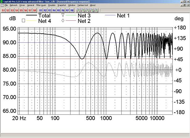

And here a simple example of -6dB vertical directivity. Or basically this same example works in horizontal plane as well. As you see there is pretty significant improvement in overall response. For really good result directivity should be something like -20dB which a good electrostatic, long linesource or a long ribbon can create.
Naturally these are just fast made examples. Vertical directivity isn't that even, different surfaces and their reflections even up the result and so on. But even if the response looks good it doesn't proof good results. Covering one reflections mess up with other reflection doesn't make overall result any better. It's like you're using brush and a set of paint to clean up window. After all the hard work you might have a landscape on your window thats similar to actual view (depending how good painter you are) but it's still far from chrystal clear window you can look through.
And I think this applies to many different things in audio. For example you have overbright speakers. Ok. You can neither invest neutral speakers or you can buy an amplifier that has shy treble. Both fix the audible problem but only one of them truely bites the problem, other one just covers it. I think this is partially the way people build their systems in audio / high end world. I think it's not the right way thought.
There are many examples of this behavior in commercial and why not in some DIY systems as well. For example speakerspikes. Why do you use them? To isolate the speakers from the floor. Why? Ok, speaker is shaking and it can't deliver it's vibrations to floorboards. Ok. Spikes fix in nicely. Problem solved. Or is it? I'd consider using properly build box without any resonances what so ever much better solution and it really gets into the problem and fixes it. Unless you want to dance with your speakers which naturally requires serious shakes.
Other example could be room problems overall. Mostly in bassrange. Most people overlooked parametric EQs until Velodyne made one with "interface for dummies". After that it's been praised as the most important thing in subwoofers for decades. And what I've heard Velodynes EQ/crossover isn't even that high tech. Has some electronical problems. Ok. Solves some problems. Or does it? There still are room resonances, room modes and the Eq is there only to ease the headache. Electronical gadgets don't reach acoustic problems. Why not do it better? Make a system that just doesn't wake up room modes. This means directivity. Where do you need the eq anymore? And the result is far more uniform and usable around the room that one spot optimized parametric eq can ever be.
Strange business. But it seems to be quite enough for most people. Sadly this leads commercial companys to slack. They don't even have to invent anything new, make any real R&D. Just make more of the good old gadgets, put some new exotic materials on them, create catchy marketing phrases for them and sell away.
Jussi

The 100-200 filter does not quite take away 6 dB, it is closer to 4 dB. What i noticed was that when I set my system flat from say 200 down to 50 Hz, measuring at floor level to catch maximum floor effects, it will *still* sound bass bloated! So I just put the filter back in without thinking any further, because it made it sound "right" regardless of my measurements.
BTW lucky if you have anechoic of otherwise siphisticated measurement capabilities. I produce a lot of artefacts in my measurements, my outdoors is too noisy, my indoors forces me to either go too close to the speaker to represent true baffle effects, or so far that room effects mask most of the direct sound. I have become very cautious in interpreting my own measurements. But anyway, I add a few curves, measured indoors at conditions that Ii believe add few artefacts. Most curves octave averaged, which seems a lot, but gives me the correct shape of the responce w/o distracting wiggles due to reflections and diffraction. Just for illustration. First the mids off axis.

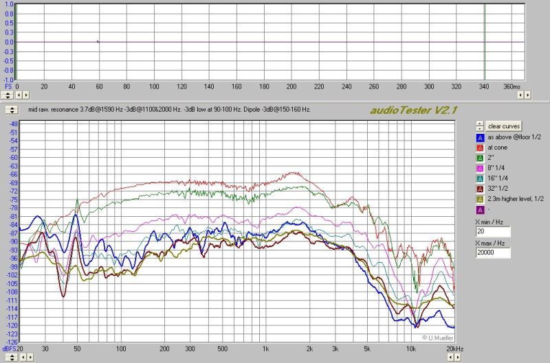

And now a demo how a beautiful nearfield measurement becomes a complete mess at just 0.5 to 1 m distance. BTW ignore anything below 100 Hz. This is room hum - my room is large, the lowest mode is at 24 Hz, and therefore bass response *should* go low even with a dipole.

MBK said:First off, sorry for getting you into all these floor bounce calculations. The 6-10 ms was a mistake of the late hour. I dimly remembered I got >1.5 ms (which is enough to get out of the "blending" range of the ear) and must have made a mistake on the calculator when I tried to verify it. Anyway for myself I have concluded I won't touch the floor bounce, though your remark on using vertical directivity to limit it got me thinking.
I found some room acoustic lecture material that suggests all below 35ms arrived sounds are blended into a direct sound in human ear. This sounds a bit much on most environments. But then again I've heard plenty of recommendations for dipolepanel to be at least 2m from frontwall and even prefering >4m distances. 4m would give rear radiation 24ms delay before reaching listeners ears. Below 2m distances are caused effects where rear radiation is "glued" on to the direct sound and mess it up.
There are plenty of practical examples of this. Imagine yourself listening a live chorus. Your listening position isn't perfect and so you aren't in focus with all singers. With large chorus even few meters distance difference are very possible. You can't pinpoint individual singers or groups of singers just by the fact that some of them are a bit futher away from you than others. Unless one of them is singing a solo... But you also get blurred singing. Even large chorus recordings suffer from this. Chorus sounds united and whole but words aren't distinct. Ear can't separate singers but their different timing smeares the sound and change the tone.
I also found another lecture material that says human can spot sounds more precisely with direct sound and reflections below 1ms delay. With room + speaker this means diffractions from cabinet edges which is the first problem. After that ear summs first reflections and direct sound up to 40ms delay and only after that ear can really determine which sound is reflected and which is direct sound. In most rooms reverberation time lasts up to 500ms or so. Within that 1-40ms time sensed main direction for sound is still there but the tone changes. Ear mixes them all up, different phases, different frequences from different angles, different reflective materials reflect different frequences and all this is multiplied if speakers radiation pattern against first reflections isn't even. In most cases dipole speakers rear radiation is also included in <40ms delaytime unless the room is huge. This is why I'd use some heavy diffusing for the rear radiation. Just to make the room "bigger". Unfortunately this isn't possible. Broadband diffusor that would really do some good is basically size of a bookshelf and I can't have one on my front wall. But I have it at the rear wall which is the other problem.
Actually listener position is also crusial in this aspect. Listening seat near the rear wall and first reflections from there arrive your ear with very short delay. In my case I can use Linkwitz recommended dipole positioning advice and have equal space from listening spot to rear wall and from speakers to front wall. Still both direct sound bounced off the rear wall and rear radiation bounced from front wall come to my ears with aprox 9ms delay. Hope that's enough. At least it's helluva lot more than reflections from sidewalls or the floor. Therefore I need the directivity to minimize the problem there...
Against floor bounce dipole directivity just isn't enough. Even without any baffle (vertically floorstanding panel is pretty "wide" and therefore not that much of a dipole) dipoles natural -3dB at 45 degrees isn't nearly enough. And with normal listening distances and heights 1st reflection arrives below 40 degree angle. Even my +-45 degree simulations are too optimistic.
Yep. But it still doesn't explain why this didn't show up in anechoic measurements with adequate measuring distance.
Good looking measurements. Not that much directivity thought. Have you tried to measure them from 180 degree angle to see how well behaved cardioid they are?
Jussi

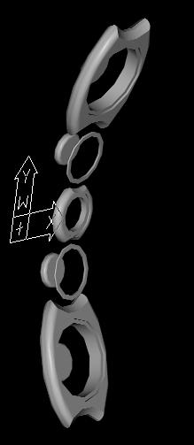

Funny that you mentioned no baffles at all. Here's a test I ran 2 weeks ago. Quite a few laughed at the idea, but with active XO & EQ it worked surprisingly well. 15" drivers is all it takes. I used a coax on top and woofer on the bottom. The real flaw was that early reflection off of the support structure. I'm just about finished with a magnet mount support structure and will try some ideas wrt diffraction rings to see if I can make an 8" driver work with no baffle.
Here's what is in process. The 2 supports at the bottom are for the 15" woofer whose structure is isolated.
Jussi,
I think your attached image is absolutely great! Being a fan of focused line array implementations, your concept looks like a killer set-up. With the correct time alignment and decent drivers, it should probably have stunning clarity and definition. The use of an open baffle also lends itself to an open, natural and live presentation.
Can you build a mockup with a wood frame and threaded rods and bolts to get the acoustic setback/ time alignments? I would think that once you have your array "dialed in" you could take measurements and contruct a permanent and attractive structure.
JohninCR,
Your pictures are an inspiration! My eyes aren't what they were 30 years ago, so tell me: Is the mounting block surrounding the magnet a through bolted split block? It seems that you've hit on a very simple, yet articulate system for adjusting your drivers' position. Well done!
It may be that I'll have to try something like you've done, if for no other reason than it looks like a fun project.
Let's see now, where did I put that box of spare drivers?
Both of you have given me something new to think about. Thanks!
JohninCR,
Best Regards,
TerryO
TerryO said:JohninCR,
Thanks Terry.
I wanted the mount to be adjustable for different drivers and/or baffles. For different drivers I just need new half circles. Cut a rectangle out of the diameter equal to the size of the magnet, drill the hole, and then (yes) cut the half circle in half to form the correct sized clamp. I cut the bases for the main driver and woofer from the same piece of wood for a good fit and matching grain, so they should look really nice once I rub some oil into them.
