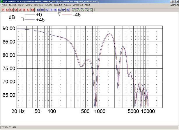

Actually a bit different woofersetup could fix that uneven behavior that WWMTM causes. Uneven since WWMTMWW would the symmetric option.
My primary idea for actual woofercolums is Beethoven style compact W-baffle structure. Four 12" Peerless SLS on each side. Has plenty of SPL capacity above 30Hz. According to my analysis there isn't that much material below 30Hz and therefore I won't overkill the bass to play <30Hz. Dipole bass efficiency runs out fast and reference level performance below 30Hz would require huge configurations. Mainly music materials bass is between 40Hz and 120Hz. And most music intensity (85-90% or so) is 40-3500Hz range. Some 30Hz action appears but levels are already lower than at and above 40Hz.
Sure they are some killer albums with very low frequency humming and in some cases with tremendous dynamics (1812 Overture for example) but I wont be optimising my system to those rare recordings. Perhaps I would if budget, room size and other aspects weren't limiting things. Compromisses compromisses...
But to that point. Adding just two 12" woofers more up to six 12" on each side and stack them into a about 2m tall column using just single 12" driver on each vertical level. Beethoven/Phoenix column uses two so six level stack would require twelve woofers. I don't need that much. Six give a bit more kick and just one driver on each level leaves the whole thing nice and narrow compared to Beethoven style four 12" shorter model. Tall sure. But I can place them along the sidewalls anyway. Just bolt them in. Maybe even use same wallpapers to hide them... 😉
So the advantage. Such tall column behaves pretty close like a linesource while overall room height is 2,6m. Vertical directivity increases, most harmful room reflections cancel even more and according to LspCAD simulation vertical window in +-45 degree angle is pretty close to symmetrical. I used 2nd order 80Hz cross there. Low mids relieve it to uppermids at 300Hz. Simulation doesn't include tweeter section which smoother some of that 1000-2000Hz bump in vertical dispersion.
I have heard some ideas that speakers radiating surface should increase when frequency goes down. So bass instruments need a bigger reproductive device than higher frequences. And according to some theorys this causes problems if it doesn't work like that. For example using WWMTMWW highly directive and physically large setup for midrange and treble and drop it to some small (compared to the mains) subwoofer for the bass. I think problem isn't that significant if the cross is low enough. So in subwoofer-main speaker situation it shouldn't do that much harm.
All theory thought. I have heard one system that suffered some problems with bass impact and authority while bass was physically much smaller than directive and larger mid-treble section. Did this theory cause the problem, difficult to say.
Any comments or other aspects on this issue?
And from this woofertower simulation I know linesources have very good dynamics and they can deliver more precise cylinder shape wall of sound towards the listener that normal point source just can't do. So in this aspect such column would be an improvement over the small one. Still they need to be crossed low. W-baffle configuration so 1/4 wavelenght resonance is kicking in and its still a separated system from the mains. But I'll have to negotiate with my family how such colums would suit for the rest of the decoration.
