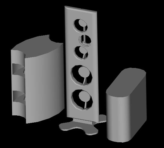

Here is a 3D model from both main panels "production" scetch and mensioned crankshaft woofer system side by side. Crank is turned 30 degrees outside as it would be along the sidewall while main is toed towards the listener.
It's pretty much as compact as it can be and holds four 12" SLS woofers with plenty of output for my needs. But it also looks pretty bulky and big. Unfortunately. And it doesnt help things that they have to be placed pretty much like this.
There is also a Minos style monopole. Just for comparison. Big enough to hold for example RCF LF15G401 in closed environment.

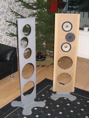

Some progress. I got the main panel frame and floorplate cleaned, welded and painted today. Looks good so far. I didn't measure them but they sure weight pretty darn much. And adding the floorplate decreased ringing. I guess that narrow spine should improve things even more. Setup is also stable at the floor. With the drivers, woodpanels and all it should be very stable. Mission accomplished so far. Unfortunately no new pics.

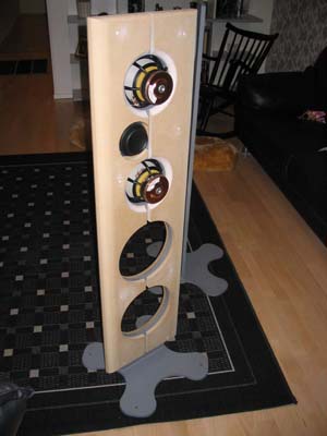

Packadges arrived. Seems like I'll have a very busy chrismas holiday. 🙂
Woodpanels fit like a glove. Simply perfect. All curves are like they should be and the whole thing weights like hell. 😀
Merry Chrismas to me. And to you as well. 😉
Jussi

Wow, lucky guy
Those look great! I don't anticipate much by way of baffle resonance there, the only weak point I'd see would be the coupling from the foot to the panel, but being thick steel, should be pretty strong 🙂
Re: Wow, lucky guy
Construction actually lacks that spine I added to my scetches some time ago. I can add them later if the overall configuration and mainly midrange polar behavior satisfies me. That should make the whole thing much more rigid.
Jussi

Looks like tweeter complications force my Esotars to retire from this project. Shame. I assume the dome profile is incompatible with the waveguide causing stored energy and twinkled response problems.
