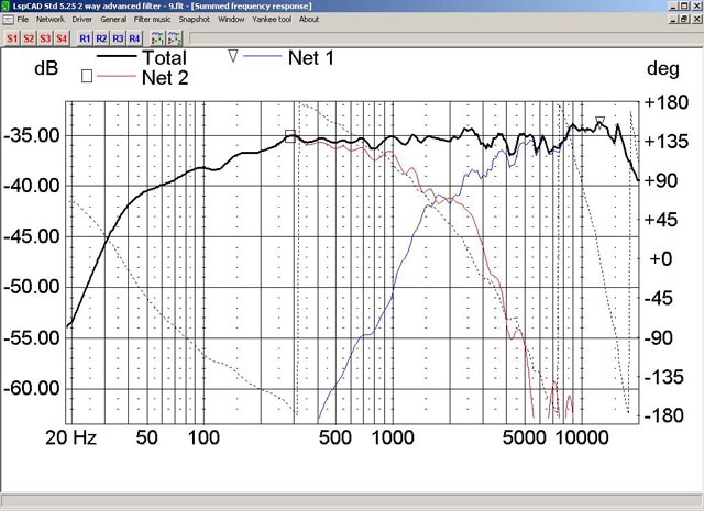

Jussi,
Here is the devil's opinion...
Even assuming a trap, a 2nd order LP at 2k will attenuate the W18 breakup at 5k less than 20db. That will not sound as good as you are trying to achieve no matter what the power response. I believe your original WG approach, maybe with a different tweeter or WG, is superior to using the W18's to control directivity in the lower treble.

Devils indeed. 😉
I know the problem. Personally I'd use 4th order cross 1600-1800Hz with waveguide without any gadgets or tricks for the radiation pattern. No-WG option also messes up my speakercloth idea. Dome is higher than flange surface so speakercloth along the panel causes the cloth to touch the dome. And I haven't found a operational solution for it.
You know anyone in EU area that needs a pair of Esotars? Personally I can't afford to have a closet full of top notch drivers. Accuton C2-12 looks very promissing for the WG option. Stiff diaphgram so it can handle the stress, good responses, small suspension, right shape flange and most importantly inverted dome structure which is pretty much ideal compared to high profile soft dome.
Shame there isn't that much objective data of those drivers. Efficiency isn't as high as Esotar but the waveguide sure helps so at least up to 5Khz it would have the same or more on axis output than no-WG Esotar. And like mensioned before, most music materials intensity is below 3500Hz so it should be fine.

2Khz 2nd order filter has exactly -20dB attenuation at the prime resonance of the W18. I've read about systems with even higher cross with same order. If I don't remember wrong Ellis 1801 is 2500Hz 2nd order...? But that's not really the point. Is -20dB enough, how can I verify it? Distorsion measurements? Extensive listening? Here are the on axis response in that earlier simulation. W18 distribution to overall sound continues up to 5-6Khz, some additional damping might be in order against those 7Khz and 8,5Khz peaks. Phasing matches nicely.
Perhaps the cross could be lower. But with 2nd order it starts to push the Esotars to their limits. Dynaudios present C1 model uses Esotar2 with 1,8Khz 1st order filter but the unit is new and the system 2-way monitor which is propably not even meant for high power system.

This looks very good ... In general though I'd say this: while measurements are certainly a good way to check for aberrations and confirm major design goals, the number of parameters that influence the result is just too great in audio to rely just on measurements, not to mention simulations which don't seem to really work even in circuit design. Perfection in one parameter may be offset by the resulting compromise in another area, possibly one not measured (distortion performance? "average recording" characteristics? etc).
I'd say, select a few possible implementations, confirm acceptable performance by measurements, and then live with it for a while, play program material and all that, then change it and see / hear whichever sounds best to you. I have been surprised at times when I made major changes that should affect my system's characteristics a lot (say, change the mid from a vintage paper fullrange desing to a modern high x-max poly cone), and found surprisingly little difference in the end result once implemented properly. There is the famous "art" part in engineering which depends on developing a feel for stuff ...

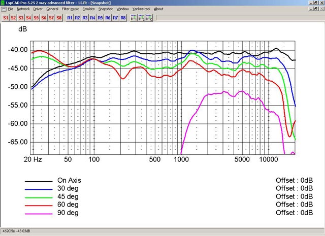

This off-axis result looks much more consistent, what did you do to WG? What happened to 9k dip?
The little off-axis rise around 1.2k is interesting. I suppose it is tweeter flare at low-end of range. 1.2k is somewhat insensitive band for ear so it may not be as objectionable as higher frequency flare.
Things are looking up! 😎

Paul W said:This off-axis result looks much more consistent, what did you do to WG? What happened to 9k dip?
This is modified waveguide. Throat was machined in new shape. Now it fits almost perfectly to the Esotars flange and I used some mouldingwax (don't know is this the right word, you know, stuff that kids play with, shape things) to clear the rest. Tweeter isn't well intact so I don't worry about a bit poor CSD just yet. Packing tape and a single screw isn't exactly high end fastening. 😉
The off axis notch at tweeters range is very minor. Is it 1,5dB or so. Just looks more dramatical as it is. But the off axis rise at 1,2-1,4Khz is just the dipole null that is expected in this size baffle. This is one subject I knew all the time and I wrote something about it earlier in this thread. Without any baffles there wouldn't be that null but that just eats away system efficiency.
Fortunately there is an automatic cure for this when it comes to power response. I used two mids in MTM configuration and MTM has its vertical null between 1Khz and 2Khz range so I don't worry about it. Like you see the null starts to give up at 60 degree off axis response so I expect to have decent directivity to 80 degrees or so where my sidewalls send their first reflection towards the listening spot.
Here is another a bit more optimized response with the tweeters 90 degree off axis response on it. It's about 11-12dB down, not a perfect null like a "dipole front radiation matched" tweeter should be. However responses up to 60 degree off axis behave very well like a dipole front radiation. Off axis roll off is also very smooth and beaming isn't as big problem as it is with non-waveguided 1" tweeters.
Crossover is 1800Hz 4th order. At the crossoverpoint crossovers electrical response is about 5,5dB down and it starts to drop above 10Khz staying more than 4dB down under 4,5Khz. Now that's efficiency. Esotars specs indicate that they are about 92dB effiecient but roll off a bit from upper treble. Waveguide is the cure. Response rises and I have to eq it in the crossover but it also means more efficiency, less distorsion, more dynamics. And I suspect Esotar is pretty dynamic tweeter as it is.. Compared to 10Khz range (where Dynaudio published on axis response is at 92dB level) tweeter is about 96dB efficient below 4500Hz (since electrical loop goes down in the crossover). Nice. Midranges are pretty much a match for them and with a 300Hz (or so) 2nd order crossover all that efficiency is in business since no eq isn't required.

The actual cause of the 9Khz dip is driver failure. I measured both Esotars in flat baffle where WG artifacts naturally don't appear. Other has the notch, other doesn't. I'll send the failed one to a friend of mine who can rebuild it but I'm not that optimistic about it. Shame, I just got the guides and all working...
