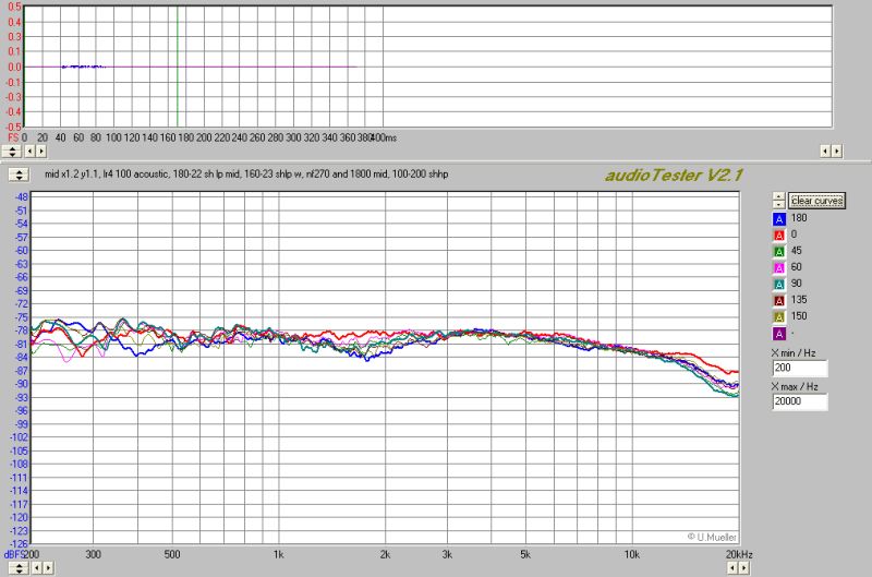

Yes, I have, though in a primitive in-room setup with likely reflection artefacts, and a bit closer than I wish (1.2 m). But hey, it's an indication. I have a largish dipole 3-way with shallow (20 cm) U-frame, ca. 120x60cm. I often have had similar thoughts as yours here actually, but to everyone his own trade offs.
I posted the off-axis response somewhere but it might have been in another thread, so here it is again.

My system is allactive, no passive components at all. I have the Diyaudio generated MOX variable analog crossover, with a lot of patches for additional filters though, definitely not a permanent setup. But it plays...
The graph is too busy but I only made this one... I didn't bother improving it because it has the in-room limitation which makes it marginal anyway. I have to drag the system into the yard at 3 am when traffic is low to improve that.
But what it does show is this: all the curves are within a 6 dB bracket, and above 400 Hz or so, there is no clear dipole falloff. And the 180 is not a misprint, I did a full (half) circle. I am mystified about the tweeter as well. My only explanation is that a) baffle edges will diffract HF (and so start a new point source) and b) the tweeter is very close to the top of the baffle. I did this intentionnally, to allow for rear radiation as well (to make the baffle step effect insignificant for the top edge). I just never imagined it would work that well.
The grid lines are 3 dB apart, so I expected the 45 and 60 degree lines to nocely be distinguishable, but not so. There are some wiggles at all angles, but they overlap.
The only larger, consistent deviation in dispersion is at 180 degrees at 1.5-1.8k. Since in this range the rear wave of the woofer must be out of phase with the rear-dispersed front wave of the tweeter, and since this is where the crossover falls, it is effectively a reverse null. So, this deviation gives me confidence that the measurement is not all artefact. But I can't quite explain why the dispersion should be so uniformly even, especially at the rear.
Last note, the subjective effect is consistent with the graph as well. Walking towards the speaker, the soundstage only collapses when I reach the line between the speakers. At the rear, sound is somewhat duller but not excessively so unlkess in the imediate shadow (say at 50 cm). At all reasonable front angles, the timbre does remain reasonably equal. Only at a larger distance at exactly 90 degrees does one notice the leaner bass (below 400 Hz true dipole behavior sets in).
