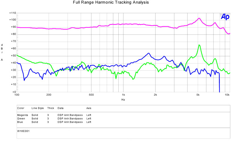

Not that much. Got the tweeters and measured two different crossover setups for the Behringer. Later one sounds pretty promissing. 300Hz 2nd and 1800Hz 4th order crossover.
I said i was thinking of a 1.2* 1.8m baffle, and i was intrigued when you responded . ."That's more like a open baffle than dipole". I think of the 2 terms as different ways of describing the same thing: a dipole figure radiation pattern results from (whatever size) of open baffle.
Have you read open baffle information from www.linkwitzlab.com? There is some well explained information about this. Basically the difference is "dipole" vs "dipolar". Certain size baffle works as a dipole up to a certain point. In my case, 34cm (13,4") wide baffle, up to around 500Hz or so. Below that dipoles figure 8 radiation pattern is pretty well achieved. But above that system is just dipolar. It radiates sound in opposite phases front and back but the baffle size doesn't allow them to form a perfect dipole radiation pattern. This causes dipole nulls at some point. In my case first one is around 1300Hz which is also very visible in the off axis measurements. Directivity drops and radiation pattern spreads open for a moment. With 1,2m wide baffle first null is much lower and before your considered crossoverpoint of 1200Hz there is propably second and maybe even third null. Check linkwitzlab for additional information and calculation patterns.
But like said, large open baffle is a different ballgame than smaller mostly dipole operating panel. Both have advantages and disadvantages. Basically whole dipole pattern is achieved and maintained best by using totally open drivers. No baffle at all. But this ruins overall efficiency. As you know the true dipole range has it's -6dB/oct roll off towards bass. For example we measured 7" Peerless HDS without baffle and got poor 75dB sensitivity at 300Hz. So it's more than just the radiation patterns.
I haven't got a measurement setup just yet - really curious, which PHLs did you test or see results on?
It was PHL 1120 midrange unit. I don't know is the same breakup pattern following the drivers in the lineup but there are problems with the papercone. Period. Many people dislike metalcones since they have dramatic peak at upper midrange area requiring steep crossover and a notchfilter. Ok. But the problems is pretty much solved by it. Many 7" papercone midwoofers have a breakup around 1Khz. At the middle of their passband. Naturally it isn't even closely as severe as metalcones but it causes some stored energy and distorsion problems. Naturally this can be sensed as a positive thing depending on what different people like. So the popularity and praised "naturality" of papercone can technically be just a coloration and misbehavior of the driver.

Personally I'd go for the W17s you have. I use W18Es in my dipole system, 34cm wide baffle with 300Hz 2nd and 1800Hz 4th order crosses at the moment. And they sure play loud and clean. Measured sensitivity using parallel connection is around 94-95dB. Not that much power required. Single or double 15" PA woofer for the bottom, depending on your room and needs. A high quality dome for the treble. Or use the ribbons if you already have them. W17s in separated small panel with the tweeter. Something like the NaO. And then the woofers in larger construction depending on your crossover needs and speaker placement. Digital crossover and delay ease things up a bit. NaO style panel doesn't require much floorspace and is even mobile if you need to move them for vacuuming or such. Woofers along the sidewalls, plenty of output. But this idea is just me ... 😉

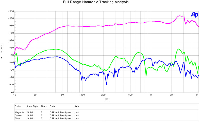

And here 25W/8565-01 THD @ 90dB SPL. Both measurement have too small closed cabinets so below 100Hz distorsion isn't correct.
That 3rd harmonic peak at 1800Hz with W18 response isn't that good thing. It's from the primary breakup. I guess my present 1800Hz 4th order lowpass with adequate notch filtering is pretty much the maximum for this driver. At least when it comes to distorsion.
25W didn't show that big suprices either. Few 2nd harmonic peaks, pretty similar than smaller brother 21W has. I guess some of them can be damped with magnet support. My present 300Hz 2nd order lowpass might be a bit high for this driver.
Jussi
Jussi
