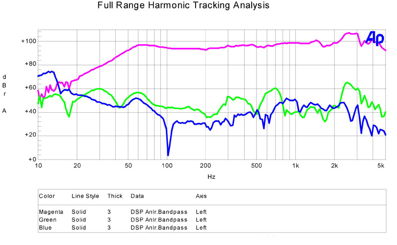

Ups. Sorry for the misinformation. Measurements are just 2nd and 3rd harmonic and level is seen in each measurement. W18 response goes up to 95dB at midrange. Pretty well inline with Seas own graphs.
Here is 25W at 95dB. Again ignore distorsion below 100Hz (too small cabinet). Pretty good -50dB result up to 250Hz. Not sure how much those 2nd harmonics die down with magnet support and 2nd order filter. I don't think I'll go for 4th order here since there are other issues to consider. Like the vertical radiation pattern that's already discussed here.
-50dB with 95dB SPL. This leads to conclusion of ~0,3% distorsion at 100dB or so using two drivers on each side. Not bad. W18s 3rd harmonic peak is a setback. Fortunately well known setback. It isn't bad since SPL is already very high 95dB leading to 100dB ~0,5% THD with two drivers. But it could be whole lot better. Below 1Khz W18 is extremely clean. Pretty demanding company for any tweeter...

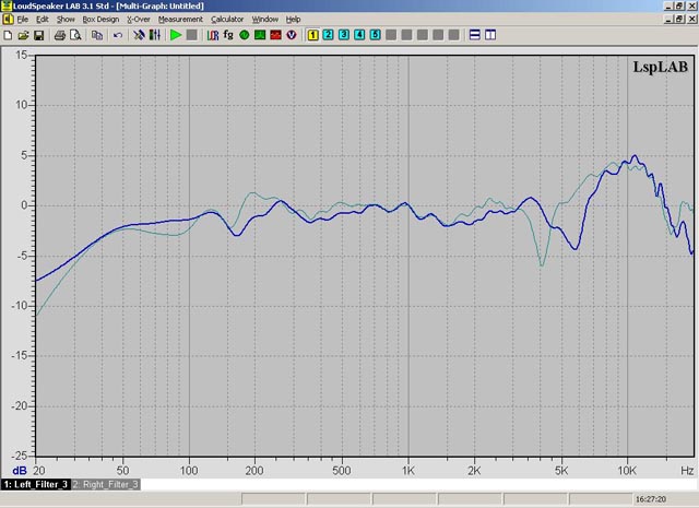

Ok. More tweaking. Crossover versio 3.2. Pretty much measured balance and I must say it doesn't go that much wrong in the room either.
Here on axis responses at 100cm distance with room responses at 250cm 1/6th octave smoothing. Response rise between 6-12Khz is related to uncalibrated Behringer microphone. No sibilance audible. Midrange level is rised 1dB after this measurement. Still promissing...
Only problem is that while I'd get these things ready I have to come along without speakers for a while. 🙂

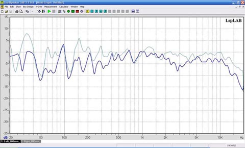

2,5m away. At the listening position. 300ms window, 1/6th oct smooth. Room is very difficult and rest of the furniture aren't symmetrical against the speakers. I guess some of the differences between channels appear from there..

Here is a roomresponse using 300ms window and 1/6th octave smoothing. Basically the only real problem frequency is that 33Hz centered lowest listening direction mode in this room. So far it hasn't been that big problem since I can notch it off in my Behringer. Same mode is also dominant with monopole subwoofer.
Actually this response isn't one of the latest ones since I've altered lowmid level since then but it overally shows how things work out.
