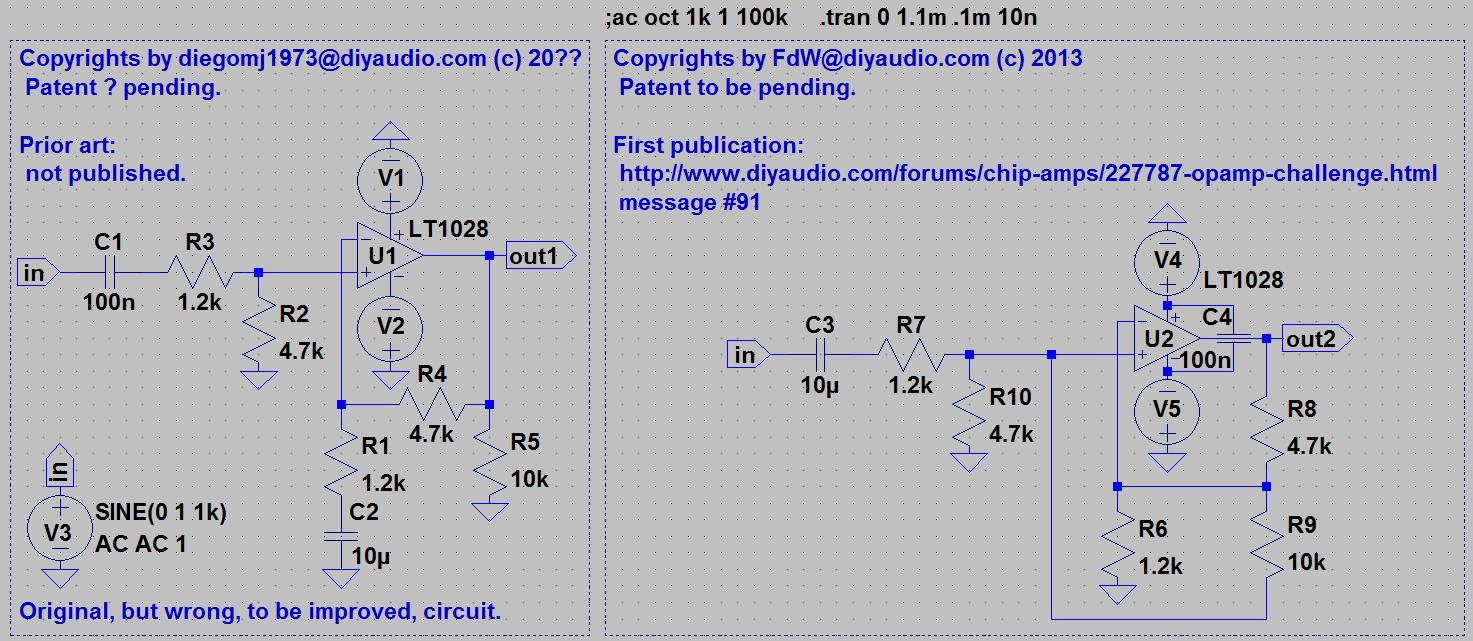

While what you have is very interesting, would have to find a way to keep the same input impedance (or something very similar).
So you removed/bypassed the 100n and reconnected the ground leg of the 4.7k at the 10u. Not really new and I fail to see the advantages vs removing capacitors alltogether (and adding a servo in case offset is an issue....).
I don't think that wouldn't work in practice although it would in simulation. It's relying on the input source to define the DC conditions. An AC coupled source wouldn't bias the opamp correctly.

to keep the midband input impedance similar seems to imply that the 4K7 and 1K2 still define that parameter. If the 0.1uf were bootstrapped then the input impedance would rise.
In simulation you can "flip" the voltage source physically through 180 degrees and make use of applying the input to the inverting terminal. Again thats a case of works in simulation but not in practice.
I wonder if the 10K output resistor could play a part. We are assuming its a passive non-contributor... so why include it at all.

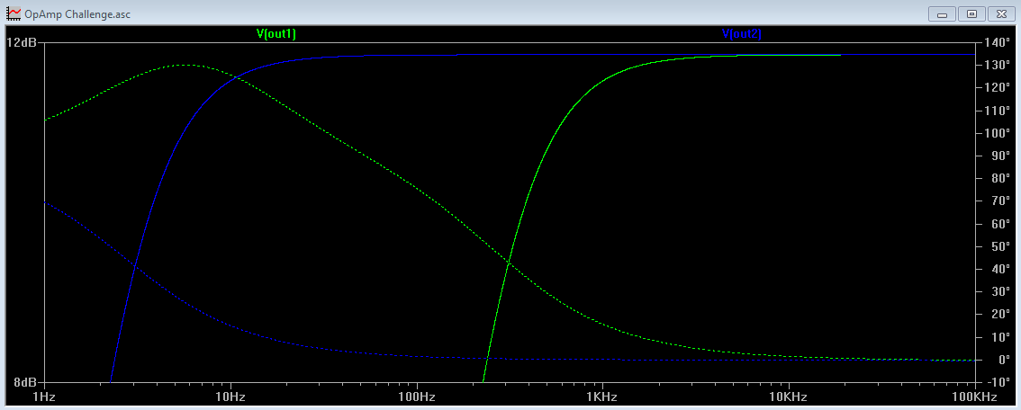

Looking at the first post the response has to be around 3db down at 7hz....

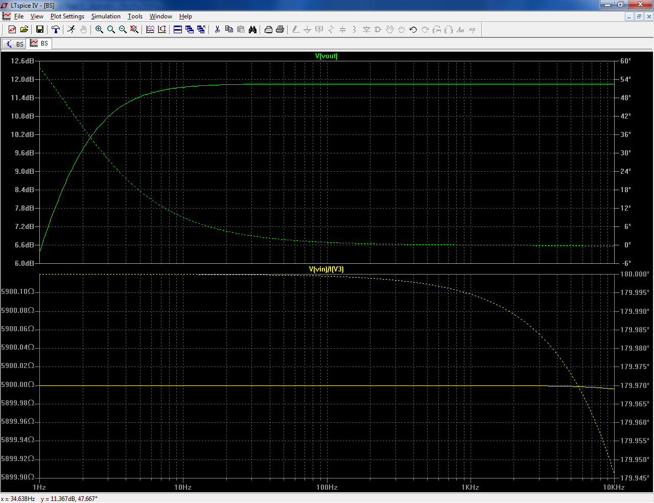

With the 100n as a spare I can do almost 2Hz.
The input impedance is:
@ 1Khz 5.9KOhm
@ 10Khz 5.9KOhm
@ 100Khz 5.7KOhm

Still, it cannot be 'the'-circuit (it is way better 🙂) because it does not stop at 7Hz. But then, this was only one evening of research 🙂

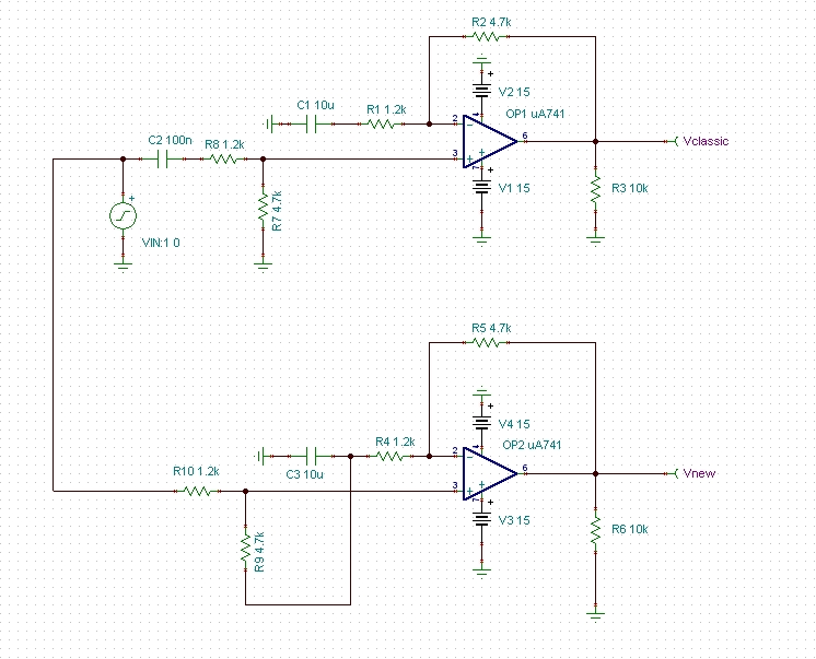

So if we use the 10µF capacitor with the input impedance which should be about 5.9 kOhm the -3dB cut off frequency is about 2.67 Hz which does not correspond with the presented graphs from diegomj1973.
My post #75 has an input impedance of about 2.4 kOhm which gives us -3dB at 6.63 Hz. => exactly what all graphs from diego are showing.
Conclusions:
* the 10µF capacitor is not connected at the input stage
* or diegomj1973 measurements are wrong and his circuits input impedance is 2.4kOhm and not 5.9kOhm.

If it helps: the 10K resistor is connected directly between pin 6 and 0 volts (in both variants: the common and modified). It may be another value, too: to make it more generic.
Tested with TL071, TL081CP, LM741.
It works in real conditions and simulations.

I'm just learning to use spice, thinking it might help me understand your previous response, the one where you lifted the input signal return to the top of the 10uf cap.
I still don't get it. The frequency response at that node (the top of the cap) doesn't seem to change, although the magnitude looks like it increases. How does this work to lower the pass band?
I'm obviously missing something very important here.
on edit: Doh! It's a .1uF cap, not a 10uf!

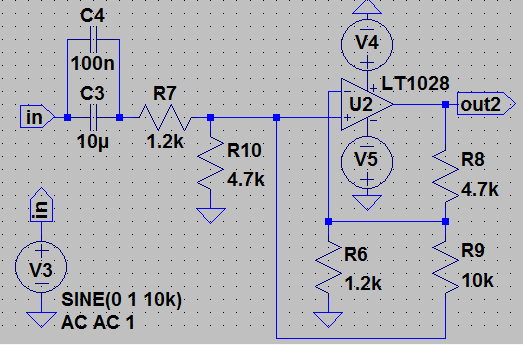

Knowing now that the 10K doesn't figure in it all I can't see a solution. If the input has to be AC coupled, then as I see it pin 3 needs to see 5.9k to ground both to define the input impedance and to set the DC conditions. Bootstrap it in any way and you lose that...
This is my latest (and probably final) schematic; I did find a legitimate usage for the 100nF capacitor (although not in the signal path or the feedback-path). The scheme now has been decorated with (almost) legal annotations. Last night the patent office was closed, I will try again coming night 🙂
