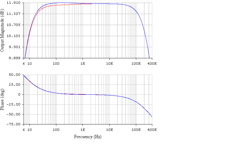

That is a very good approximation. You'll notice that this is not the one I use, yet.
I've been testing and studying this setup for almost a year. If you try different combinations of capacitors, will verify certain nonlinearities at low frequencies (depending on the ratio of capacitors). Try, for example, C1 = C2 = 10 uF. The nonlinearity in this case is about 1 dB. Another thing you can try is to make a sweeping capacitor values and observe how the system behaves, to verify what I say.
This configuration could be used, but with certain restrictions on capacitor values.
The configuration that I'm using does not suffer from this drawback.
Anyway, an interesting approach is what you have uploaded.
The blue curve corresponds to what You have kindly uploaded.
regards

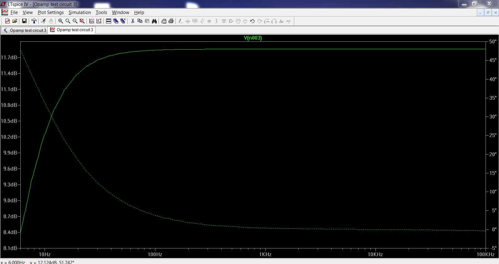

Unity gain bootstrap for a low low pass with a small capacitor :
How to modify the original circuit should be obvious.
Should read :
Unity gain bootstrap for a low high pass with a small capacitor :
rgds, sreten.
