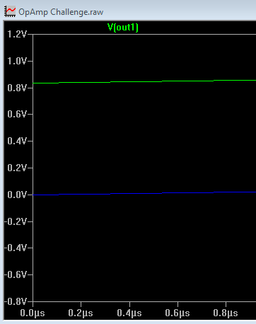

Here another observation, although the 'original' circuit exhibits some offset, my new and improved circuit has 'NO'-offset (see picture). LTspize shows -0.00308642fV (as near to 0V as humanly possible 🙂) (ohhh, and I know why 🙂)

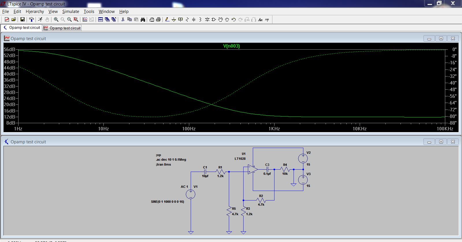

I guess we're just going to have to see what you come up with. Extending the LF response by reconfiguring the circuit is easy of course... and does what you ask... but I guess that's not what your getting at.
The first simulation here wouldn't work in practice using real parts (although it does work in spice)
The second would work of course but its totally standard and can't be what you are getting at. It does have the added bonus though of decoupling the opamp rails though, which is is a "huge" benefit.
So I guess its over to you to show what you have come up with 🙂

Do you know why Mooly's example makes the .1uf cap look like a 10uf? I'd really like some help with that.
Do you mean this one, post #31
http://www.diyaudio.com/forums/chip-amps/227787-opamp-challenge-2.html#post3330328
The 0.1 is now included in the feedback loop. Our point of interest is across the 10k and so the feedback keeps this point correct. If you look at the output
of the opamp rather than the notional output terminal of the circuit then the opamp output rises with decreasing frequency to counter the rise in Xc of the cap. The downside is that the circuit will clip easily at low frequency because the output of the opamp has to be so large.
Here's the output of the opamp rather than at the other side of the cap.
