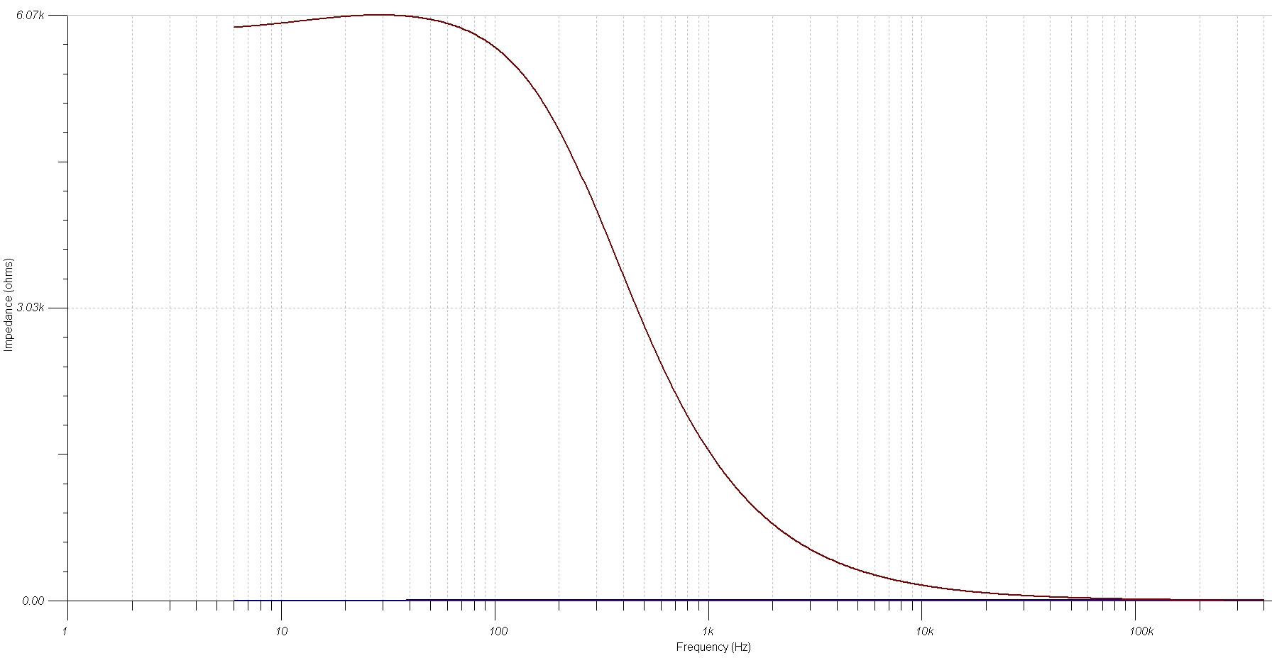

If it is what I think it is (my turn to be "misterious" 🙂) you'll need to plot inputZ vs. Freq.
Something nasty will turn up...Your signal source will have to drive a dead short past ~10kHz or so...therfore distorsions will raise signifcantly wrt Freq. The classA amps can't save the day here.

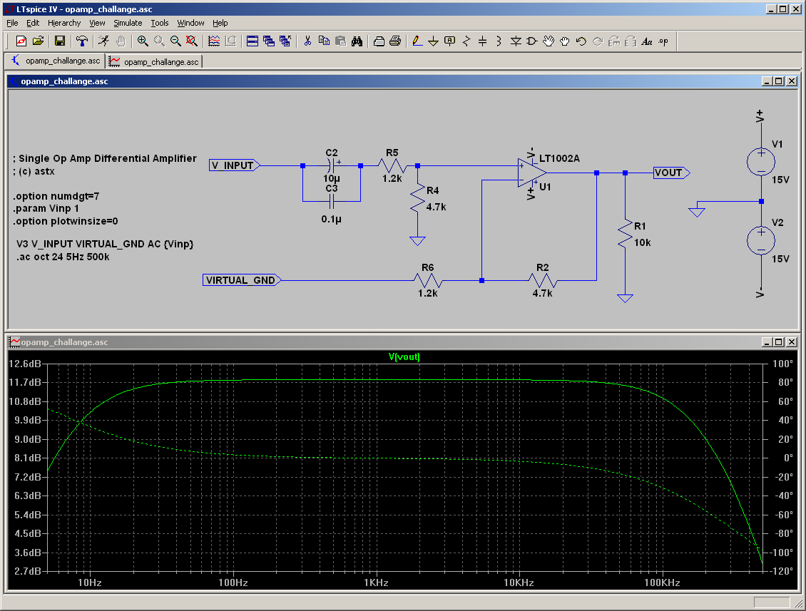

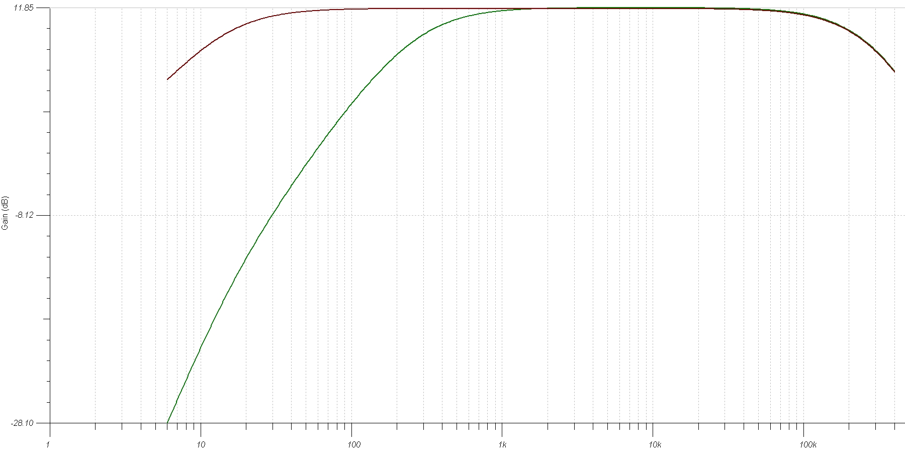

Here are my results, first two very similar to those in your initial post.

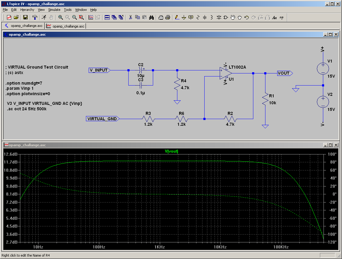

sidiy:
You can upload the schematic?
Of course! With only one modification it satisfies all the conditions and gives the same simulated results. The bad news is that it loads the source pretty badly so in applications for audio one must consider headphone type outputs with care for stability, distorsions...etc.
Yes. In my amp I have it working in the same way.😉
Thanks... my reason for asking was this... to confirm that two identical circuits can have either the "negative" or the "positive" of their respective signal sources joined together (as would happen with a CD player with the negatives being common) and that both circuits would still operate correctly 🙂

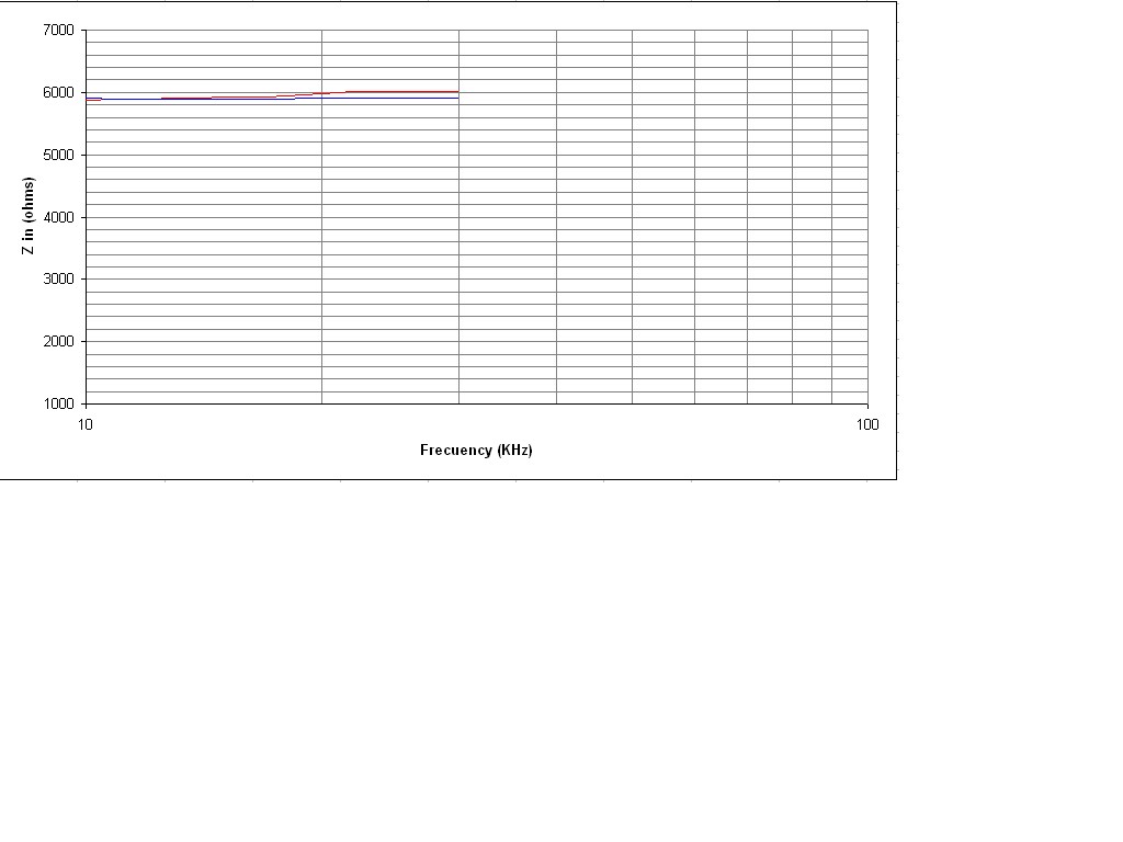

I haven't been able to figure out how to meet all the requirements. The circuit I offered earlier that matched your phase and amplitude plots almost exactly, removed the ground referencing of the input source.
The input impedance is one area where my solution failed too.
If the input impedance in the pass band remains the same as the original then that suggests we should be able to add a 5.9K in series with the source voltage and that the output voltage will reduce by 50% without affecting the response.
sidiy:
I mounted breadboard the two options ("standard" and "modified") and measured input impedance in both circuits above 10 KHz. There may be slight discrepancies in the readings but I do not see major differences.
regards

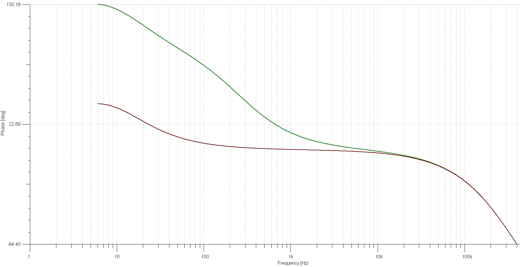

astx:
Those were the two best approximations, until now. Give me some time to analyze them in detail.
I do not see these nonlinearities, as I said occurs in other case.
I have doubts on the input impedance. I think it's 2K4.
As you can see, I use another variant.
The blue curve corresponds to what You have kindly uploaded.
regards
attachment.php
Ad post #75 and #77:
IMHO the blue curve seems to be more linear - standard differential amplifier seems to be the better circuit. The input impedance ist indeed 2.4k
Also with matched resistors the CMRR will be very good.

astx:
The blue curve is more linear than red (no doubt). However, in real cases, this nonlinearity does not exceed 0.1 dB. Believe me it is so.
The main intention in my connection is:
Given a common connection, have the possibility to relocate its components, maintaining its current parameters and improve only the low-frequency response (without prejudice to the other parameters). This would allow us to implement it in all that exists, relocating connections only.
While what you have is very interesting, would have to find a way to keep the same input impedance (or something very similar).
