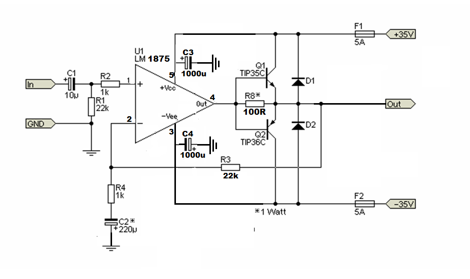

Was looking for something that drives external transistors, and be able to run at more than 40 or 50 volts, from what I gather. That’s not the 1875/2050.

They are not really supposed to be used like that. Magic smoke is common for those who try. And does anyone know how positively awful the crossover distortion is on those “designs”? One is far better off driving complementary CFP pairs with a regular, non-power high voltage op amp. At least proper current limiting can be added and they can be biased into AB.

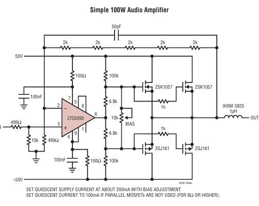

In LTC6090 datasheet is an Simple 100 Watt Amplifier.
https://www.analog.com/media/en/technical-documentation/data-sheets/6090fe.pdf
It uses lateral MOSFETs.
LM1875 can not have +/-35V. Max +/-30
Why 5x 2k ohm? Why not one 10k?In LTC6090 datasheet is an Simple 100 Watt Amplifier.

Reduces the TC of the resistor. A higher power resistor could have done the same thing, probably at added cost. Feedback resistor TC is a recognised source of distortion.Why 5x 2k ohm? Why not one 10k?

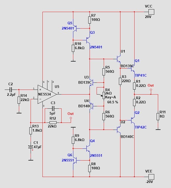

Here is a NE5534 who drives TIP41/42.
Low distortion, THD 0.00009%
That is not many parts 🙂
Haven't you seen some designs on this forum? They are crowded!
