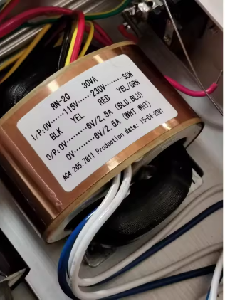

The 500w ruide transforners i have i about 3 nF between primary and secondary. That is the reason that i dont use floating power supply.
With a C-C transformer it is doable.
3nF is easily OK to put on the output of a 'good' amp and should improve stability a little. If your design objects, it is a bad amp.

The reason for me not to use toroid transformers in floating power supply amplifiers lies in the fact that i have a few 100 kHz audio bandwith and a common ground system in my mains supply. The amplifier, TV and computer are in separate mains groups means that i have ground loops of up to 100 feet. The switching power supplys in tv and computer have about 5 nF mains to DC or there is a direct connection as in the Computer PSU. 5nF breaks the ground loop for 50Hz but when you have a few 100 kHz they conduct. And at that frequency the inductance in the main ground cables begin to play a role.
That makes a great risk of self oscillations in the higher freqencies.
In a n Ei or C-C transformer it is easy to separate the windings so they can be made with just a few pF in between.
This one is called R-core.
The important capacitance for a Vanderkooy or TransNova amp is between secondary and chassis. ie the mounting.
Stuff between primary & secondary will affect ALL stuff. The usual built in EMI suppressors on IEC sockets are quite good at reducing the effect of RF on the mains.
Amps like the QSC get away with it because they intentionally roll off above audio. If you are trying to make an amp flat a decade or more above audio, the coupling between windings is going to bother you.
