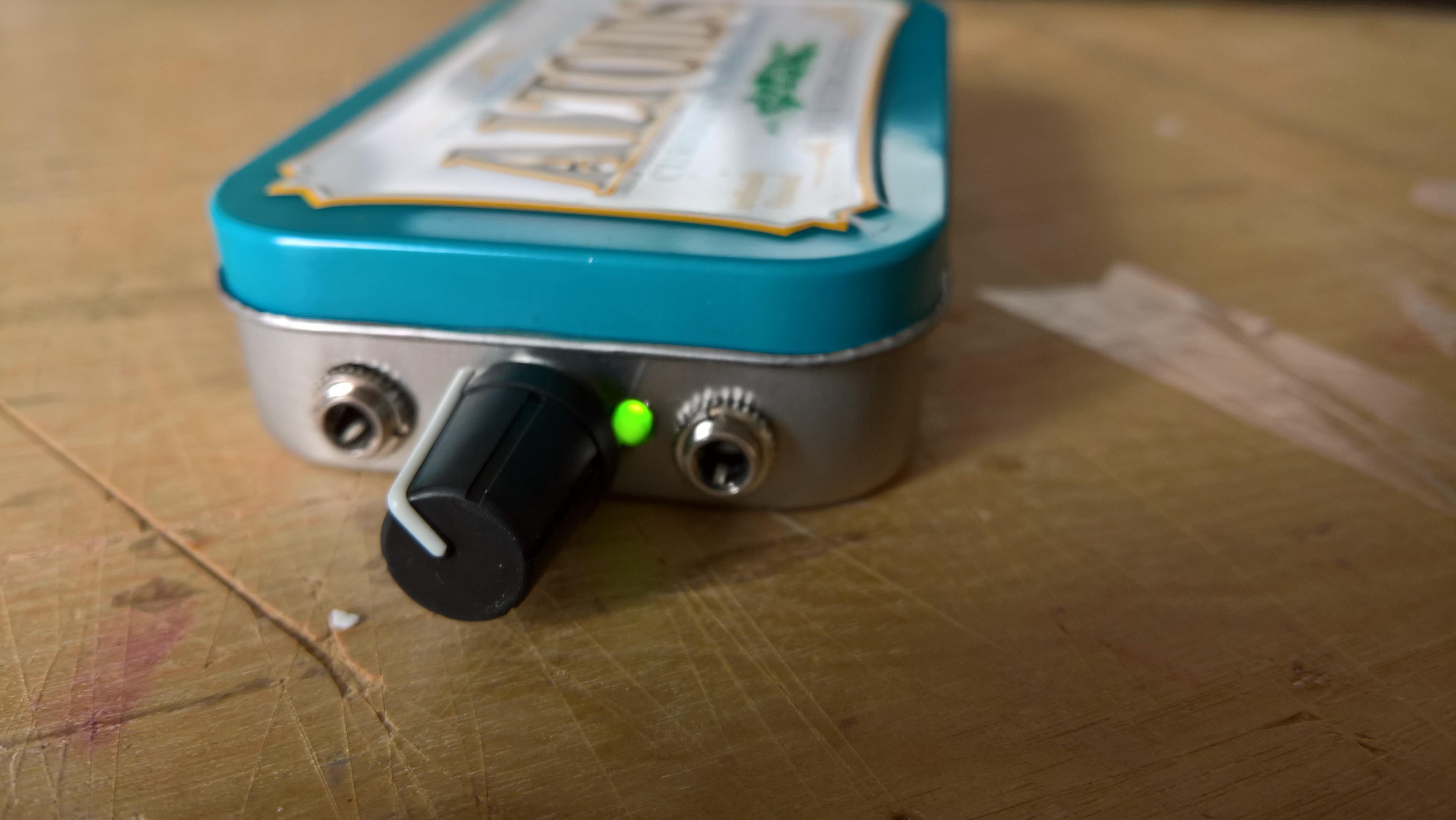

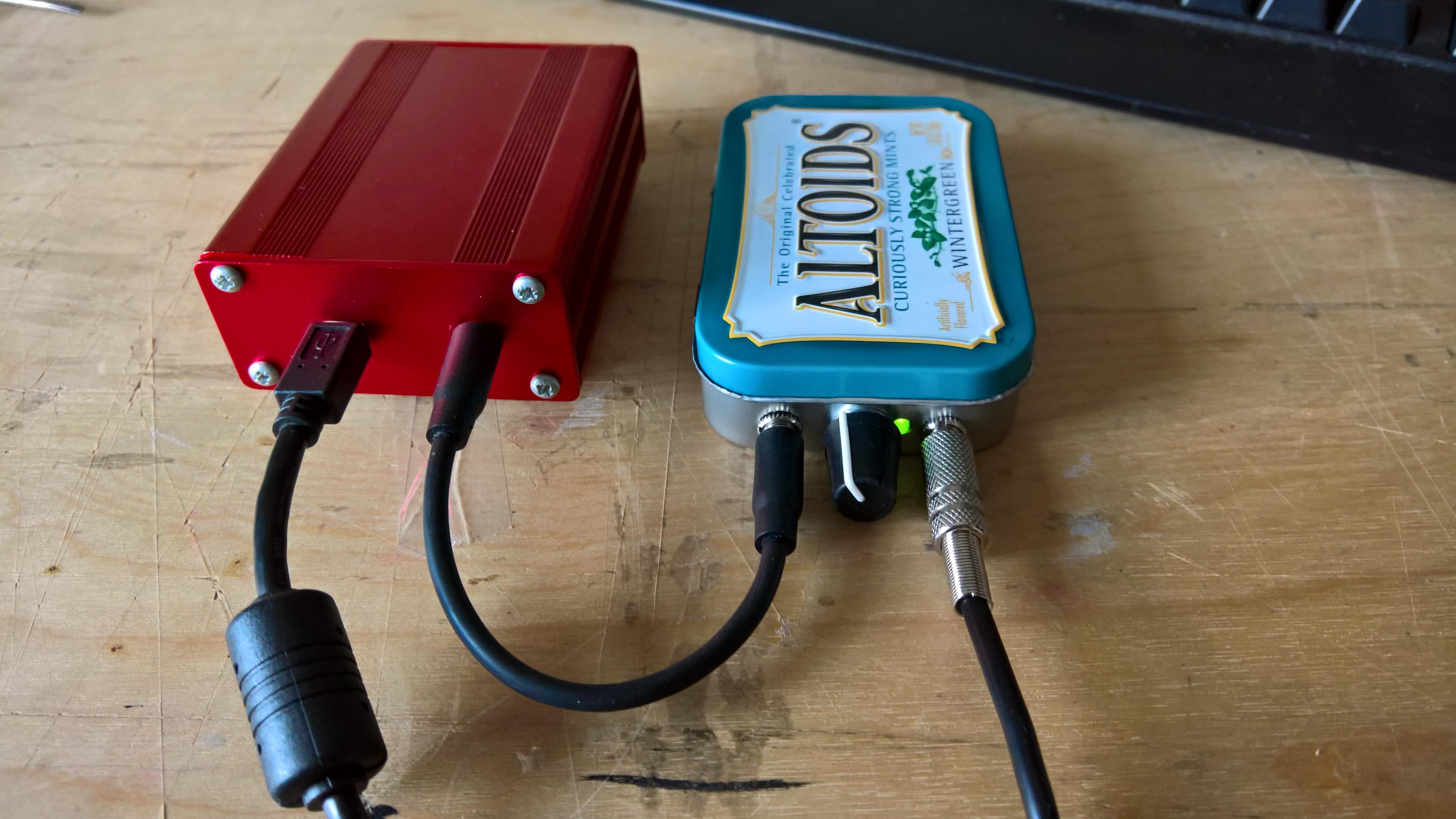

Yes the knob is a bit too big if mounted with the board parts touching the bottom on the altoids can. But I have done that not even thinking and it slightly touches but doesnt seem to cause any real issue. So I could get another can OR just put some small "feet" on the bottom of the can!! Voila!!
Here are some pix with the led on:
Also note I have the headphones and dac plugged into the wrong jacks!!! LOL.
Listening to the amp outside on the enclosure then flipping it upside down makes this an easy mistake to do!! No Sound!! LOL!
Working ok fine so far and sounds great!
Alex
Note does anyone have a smaller know that would fit and look good? Maybe a smaller diamter silver metal knob??

Alex - looking good! Great job on the mint tin holes. Feet are a good idea! Saves from having to re-drill the can. Yeah lets see if we can find some slimmer knobs out there. These BOM knobs from Mouser are 13.2 mm in diameter at the widest part.

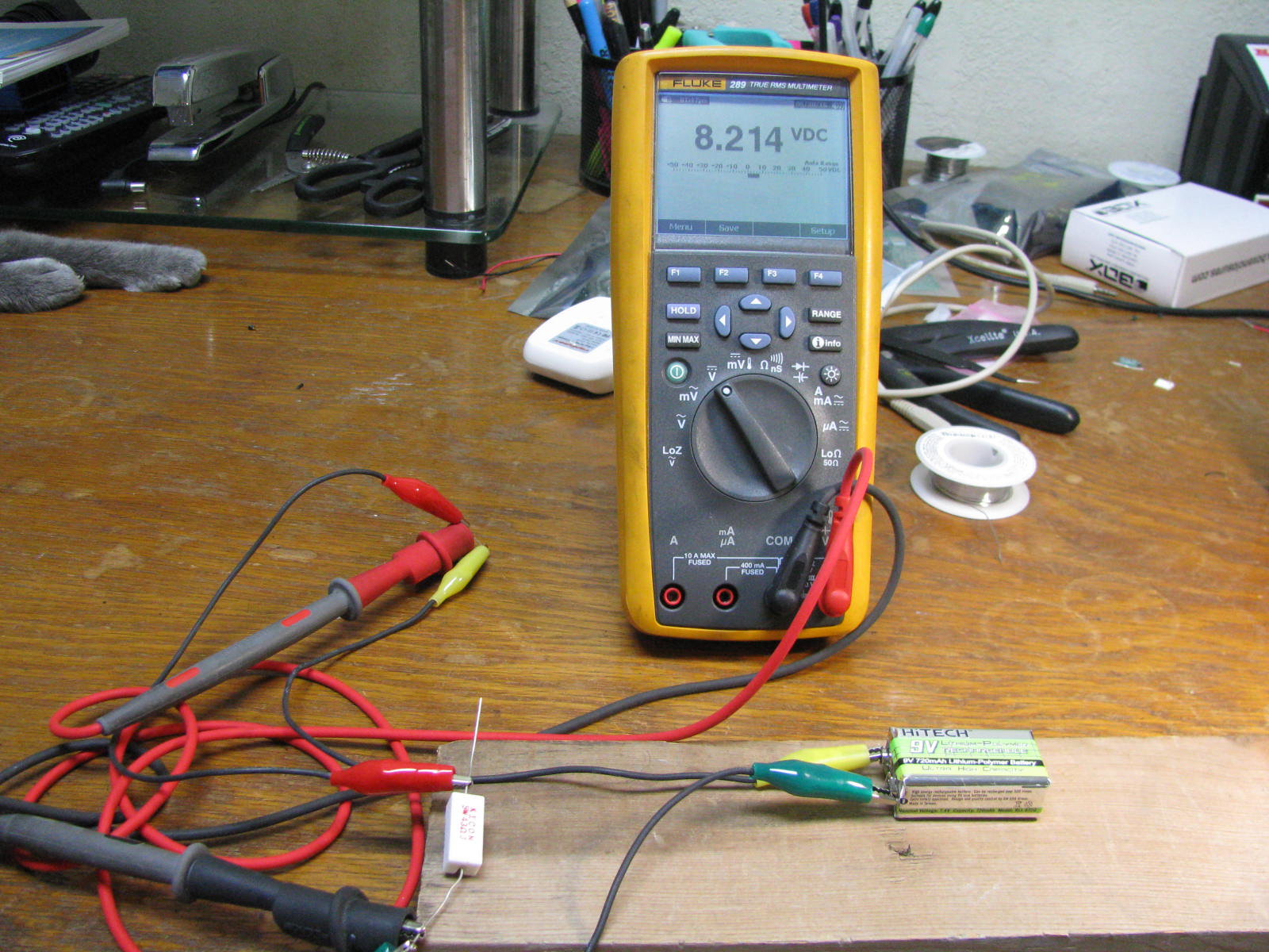

Lithium 9V battery internal resistance at a 0.25C discharge rate

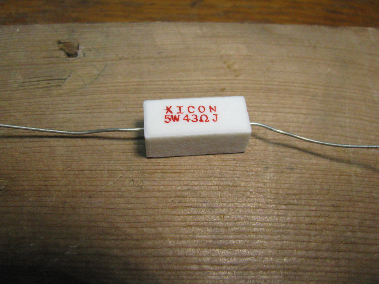

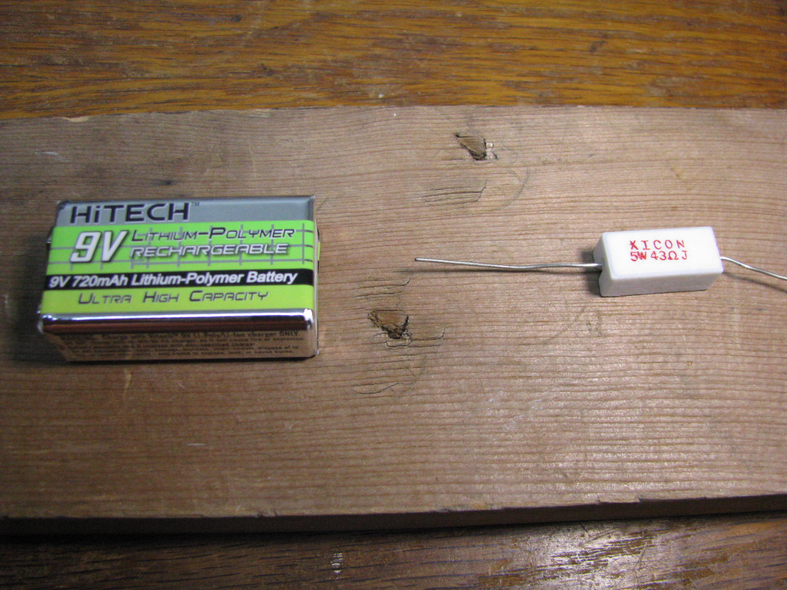

I wanted to see if the internal resistance of the lithium polymer "9V" battery was current dependent (non-linear) by trying a heavier load. Turns out it isn't! Still essentially the same.

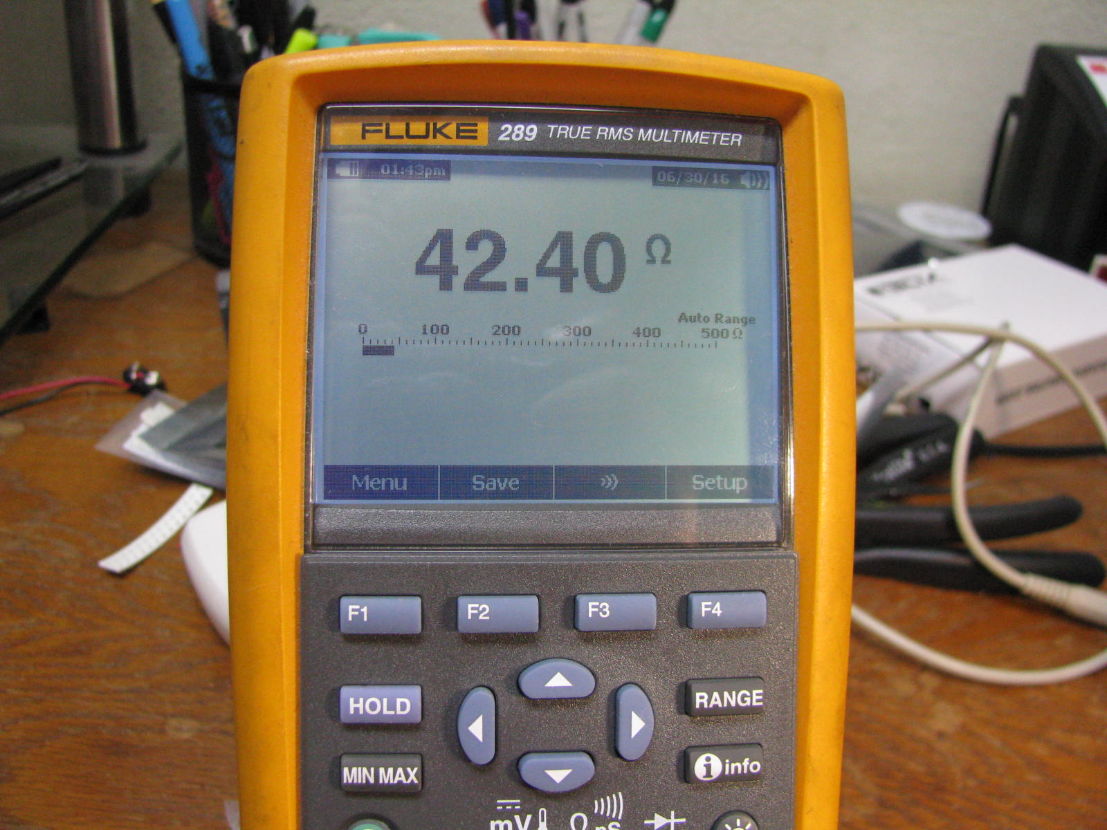

In the photos below the new load resistor is a 43 ohm 5W "sand" type, measuring at 42.40 ohms, which gives a discharge rate of 0.25C (around 185mA) for the 740mAhr battery. The lithium battery has been recharged after the test yesterday. 0.25C is the dicharge rate used for the NiMH "9" cells above, giving a better apples-to-apples comparison between "9V" NiMH and "9V" lithium polymer.

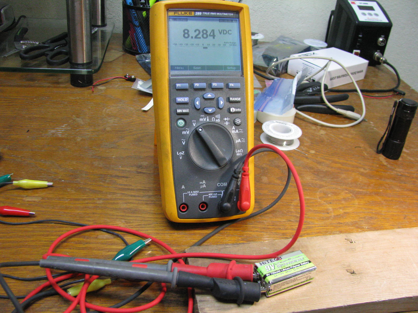

The open circuit voltage is 8.28Vdc, the voltage under load is 8.21Vdc. The current through the series setup is 8.21/42.40 = 194mA, close to 0.25C. The voltage across the internal battery resistance is 8.28 - 8.21 = 0.07Vdc.The internal resistance of this rechargeable battery is then 0.07Vdc/194mA = 0.361 ohms, compared with 0.381 ohms above for the 0.08C discharge rate. Fairly consistent. At the 0.25C discharge rate the battery is dumping 8.21Vdc^2 / 42.40R = 1.6 watts into the resistor.

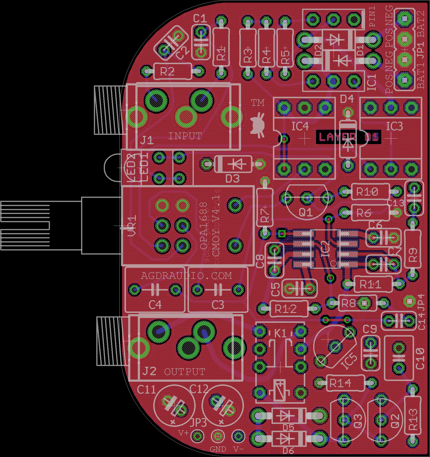

Revised front panel hole template, new knobs
Excellent suggestion!! I've been thinking about it since I read your post. I think you are 100% correct. That slim rubberized knob I had specified in the BOM is just the wrong thing for the CMOY. It needs a smaller knob. So the problem isn't raising the PC board 2mm to fit that knob, the problem is finding a slimmer knob. Having the board sit on the 3.5mm jacks is just fine, as I originally intended.
So for knobs, here is a start. 😀 Adafruit has some T18 shaft slim knobs that are 10 mm in diameter, in either 10 mm long or 15 mm long:
https://www.adafruit.com/products/2058
https://www.adafruit.com/products/2057
I've just ordered some to try out. If they work I'll have them available on the sales thread, so folks won't have to place a separate order.
The mechanical measurements for the Super CMOY show 5.8mm of space from the center line of the pot shaft to the mint tin bottom, if the board is sitting upside down on the 3.5mm jacks, plus an additional 0.2mm for the bottom metal thickness. That is a total of 6.0mm from the pot shaft to table top, so any knob less than 6.0 x 2 = 12.0 mm should clear the table. The 10mm knobs here should work great. The slim rubberized knobs I had listed previously are 13.2 mm in diameter, just 1mm too much.
And... below and out at the Google Drive link is a revised version of the front panel hole template. This one is back to the Super CMOY sitting upside down on the 3.5mm jacks. The hole template now includes an optional 2mm hole for the LED light to come through, with the LED soldered in the rear position that clears the panel.

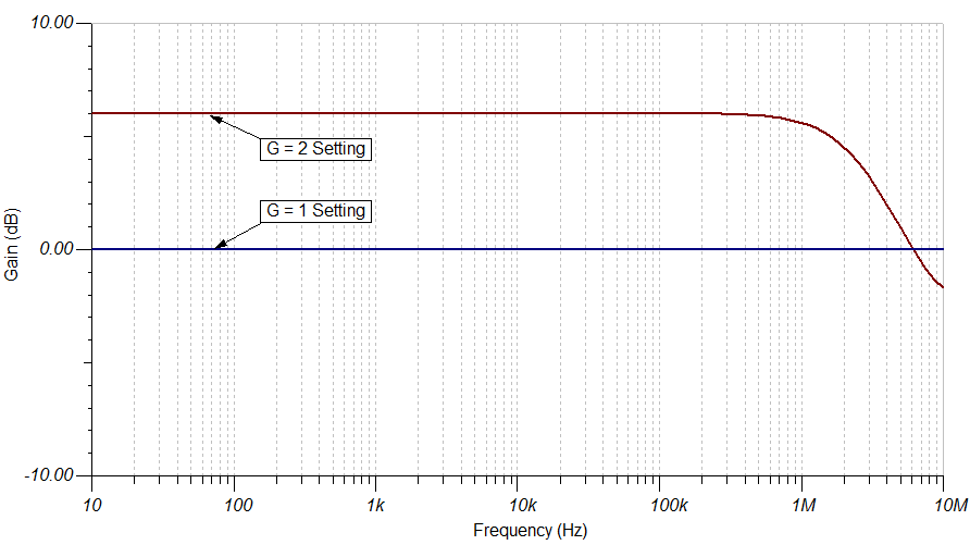

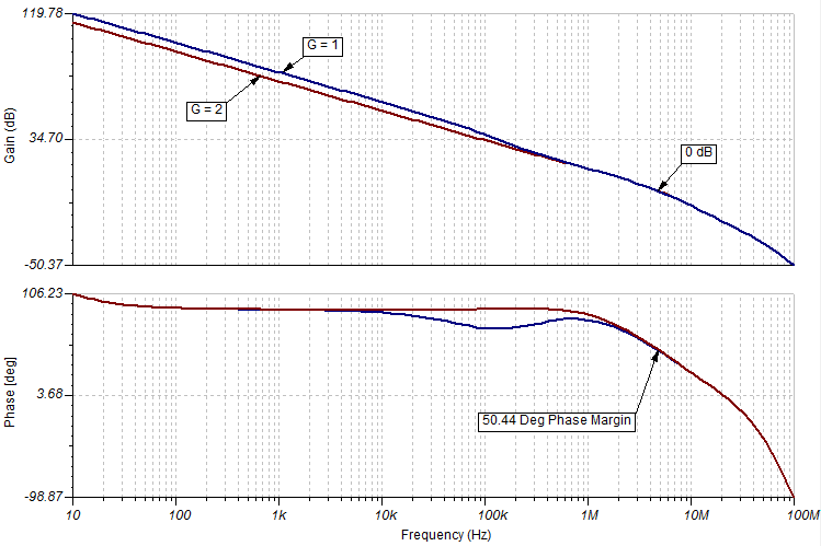

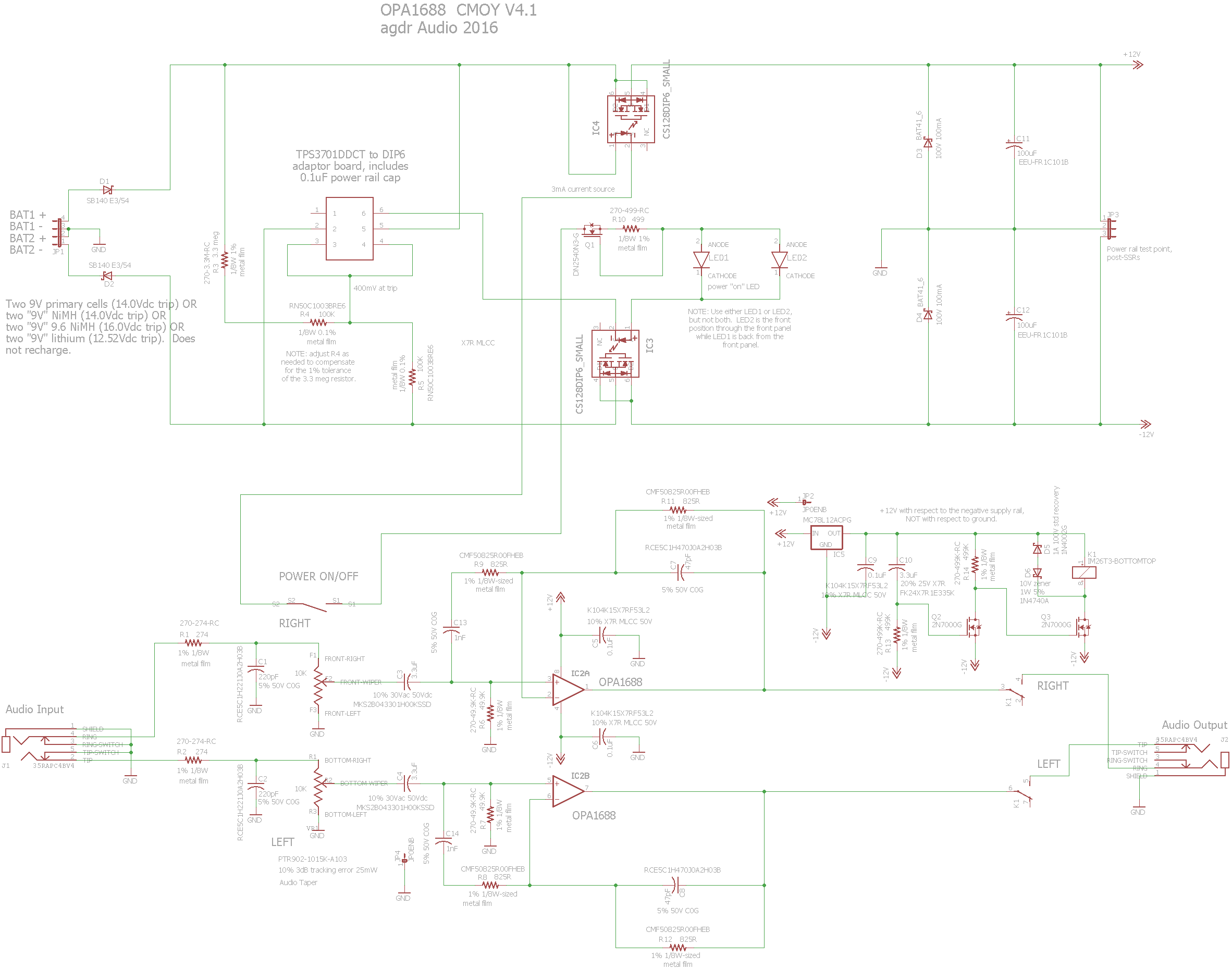

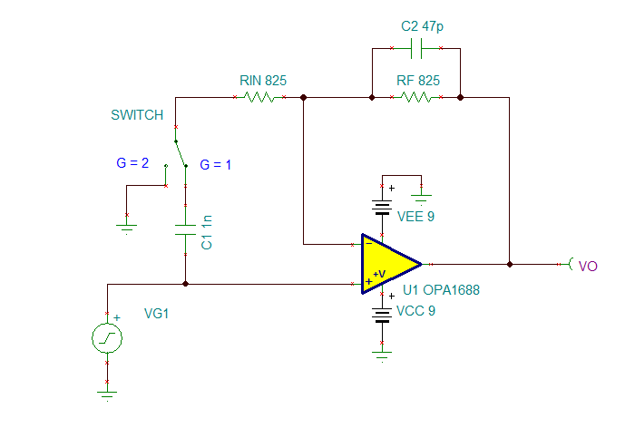

So I did a quick stability simulation on the G = 1 configuration and a 400pF load and I wasn't really happy with the result (about 25 degrees of phase margin if I remember correctly). The problem is that in a gain of 1, the inverse feedback factor (1/feedback factor, the inverse of quantity of the output signal that is fed back to the input) is already 0dB, so I can't really create a dip in the curve to get a boost in phase margin. BUT I can increase the inverse feedback factor without actually changing the signal gain, this technique for stabilization is commonly called noise gain (because...well...it increases the noise). The trick is to only increase the inverse feedback factor outside of the audio bandwidth, so we still have the low noise and distortion of the gain = 1 configuration at the frequencies we care about. And at high frequency, near the loop closure point I have some extra inverse feedback factor and can use my little 47pF capacitor to boost phase margin.
But enough control theory, the circuit is attached. It uses a switch to select between G = 1 and G = 2. You could also do this with a jumper and have many selectable gains. The phase margin with a 400pF capacitive load for both G = 1 and G = 2 is 50 degrees (loop gain and phase plot is attached). Also attached is the frequency response in both settings so you can see that the signal gain is exactly what you would expect. This might be a good way to may a CMoy more flexible to accommodate multiple headphone types.
It is worth to mention that opamp open loop output impedance is somewhat current dependent. This is especially noticeable for lower power opamps, when output stage has a quite low bias current. In such case output impedance has an obvious peak when output current is around 0, and in this region opamps are more sensitive to a capacitive load.
Opamp models, unless they are made on transistors level, do not represent these effects, and as a result they do not give a full picture of what is going to happen in such case with a real device.
OPA1688 has a moderate GBW, which helps, but it is still quite a low power device and it is worth to keep an eye on this.
If you run into a problem like that, it is not too hard to fix it by lowering the crossover frequency even more by adding RC in between opamp inputs. Similar way to what John did, but without affecting overall gain (you can also make it smarter combining it with an input filter, but it works only for an inverting amp). Or just by adding an output RC damping.
NB Also a signal source is not always an ideal voltage source, may affect results somewhat.
johnc124 - Outstanding! Thank you for taking the time to work through this! Much appreciated. Your solution to increase the unity gain phase margin makes perfect sense. I agree, 25 degrees is getting thin enough that sooner or later somebody out there with a long cable and just the right headphones may have oscillated.
The timing is great, I have nealry run out of PC boards from the first fabrication run. I was about to send out a V4.1 with a few cosmetic changes, but no functional changes - until now! 🙂 Luckily I have space for the two new 0.1nF 50V C0G MLCC caps, C13 and C14 below. I also have the layout and schematic posted in a new V4.1 folder out on the Google Drive link.
For the gain of 1x, the new C13 and C14 are populated. For gains of 2x, 3x, or 4x C13 and C14 are left out, with the capacitor pad that connects to the resistor (R9, R8) is jumpered to ground. For C14 that is the new JP4 ground pad next to the cap pad to jumper. For C13 the bottom pad of the capacitor just solders to the right end of R6 (which is ground) with a piece of jumper wire.

That's correct. While designing the OPA1622 I required that all distortion simulations be performed with at least a 3 ohm power supply impedance. At first my design team didn't care about the requirement, but it eventually drove many of the design decision for that product (just take a look at the PSRR).
Hold on, guys! Saying "signal source" I didn't mean supply sources. I know that the way I construct sentences is a bit odd, but not to that extend 🙂
When freq compensation is performed by adding an impedance in between inputs, you result will depend on other impedances connected to the inputs, including you signal source. It is unlikely will cause a big problem, but you have to check corner use cases, like no source connected etc.
Also, while having lower valuer resistors values in feedback is beneficial from an output noise point of view, it barely will do any improvement in case like this. I would keep resistor values a bit higher than ~800Ohms, so you can use a higher impedance RC for compensation. Just remember about an input capacitance, that is it.
