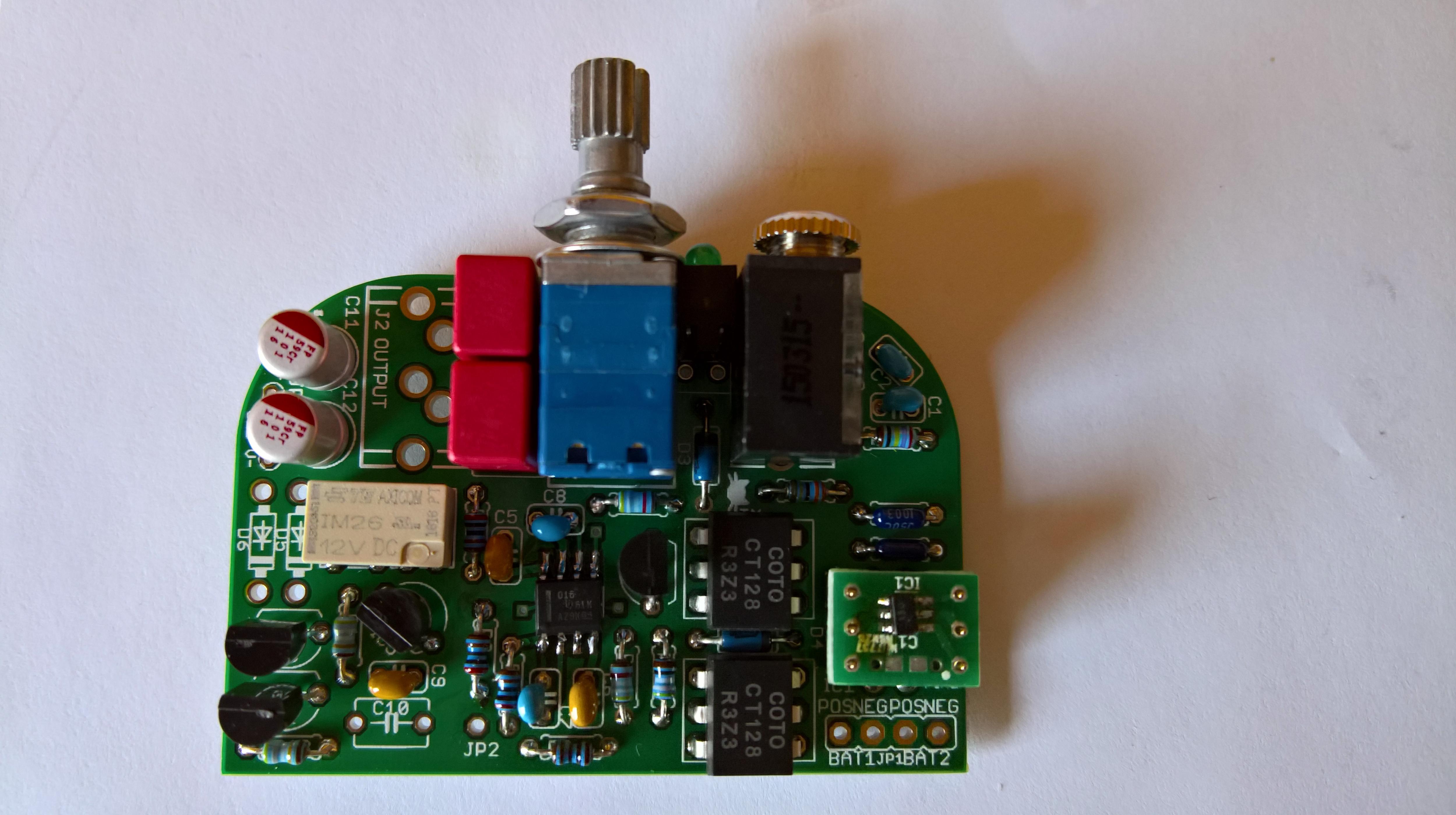

Got parts, got boards, iron is getting hot!! LoL
And that is the current V4.0 here that adydula is working on now! 😀 I'll be curious to see how your case comes out. You do such a good job with the hole marking and drilling. Plus listening impressions like johnc124 said! I know you have all my amp designs there plus some others.
Hey great shots!!! I like the tape method!!! (lol).....Simple things for simple minds...
I am starting to populate this morning!

I'll be curious about how long it takes you to do the build! I haven't timed myself yet but I think I'm at about an hour. Half of that is spent getting the parts out of the storage bins. 🙂

It took me a little less than 2 hours, I am slow and methodical, I use a schematic, check parts with a meter, make sure its the correct part in the correct spot..easy than having to remove! Then install and use a yellow highlighter to mark on the schematic to keep track and that all parts are indeed installed.
Another hour working on making the holes in the Altoid can, its a fragile can with thin material, slow and easy.
Heres a pix, just one switch to install and 2 zeners then test time!
Alex
Alex
Looking good there! Yeah I mis-estimated how long it takes me to build too. I'm building another one up right now and it is taking closer to 1.5 hours, even having designed it and knowing exactly what the parts are in my head!
I'm eager to see how your mint tin comes out. You do a great job with the hole drilling.
