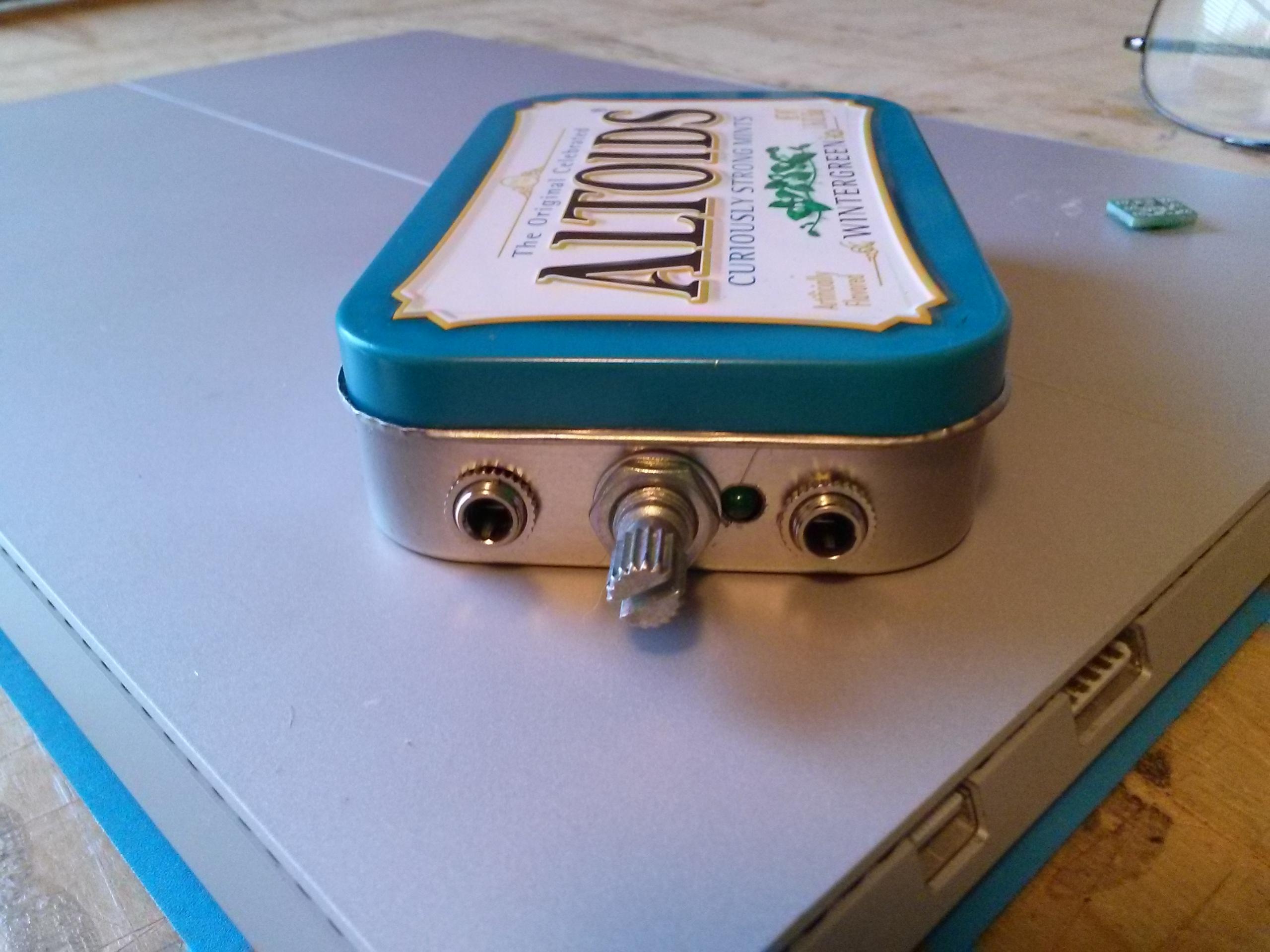

Heres the "rough" holes...I will file and de-burnish the holes and paint the area black to hide the imperfections. I had one slip and a small scratch when drilling the small led hole a real pain...But when its done it will look great.
I will post when all done powered up so you can see the led.
It took a good hour to do these holes.
First was the pot with paint inside and small center punch and start with small drill and work up to the hole size, larger drill size will catch and rip the thin tin material so have to be very slow and methodical and use round file to massage hole.
The same for the two 3.5mm jacks. The led was last.
Alex

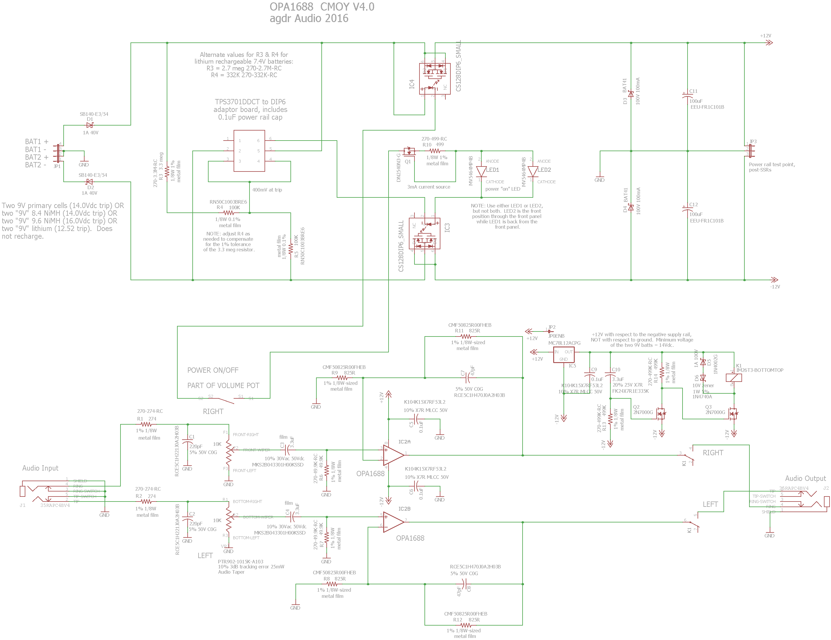

If you put a basic schematic up here I can do some stability checks to confirm the value of the capacitor. The basic concept is to just put a slight dip in the 1/Beta (inverse of the feedback signal) right around the 0dB loop gain point, which gives a little boost in phase margin. Maybe I'll have some free time on a trans-pacific flight to look at it!
Revised schematic posted
Thank you! Any input is appreciated. 🙂 The schematic is posted below in .png and pdf, and also updated at the project Google drive link:
https://drive.google.com/folderview?id=0B67cJELZW-i8b0VRa29ScjFac2M&usp=sharing
then V4.0 -> schematic.
Good timing too, I was about to post an updated schematic. Most of what has changed on the schematic are just cleaninig up the part labels. I believe everything has the manufacturer part number now, but if anyone finds a missing number, label, or value please let me know.
I've swapped the 1N5818 Schottky battery polarity protection diodes for SB140s. Similar thing, the SB140s just offer a bit more for the money.
And as per post #39 and johnc124's input the voltage gain resistor set for the "standard" 2x case shown on the schematic are 825 ohms. The BOM lists the alternate resistor sets for 3x and 4x gain.

For a quick-and-dirty simulation I used a 400pF capacitor as a worst case headphone load. In the gain of 2 case (825 / 825 resistors) I get 50 degrees of phase margin with the 47pF feedback capacitor and 35 degrees without it. I'd recommend you keep it.
You are right! The compensation capacitor forms a filter along with the feedback resistance. The OPA1688 datasheet doesn't have the writeup on it, but the OPA1622 datasheet does on page 24, for the case of balanced inputs from a DAC:
"Capacitors C1 and C2 limit the bandwidth of the circuit to prevent the unnecessary amplification of interfering signals. The maximum value of these capacitors is determined by the limitations on frequency response magnitude deviation detailed in the Design Requirements section. C1 and C2 combine with resistors R2 and R4 toform a pole, as shown in Equation 9:"
fp = 1 / [2*pi*(R2,R4)(C1,C2)]
referring to figure 52 in that datasheet, which is similar to figure 49 in the OPA1688 datasheet. From the discussions in the Vendor forum johnc124 said he had to abandon using the network as an RF filter with the OPA1688, due to the need to keep the cap smaller for stability with capacitive loads. That is why the capacitor is 470pF for the OPA1622, but only 47pF for the OPA1688. Lol, I had to ask about that because I was sure it had to be a typo at first. 🙂 So that is why I've included the RF filter on the front of the CMOY.
So long story short - I agree, with the feedback resistor jumpered to make a voltage follower there wouldn't be any need for that 47pF cap at all.

If I did it again I dont think I would put the led next to the vol pot....with the knob on it the led will be partially blocked. I like the idea of having the led in another place and just wire to it.

Yep, I agree, on seeing your photo I realized that LED in the forward position, through the panel, isn't really going to work. Pretty much needs to either be in the rear position with a small panel hole, or moved somewhere else entirely on leads. Or left off and just jumpered. 🙂

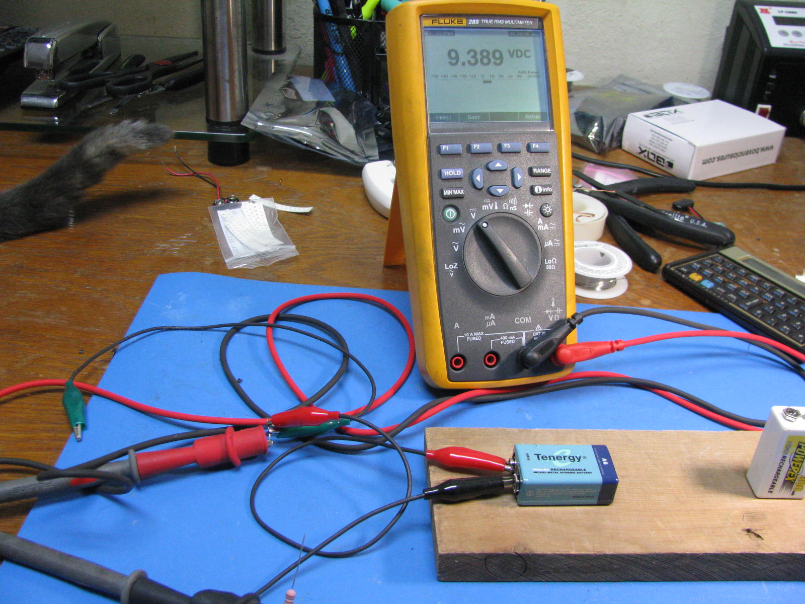

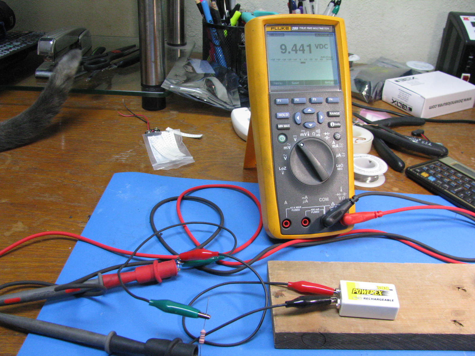

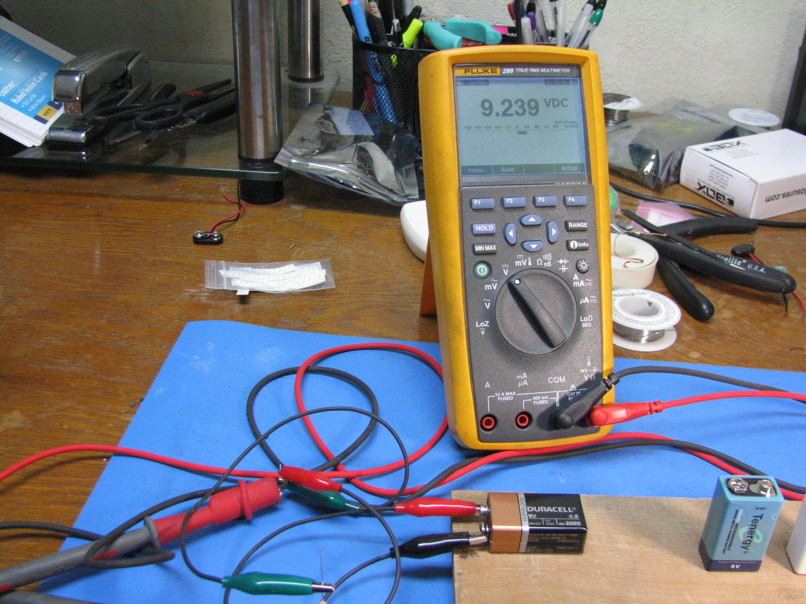

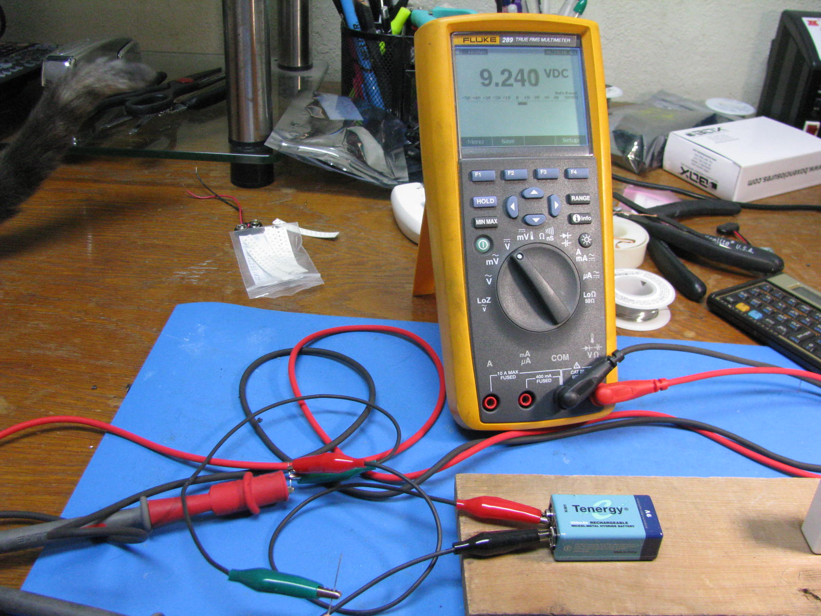

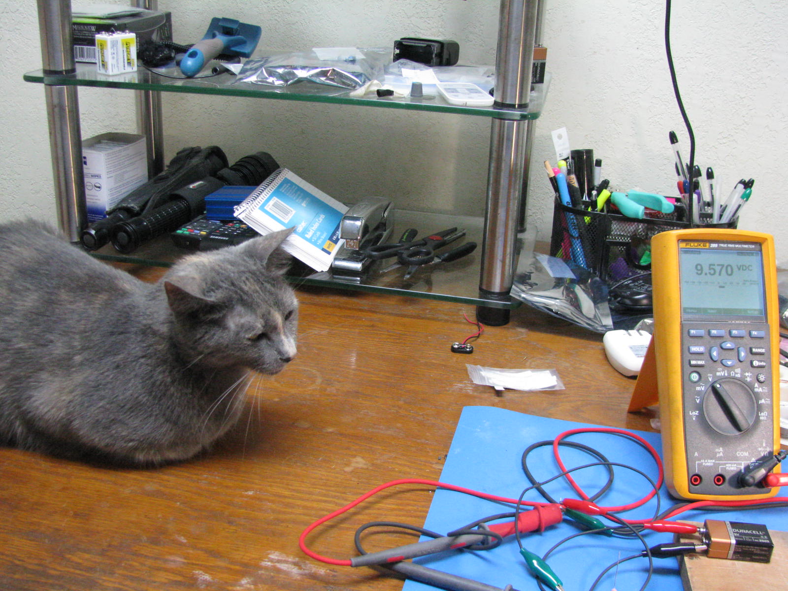

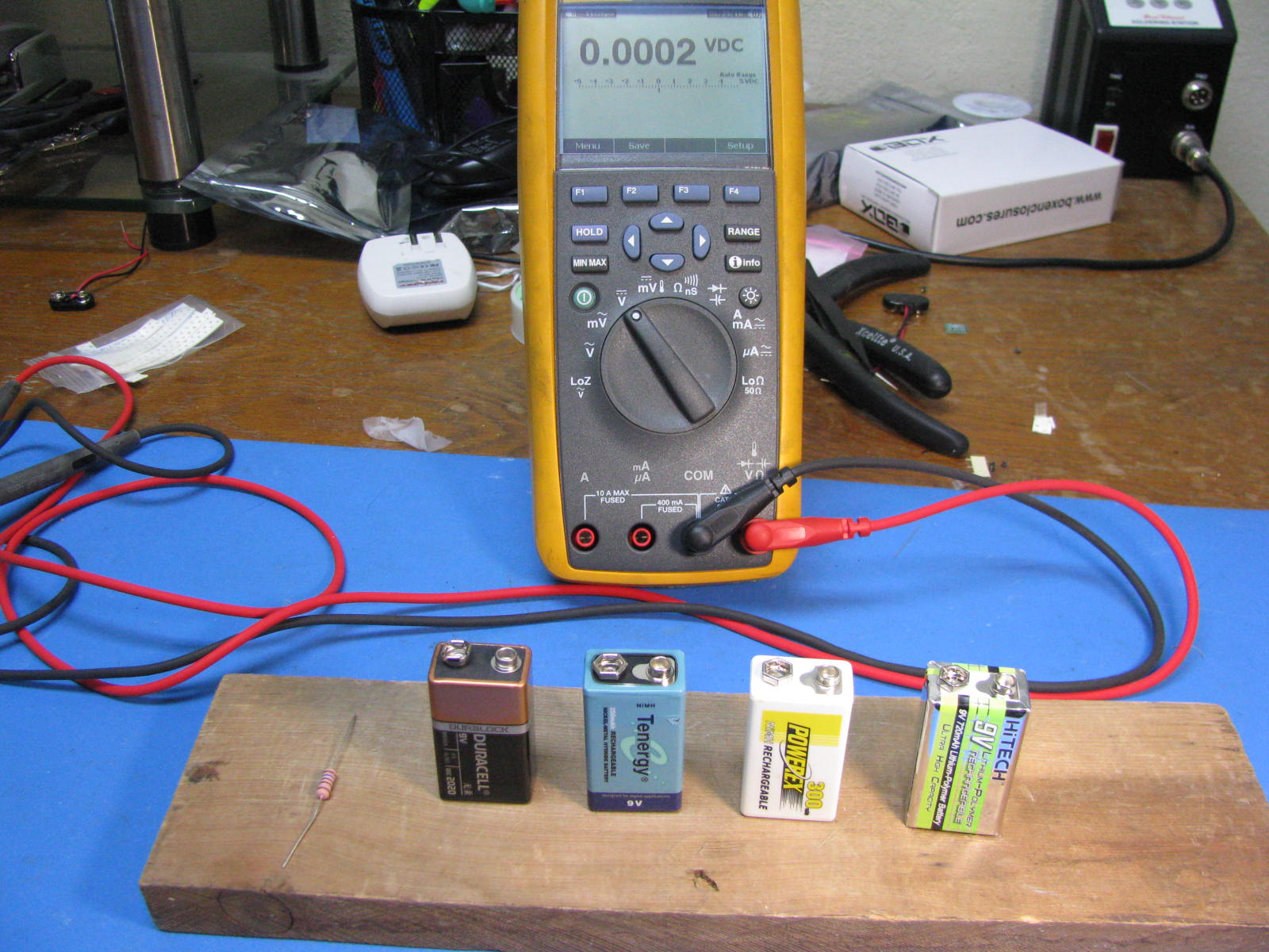

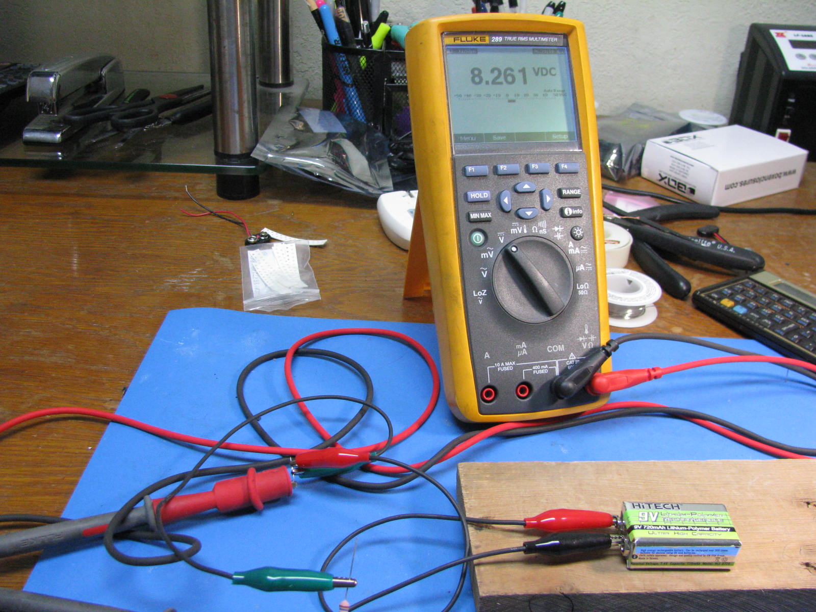

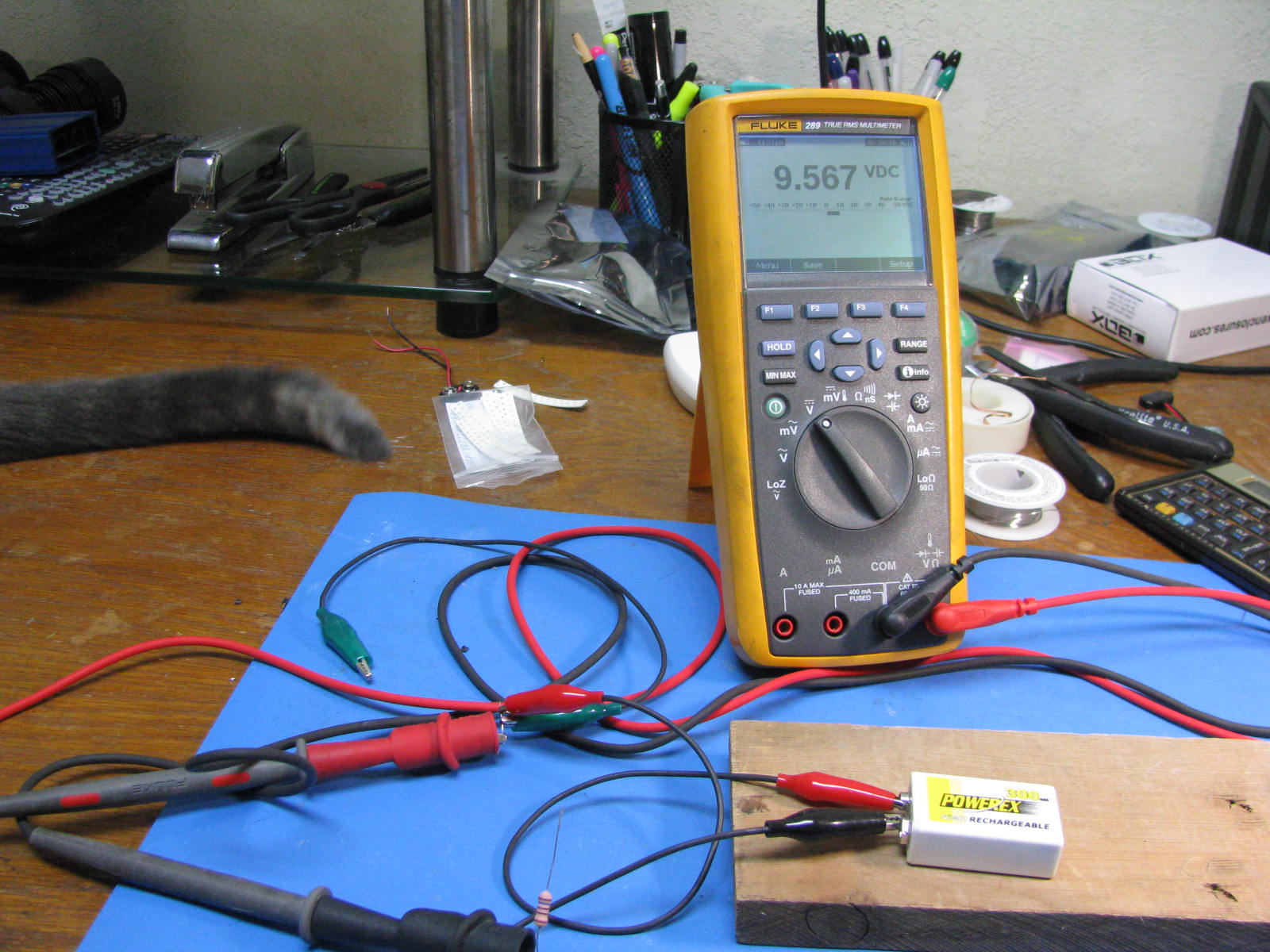

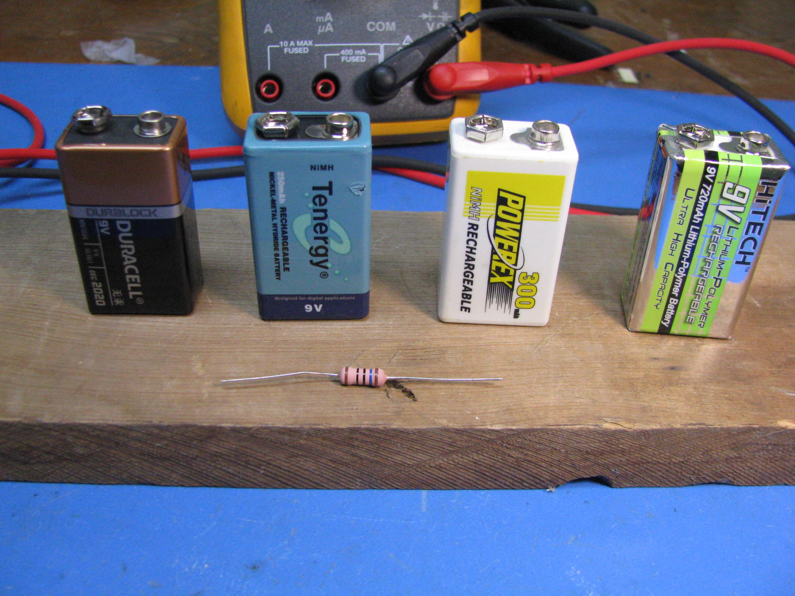

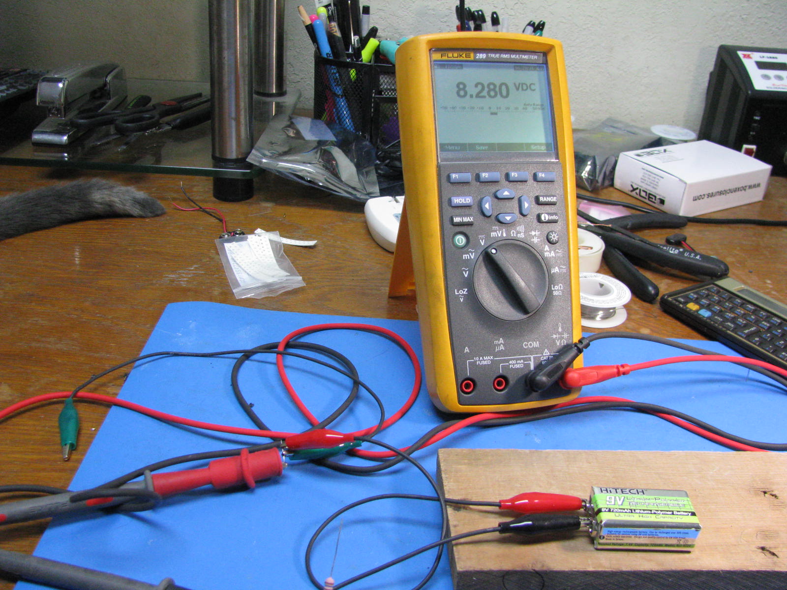

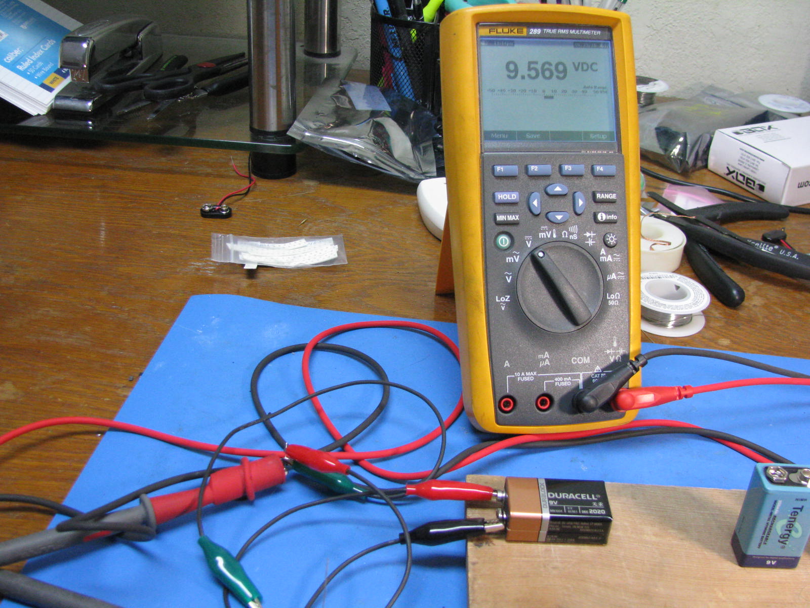

"9V" battery internal resistance shootout: NiMH, lithium, primary - part 1
I had a few minutes so I went ahead and did the "9V" battery internal resistance test discussed in posts above. The results are shocking! 😀 Pun intended, but they really are!
Photos:
* First 3 are the test setup. All the rechargeable batteries here are about 1 hour fresh of their various battery-manufacturer chargers. The primary cell is new right out of the package.
The test candidates are a primary (throw-away) 9V battery, a Tenergy brand "9V" (8.4Vdc nominal 7-cell) 250mAhr NiMH rechargeable battery (same one used in the NwAvGuy O2 headphone amplifier), a maha Powerex brand "9V" (8.4Vdc nominal 7-cell) 300mAhr NiMH rechargeable battery, and a HiTech brand "9V" (7.4Vdc nominal 2-cell) 720mAhr lithium polymer battery. The last 2 are the ones I've linked to in some posts above as recommended. I also have a couple of the maha Powerex 9.6Vdc 230mAhr batterys around here somewhere, but couldn't put my hands on them tonight.

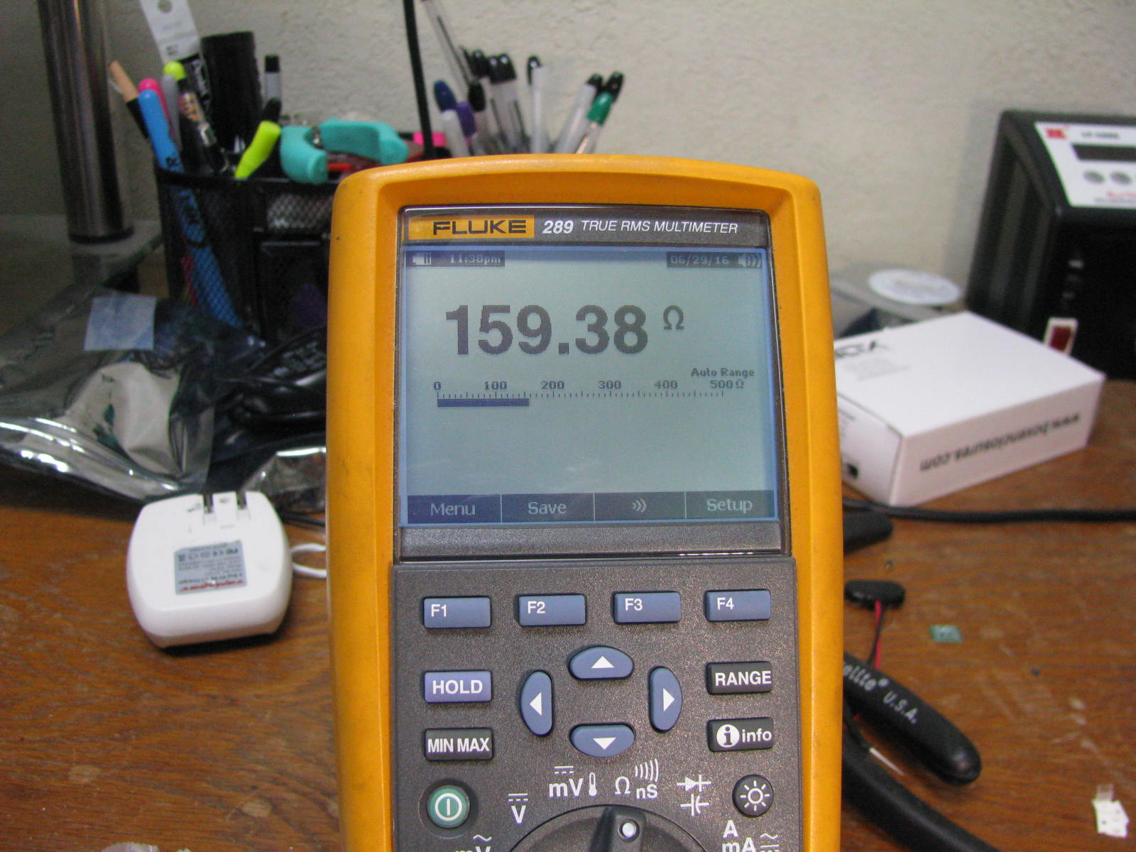

* Next photo is measuring the resistor in the photos above, a 160 ohm 3W, which measures 159.4 ohms
* Next three are measuring the 9V primary battery. The middle photo is why there is a tail in some of the pictures. 😛 The open circuit voltage is 9.57Vdc, the voltage under load is 9.24Vdc. The current through the series setup is 9.24/159.4 = 58mA. The voltage across the internal battery resistance is 9.57 - 9.24 = 0.33Vdc. The internal resistance of the primary battery is 0.33Vdc/58mA = 5.69 ohms. About 5x the amount I always had assumed that primary 9V cells had!
* Next two are measuring the Tenergy brand 8.4V nominal NiMH rechargeable 7-cell battery. The open circuit voltage is 9.39Vdc, the voltage under load is 9.24Vdc (again! strange). The current through the series setup is 9.24/159.4 = 58mA. The voltage across the internal battery resistance is 9.39 - 9.24 = 0.15Vdc. The internal resistance of this rechargeable battery is 0.15Vdc/58mA = 2.59 ohms. About half that of the primary 9V battery.
* Next two are measuring the maha Powerex brand 8.4V nominal NiMH rechargeable 7-cell battery. The open circuit voltage is 9.57Vdc, the voltage under load is 9.44Vdc. The current through the series setup is 9.44/159.4 = 59mA. The voltage across the internal battery resistance is 9.57 - 9.44 = 0.13Vdc. The internal resistance of this rechargeable battery is 0.13Vdc/59mA = 2.20 ohms. Slightly less than the Tenergy version, but still pretty close, which they should be since they are the same NiMH technology. Makes a good double-check on the procedure.
I'm out of photo slots, so part 2 next. That one is the "shocker", the lithium battery!

"9V" battery internal resistance shootout: NiMH, lithium, primary - part 2
Continuing on from above...
* Next two are measuring the HiTech brand 7.4V nominal lithium polymer rechargeable 2-cell 720 mAhr battery. The open circuit voltage is 8.28Vdc, the voltage under load is 8.26Vdc. The current through the series setup is 8.26/159.4 = 51.8mA. The voltage across the internal battery resistance is 8.28 - 8.26 = 0.02Vdc. The internal resistance of this rechargeable battery is 0.02Vdc/51.8mA = 0.386 ohms. WOW!! 😱 That result was so good I repeated the entire test again from scratch and double-checked my wiring. 🙂
Based on this result it looks like it's time to toss the NMH and primary cells into the wastebasket and stock up on lithium! These are lithium polymer. Given this result I'm going to get some of the "9V" lithium ion from the same company and see what they clock in at.
Here is a link to these lithium polymer "9V" batteries (I have no affiliation with this company)
9 Volt Battery Charger for Li-Ion and Li-Poly Batteries - Includes 2 Batteries: BatteryMart.com
The single battery charger they show in that photo is the one I have. They also have a double battery charger set:
2 Bank 9 Volt Battery Charger with 2 Batteries: BatteryMart.com
Discussion: these battery internal resistance results are non-trivial, especially if you have 16 ohm headphones or IEMs! That 5.7 ohms of internal resistance in the primary 9V cell is going to wind up in series with your headphones, forming a signficant voltage divider. This would be true of any CMOY, or other battery powered headphone amplifer (like the NwAvGuy O2 running on batteries!) unless the design has a voltage regulator inserted between the battery and the amplifier. In that case the circuit is looking back into the output resistance of the vreg.
The 2.2 ohms or so of the NiMH "9V" batteries isn't too bad if you are using 32 ohm or higher headphones. Those blue Tenergy NiMH in my tests here are the ones that went out with literally thousands of NwAvGuy O2 headphone amplifiers over the years. With 16 ohm headphones or IEMs you are looking at a 1:8 voltage divider with the NiMH though, which is getting up there.
The 0.386 ohms of the lithium cell is the solution! Even at a 16 ohm load that isn't going to drop a significant amount of voltage.
Thanks goes out to johnc124 for mentioning in one of the vendor forum threads that 9V battery internal resistance might be a lot more than the 1 ohm or so figure I had always heard for throw-away primary cells. Looks like he was correct!
Also - some more information on the resistor I used in these tests, if anyone wants to repeat them. Its a Digikey 160YCT-ND (Yageo FMP200FRF52-160R), flameproof, 160 ohm, 2W (I typoed and wrote 3W in the part 1 post above), metal film, 1%.
