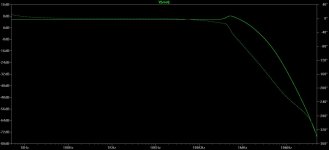

Not sure if I'm interpreting this right (or didn't make a mistake in the simulations...) but it looks like one could actually get away with not using that 47pF cap for 32 Ohm and below headphones. But it does make a difference when things get "worse".
Also, looks like using 1k/1k resistors or 825r/825r makes little if any difference to the phase margin (both combinations give a gain of 2x).
I haven't attached any of the plots, since there's a lot of them. But if anyone's interested in any in particular, let me know.

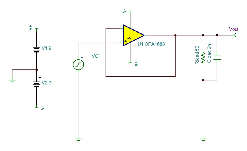

Also, I was curious, what happens if we continue to crank up the load capacitance....
At 330 at 600 Ohms and 2nF, that 47pF cap makes the difference between stable and unstable. Although that margin is so narrow it probably isn't a good idea anyway. I think I tried playing with larger values (220 pF?) for the feedback cap, but they didn't offer much improvement.

I did another round of simulations. This time using a R1 of 2.2kOhm, and an R2 (ie Rf) of 560 Ohm for 1.25x gain. I also added in 50 Ohm and 150 Ohm loads, the former because I have a pair of Sennheisers that have that, and the latter just to fill out the gap.
I do have an LCR meter, but I think I tried hooking it up to my headphones once, it kept jumping around and couldn't give a capacitance reading.

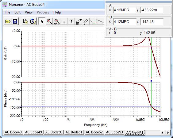

So just for fun, I thought I'd simulate what would happen in a standard 1x gain setup, and the results weren't what I expected. The circuit and results are in the attached images, but what it's showing is a phase margin of 37.5 degrees with no coupling cap!
Which leads me to think one of three things is true:
1) I've made a mistaken assumption somewhere in setting up the simulation. (I don't know what I don't know...)
2) The simulation only goes so far, and doesn't tell the whole story.
3) The phase margin actually is that large for the unity gain case.
Thoughts anyone?

You are looking at the wrong place to start with.
Phase margin has to be measured for open loop gain.

You need to use Middlebrook or Tian methods here. Opamp output impedance is far from being zero, so any simplification will give you a significant error.
NB Simplification could be OK-ish for 16Ohm load variant or for G=+1. You will need to move load to the opamp output and insert an AC source before feedback divider/inverting input. In such case Zout||Zload << Zdiv, so it should not give you a huge error.
NBNB It all makes sense only if opamp model has a fair representation of Zout. It is pointless trying to find a phase margin if your model is wrong.

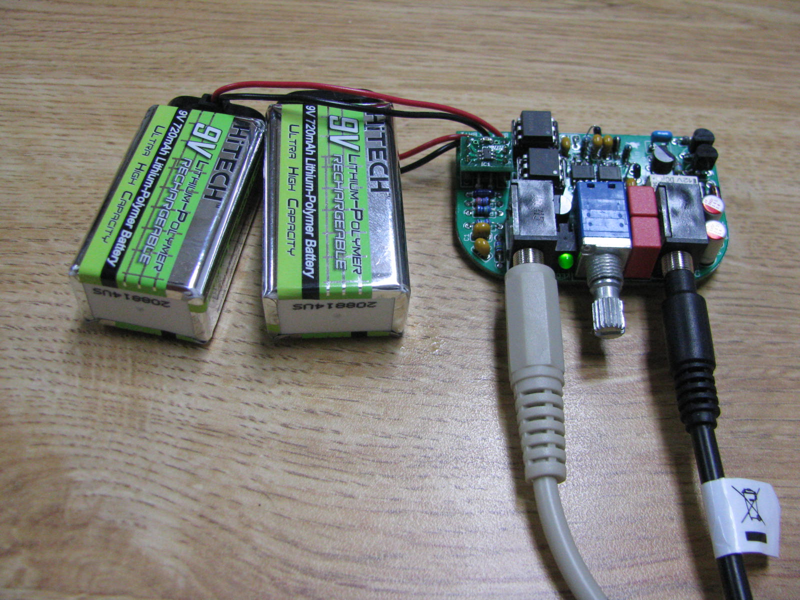

Also, my boards arrived yesterday. I'll probably hold off on soldering for a bit since I haven't had a chance to simulate that resistor combo properly. Also, I might want to drop those values a bit too. Having a 2.2k resistor there might be a bit much.

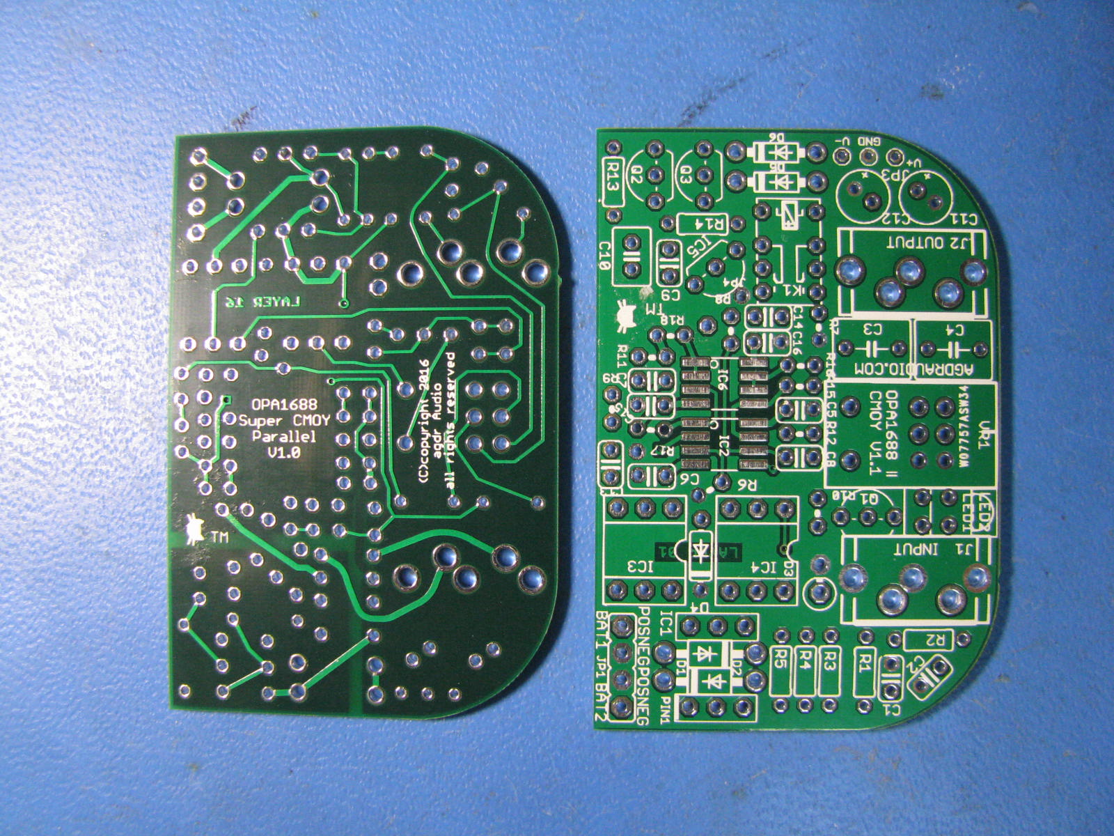

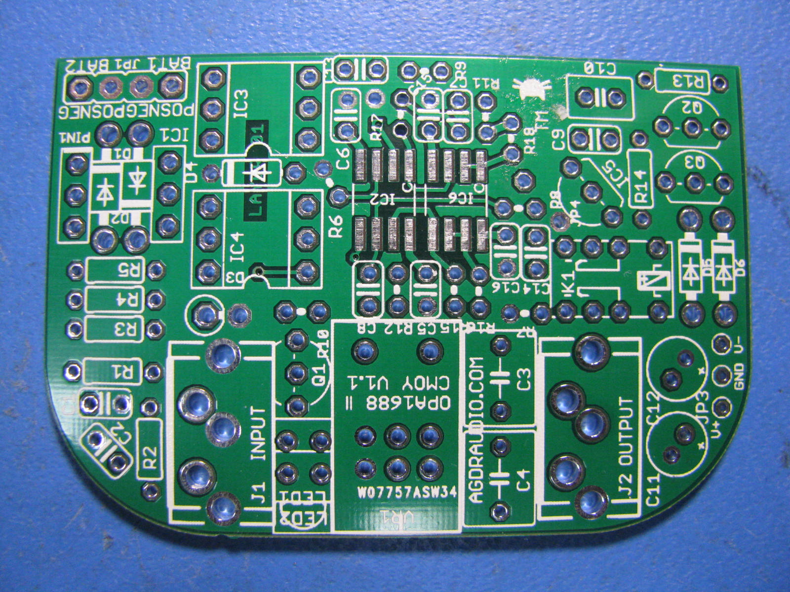

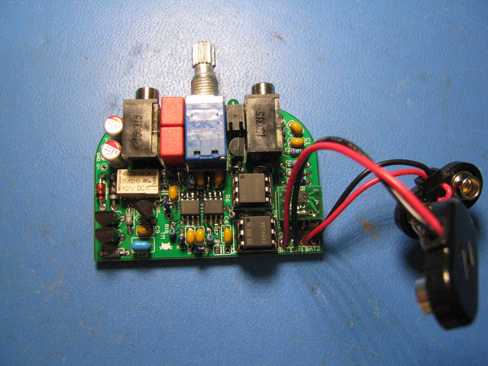

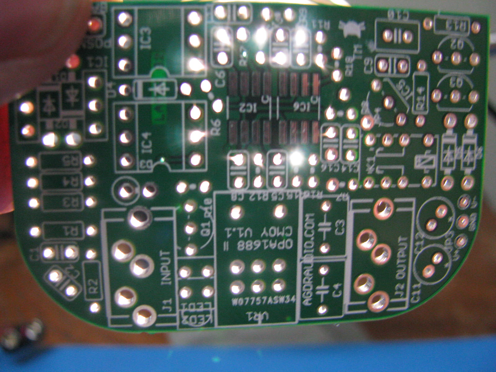

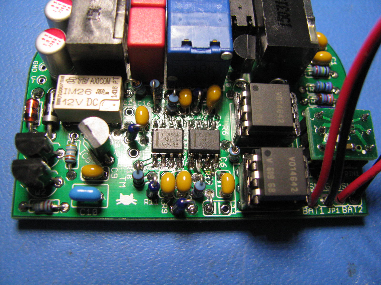

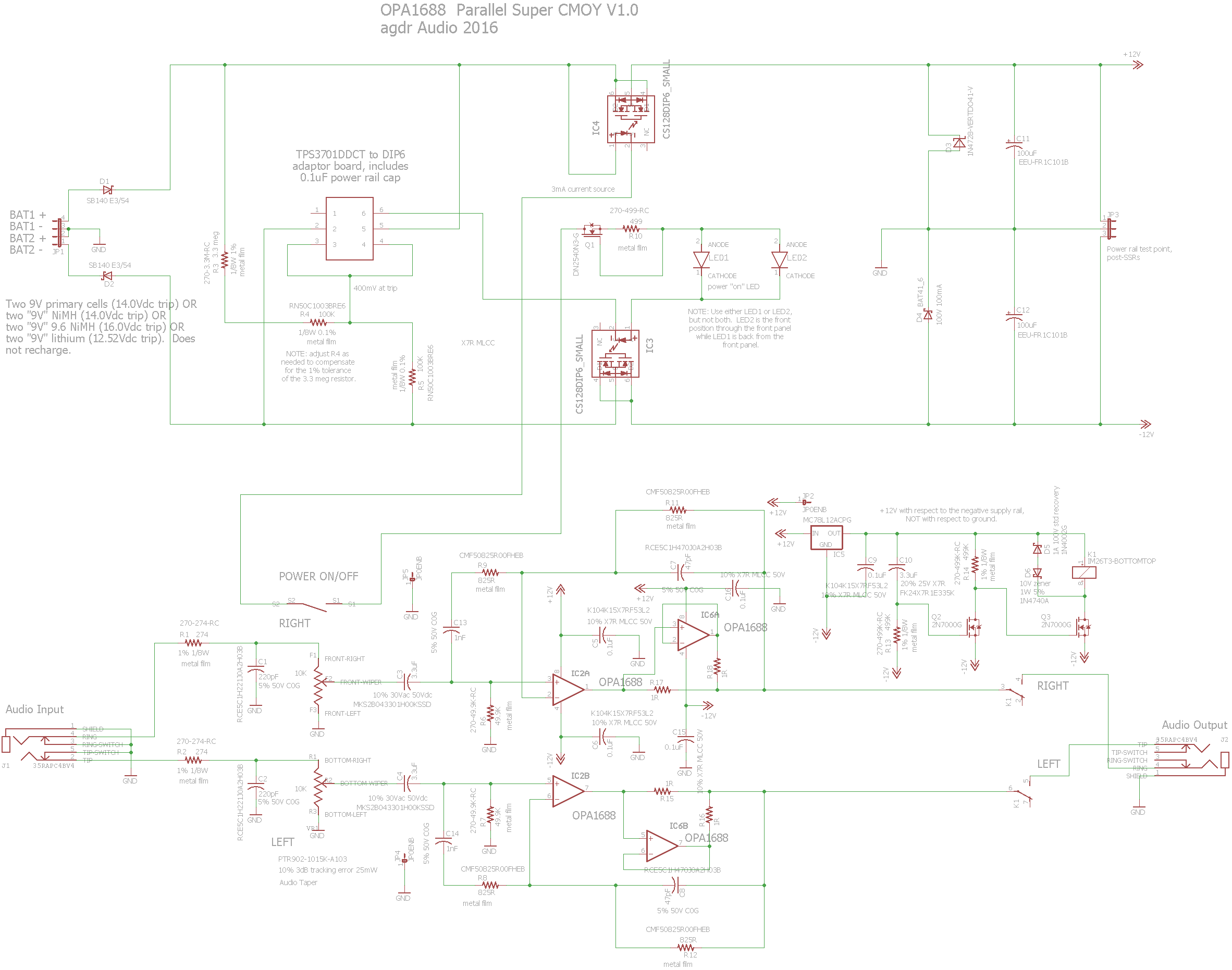

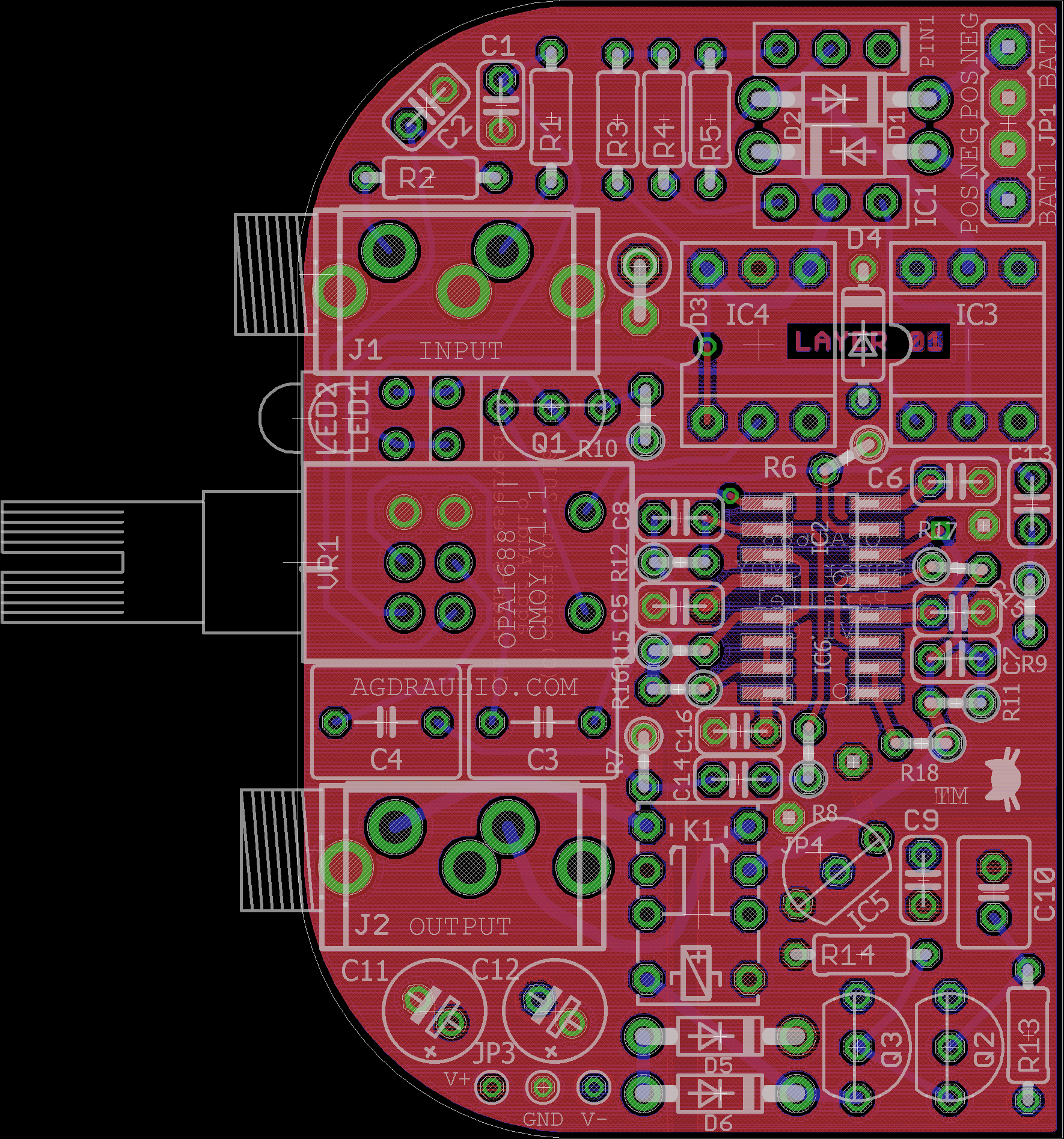

Parallel Super CMOY with two OPA1688 chips!
Here is a much bigger stability challenge. 😀
I really didn't think it would be possible to fit two OPA1688s on the tiny Super CMOY board (the quad OPA1689 isn't a shipping product yet). I've been messing with various things as time permitted. I've discovered that end-mounting (tombstoning) a bunch of the resistors freed up enough board space to fit on the two chips and the two new 1 ohm balancing resistors on each channel. I'm using the Intersil method of op-amp balancing on this one (figure 1):
http://www.intersil.com/content/dam/Intersil/documents/an11/an1111.pdf (opens PDF)
I've wanted to try this method for awhile. jcx was the one who first pointed me to that paper a few years ago. Up until now I've used the same method NwAvGuy did in the O2 headamp for balancing, with each op amp's input driven in parallel and the outputs balanced. This Intersil method simulates with very good results in LT Spice for the OPA1688. Shows the load current drive doubling, just as expected.
The only difference between this board and the V4.1 Super CMOY board are the additional OPA1688, the two 1R balancing resistors on each channel, and the two new decoupling caps for the second chip along with a bunch of parts end-mounted this time. I did put pads for the optional 1nf compensation capacitor back to the input for the 1x gain case on the outer loop, but didn't for the inner unity gain loop. Lol, well see how that goes. 🙂 Might be needed in both places for the best phase margin. Or not, having the capacitor on the inner loop might do some unexpected things to stability.
At any rate the board went out to fabrication last night. With any luck I'll be able to build one up next week and see if this thing is going to work!
Clicking on the arrows in the lower left corner will zoom these up...

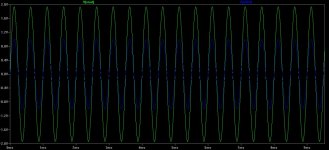

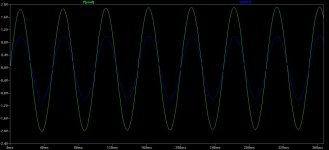

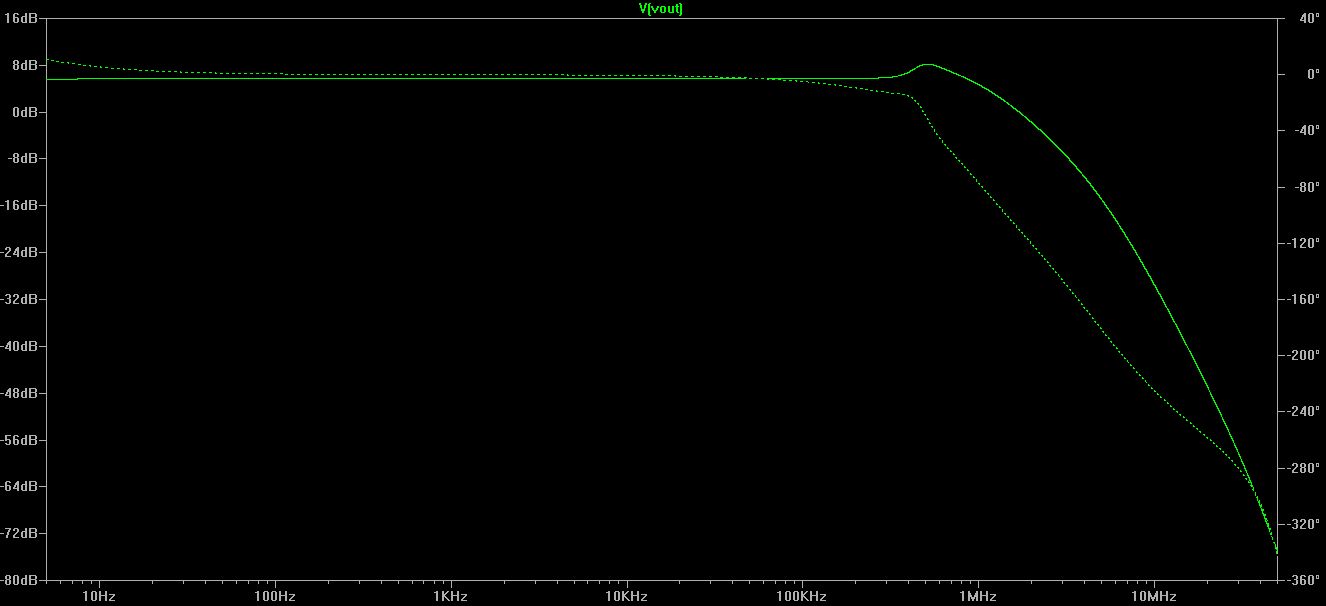

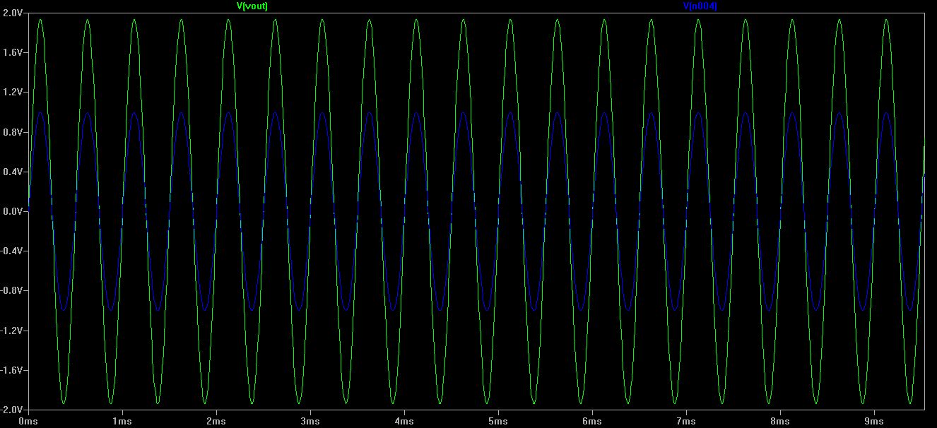

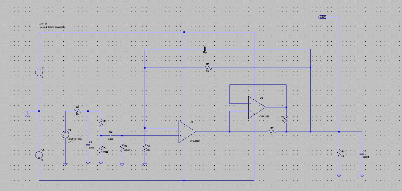

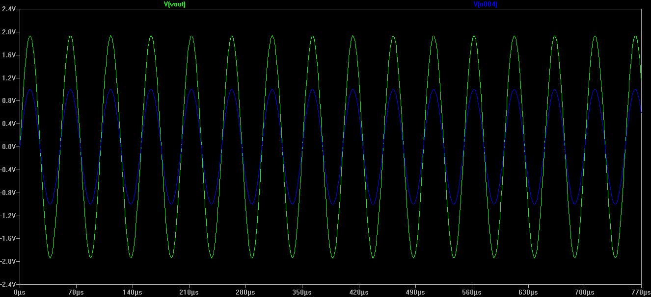

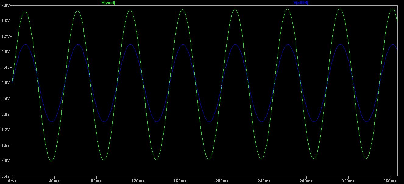

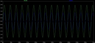

Parallel OPA1688 CMOY LTSpice sim
Speaking of LTSpice... here is the sim for one channel of the parallel OPA1688 Super CMOY in post #112 above, set up for 2x voltage gain.
Schematic, AC plot, and then transient plots for 20Hz, 2KHz, and 20KHz. All of this is with a 32 ohm 1000pF load! Blue is input and green output on the transient plots.
One interesting thing is the 100mV DC shift at 20Hz that doesn't show up at the higher frequencies. I'm also seeing a bit of waveform distortion about 1/3 of the way down from the peaks. I'm assuming these are simulation artifacts, but we'll see what the real circuit does. The simulation started up quickly but ran rather slowly, which always means Spice is battling something in the numbers. In general Spice has a harder time with nested op-amps. I was surprised it was able to quickly find the DC operating point, given the nest. I've often had to set forced node initial conditions on nested active elements to get Spice to converge on various circuits.
As that Intersil paper notes this particular nested arrangement should be OK at audio frequencies, but the delay through the first stage would become a problem at higher frequencies.
I'll be quite curious to see how this circuit tests in real life. Putting output resistors inside a feedback loop like this can cause some fun stability things to happen. NwAvGuy addressed it in a comment on one of his blog posts where he was ragging on AMB's mini^3 (and amp I like, BTW!). The mini^3 has an output resistor in the feed back loop. He says:
"Putting a resistor in the feedback loop actually makes stability worse than no resistor at all. With reactive loads, the voltage drop across the resistor will be out of phase with the output of the amplifier. That creates unwelcome phase shift in the feedback signal. And that's all that separates an amplifier from an oscillator. It's generally poor engineering practice unless the resistor is absolutely required for some other reason or only pure resistive loads are used (which rules out nearly all headphones).
The resistor also tends to increase distortion into low impedance loads as it's creating relatively massive feedback error signals under those conditions."

I just received the boards back from fabrication for the parallel OPA1688 Super CMOY, post #112 above. It works! Nailed the layout the first time. Sounds fantastic. 😀
In addition to doubling the output current and capacitive drive, the paralleled chips act to spread the chip power dissipation over a larger area.
I'll be curious to see the THD+N plots vs. the single OPA1688. Also measuring it with heavier capacitive loads. I built it up with 2x voltage gain and 1 ohm output balancing resistors, so 0.5 ohm output impedance on each channel. The output DC offset measured at 250 microvolts on one channel and 210uV on the other. The headphone relay circuit still works perfectly. Zero turn-on or turn-off thumps.
Photos:
* First 3 photos are the bare board. For the 3rd I had a bit of a laugh holding it up to the light. Looks like a piece of Swiss cheese now with all the holes.
* The next 2 show the completed build with all the end-mounted resistors and one end-mounted diode.
* And the final shot is powered up and doing its thing. 🙂 I'm using the lithium polymer "9V" cells here.
Remember that clicking on the arrows in the lower left corner zoom these up.

Simple questions
You can enlighten me some questions?
As both channels are identical, I will refer only to the left channel, but serves for both, of course.
1 - The capacitor C4, also form a high pass filter with the resistor R7. It has the function to maintain a stable input impedance of the op-amp?
2 - The R7 resistor, low value would be less prone to noise? (Something around 4k7 to 22k)
Or it is necessary to be close to 50k to prevent oscillations as in the image below.
*You know tell me why is this oscillation as in this picture?
