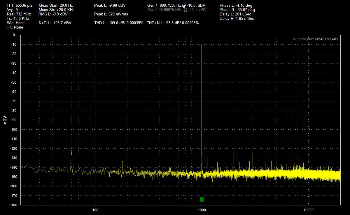

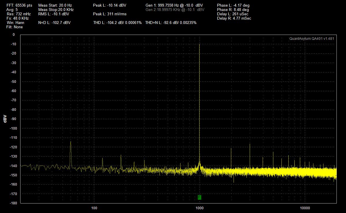

Parallel Super CMOY THD+N tests! part 1
I finally had some time this evening to run THD+N tests on the Parallel Super CMOY with the 2 OPA1688 chips. In summary: Nice! 😀
Compare these results with those in post #87 & #88, where I tested the single OPA1688 Super CMOY with 15/33/150 ohm loads. Especially interesting is that last two plots in post #88 back then with -1dBV input and the 15R load, where I didn't realize I was exceeding the maximum current output of the chip and measured, of course, high levels of distortion. That would have been 85mA through the 75mA maximum per channel chip. But here no such problem with -1dBV into 15R! With the two OPA1688's in parallel the maximum output current at low THD should be roughly double, 150mA per channel. In fact I doubled-down on that and ramped it up to +1dBV with the 15R load and all is still fine.
I'm only using the lithium polymer batteries here since those tests in posts #87 & #88 showed there was no significant measured difference between the lithium batteries with the 0.3 ohm internal resistance and the throw-way 9V batteries with the 5 ohms. I've also used just 15 ohm and 150 ohm loads here in the tests, no 33 ohms, to simplify things.
One of the results here is that having the second parallel OPA1688 in the "Intersil" parallel chip configuration (datasheet linked post #112 above) seems to produce no negative effects at all, at least that I can see, yet does produce the expected positive benefit of double the output current drive. If anyone spots anything in these plots that would indicate problems with that issue of delay through the first OPA1688 chip in the "Intersil" configuration, please post! 🙂 I've used 1 ohm output balancing resistors in this build, so 0.5 ohm output resistance of the amp looking back into the output port.
Plots:
* The first 3 are all with -10dBV input at 1KHz and 48Ksps sample rate. The first is loopback of the QA401 tester showing its inherent 2nd and 3rd harmonics that have to be subtracted out of the results. Then the Parallel Super CMOY with a 150 ohm load and 15 ohm load. When those nearly -125dBV 2nd and 3rd harmonics from the tester are taken into account the results here look great.
* The next 3 are the same as above but with a -1dBV input and output rather than -10dBV. loopback, 150 ohm load and 15 ohm load. Again compare the 15 ohm load result with the last two plots on post #90! 🙂 Same deal, if you subtract out the now nearly -105dBV tester's harmonics from the result these look just fantastic to me, especially given that 15R load.
* The next 3 are the same as above but with a +1dBV input and output rather than -1dBV. loopback, 150 ohm load and 15 ohm load. Still doing great with a 15R load! Lol, try that with a OPA2134 based CMOY. More great results if the tester harmonics are taken into account. I did a "little finger" subjective chip heating test after the measurements. Both chips were warm, as expected, but not excessively so.

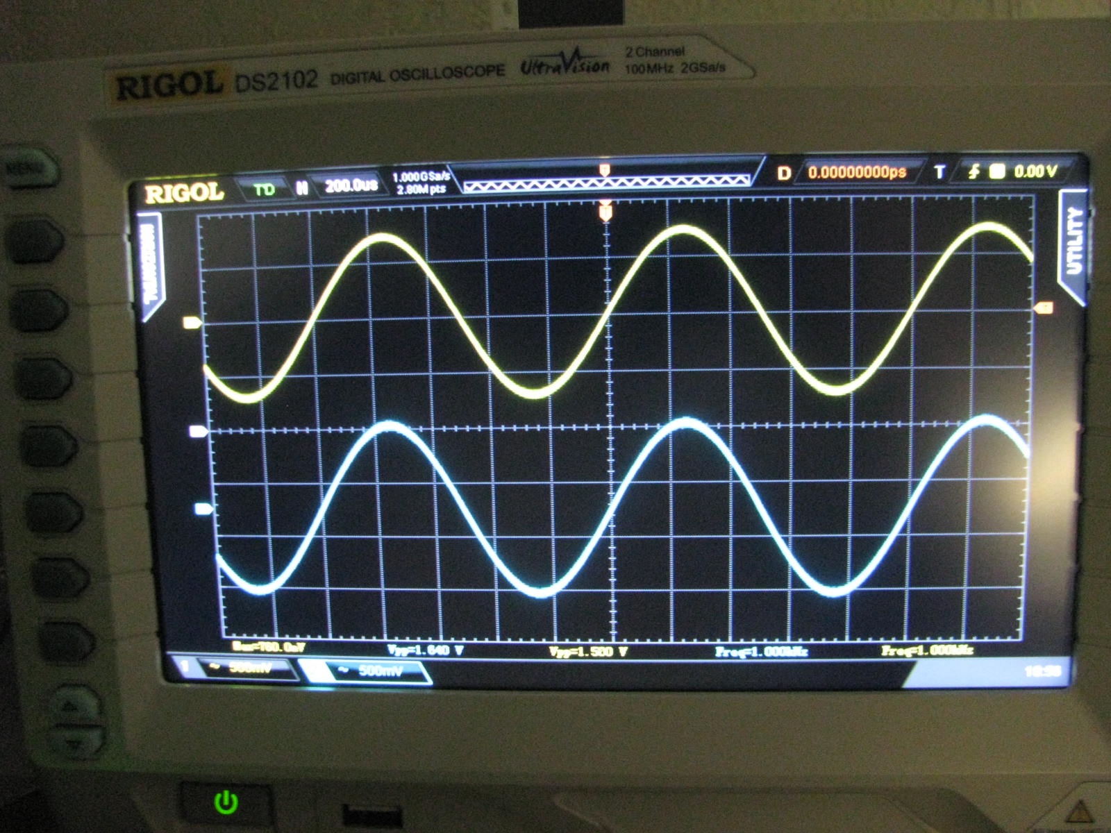

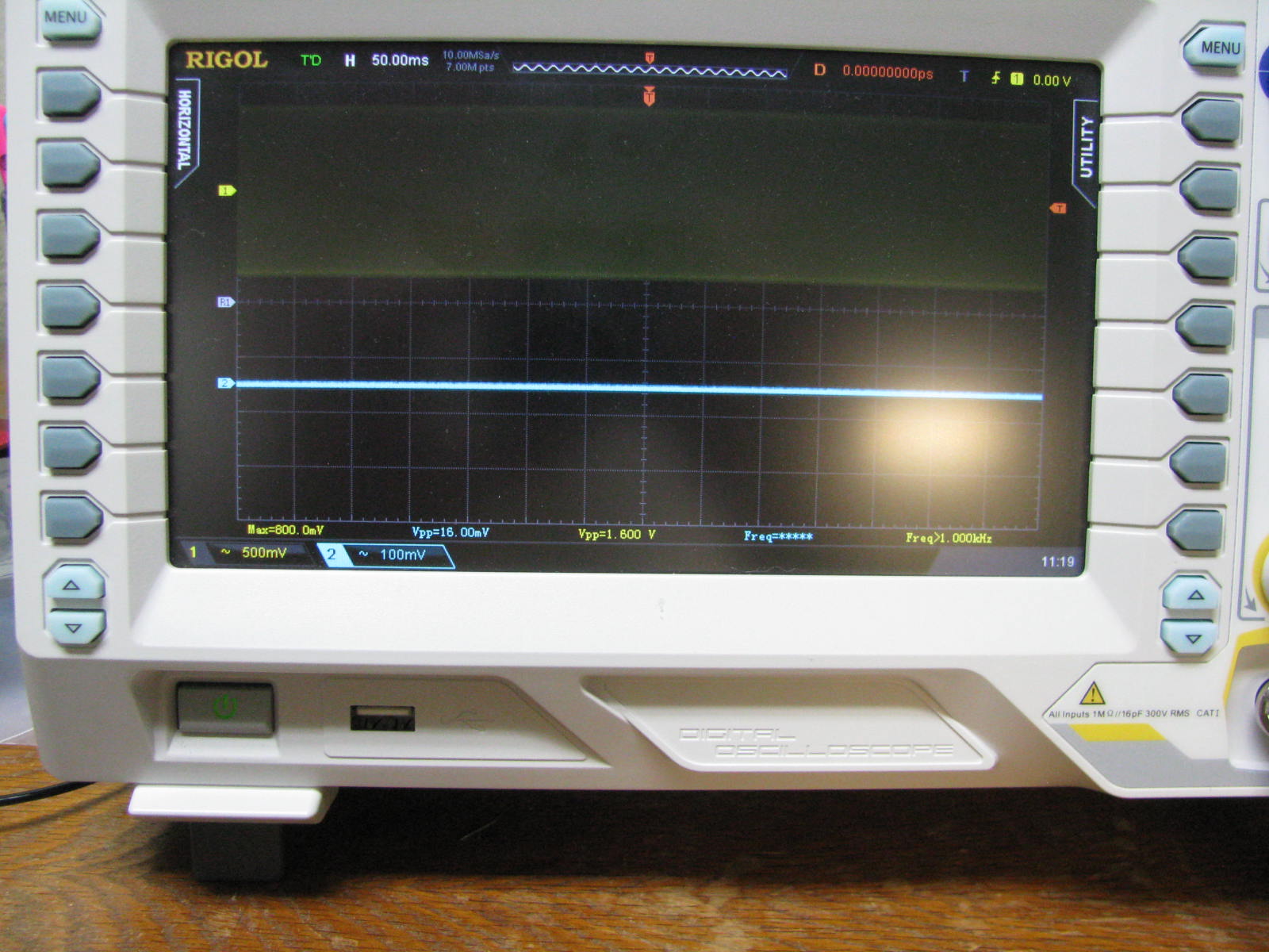

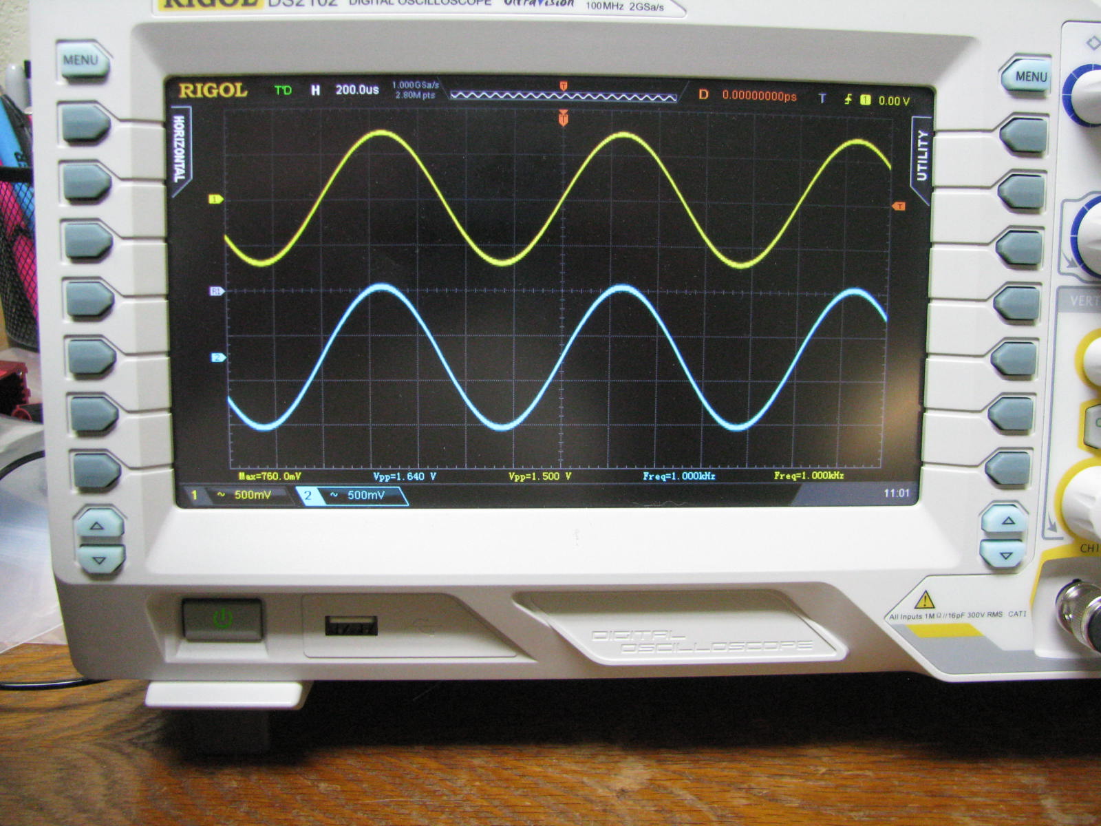

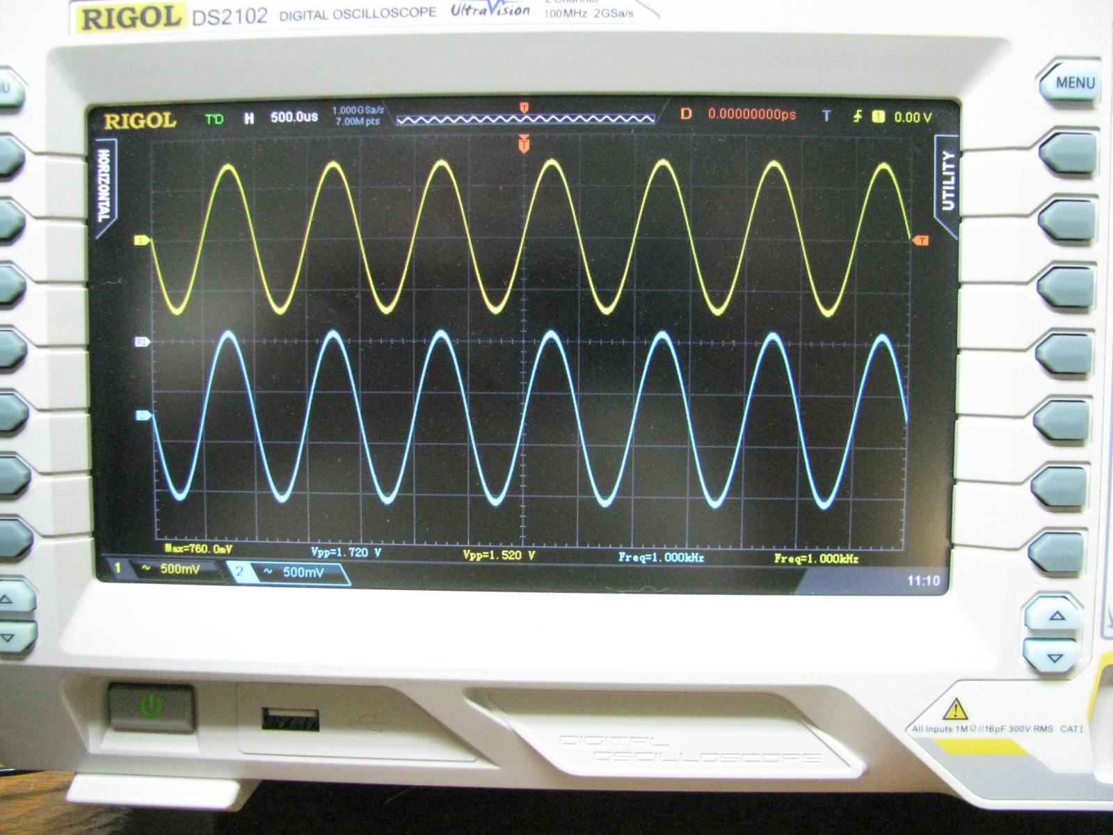

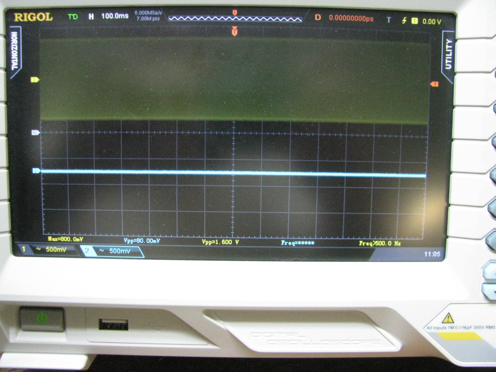

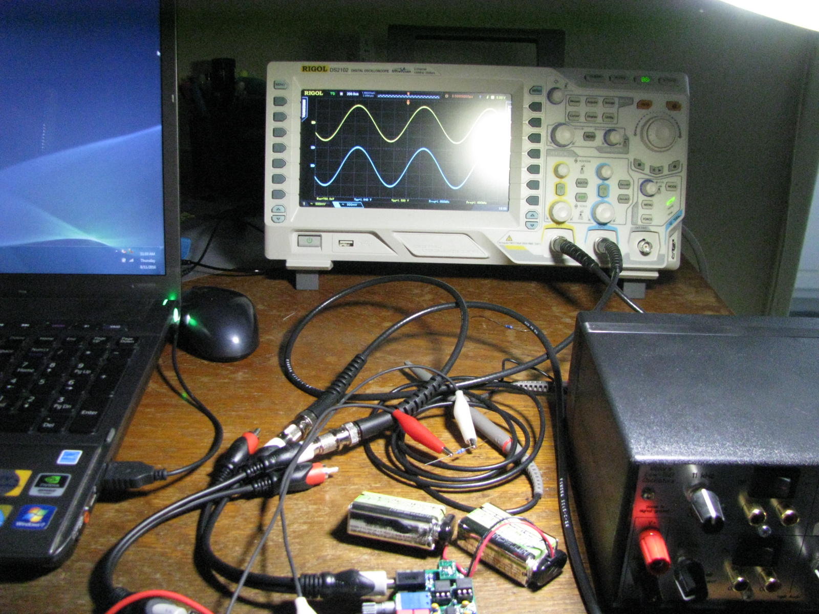

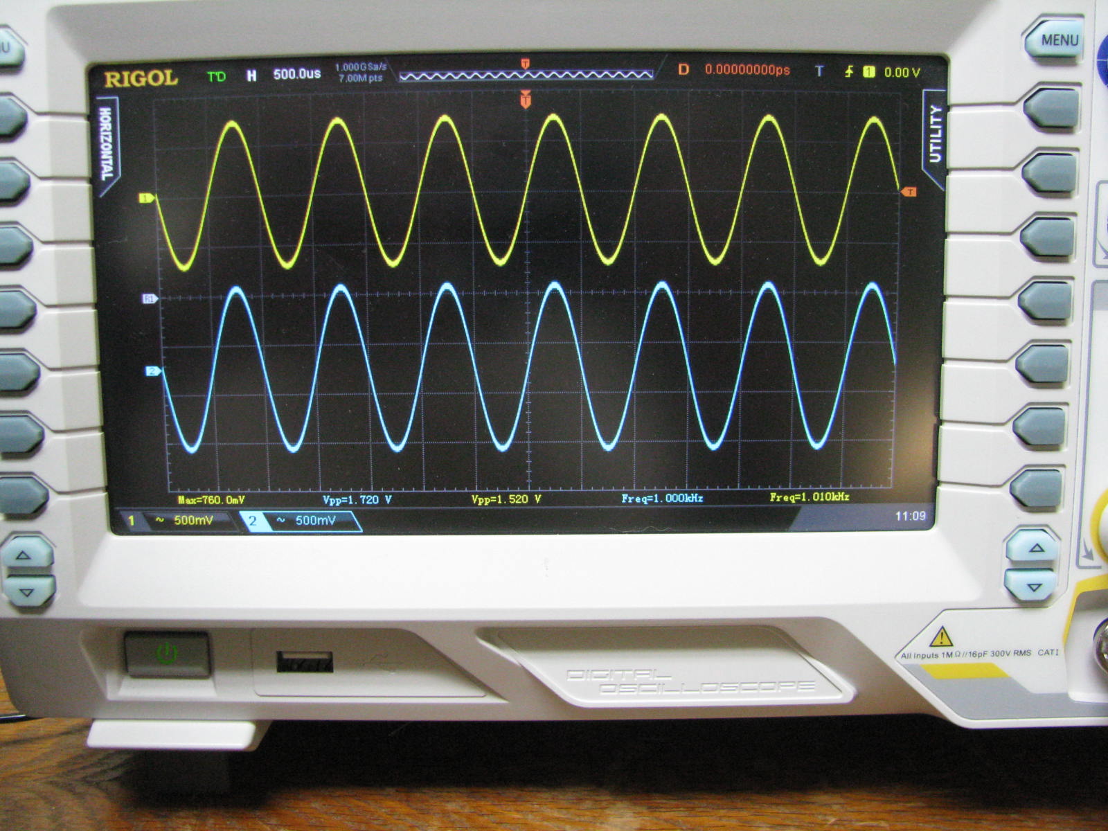

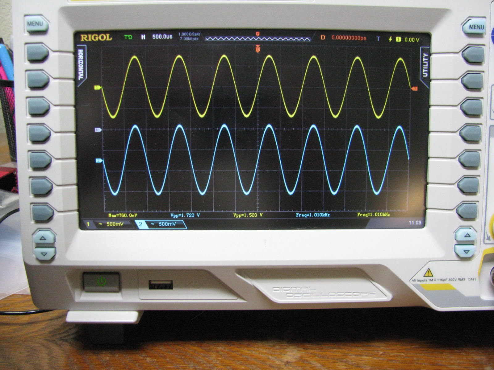

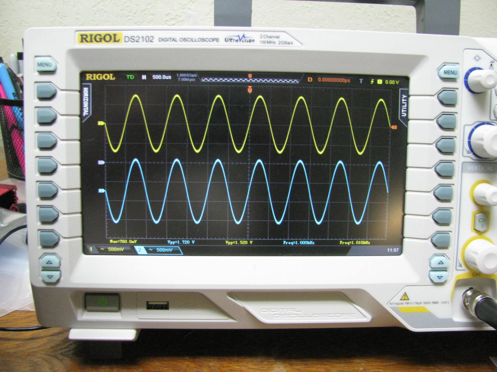

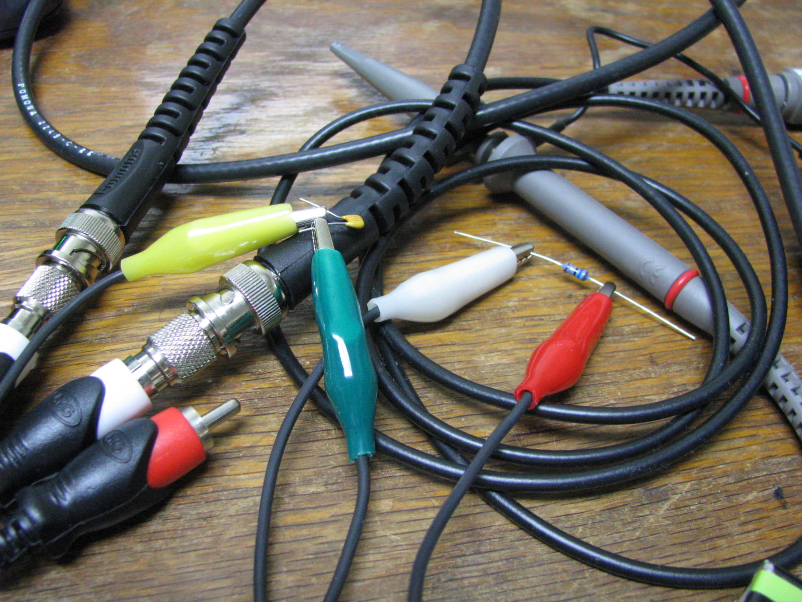

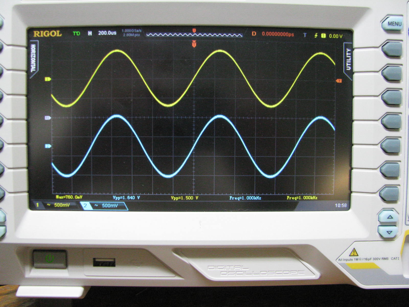

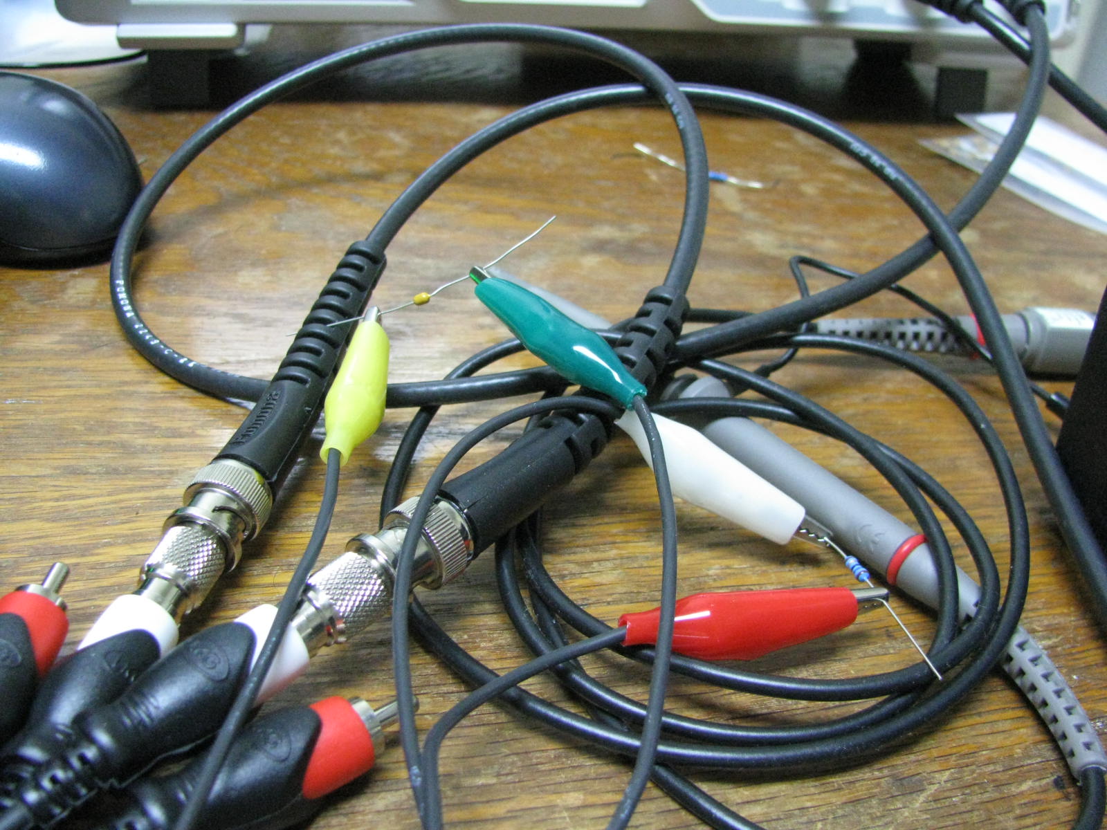

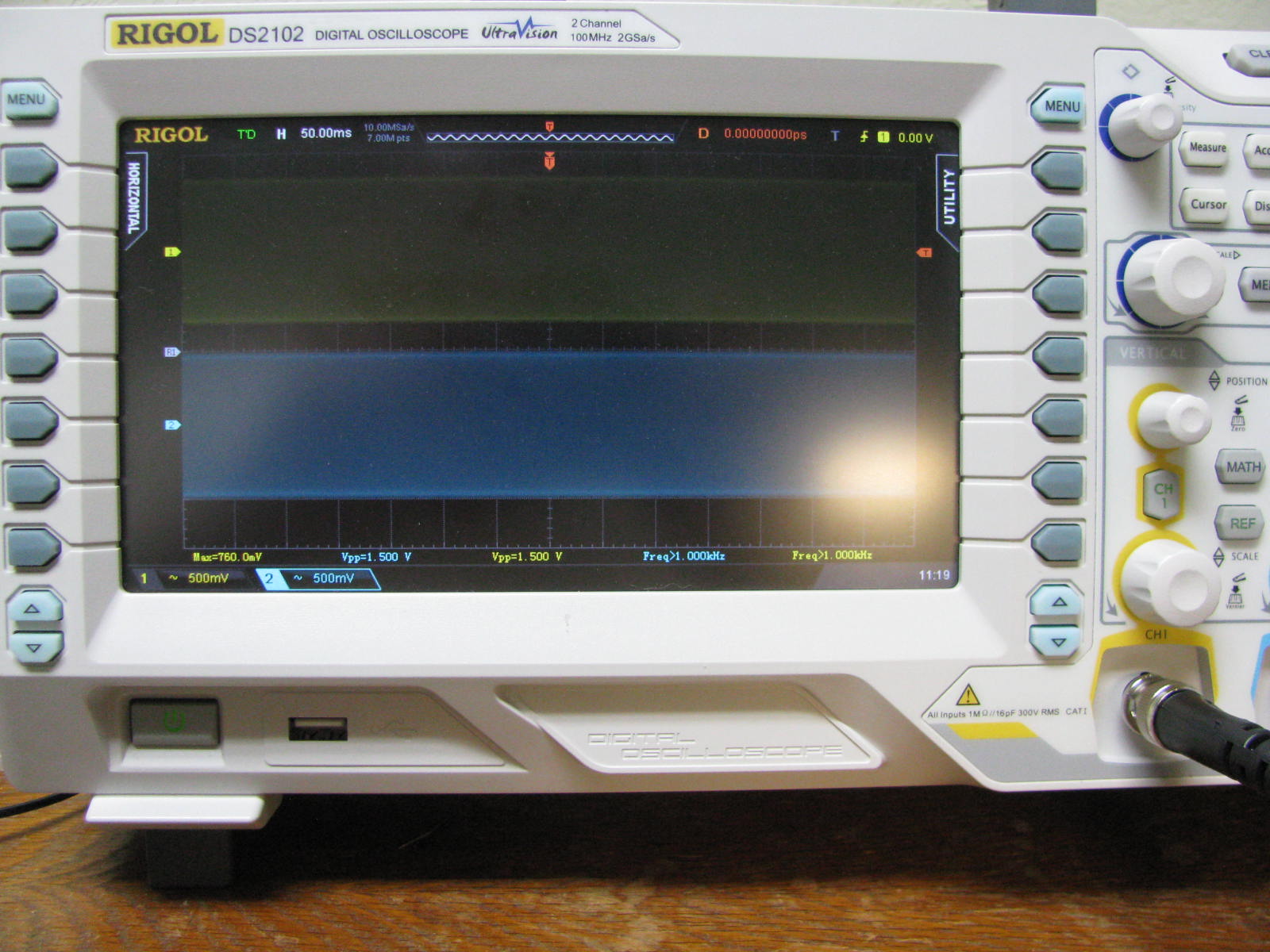

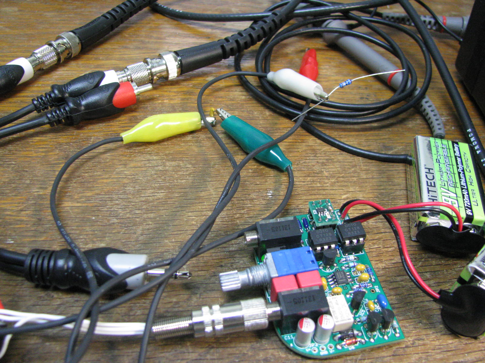

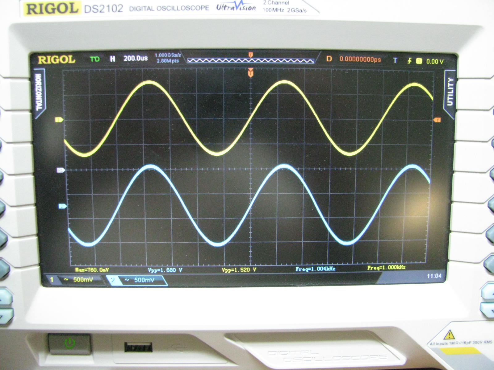

C-load testing: single and double stable with 2.2nF load! Part 1
I did the capacitive load testing on both the single and double (parallel) OPA1688 Super CMOYs today and what a surprise - in a good way - BOTH are completely stable with a 2.2nF (= 0.0022uF) load with both 16 ohm and 150 ohm resistances! Both of the Super CMOYs tested were built up with 2x voltage gain.
But gets even better. 😀 As a double check on the test procedure I unhooked the resistive load entirely on both amps, leaving the CMOY to power the purely reactive capacitive load. They *should* oscillate, of course, at some level of purely capacitive load as the phase margin shrinks. The test capacitors are all C0G MLCC ceramic, very little ESR. Sure enough, both oscillated with a 2.2uF purely capacitive load, as expected, although the parallel not nearly as much as the single chip (details and plots below).
But guess what? The parallel Super CMOY is completely stable with a 1nF purely capacitive load!😱 That is just fricking amazing. Good work TI and johnc124 for the compensation capacitor tips in the datasheet. I'm equally amazed that both the single and double chip Super CMOYs are stable at 2.2uF with the resistive loads.
DETAILS
* The first photo below is the test setup. That is a Victor low-THD 1KHz oscillator feeding the (double chip parallel) Super CMOY (yellow trace on the scope). The output of the Super CMOY is the blue trace, with the two test clips holding the load resistor. When I start adding the capacitor I have a second set of test clips. The clips themselves will add a bit of capacitance to the load, of course. An argument could be made that the inductance of the test leads might partially isolate the test capacitance at the end, but that would also be true then of real headphone cables, which is what this whole effort is modelling.
* The next plot is with a 1.5Vp-p (about 1Vrms) input signal and 16 ohm purely resistive load. No load capacitor yet.
* Next is the same as above but with a parallel 470pF output load added. No visible change or oscillation. I was expecting just this much capacitance to be stable.
* Next photo and plot are now with 16R + 1nF in the test clips. The photo is just to show the test setup. That is an axial 1nF C0G MLCC cap. Again zero oscillation. I didn't show it here but I ran the scope time base up and increased the sensitivity looking for higher frequency oscillation. Just nothing.
* Next photo is same as the above, but now with the 2.2nf cap. So 16R + 2.2nF. No oscillation! The third scope shot is with the time base run up looking for higher frequency stuff. I didn't take a photo but I ran the sensitivity up to 10mV at one point. No oscillations.

* The next 3 show the test setup and results for 2.2uF C0G MLCC. Just the 150R load is shown here, but I tried it with both the 16R and 150R. No oscillations! The 3rd photo just shows the time base on the scope run up with the input signal still applied. The 4th is with the input signal to the amp removed.
The final two here are now with the purely capacitve load, resistor removed, which is *expected* to oscillate - and does! The whole point of these tests is a double-check on my test methods here. If the amp didn't oscillate at some fairly heavy level of output purely-capacitive load like this, something would be wrong.
* Here the 2.2nF capacitor is still across the Super CMOY output (single chip amp still) but notice the load resistor is unclipped from a test lead. Purely reactive load, and the results don't dissapoint. Oscillation, as expected.
Next up are the same tests as above in part 1, but now with a 150 ohm resistor instead of 16 ohm. These test are still with the Parallel dual-chip Super CMOY
* 150 ohm purely resistive, with no load capacitor yet.
* 150 ohm + 470pF
* 150 ohm + 1nF
* 150 ohm + 2.2nF
The next set of tests are with a single chip Super CMOY. I skipped right to the 2.2nf load case here since it the the most likely to oscillate.
