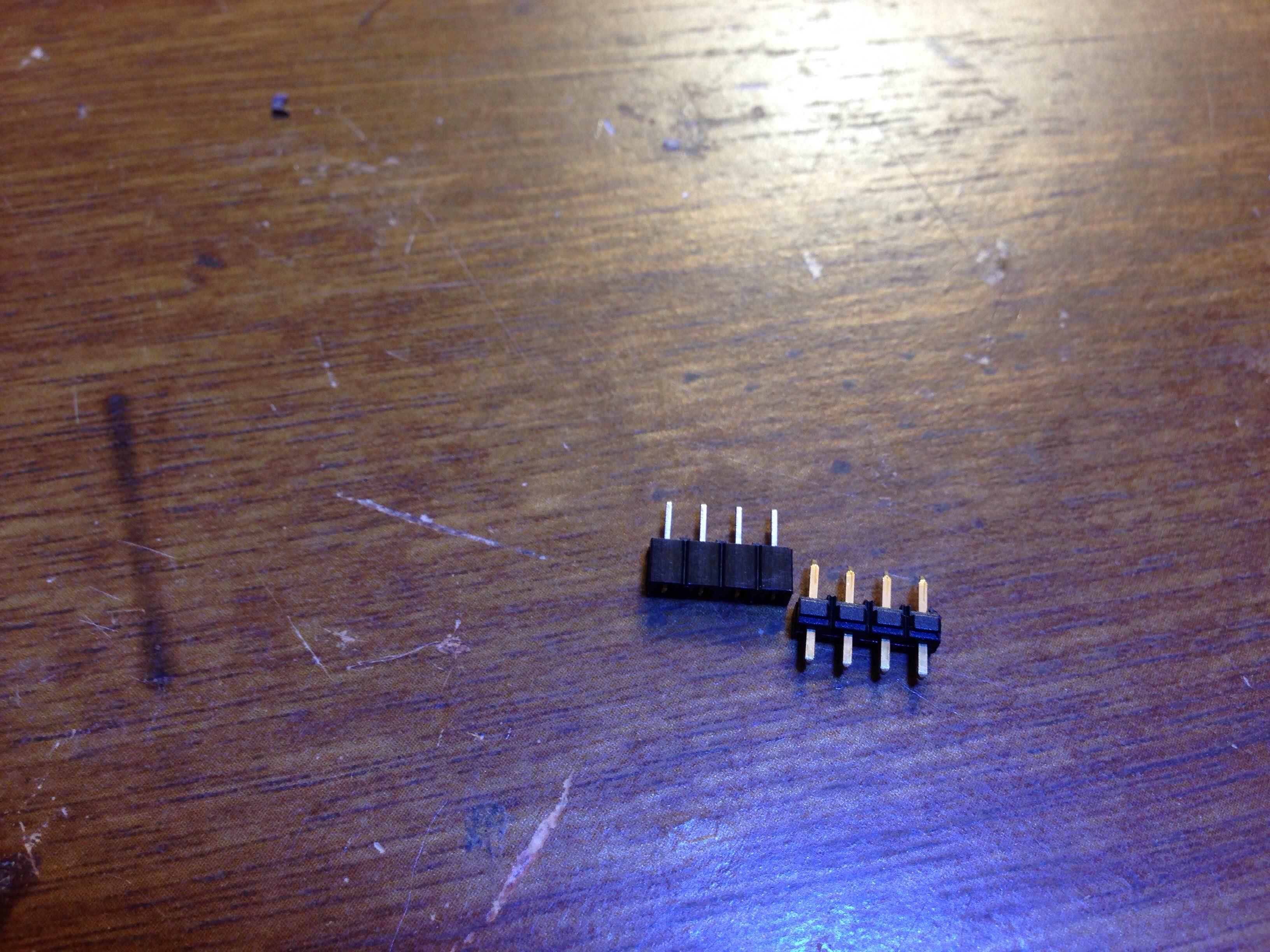

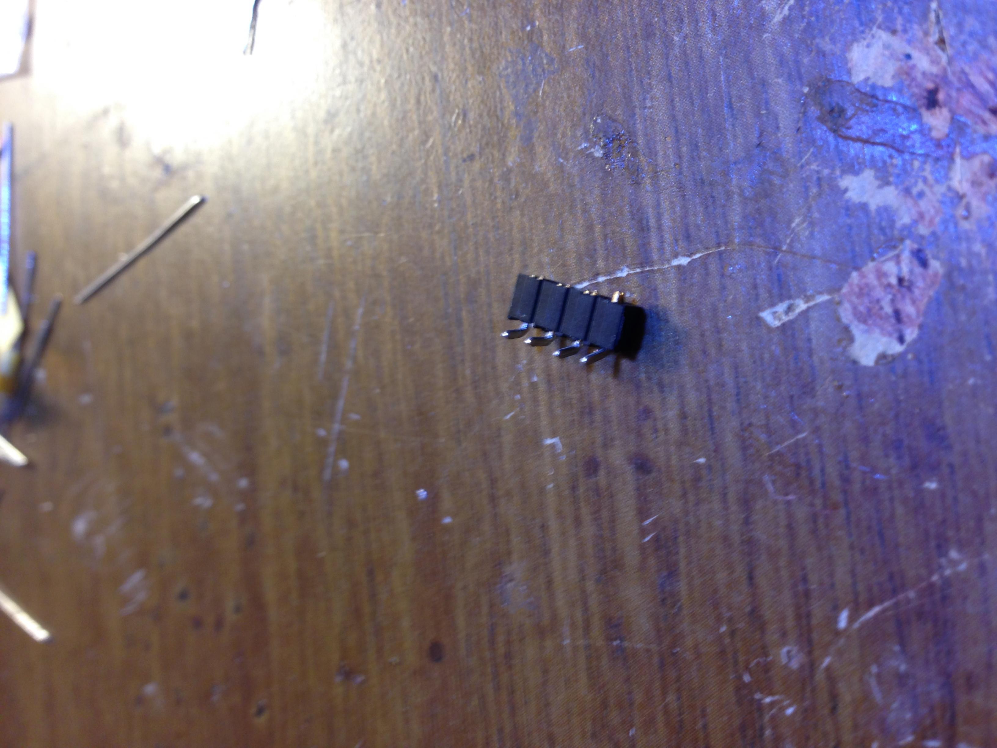

So while getting parts to build up a 2nd super cmoy(I broke the first one), I decided to look into the idea of a battery header. I haven't tested these in a board yet(still waiting on my pcb to arrive, USPS is holding it hostage), but I'm pretty sure they will work with one modification. The are MFG part # 929870-01-04-RA for the sockets and MFG part #929805-01-04-I for the header that go with them. You can see a picture of them in the first photo. The socket is only 5 mm high when placed in the pcb! The header is a little higher at 8.5 mm, but with a simple mod(bending the pins to right angles), they can be reduced to 6 or so mm. I'm thinking about soldering my battery wires to the header and shrink wrapping it to provide support.
Hmm..that sound like a good idea to me! The battery connector isnt the greatest mechanical assembly. Let us know how it goes with some pix installed in the altoids tin can etc.
Good find! My original intent was to use a header and socket for the battery wires, but I couldn't find any short enough to fit. The maximum vertical space is the height of those 3.5mm jacks, around 12mm. The PCB holes are spaced 0.1" for a header. Looks like you may have found a "low profile" one that would work! Please post a photo when you get it wired up.

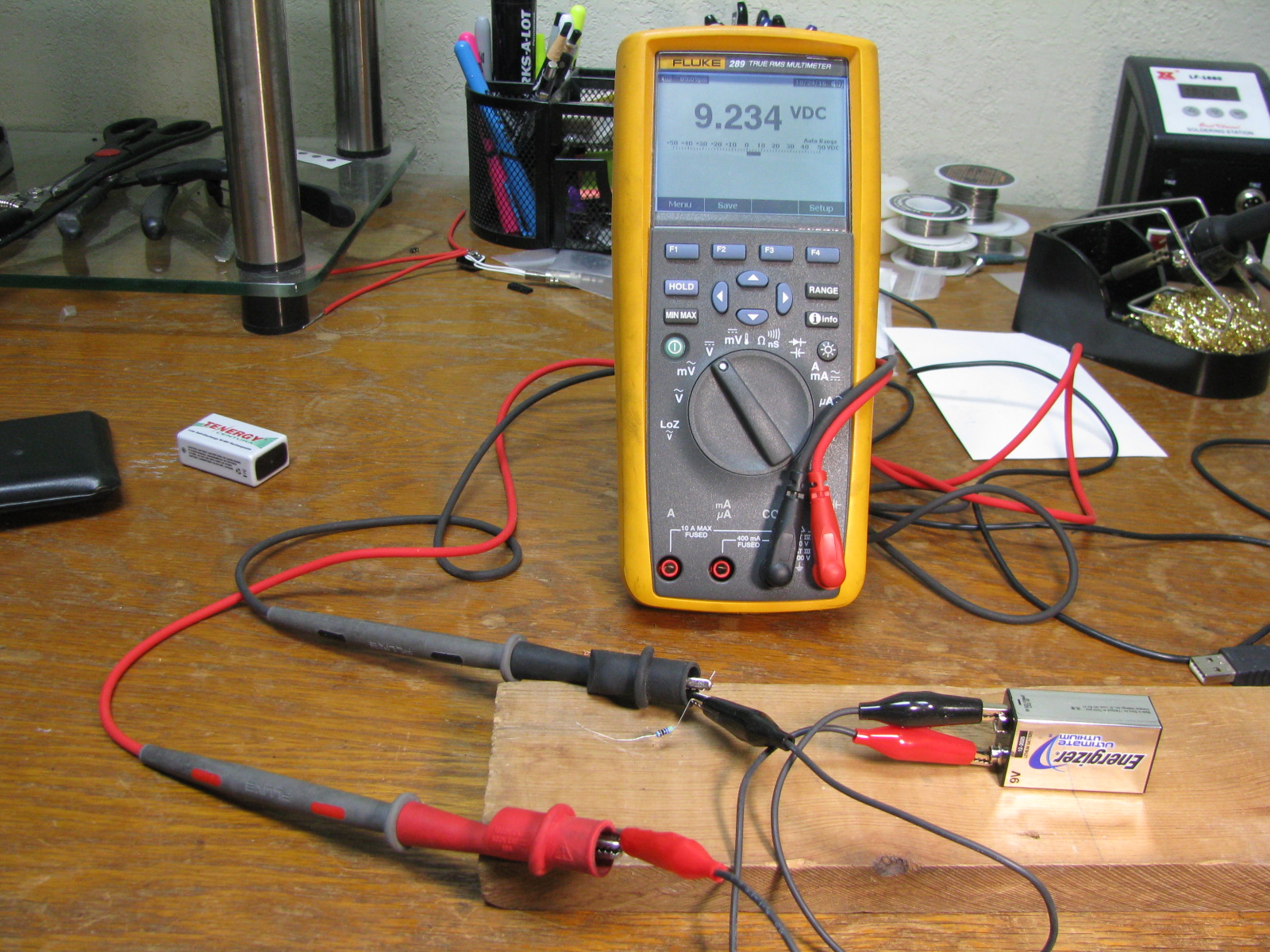

"9V" battery internal resistance shootout: NiMH, lithium, primary - part 3

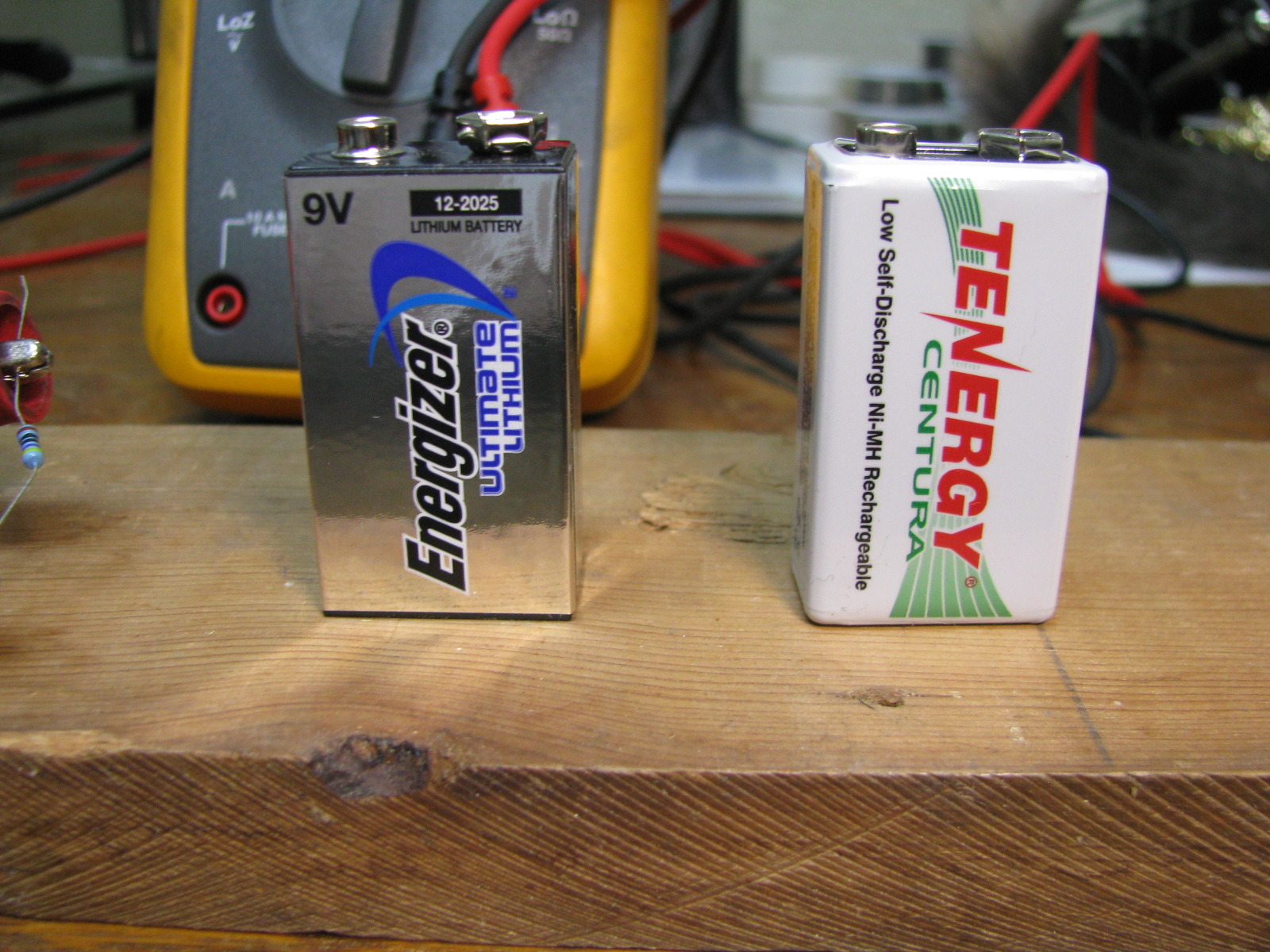

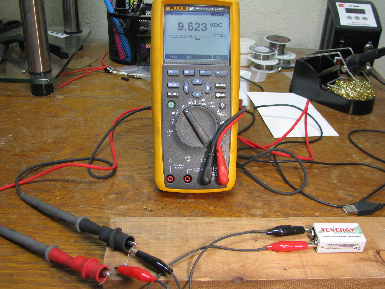

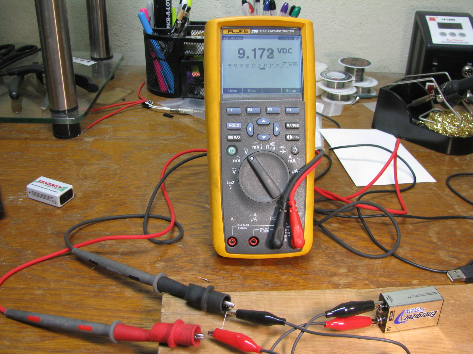

Continuing on from posts #59 and #60, internal resistance tests on a couple more types of "9V" batteries.
One is a 9V primary cell (non-rechargeable). I see these advertised a lot for "10 year life in smoke detectors". Right off the bat that says to me "low current capability".
The other is the "low self discharge" cousin to the standard Tenergy "9V" (8.4V nominal) NiMH rechargeable often used in the O2 headamp. This type will stay charged much longer on the shelf, unused, but I've also expected that to mean trouble in terms of current capability.
I tried using the same 160R resistor I used in the previous tests, but the voltage under load on either battery did not stabilize well and continued to drop. That implies the 60mA discharge rate is too great for the batteries, which matches up with what I was expecting. I switched to using a 470 ohm (meaures 475R) to drop the discharge rate to 20mA. Still continues to drop at 20mA, but the rate of drop is much less than at 60mA.
Photos:
* first two are the test setup, with the two batteries and 475R resistor
* Next two are the open circuit voltage (9.681Vdc) and load voltage (9.623Vdc) for the low self discharge NiMH. Going through the math in post #59 comes up with an internal resistance of 2.9 ohms.
* And the final two are open circuit voltage (9.234V) and load voltage (9.172Vdc) for the primary lithium 9V. This one comes up with an internal resistance of 3.2 ohms.
The lithium polymer rechargeable "9V" from the previous tests has both of these beat by a mile! There wasn't any rapid voltage drop even with the load of 60mA attached. No problems handling high load currents, plus the 0.4 ohm or so internal resistance.

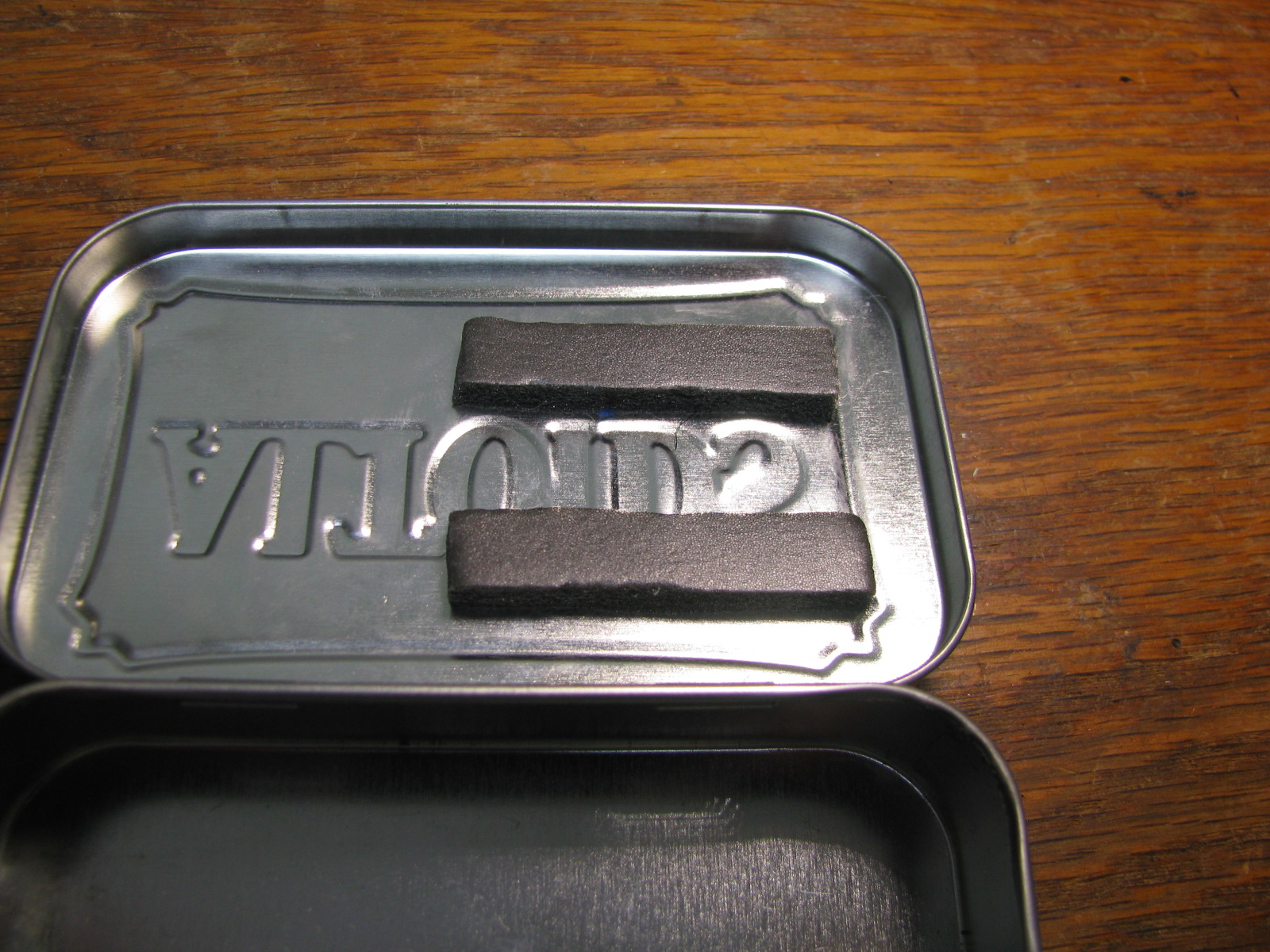

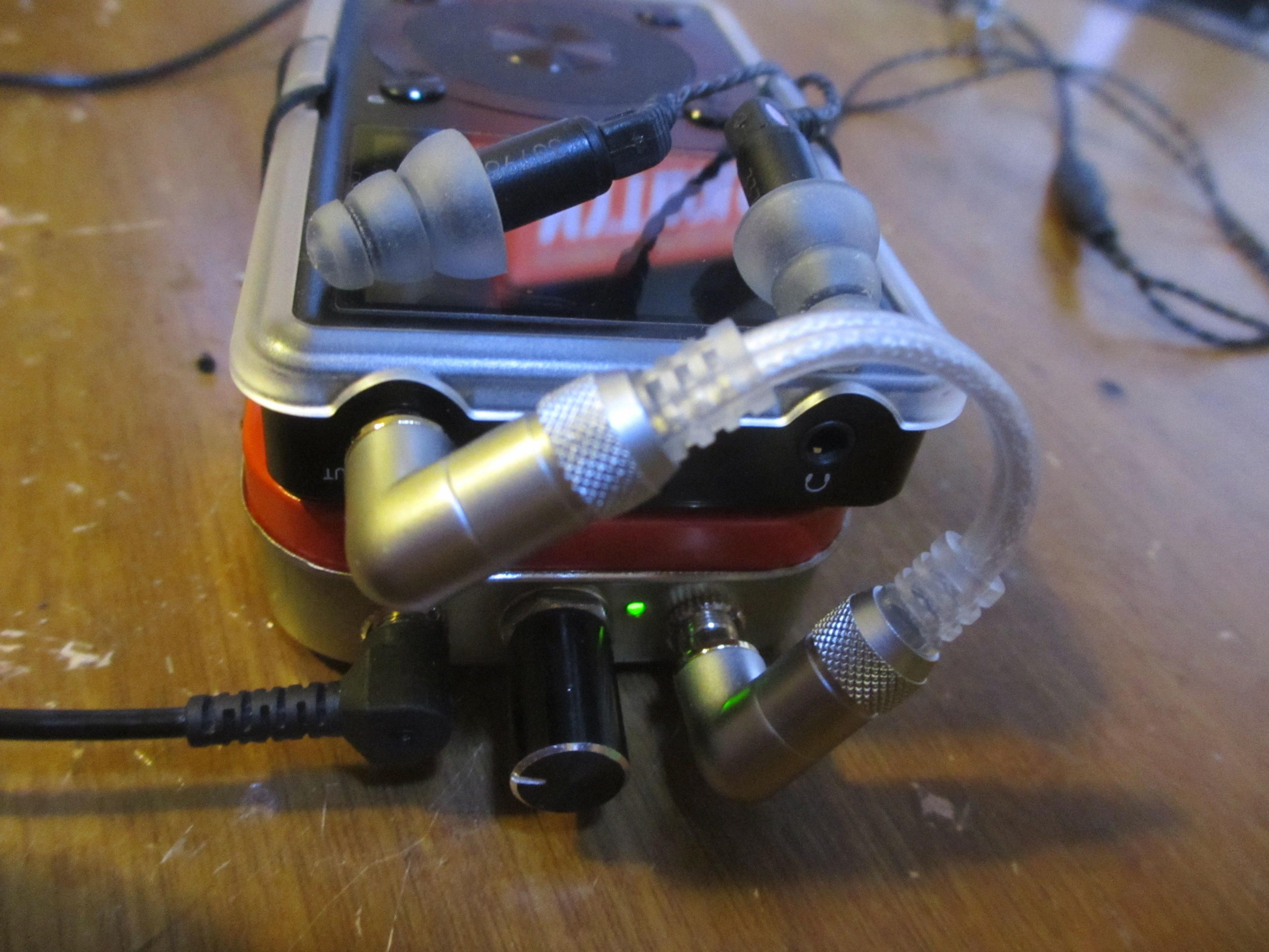

Here are the PIX, the listening results will have to wait until I upgrade firmware on my Yamaha RX-A1040 receiver.
Looks great! I've been putting a couple of strips of foam rubber weather stripping, from the big box home stores, under the lid over the battery area to take up the remaining space between the lid and the batteries. Works great. Photos below.

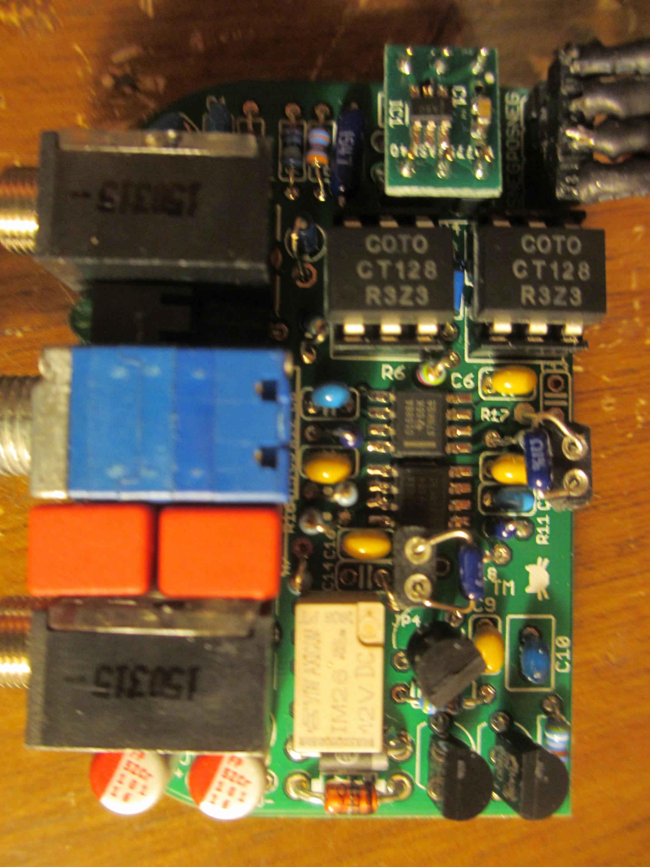

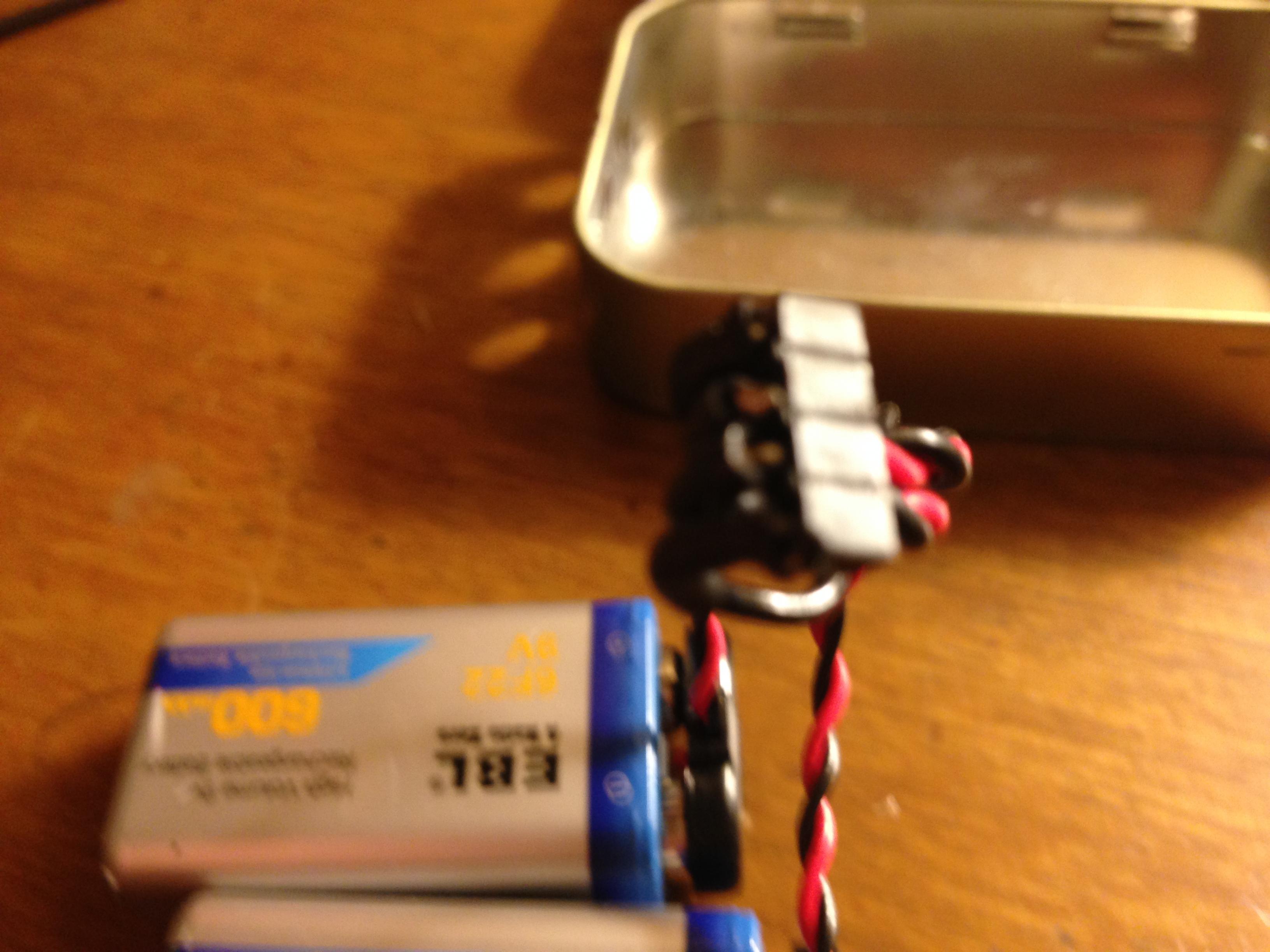

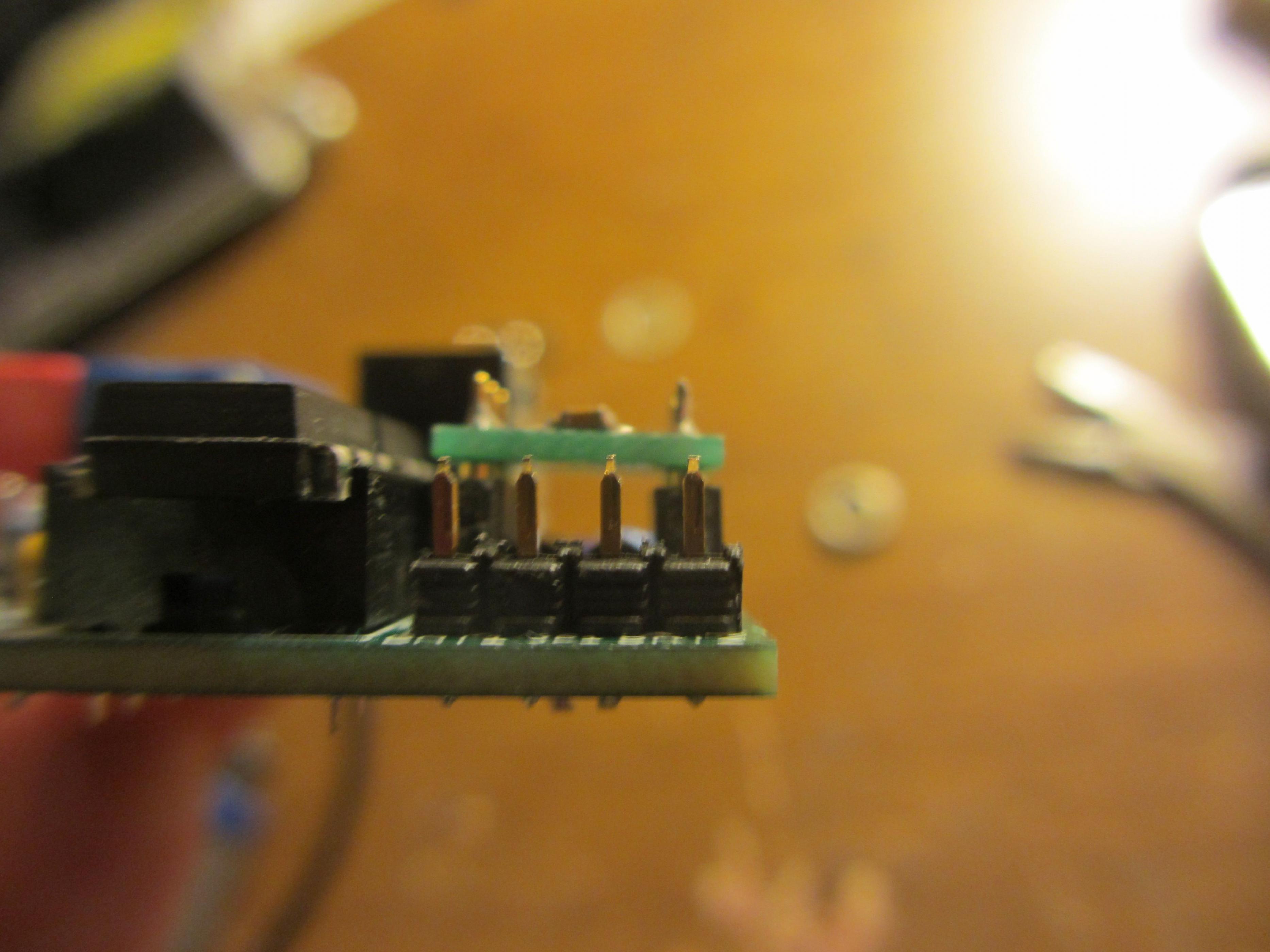

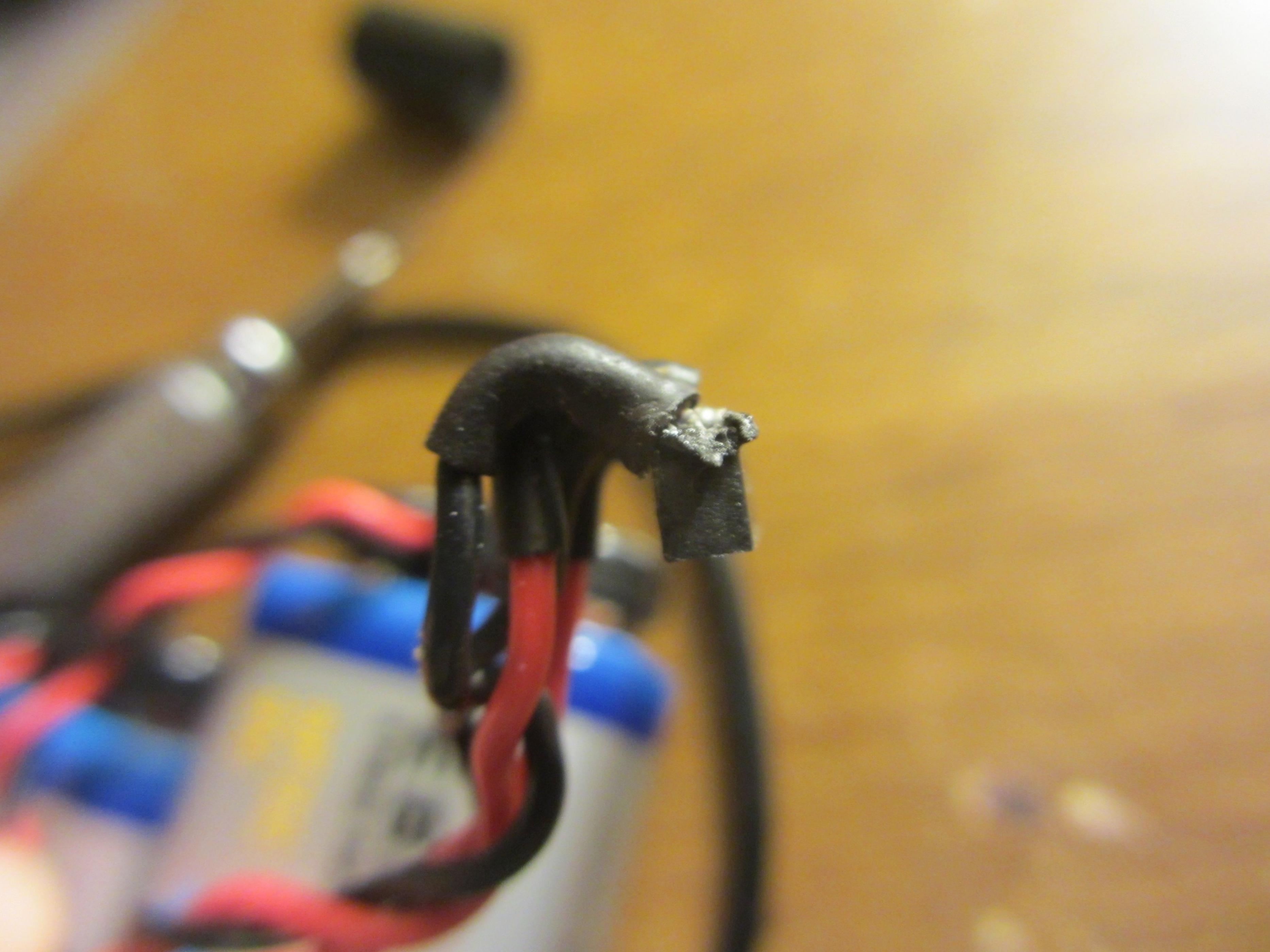

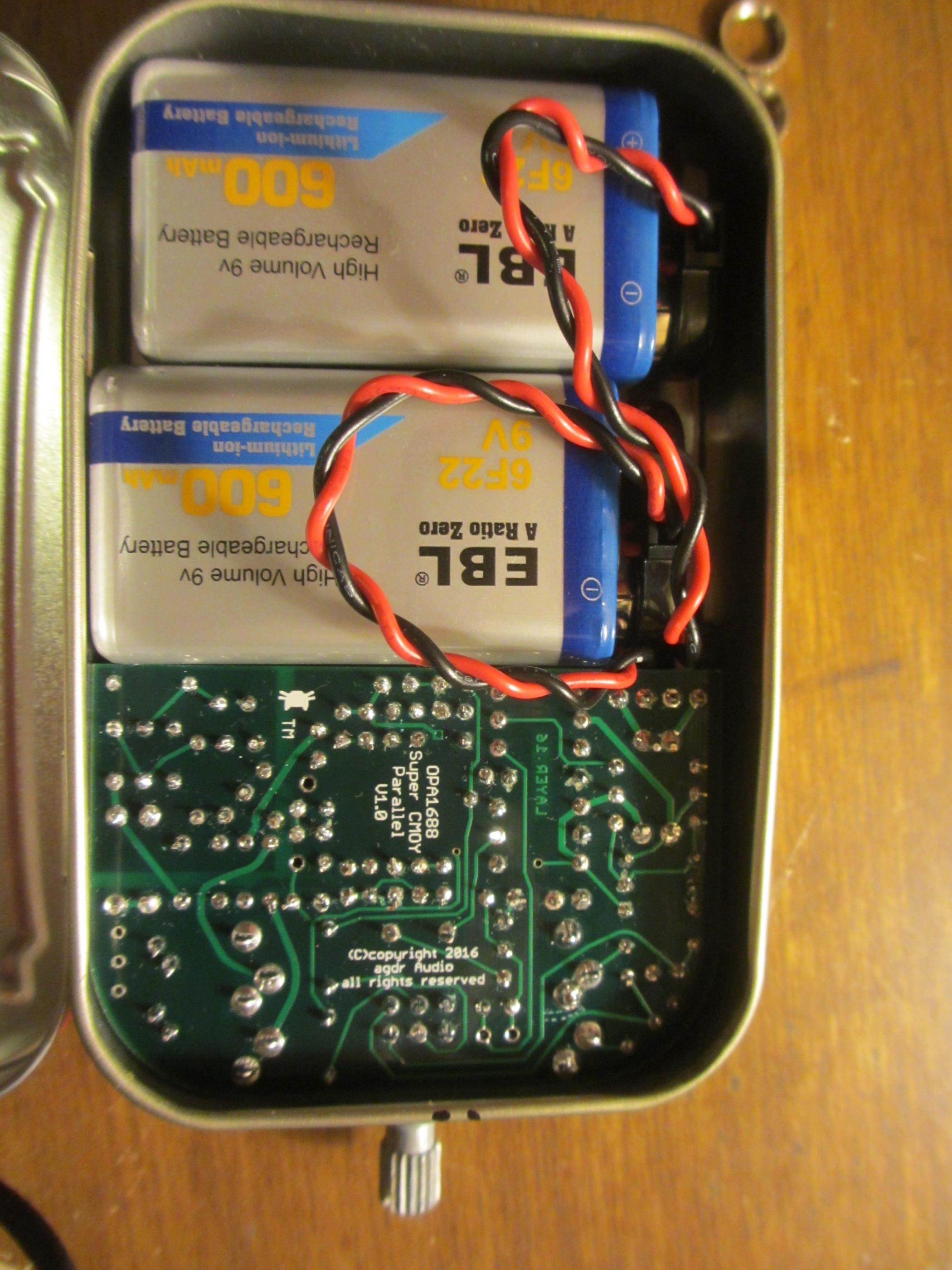

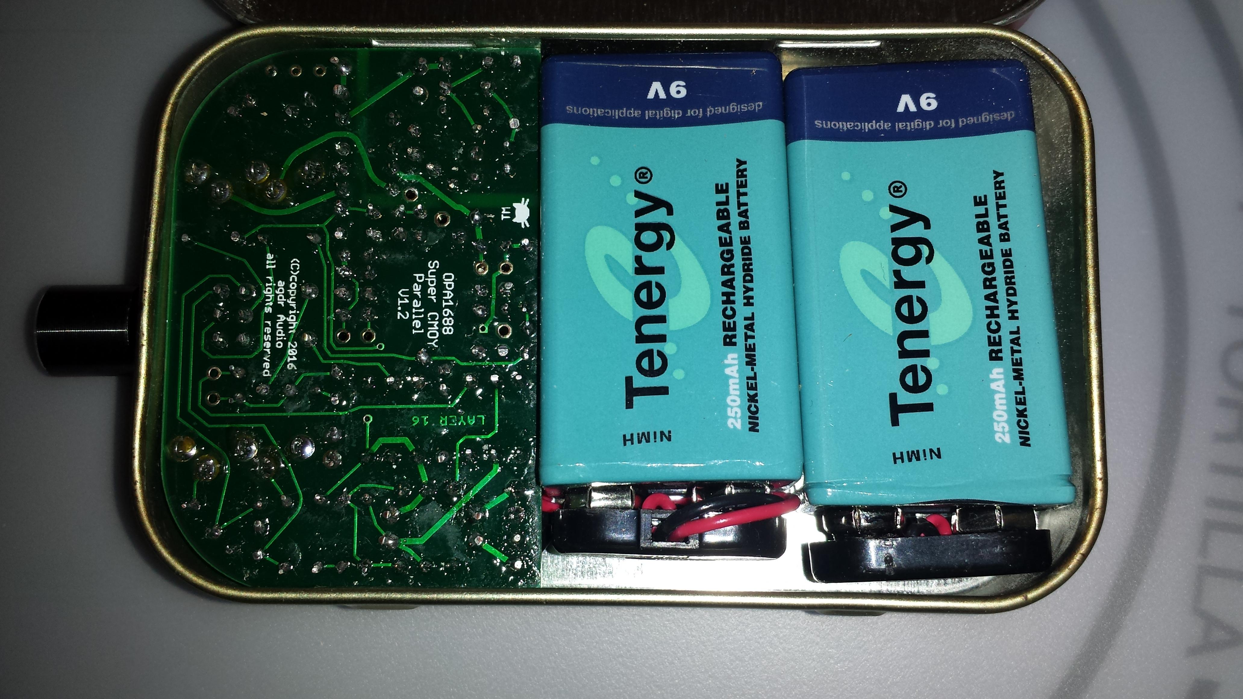

Alright, so I finally have the finished pics of my AGDR super Cmoy with detachable battery! Sounds great and everything works. I just used it on a long trip and I must say, it performed very well with my noise isolating(should I say noise killing?) er4 headphones.
First pic is of the socket, I bent the pins so the cable would naturally move up and over thought he battery compartment.
Second and third ones are of the battery assembly after having heat shrink applied as a insulator
Fourth one is a board shot. I forgot to mention I made more mod: replaceable rain resistors. I used a cut up dip 20 socket because I has a few on hand.
No. 5 and 6 are side shots that show clearance to the header. There still is a lot.
No7 shows the board fitting in a regular Altoids tin. Clearance are about the same as the original.
No 8 is a finished photo of is in my portable rig. Sounds great! Thanks AGDR for helping me debug!
Hey that is some very fine DIY work there! Thanks for sharing your photos. Those power pins and wiring came out really nice. I always figured there wouldn't be enough vertical room, but in your side shot there is a good 2mm or more there. I like that short 3.5mm source cable too. Fantastic idea on making the gain resistors replaceable, I do that with O2 amp builds. That would make trying different amp gains a snap. Definite member of the Super CMOY club!!
How many days are you getting on those 600mAhr lithium batteries between recharges? I'm glad you twisted the battery wires together on each snap. That is something I've forgotten to add in the build instructions and in fact something I've been forgetting to do myself!
