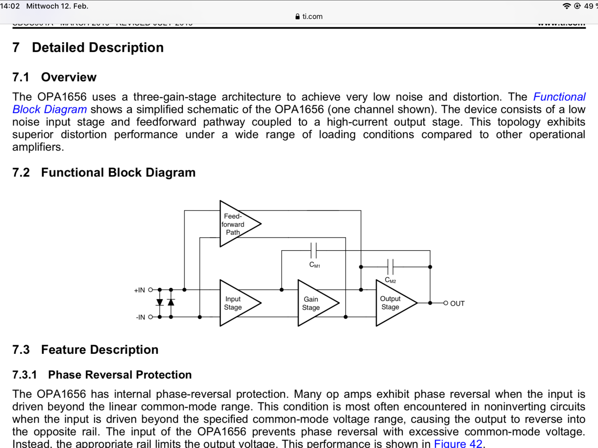

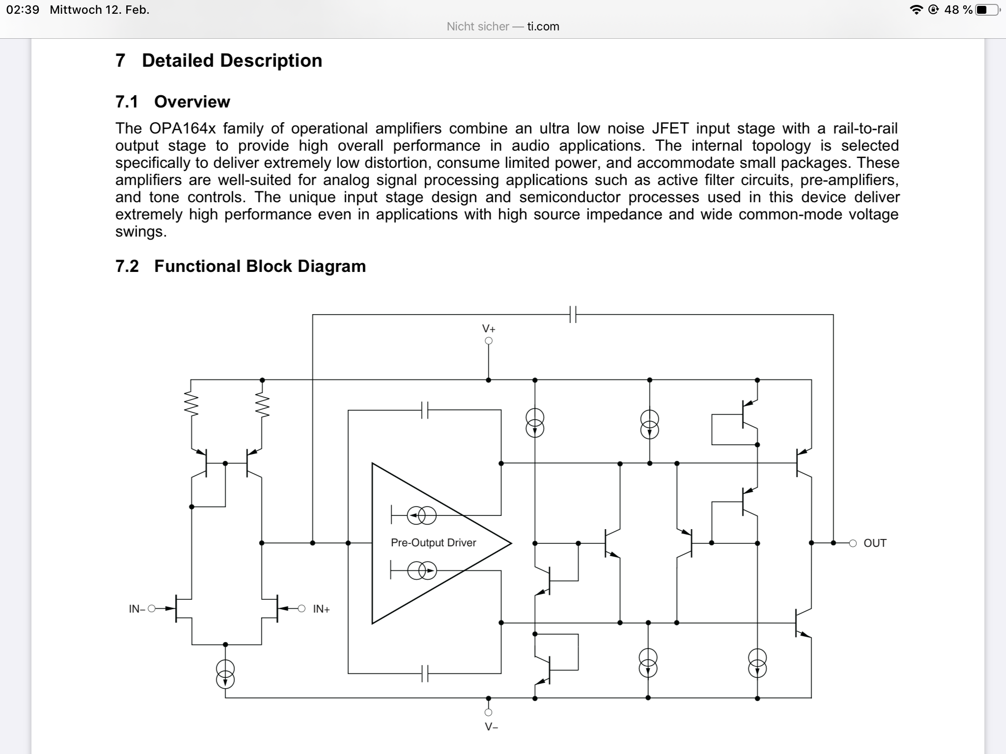

I don't think it's the case, opa604 has more feedback at 1khz than opa1642.
Opa1642 does not need as much Feedback. It has lover distortion because of a much different topology.
I dunno.. maybe I'm putting my foot in my mouth again and it's a bit difficult to say as we don't know at which level those measurements were made. Still, they seem to hit the thd levels of the opa604 itself, which hints at the opa604 being the limiting factor. The opa1642 has indeed less open loop gain but its intrinsic thd is quite a bit lower. It might be a wash in the end though.

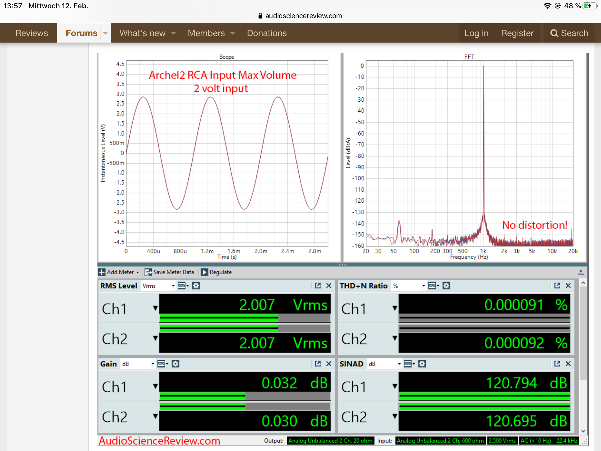

This is a measurement of a headphone amp with the OPA1656. I doubt if composite amplifiers are needed any more.
Well. It is a composite amplifier. Further more, Amir's dash board doesn't have the amplifier loaded. It's either 10k or 600ohm. So there will be no distortion. Try replicate that with 32 or 16 ohm. Distortion will be much much higher even with composite amplifier.
