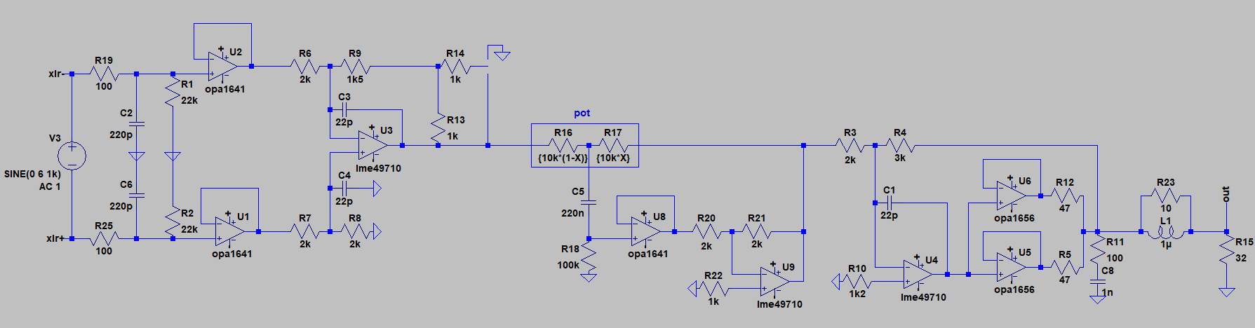

I'm currently busy throwing as many lm4562, opa1642 and opa1656 as I can in a small headphones amp design. :D

If you want to add a BUF634 (really I would suggest the BUF634A, cheaper and better) to the output I would suggest switching to the INA163 since it has the sense pin which allows you to close the feedback loop around the BUF634A. If there is no feedback around the BUF, distortion will be somewhat high.
OPA1656 should be able to do about 12Vrms / 17 Vp into a 600 ohm load, but distortion will definitely be rising at that point, as shown by Figure 8 in the datasheet.
