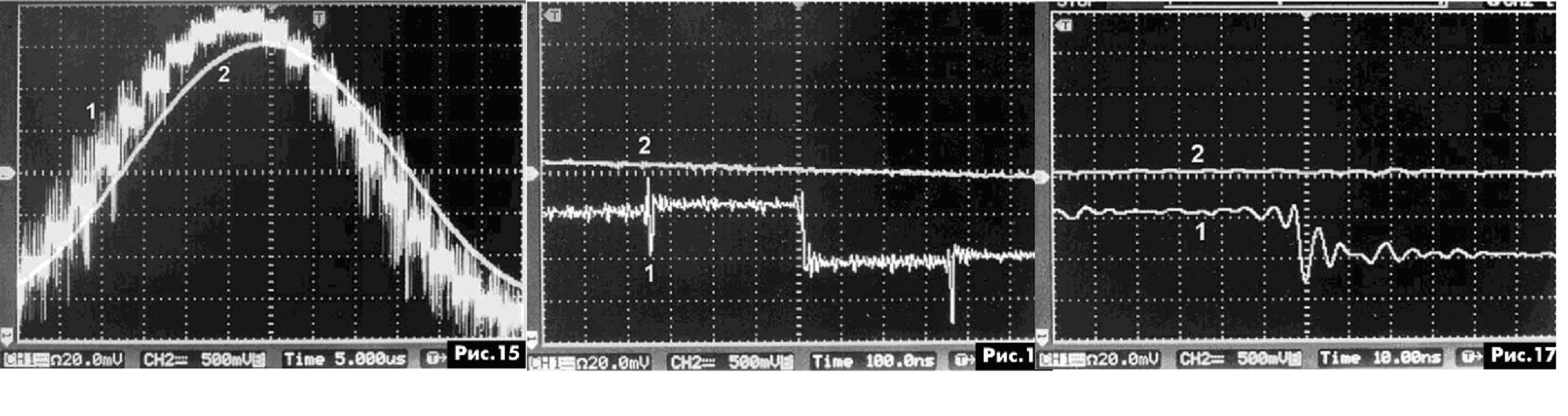

I think for I-V it's more the edge rates that are of concern. Obviously the first opamp after DAC is the critical one. Below I have a pic of PCM1794(2) OP
current 'stepped' waveform. The edge rise time looks around 1nS. I'm not sure what the BW of CRO used was so they could be even faster.
It is a possible reason why there is such a large variance in distortion between various opamp based I-V architectures. For example I have seen
plenty of PCM1794 implementations with distortion not much below -100dB. But I have also seen the same DAC having all distortion spikes below -125dB
with careful attention to first I-V stage RF filtering, the first pole being passive.

Thanks for sharing. What do you think of the requirements for newer DAC like 4499? How much more difficult to get it right?I think for I-V it's more the edge rates that are of concern. Obviously the first opamp after DAC is the critical one. Below I have a pic of PCM1794(2) OP

I am not worried about the signal but the DAC current output "steps". To track it you need more than 20V/us
And I would bet that the amplitude of each step is too small to actually reach the slew rate of the amplifier. Remember, to actually hit the specified slew rate of an op amp, you have to create a large enough voltage between the op amp inputs to direct 100% of the tail current into the compensation capacitor. Just because you have a fast edge doesn't matter. You can put a 1mV square wave with an infinitely fast edge into an op amp all day and never exercise its slew rate. It will remain in small signal operation where its rise time probably 0.35 / bandwidth (single pole system).
