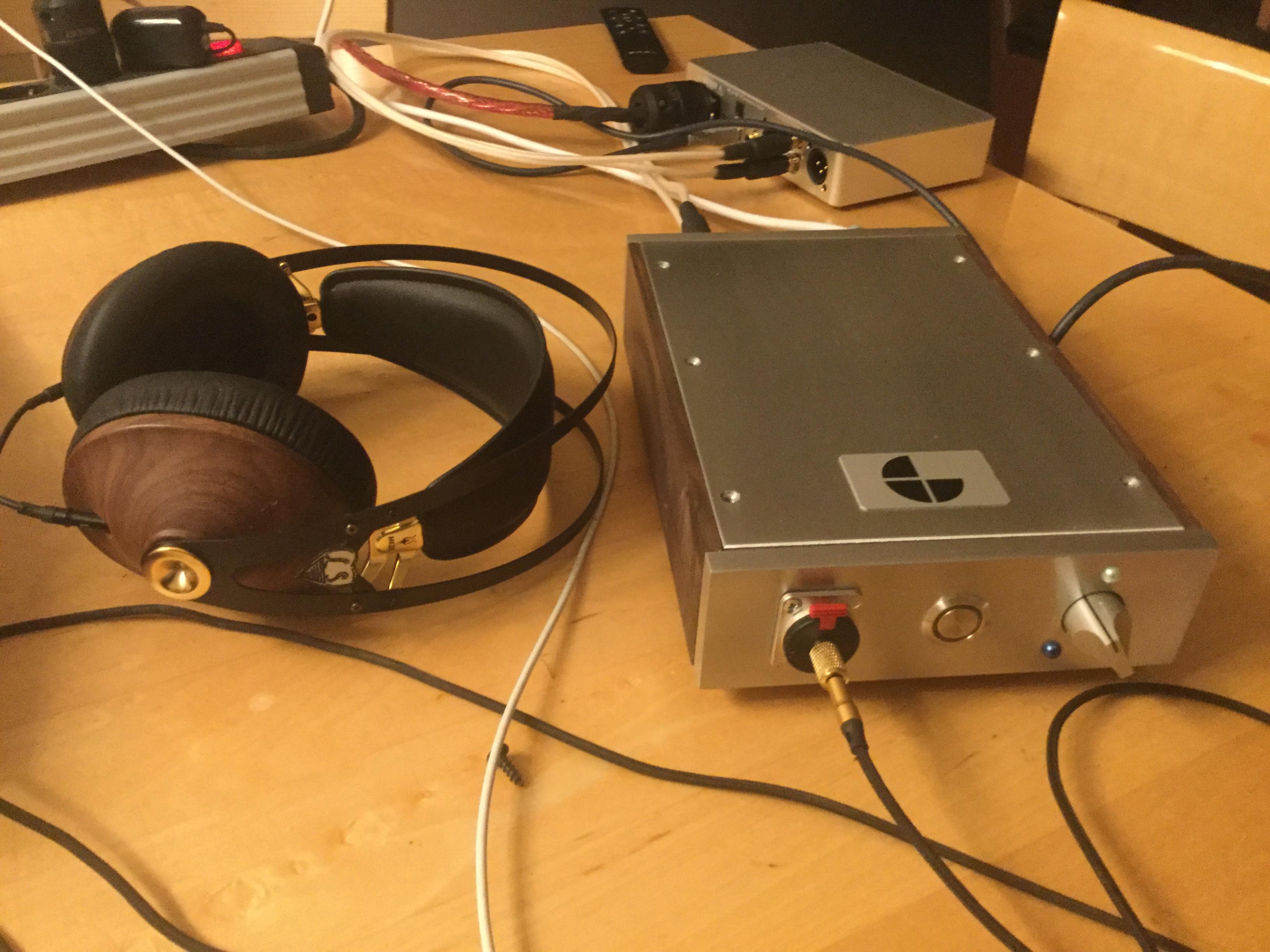

I build a headphone amplifier prototype with it without buffer. I have not measured it so far.

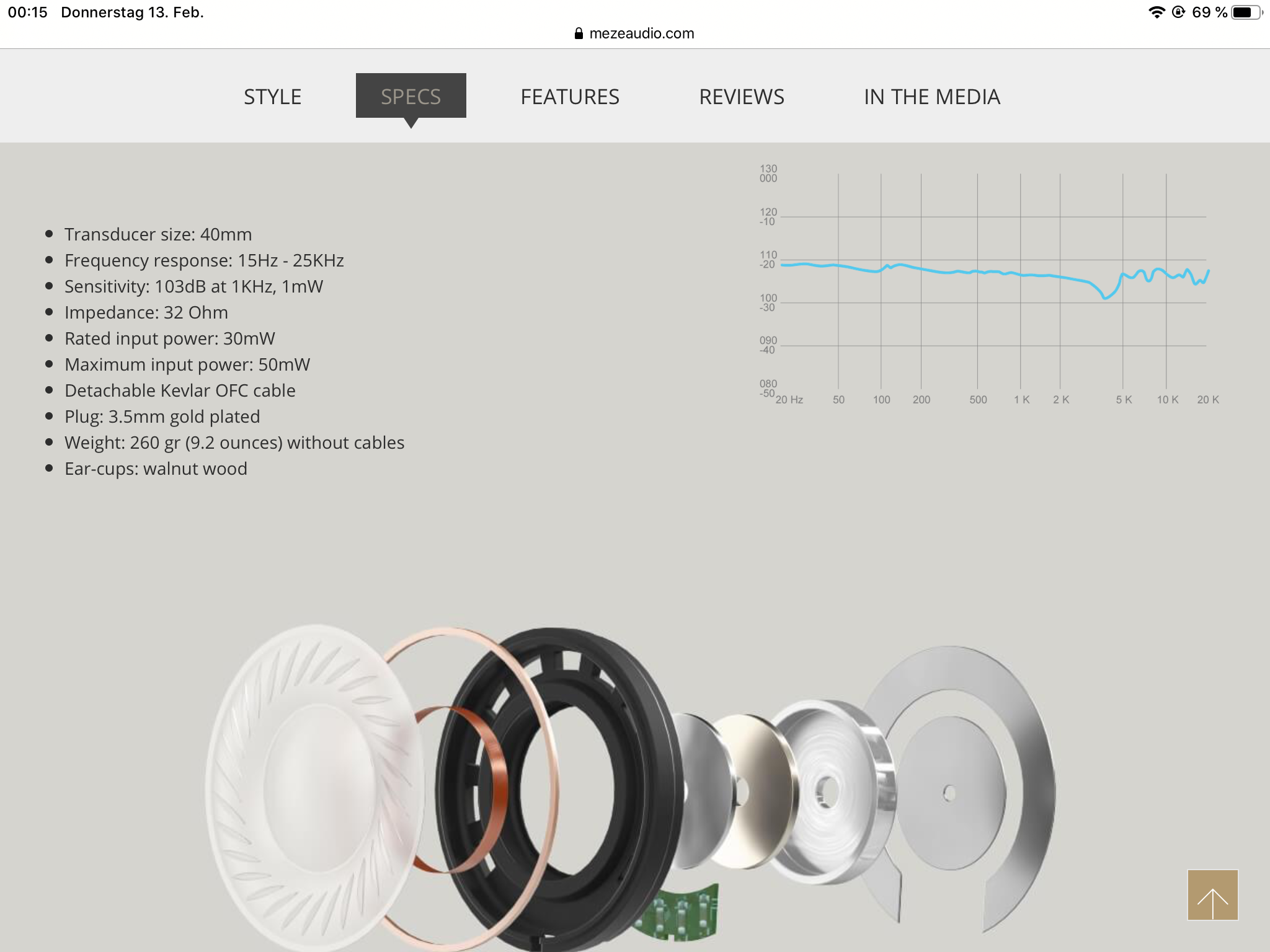

Azul headphone amp (BAF 2019) uses an OPA1611 + LH0033 composite. It'll deliver 75mA RMS into a 32 ohm load; that is 180 mW which is quite a bit greater than the rated maximum shown in post #162.
