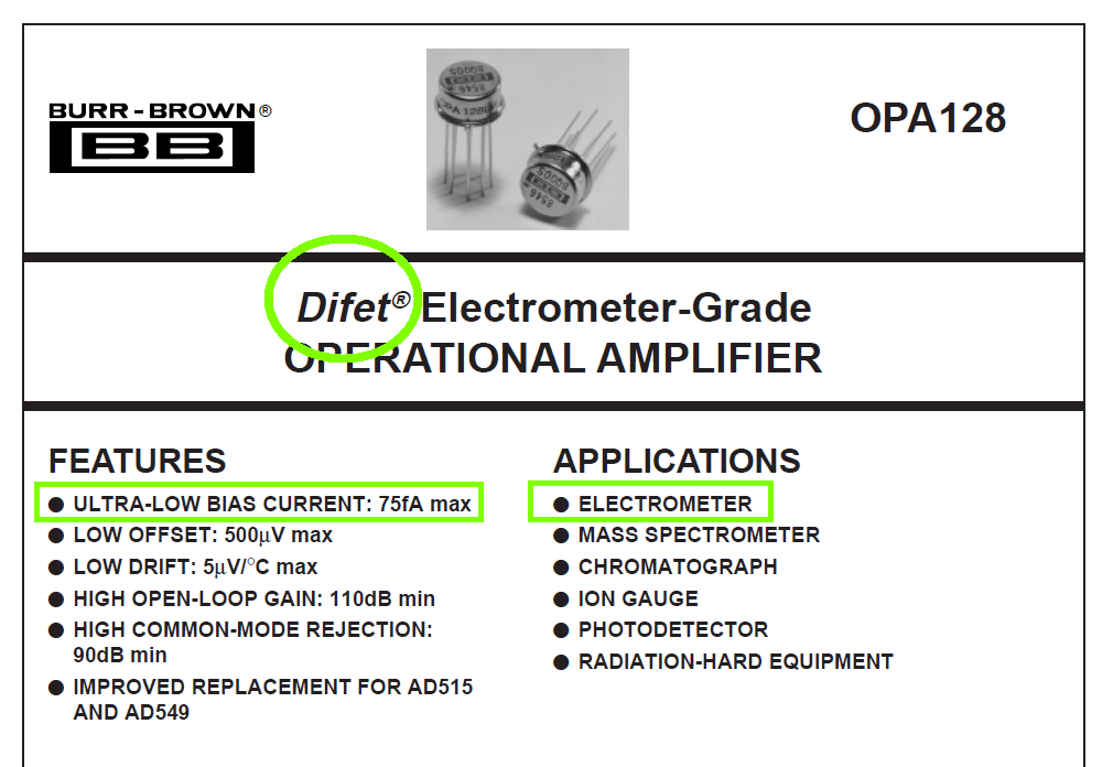

DIFET is dielectrically isolated JFET-Bipolar process. Its purpose is to achieve the absolutely lowest possible input leakage, in order to build electrometers. The fact that audio people have a weird, all-consuming fetish for those parts, is a happy accident.
attachment.php
_
Just to clarify a few things:
1. "DiFET" is a name Burr-Brown applied to a particular dielectrically-isolated bipolar process that included JFETs. Dielectric isolation means that the transistors are surrounded on all sides by silicon dioxide as opposed to junction isolation, where there is essentially a reverse-biased diode between all transistors and the substrate. Dielectric isolation does reduce leakage by isolating the back gate of a JFET from the substrate, but that is not the only benefit in conveys. It also stabilizes the the back-gate to substrate capacitance, reducing distortion in many circuits. More info here: https://www.ti.com/lit/an/slyt595/slyt595.pdf
2. The Burr-Brown DiFET process is OLD and used a now-obsolete method of creating the SiO2 tubs the transistors sit in.
3. OPA828 is still on a dielectrically isolated process, and it does use JFETS, so it is still a dielectrically isolated JFET op amp. It just happens to be on a far newer, more advanced (and better in pretty much every conceivable way) process that doesn't use the Burr-Brown "DiFET" branding.
