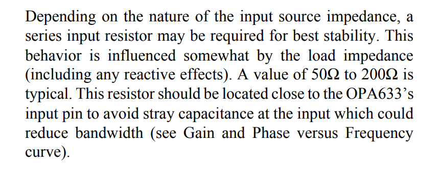

I was just wondering whether one can get the kind of problem you had when the op-amp is mounted on a perfect PCB. That is, op-amp datasheets always warn you about capacitive loads, but should they also warn about inductive and resonant sources?
Based on my calculation, I think the answer is yes, not just for the OPA1656 but for any op-amp, particularly the fast ones.
Check the datasheets of the LMH6321 and also the OPA633. Both of them recommend a resistor in series with the input pin; example verbiage below.

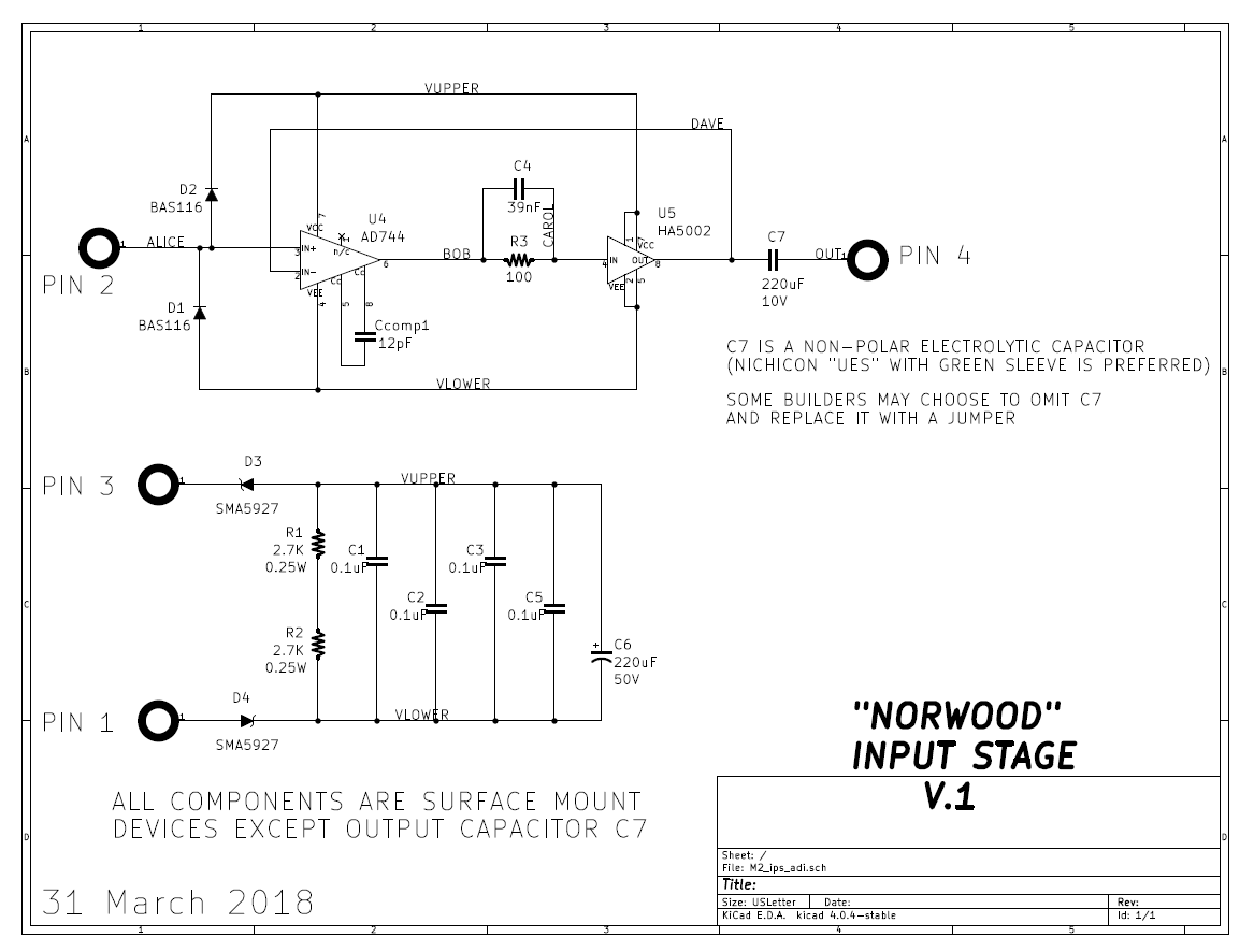

That's why I included resistor R3 in the "Norwood" circuit, sold by the diyAudio Store as part of the M2x bundle. Capacitor C4 was included because I read section 6.6 of the LMH6321 datasheet, and decided to apply its recommendations. However, some phono preamps (e.g. Parasound JC-2) omit this capacitor and accept the bandwidth reduction since multi-megahertz isn't in the job description for an RIAA equalizer. Instead, these phonostage circuits connect an inductor in parallel with the series resistor, to mitigate its Johnson-Nyquist noise contribution in the audio band.

In a old audio express phono amp article by Dennis Colin he mentions the only way to tame the ad797 was to put a small r (221?) in series with the input pin

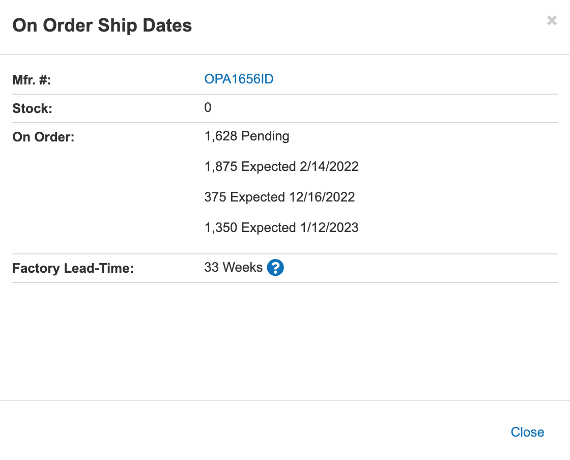

I finally got around to starting a project with the OPA1656. Last month, Mouser had 0 stock, but Digikey had some. When I checked just now, Digikey was out.
Mouser is showing a lead time of about 4 months (screenshot).

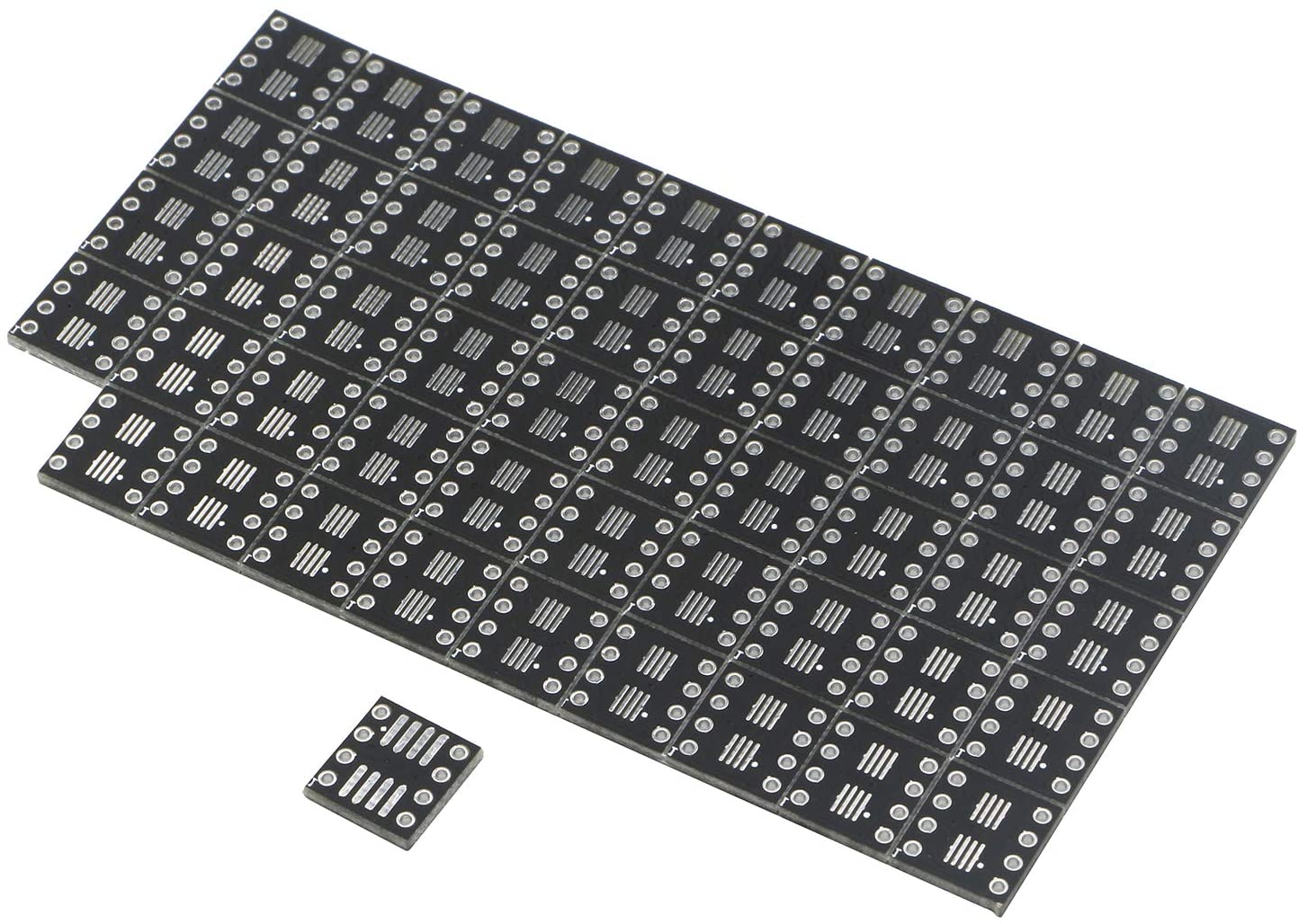

As far as adapters, I have a panel of these and lots of pin headers I solder on myself (yes I am cheap 😀)
