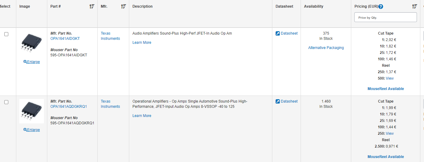

You guys must have a different Mouser then we. I just ordered some today.
Edit - I see, you want the SOIC. Ok yes that's in short supply.

Some of us need a bit larger quantity. This week of assorted ICs I use to make my microphones I bought 35,000 pieces. I could use another 25,000 of just the OPA1692. One source lists more than that as stock, but they don’t respond to an inquiry.
Some folks are selling small quantities at wee bit high prices.
In quantity some of the op amps I might substitute are $.057 and others $.09. But for the first stages of my gizmo it is around $.74 per unit.

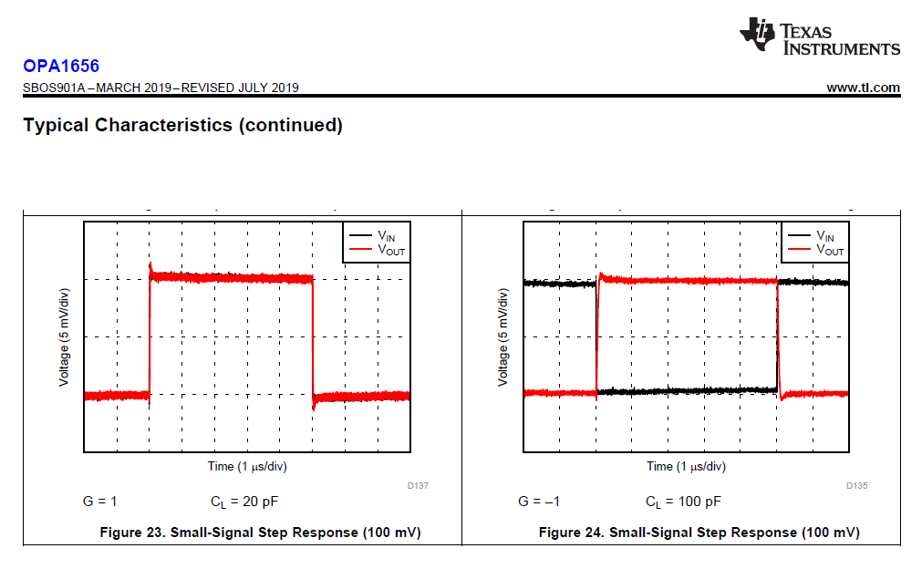

As the open loop output impedance shows, OPA1656 appears to have an output stage similar to OPA1611 (2) which is involved with partial driving current.
He is interested in how such an operational, with 150db open loop amplification, has a small ringing at an amplification of (-) 1. This OPA uses multiple compensations to control the unit amplification.
However, as shown in figure 6 closed-loop gain vs frequency (see amplification at 20db) this operational seems to "like" large amplifications, over 30db! Under these conditions, in many of the usual applications that require a 1x ... 2x amplification, the so-called noise gain artifice must be used. And the noise of this op am is to be taken into account, being higher than operational such as OPA828 (see in the range 0.1hz to 10hz)

No changes have been made to the amplifier. For consistency sake we always try to make the different channel variants of an amplifier as identical to each other as possible. When there are (measurable) differences between the variants we add information to the electrical characterization table in the datasheet. The only difference between the 1655 and 1656 is that the second amplifier has been removed from the die of the OPA1655. Whether that results in auditory differences, I'll leave to the listener to decide 🙂 And yes, samples should be available here in a day or two once the stock becomes visible on ti.com.
