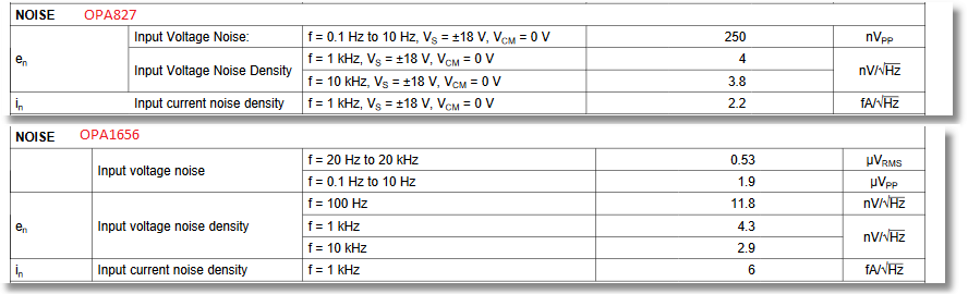

OPA1656 is less noisy than the OPA827, 2.9nV/rtHz vs. 4nV/rtHz both flat.
See attached, Jan is using the opamp for his project MRK 3 input box (input attenuation & gain) prior an ADC for measurement purposes :redhot:
Currently it is not clear, how the measurement (customer) setup was really done... balanced input & output of his upcoming gear
While did many noise simulation with LTSpice for a SVF notch (state variable filter) and the winner was always the OPA827 even in LTSpice FFT graphs.
Hp

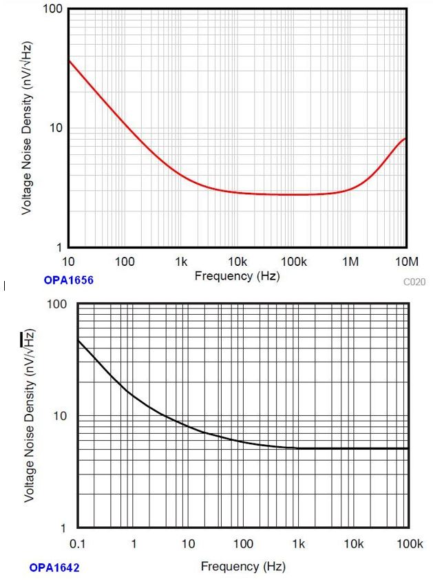

If the circuit has low impedance (1k ohm) use a BJT input opamp. If the impedance is high (10k ohm or higher), then a FET input op amp may be better.
The effective input noise depends on both the input current noise & input voltage noise. With a FET input op amp input current noise is lower, but the input voltage noise is higher.
Generally a FET input has a higher 1/f noise corner than a BJT input.
Also typically a MOSFET input has a higher higher 1/f noise corner than a JFET input. The input bias current of a MOSFET input op amp is mostly due to the input ESD protection diode junction leakages.
For a BJT input op amp the voltage noise is lower but the current noise is higher.
So the choice of op amp depends on the circuit around it and the application. Low impedance inputs and feedback resistors favor a BJT opamp.
High impedance circuits (10k ohms or higher) favor a FET input opamp for low noise applications.
There's a discussion going on over at this thread:
https://www.diyaudio.com/forums/sol...ounding-op-amps-lowest-thd-8.html#post6555025
that is saying that the OPA1656 is quite a bit noisier than the OPA1642 AT LOW FREQUENCIES (100 Hz). This appears to be confirmed by the datasheets and is not a trivial difference---about 6 db; although at 1K Hz, the 1656 is lower by about 1.5 db. Hmmmmm............
Yep, the JFETs used in the OPA1642 input stage still have an edge over CMOS (1656) for low frequency noise. However, I should point out that broadband noise in most audio applications is way more important. Although we're used to seeing frequency on a log scale, it tends to distort our perception of how much the low frequency noise contributes to the total integrated noise over the audio bandwidth. Just consider, there is 19x more bandwidth between 1kHz and 20kHz than there is between DC and 1kHz.
The exception is phono preamps. Because the RIAA eq curve has highest gain at low frequencies, 1/f noise matters. And on MM phono preamps, the cartridge inductance is high enough that amplifier current noise may also matter. I like phono preamps because you can't ignore any noise contributors like you can in other circuits!
