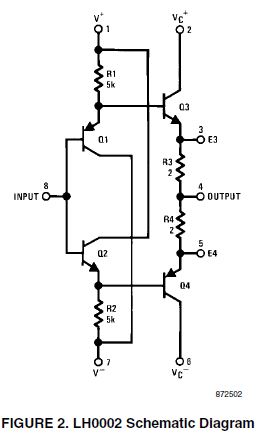

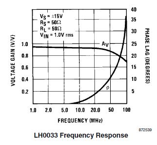

The old National Semiconductor Hybrid LH0002, LH0033 and LH0063(Damn Fast) are wide-band, high current, unity gain buffers often used as part of a compound amplifier to buffer an op amp output.
One issue is they tend to have negative input impedance, so one needed to add a series 50 ohm resistor (or higher resistance) in series with the buffer input. One also needs to pay attention to the additional phase lag of the buffer, when closing the loop with feedback.
LH0024 Application Note 227 Applications of Wide-Band Buffer Amplifiers: https://www.ti.com/lit/pdf/SNOA725A
Those parts are obsolete, but TI has some newer IC variations such as the LMH6321 & BUF634A

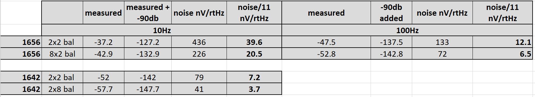

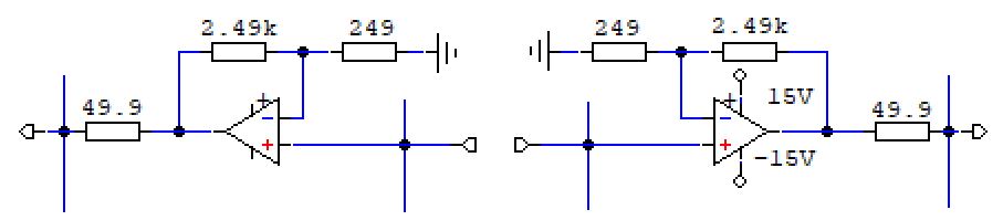

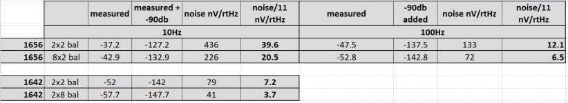

I measured again the noise of OPA1656 vs OPA1642. To check if they will match the previous ones that were made with balanced 10x paralleled op-amps.

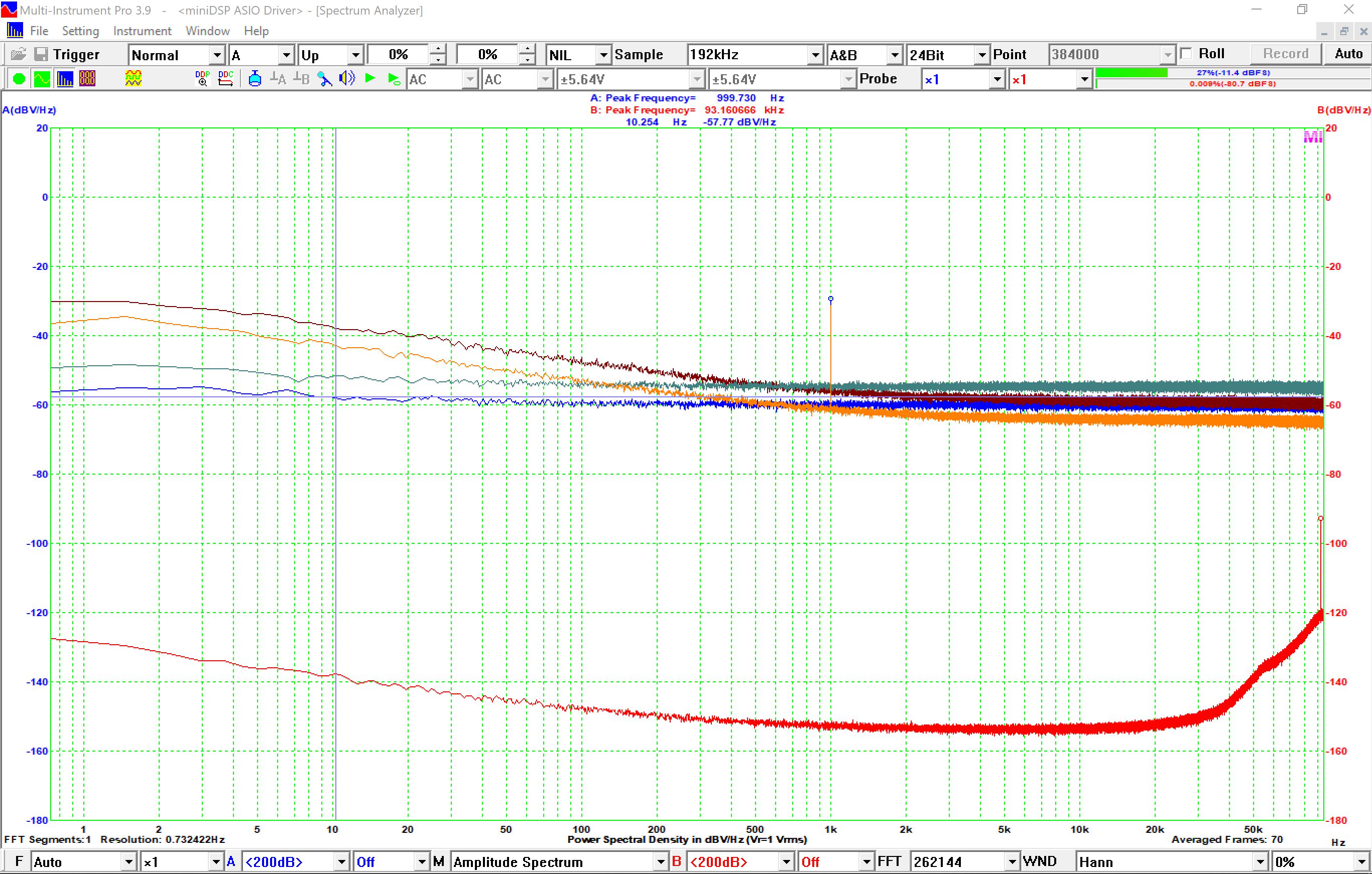

The schematic, spectrum and results are given below. Two schematics in parallel and eight in parallel for both 1656 and 1642 were measured. These combinations should be equal to a single op-amp noise and 4 paralleled op-amps noise. Setup calibrated in dbV. Output signal is amplified 90db. The 1kHz peak at -30db is a -140db control signal injected using 1V RMS generator and 100k/10miliohm divider. 10x@Dicks site for the idea.
blue spectrum - 2 x 8 parallel OPA1642 , green spectrum - 2 x 2 parallel OPA1642
orange spectrum - 2 x 8 parallel OPA1656 , brown spectrum - 2 x 2 parallel OPA1656
Based on these measurements I expect the noise of a single OPA1656 to be 39nV/rtHz at 10Hz.

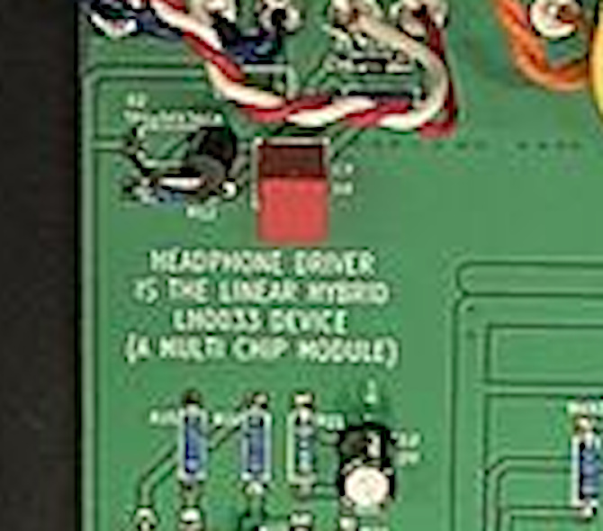

I exhibited & gave listening demonstrations of a headphone amp at the 2019 Burning Amp festival, using a composite topology with the ancient hybrid LH0033 as the output stage. Because they're obsolete and rare and expensive, I socketed the LH0033s. Then I built little "daughter card" LH0033-emulators out of modern production, cheaper parts. During bring-up and testing, the (expendable!) emulator cards were plugged in, so that if anything went wrong, I didn't destroy a hard-to-replace LH0033. Daughter cards are visible in the white ceramic bowl at upper right in the photo.
The headphone amp was called "Azul" and Ti Kan photographed it beautifully:
http://www.tikan.org/ti/audio/burningamp2019/baf2019-19.jpg
Since the LH0033 was socketed, I worried that it couldn't dissipate much heat into the PCB. So I added blue heatsinks, attached to the flat top of the LH0033 packages using phase change thermal interface material. These blue heatsinks are easy to spot in the photo.
Also visible are the gain switching relays (black rectangles amidships) and the input selection & output muting relays (white rectangles along back edge of PCB).

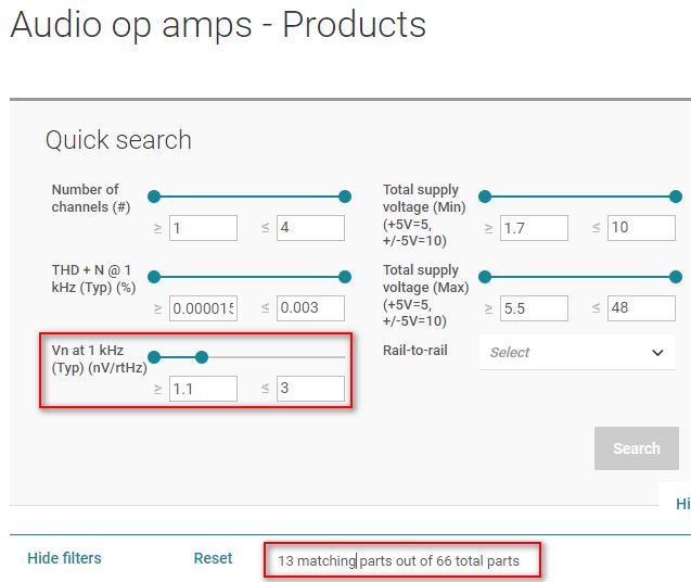

Searching on ultra low noise (default search on voltage noise) audio amps on the TI.com website, it reduces the op amp list very quickly to only a few: https://www.ti.com/amplifier-circuit/op-amps/audio/products.html#p7typ=1.1;3
There is a downloadable op amp software selection tool: https://www.ti.com/tool/OPAMPS-SELGUIDE
