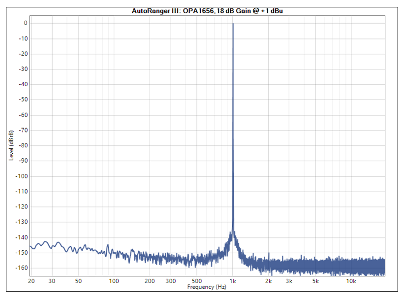

Opamps are done. Just get a '1656 and be quiet ;-)
This is from an upcoming piece.
Jan

You may happy, I am not, while it is a dual opamp with unknown channel cross-talk behavior given as -120dB... so would wait for a OPA1655 as TI promised to build... also the channel cross talk cannot be simulated, a pitta.
Better in this regard, on noise figures & as also shown with simulation, is the OPA827 (single opamp) cost some more but for measurements a must have IMHO.
Unknown is the given TI simulation model (827 & 1656) against the real implementation, but for sure the noise figure is for the OPA827 much better.
BTW: is this measurement balanced or non-balanced input?
