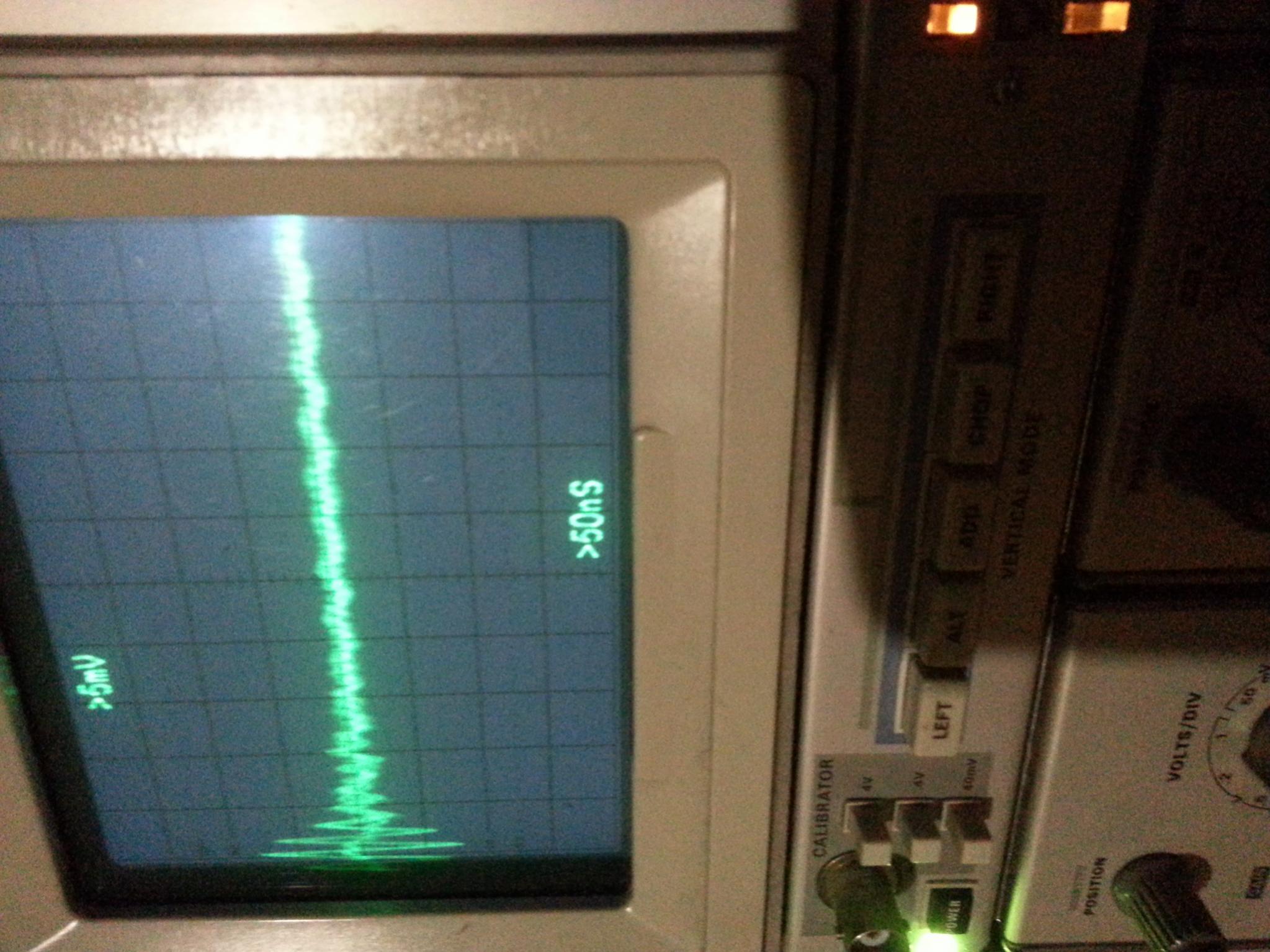

I should notice, it was a mistake when I reported yesterday that with feedback resistors change to 3K\200R the amp become more unstable. Today when I wanted to change back 1.5K\100R I saw that one 1.5K was not soldered. Sorry about that. When I soldered it and checked the amplifier again, this feedback change showed little bit better stability than before, but not much. Than I soldered back 1.5K\100R and started to change compensation capacitors.
Following your advices:
- I changed the positions and value of compensation capacitors at VAS to 12pF from bases of small VAS transistors to collectors of TO-126 VAS transistors,
- shorted the 100R on RC at the base of predriver at negative side of the pcb (in fact RC was on the base of predriver, my mistake when I draw the schematic, sorry).
The result on the scope was better than before I guess. First picture.
- Then I added 200pF capacitor from the base of predriver on positive side of the pcb to input GND. After this modification the amp couldn't even start, my light bulb current limiter was activated periodically with 2 sec interval. When I removed this capacitor and checked again the scope showed even better result. Second picture. Btw, my scope shows almost the same signal as on the second picture when the amplifier is turned off. I've checked it again and found out that the signal on the scope keeps changing to signal as on the first picture but with less overshoot and eventualy almost straight line.
Should I try also to change feedback resistors to 2.2K\150R?
However, there is one kind of instability has left. When I touch by DMM lead to gnd or to voltage terminals, some input emitter resistors, oscillation appears immediately and current limiter is activated.
