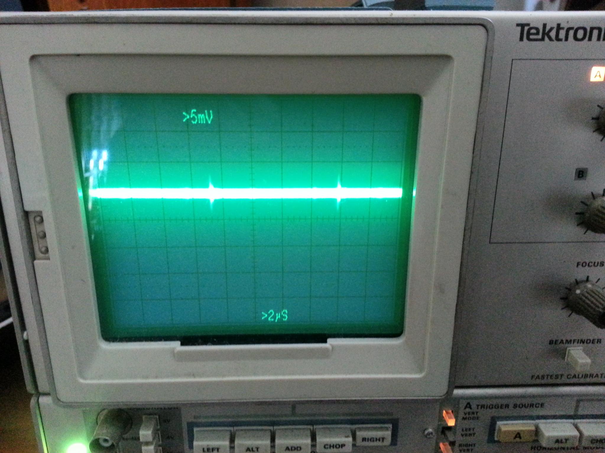

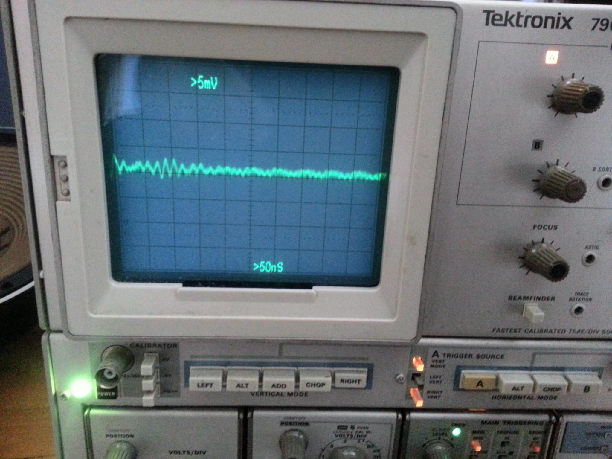

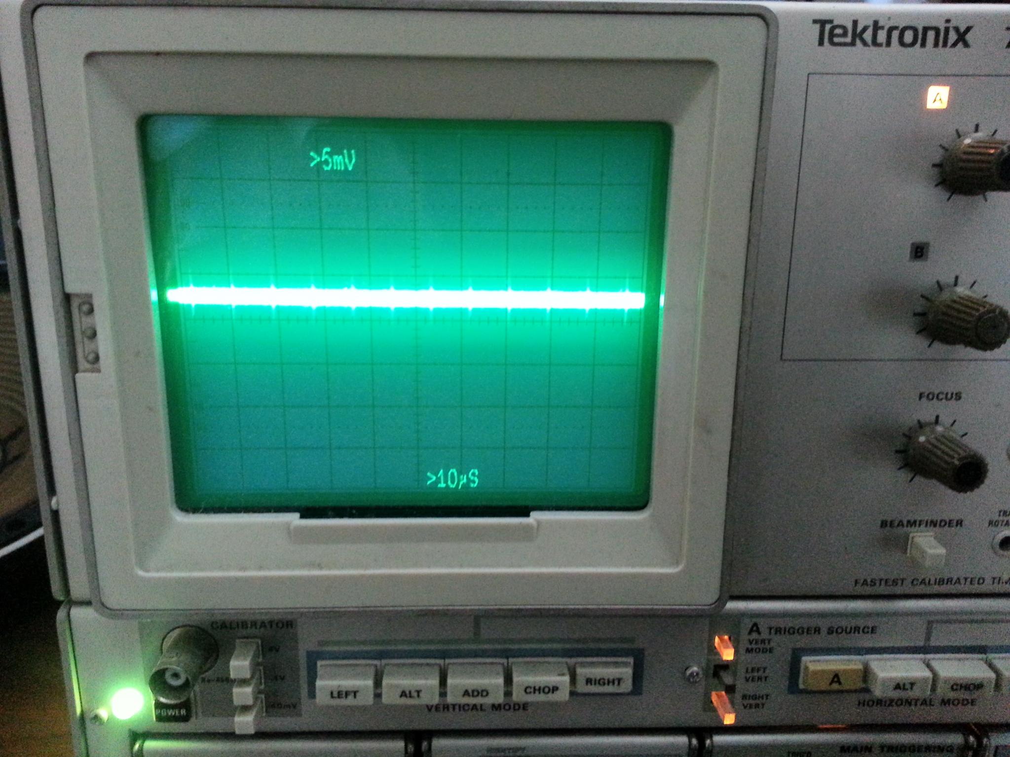

I checked the output with the scope and haven't seen the oscillations. Will upload the pics later. Perhaps oscillations are in range over 200MHz where my scope hasn't capable.
I forgot to mention, before with 300mV dc offset spike at output only little hum noise was heard before the voltage in the amp become completely off state, now the woofer cone moving added with little whistle sound.

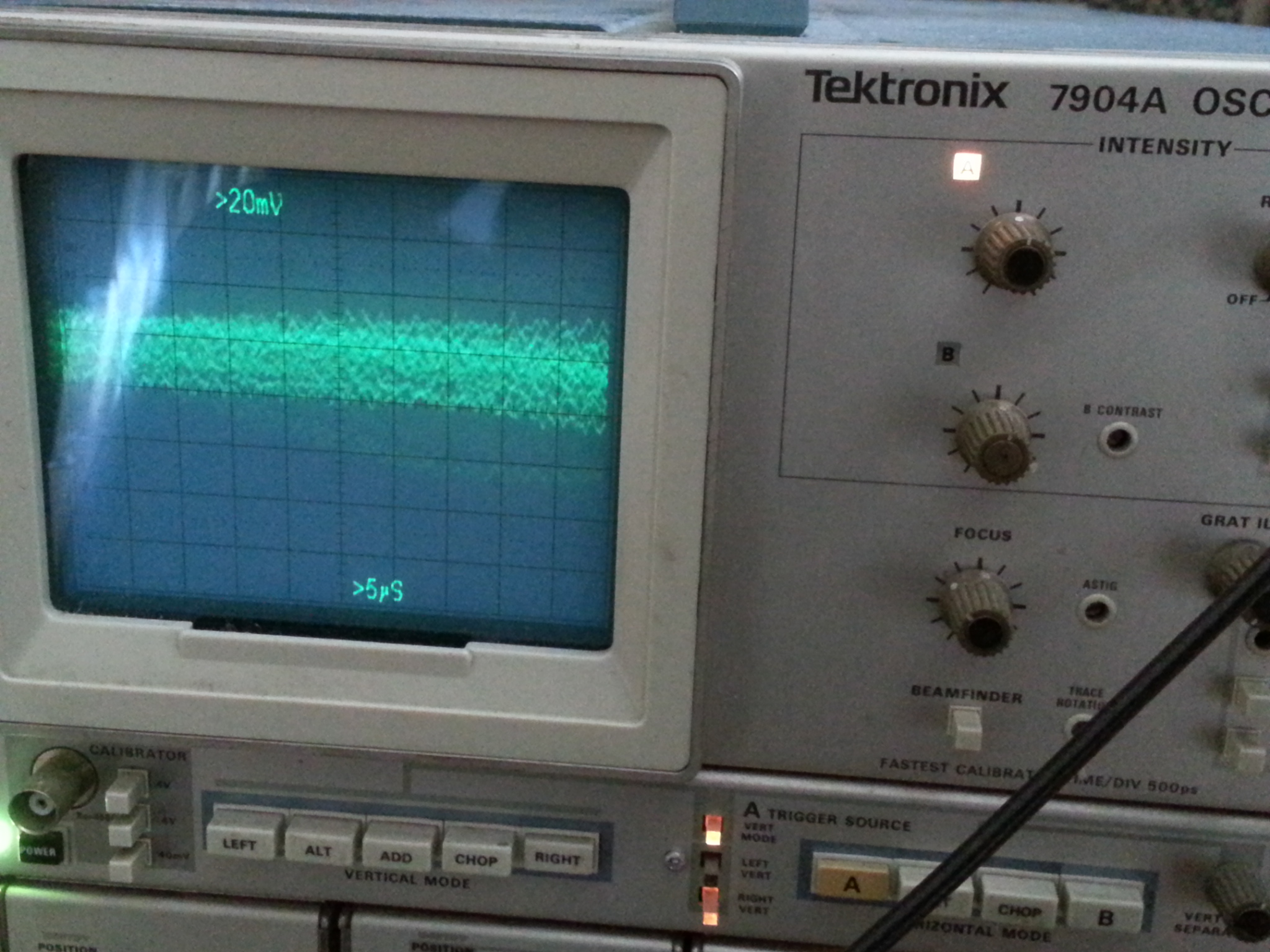

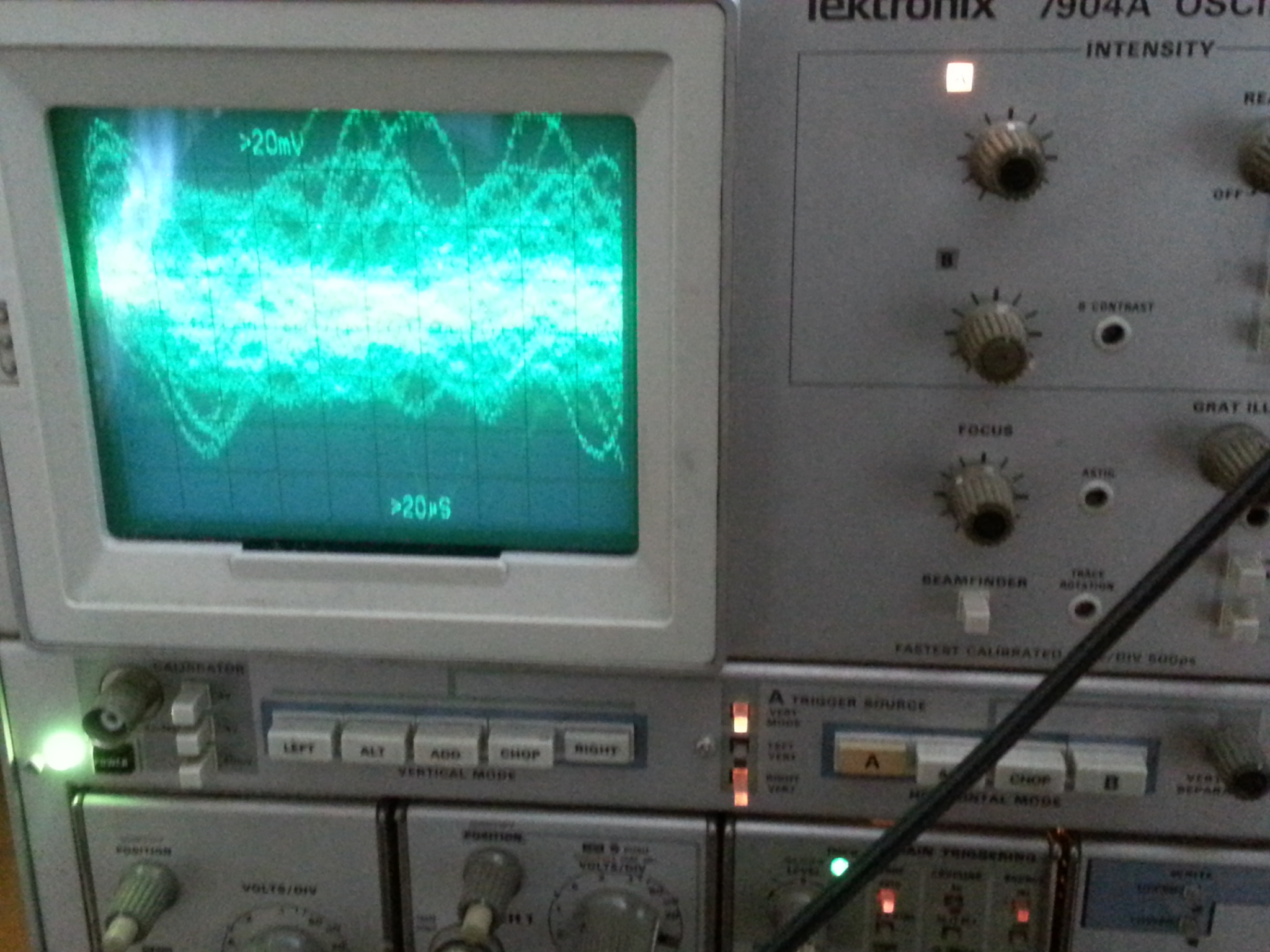

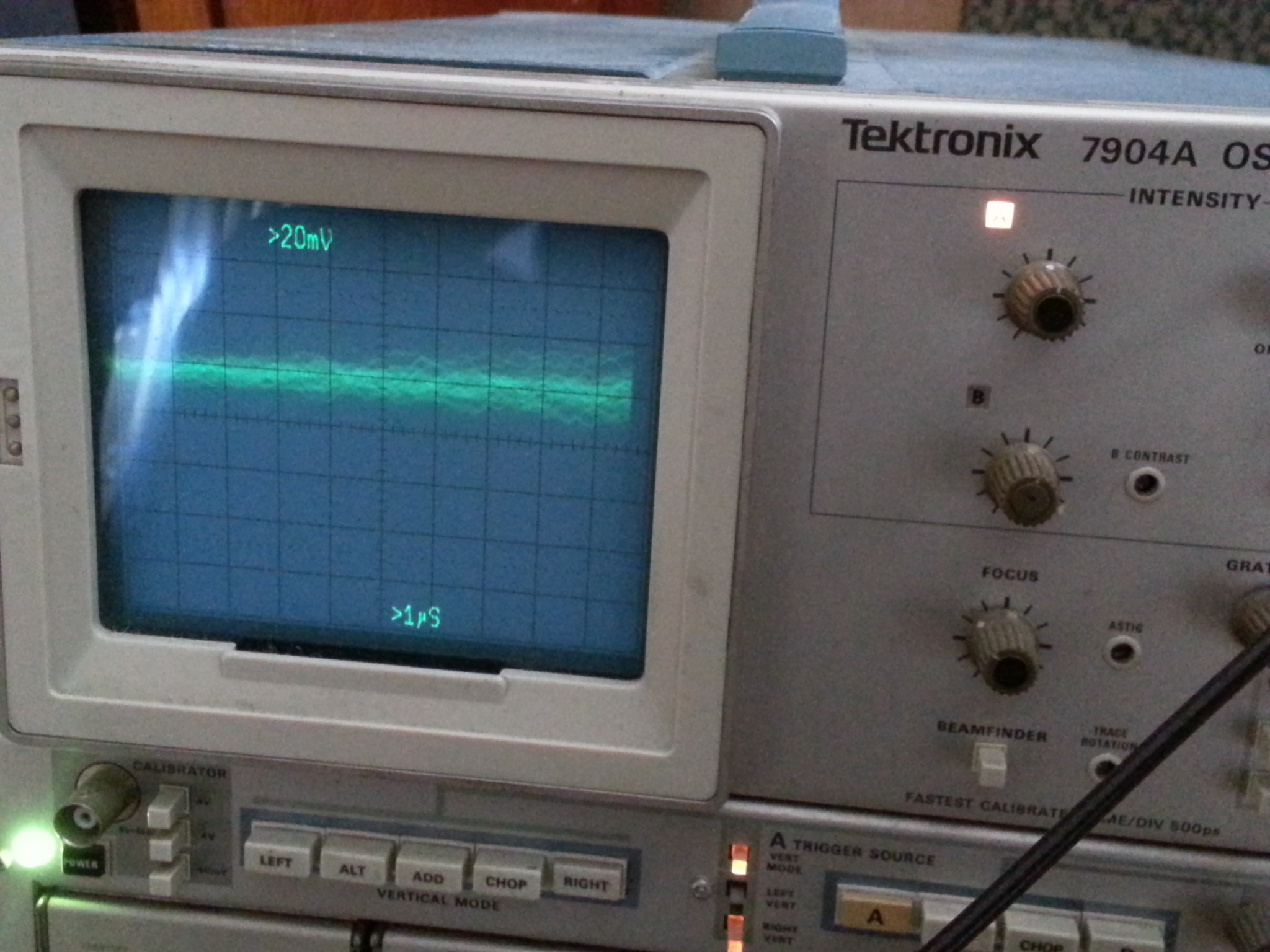

I added the recording of the sound from speaker when the amp turned off and scope photos where 3 without input signal, 3 with music playing.

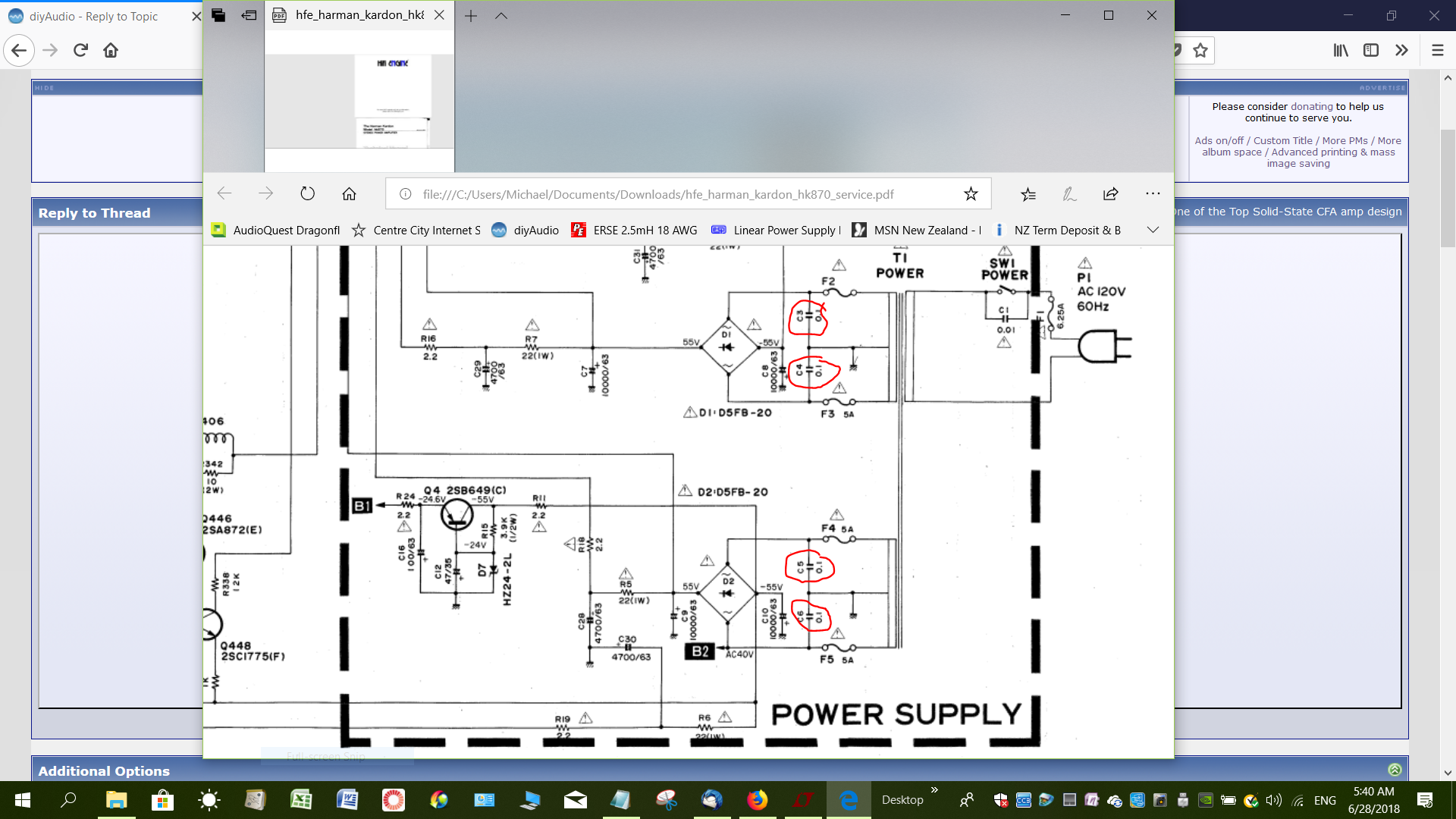

I have attached a circuit which illustrates my point about 100n resistors. You might like to consider the mains voltage suppressor cap across the mains switch too.
If your pre-driver stage is too hot to handle the answer to Iq adjustment possibilities is no.
Measure the voltage drop across R10 and R11. The current through these affects the base voltage and currents for Q16 and Q17 and if the drop is too great the latter will be driven harder.
Also if the current to the front end is restricted by a light bulb it is likely that more of that is flowing through these resistors rather than the 2k2 ones feeding your LED's.
You could try those values for R10 and R11.
This will mean the 15V zeners will be dropping to a fraction of their nominal voltage - but don't fret as you are looking for causes and effects.
In the end you could end up with a resistor zener combination where the latter is a substitute with roughly half the 15V nominal figure.

Regarding current tracking from current sorce and its temperature variations. With buffered feeback this effect is halved, the effect caused by input stage temperature effect is teoreticaly gone.
ur'e shure the psu is wired like this? see att.

A third thought is to fit capacitors of 100n between each end of the transformer primary winding to the center tap to suppress ringing effects and to check your earth system for power and signal sources - to see this has not been compromised somehow in the in view of the many changes you have tried along the way.
It was hapenning with me too. Perhaps you typed for too long and the site log you off. You shiuld always copy the text before sending it out.
These capacitors must be rated for mains use like Y1 or X1?
My base voltage drop is about right: 14.95V\15V. R10, R11 which are 1K are sufficient to supply enough current to zeners. I used these values with 8 input tr's, now is half of them. I can see voltage drop at 15V zeners only when light bulb is shining. I can even supply front end psu directly to mains, no problem with that.
By Iq adjustment possibilities do you mean changing current rating of front end psu or 25r at drivers' BE?
What resistor zener combination do you mean?
You will have to consult the electrical code in your country for any capacitor connected to the mains.
I don't want to speculate about the resistor zener combinations until you have settled the voltage rails for the front end.
If the front end supply voltage is too high with the transformer connected to the mains you could try putting some low value resistance or inductance between your bridge rectifier outputs and the capacitors. If the need is for 100 ma for example then 100R would drop 10V. That could be a reasonable starting value - although I don't know what your latest simulation indicates the actual draw for one channel will be. You can work with that and do the calculations.
A 470 uH Through hole powdered iron suppression choke has a resistance of 82 mR you could try this in combination with a resistor to knock some ragged edges off the top of the capacitor charging currents.
You could build such a filter around a suitable pair of tag strips.
I have a Class A amplifier that has 30,000uF capacitors in the supply which feed a pair of regulators. The transformer voltage for this was a little too high and I needed to reduce this for the sake of avoiding overheating the regulators. Fitting chokes between the rectifier and the capacitors is one of the best things I tried that improved the sound as well as reducing the transformer output voltage.
