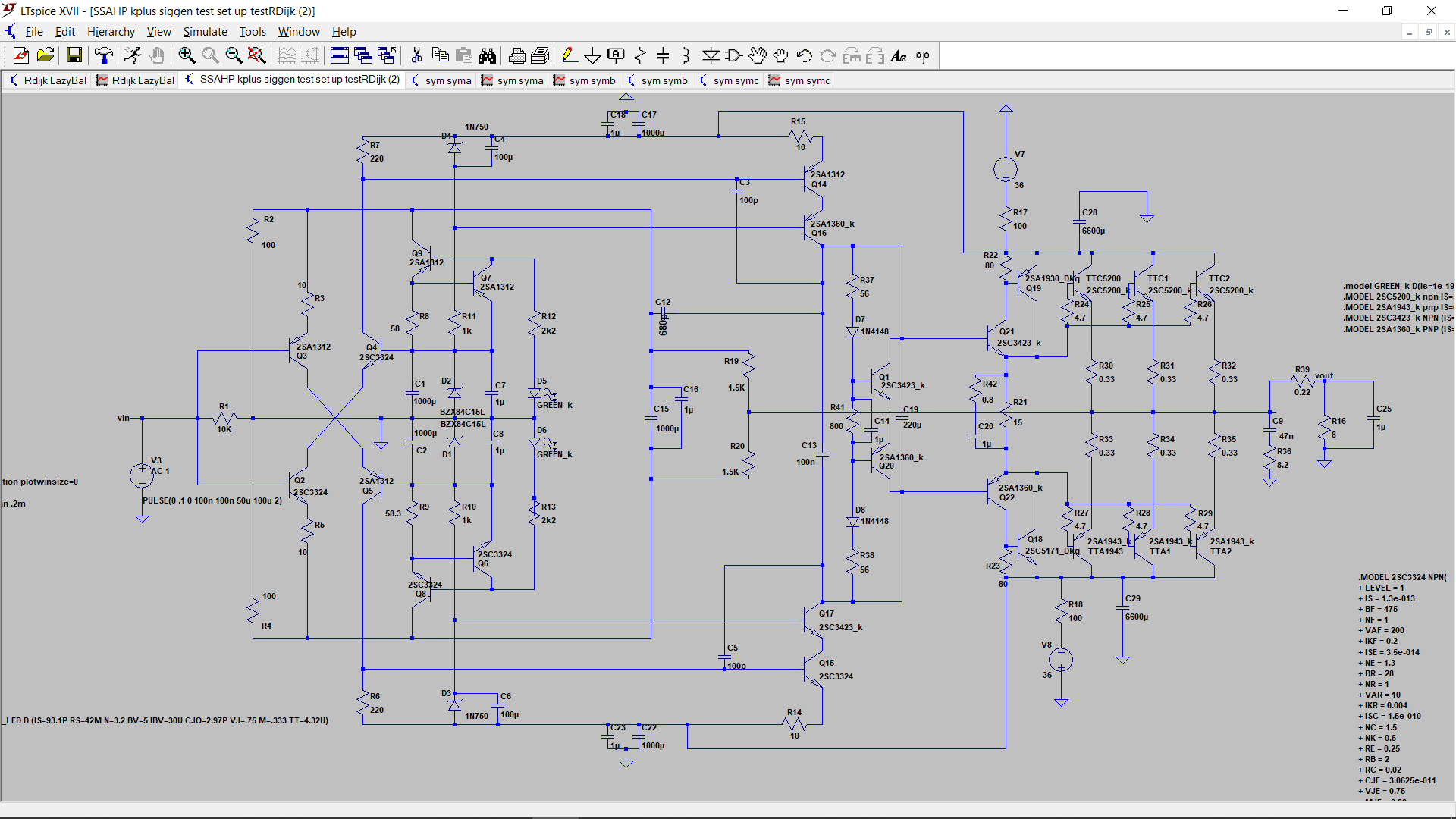

Not exactly. If you mean I mentioned some 1k resistors from post 709, this is stand alone testing of frontend psu without amp with help of 1k resistors. However R10, R11 on the pcb are the same. Zeners on the amp drop voltages, for example, from initial 49V input at 5V zeners to 44 Volts, which appears to be at bases of Q16, Q17, and to 15 Volts at 15V zeners. All these can be checked in the sim.
Light bulb has nothing to do with the sag (which is also present with frontend psu connected directly to mains) which is constant not only in charge time.
R10, R11 values are just right. If you check the sim I can raise them to 1.1k only to maintain 15V at D1, D2. With 2.2K there won't be 15V potential, only just 7-10V.
As I mentioned in previous post, more likely psu sag appears from not proper input voltage setting to shunt psu which my frontend is. Output voltage of shunt psu cannot be the same as it's input voltage.
Judging by the size of the front end toroid this should be able to supply your needs even with shunt load resistors. What are the specifications for this - winding voltages and the regulation%.
If the winding voltage is low and regulation is not tight you might achieve above the voltage nominal figure with no load and have that reduced when the load is applied.
If there is a problem with rating or regulation of your transformer you should connect the primary to the mains to avoid any compromise in that respect.
There is a further need to identify the load where the current is being drawn to - I mentioned some resistor numbers where to measure voltage drops and calculate currents in my last post.

You didn't asked me to measure. The Voltage drop at R10, R11 is 17.5-18V, 17.15-17.6V and keep rising a bit. At R14, R15 is 173.2mV for both. Front end voltage now is 37.5V, rectified voltage is 46V (psu input voltage after rectification). When I connect low wattage bulb 40W, Psu voltage at out is 36V and 36V rectified voltage. In this case the bulb is limiting the current.
With refference to gnd the measurements are: R11 - 15V\32.9V, R10 - 14.95V\32.6V, R15 - 37.80V\38V, R14 - 37.44V\37.60V
You have roughly 18 ma consumption through the zeners and virtually nil through R14 and R15 which supply the output section.
The current from the output feeds the rest of front end via R19 and R20 - what are the voltage drops across these.
R14, R15 set the VAS bias should be around 15-25mA.
R19, R20 has 0.600V, 0.627V across them.
Divided by 1500 each that is about 400uA which is about right under static conditions.

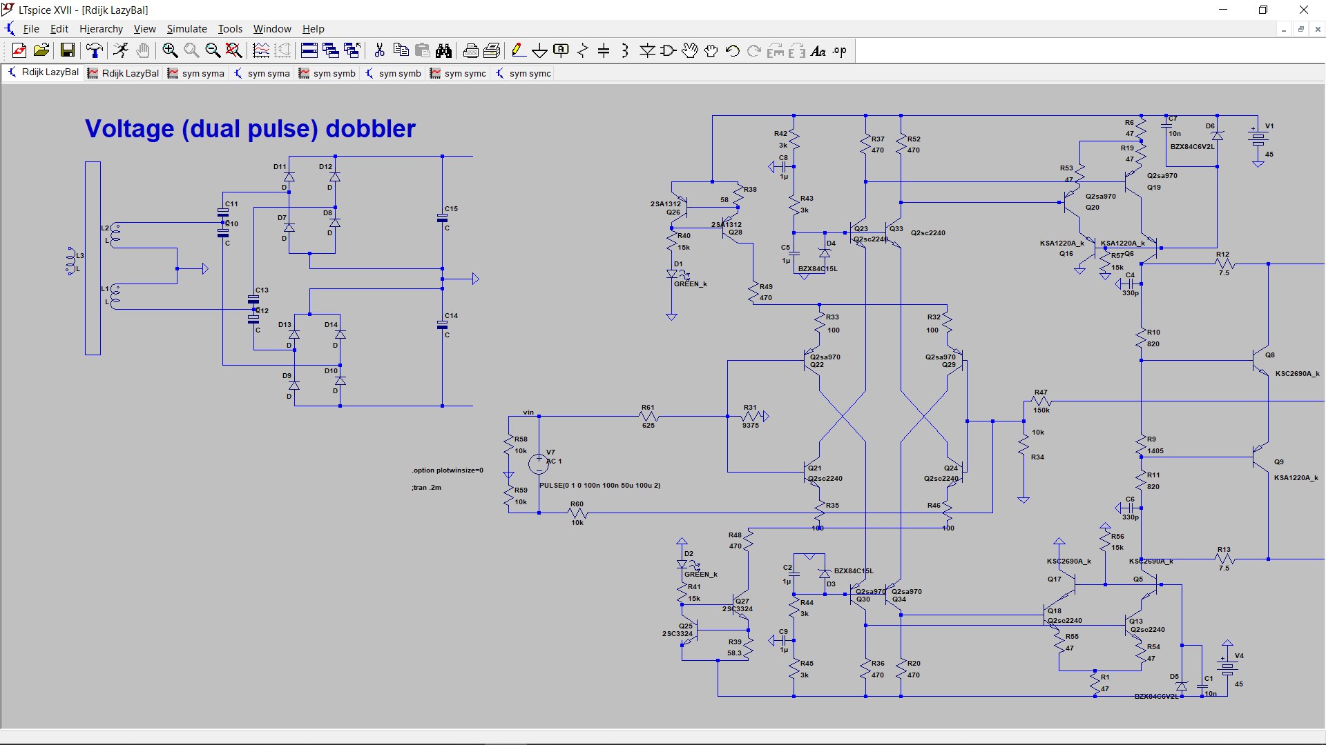

Power supply circ:
(R1 and R2 near 1 Ohm ripple second capasitor bank, R3 and R4 current setting [ (1.8-0.6)/current sett= R3=R4 ], D7 and D8 are voltage out max setting.
voltage first capasitors 37*1.42 -1.2= near 51V without load. should give effectively near 5 volt for regulation when near 45 V out)

Tnx. I've changed the R3, R4 to 15 Ohm. The front-end voltage isn't sag now (46.5V), but LEDs are off. I measured 1.5V on them.Have a nice modifying weekend.
Shall we finilize the schematic of the amplifier? Any thoughts about R Dijk input stage?
Les of means current regulating transistor is not yet putting out calculated current, but somthing like (1.5volt led -0.6 volt base emitter / 15 Ohm resistanc =60 mA thats just within dynamic ragne and peak no or near zero current for shunt regulation... well if you want a tuch more and light reduse R6 and R7. that is base current for current sorce transistors. reduse somthig like 20% if 10k use 8k ( or multiply by 0.8 if u like that bether ). new output 1.8V LED-0.6v base collector/ 15= 1.2/15 = near 80mA wich makes shore shunt transistors in powersupply output is never of. Some consider this safe side, others BULLSH|T. Remember its still one very important thing here: Its you that is making amplifier NOT everybody else. you want light or not its as simple as that.

This attached should work. C3, C5 and C12 is stabilizing for bad load. Here is a print screen.
