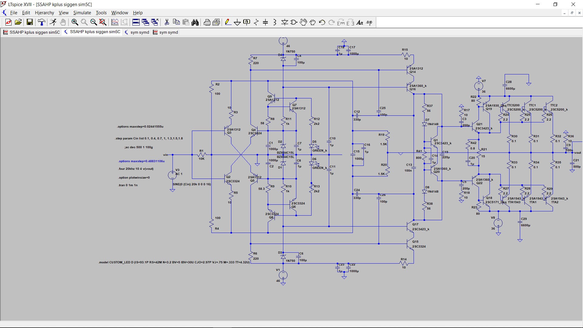

Could anybody please confirm what R Dijk stated about current input stage?
I've checked my front-end psu with 990R resistors load. Voltage drop across these resistors approximately 38V, which means 38.4mA. The sim shows 53mA current consumption for 4mA bias of input stage and 38.2mA current consumption for 3.1mA bias.
Perhaps this is the reason of my front-end psu voltage sag. Is it possible to increase the power output of my psu?

Yes, the primaries in parallel, single light bulb. I also tried to connect front-end supply directly to mains with the same result.are the primaries for these in parallel or do you have separate light bulbs for each?
Just connect a 10 Ohm resistor from positive to negative, that increases the power consumtion and therfore powersupply output. Or what the heck are you on to guess about this time????
Was it insulting for you I asked for confirmation of your statement, as I can see from your aggressive post?
This is not my schematic. I'm not familiar with design, that's why I need to ask people who took part in making it to work in simulation.
Thought this was yours: look at the name in pictures "SSAHP kplus siggen sim5C"

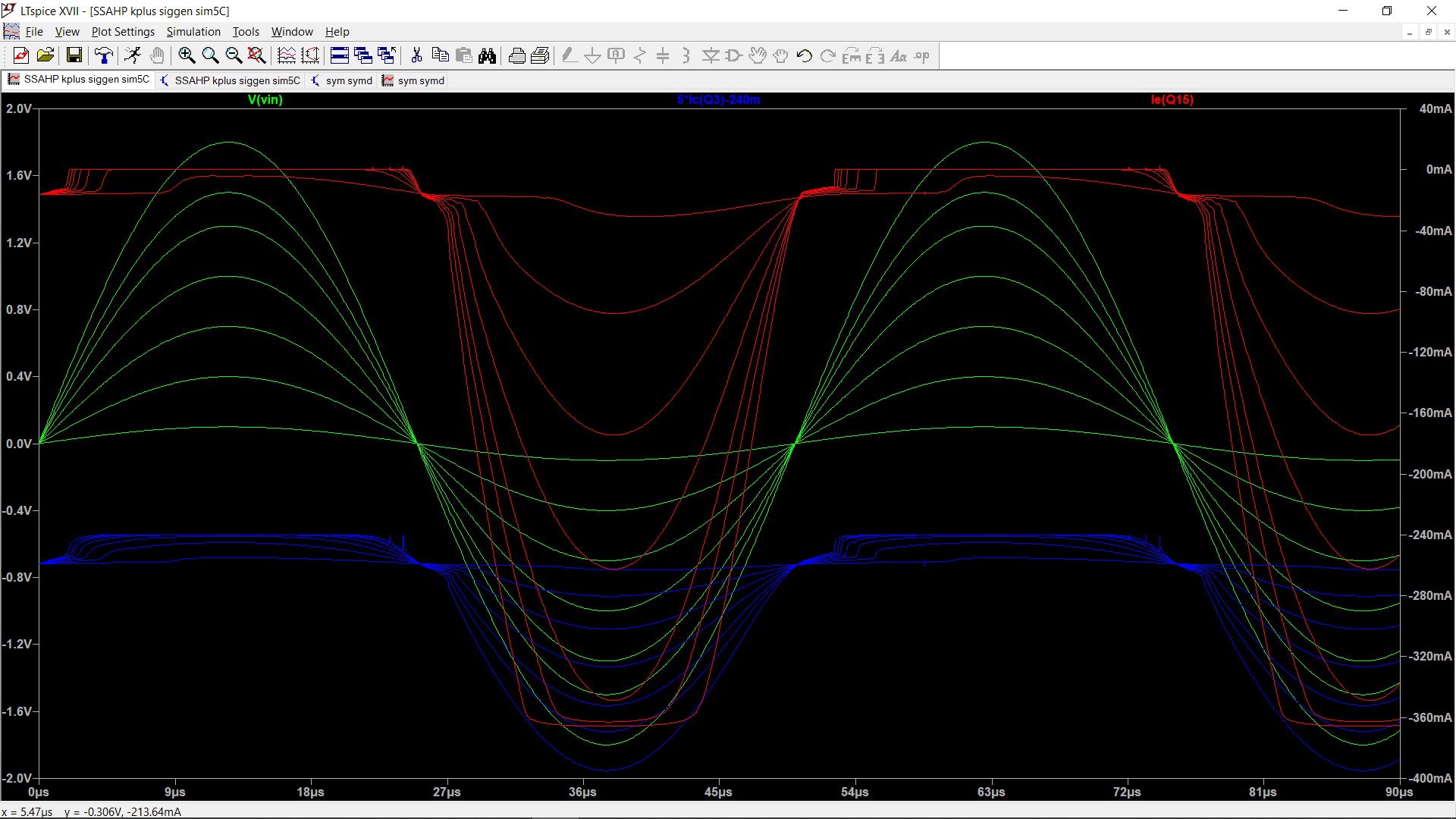

Change simmulation to transient setting and freq start time and stop time.
Previus posted simmulation results as picture of this circuit.
This circuit if from another abandoned thread.
Do you have an idea why front-end PSU sags? I've checked the voltage after rectifiers before transistors it's 49.8V with load and without load, after transistors 49.5V without load and 39V with load. As this is a shunt psu, input rectified voltage should be higher than the output voltage? Perhaps I need to have 10V higher secondary of the transformer for stable 50V output.
As you previously wrote, anomalies in the current input stage, at current sources cannot be eliminated by design change, only complete redesign of input stage is a solution? Your balanced buffered input is no longer CFA than?
A while back you mentioned some 1k resistors without identifying the part numbers. These appear to be R10 and R11 - putting together a picture from some other measurements the zener diodes associated with this (one being substituted by TL431) these drop voltages of 5V and 15V.
The supply rail feeding the combinations is +/- 39V. From this the voltage dropped by R10 and R11 is 24 V and by applying Ohms law I=V (Volts) divided by R (Ohms) is equal to 24/1000 = 24 ma.
The emitter voltages of Q16 and Q17 will be higher than their respective base voltages so these will conduct depending on the currents drawn through the bases.
At switch on you have observed the initial voltages of the input stage sag over a short time.
If you have a safety bulb in series with your transformer primary the efficiency of this component is reduced and charging of the main capacitor banks and the 1000uF caps in parallel with the 15 V zeners will be somewhat delayed until fully charged.
In this period the voltages at the bases of Q16 and Q17 will be close to those on the relevant supply rails and move apart during the charging period.
You can check this out by measuring the voltage drops at both ends of resistors one at a time with reference to ground - R10,R11,R14, and R15.
If Q16 and Q17 are driven too hard the impacts will be felt in the stages that follow. This is likely to be contained by the strictures of the light bulb on available current for the front end as well as the power stages. Nonetheless leave that in place for now.
The way to regulate base conduction in Q16 and Q17 depends on the values of R10 and R11. 2.2k would be a better choice - see what impact that has.

Not exactly. If you mean I mentioned some 1k resistors from post 709, this is stand alone testing of frontend psu without amp with help of 1k resistors. However R10, R11 on the pcb are the same. Zeners on the amp drop voltages, for example, from initial 49V input at 5V zeners to 44 Volts, which appears to be at bases of Q16, Q17, and to 15 Volts at 15V zeners. All these can be checked in the sim.
Light bulb has nothing to do with the sag (which is also present with frontend psu connected directly to mains) which is constant not only in charge time.
R10, R11 values are just right. If you check the sim I can raise them to 1.1k only to maintain 15V at D1, D2. With 2.2K there won't be 15V potential, only just 7-10V.
As I mentioned in previous post, more likely psu sag appears from not proper input voltage setting to shunt psu which my frontend is. Output voltage of shunt psu cannot be the same as it's input voltage.
Shunt psu, now you may have an high output resistance....
In witch post is your correct circuit with correct values ?
This Lazy cat circ do have the same issues whatever input trannies you are using. Yes i understand its not yours its your friends circ. The same you tried to fault trace for ore than a year without results?
Sorry to see somone using this topology. the input circuit is a bad topology.
