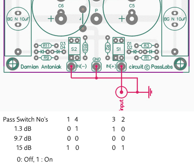

When using a master volume on the Input instead of the Output ( like in the original) a little bit more noise is noticed from the Mosfets. Not much but i guess audieble with senstive speakers.
The DIP switches is to alter the Gain on the input, 12 dB attenuation according to the manual.
Let us know what is happening. 🙂

In my continuing hunting of the hum I realised that the manual switch settings and Veterans switch layout need some translation. I've compared the service manual number and veterans schematic I think I'm on track now. The switch settings I had used were "non-settings" and while the hum still remains now it is at very low (and acceptable for the moment) levels.
In the attached graphic the dB figures refer to gain (as per service manual). To map the settings described in the user manual:
default = 15dB
12db attenuation = 1.3dB
hope this helps someone 🙂
cheers
Paul
