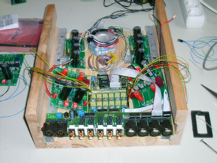

That looks sweet Wim ! 🙂
Have you tried the relvol yet??
I would like to know how well it works 🙂

Zei your shoebox install looks positively high end compared to my scattered around on a sheet of mdf setup :0 I'll take some pics when things look a bit more organised.

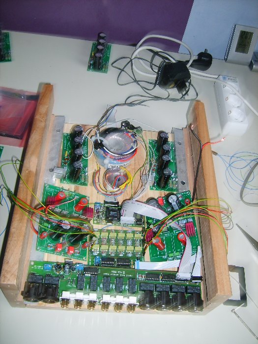

Along with the RelVol3 I've ordered Input2 and Control2 boards from dantimax. From Wim's pix it looks like he has gone the same route. Mine haven't arrived yet so I can't tell much more than replay the hype on the dantimax site 😉
You can see the Input2 clearly in Wim's pics - this is a relay select input board, with on board mute relays and board mounted XLR's/RCA.
I'm planning on rotary encoders for input select and volume... The control2 board just needs an IR receiver (which is integrated with the C2Panel options) to allow full remote control. 😎 😎

Volume and switching between inputs goes with encoders in my situation. So there are no switches on the front, only 2 encoders (Connected to the Contro2 board). Thats all.
The LCD display gives information about theactual channel and the volume level.
I am not going for the IR remote, so i do not even connect the little IR detector board. I leave it out.

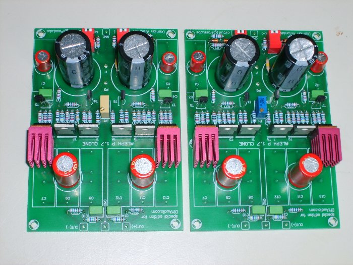

Bourns backwards?
I have what looks like an early version of Veteran's boards (with the mounting holes on the input side very close to the 1000uF caps) and I wasn't getting any change in gain by adjusting the 2k pot.
What I found was that the pot - P1 (Bourns 3296 2K multi-turn - 3296W-202LF-ND digikey #) needed to be installed backwards compared to the trimmer screw location on the board
The original way I installed it, it was shorting out the pins and provided no resistance - I've reinstalled it and confirm the resistance is adjustable now on the solder tabs, but I haven't had a chance to listen to it yet since taking it apart.
Just thought I would share that if anyone is having no effect from their trimmers as well.
