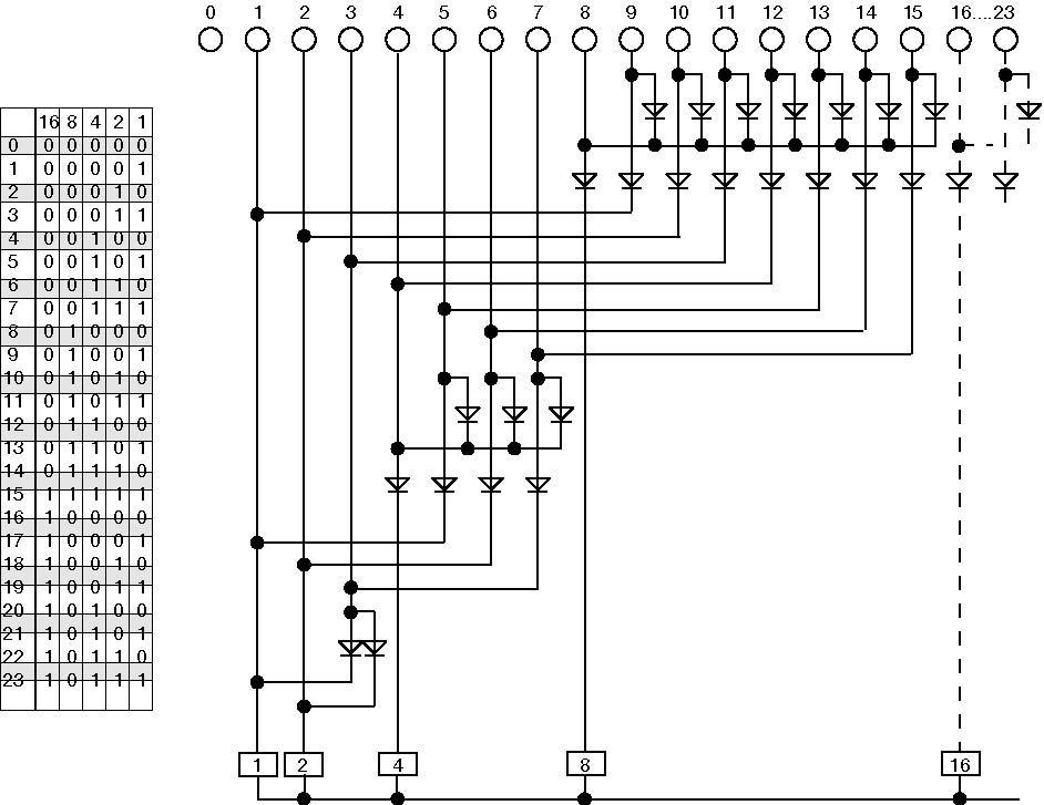

Economical approache to volume control
Open for discussion:
-I don´t like to use a uP
-I don´t like to use a 8-deck rotary switch for balanced output
volume control
-I like to use the least amount of relais
-I like to use the least amount of resistors
What do we need:
- a single deck 16 or 24 position rotary switch
- a diode matrix
- someone who comes up with an old but still buyable TTL IC
replacing the diodes
- 4 resp. 5 relays (x2 = stereo, x4 = balanced stereo)
- 4 resp. 5 resistors (x2 = stereo, x4 = balanced stereo)
- someone who comes up witch a neat program to calculate
the resistors, switched in parallel by the relais for a nice
log. curve.
volume control
What do we need:
- a diode matrix
log. curve.
You are making a mistake here. If you want to use digital bases of your relais control, you are bound to resistor values doubling for each bit.
If you want -60dB maximum attenuation and about 2dB per step, you would need 8 relais to compensate for the lineair resistor network and required logaritmic behavior.
At a pot impedance of 10K and minimum 32 steps starting at -60dB, you are looking to implement a lookup table to reduce the 32 wanted value out of the possible 256 (8 bit)
I have tested this and it works fine. However a PIC interface to the relais would be nice.
An other option is to program the bit values in a rom and use drive the address bits from a counter and use the data bits to drive the relais.
For those looking for small relais with 2xom contacts, I still have plenty left. let me know.
My goal
Hi Teake
the goal is the same, as I use Dale resistors to control the volume. If I can make up a simpler circuit, I can save a lot of money so I can use it otherwise....
Hi Teake
