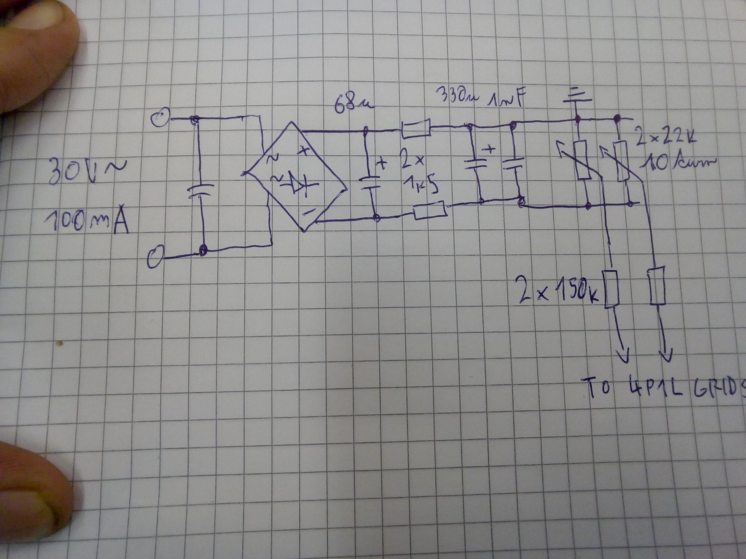

Hello guys, on the vacation Ive tried fixed bias so I could get rid of the cathode cap in the output stage.
My listening impressions are, that the fixed bias sound more natural and more focused and real, just like Andy says with the filament bias, but the highs seems more harsh and dirty, I dont know why, but maybe because the rectifying diode switching, or something like that.... So yes, I now undrstand why you recommend filament bias - because it is totally noise free from the beginning.
How to do properly the fixed bias?
Best regards, Michal

My schematic is here
Are you sure, that with these small capacitors the bias voltage is enough clear?
Using two bias potentiometer in the same negative voltage is "old school" method. Any change in one affects the other.
Why not use proper filtration and independent bias circuits?
Sample:
fixed bias supply I used cheap diodes...
UF4007 is enough good there. I used these diodes for decades in my fixed bias power supplies.
Okay. Thank you for the schematic.UF4007 is enough good there. I used these diodes for decades in my fixed bias power supplies.
I use some really normal slow diodes, but UF4007 is a fast diode as I know... I know that even 200uF in the whole bias supply is enough because there is absolutely NO HUM. Only the high frequency problem.
Maybe bypassing each diode with a 10-100nF ceramic cap will lower the problem a bit.

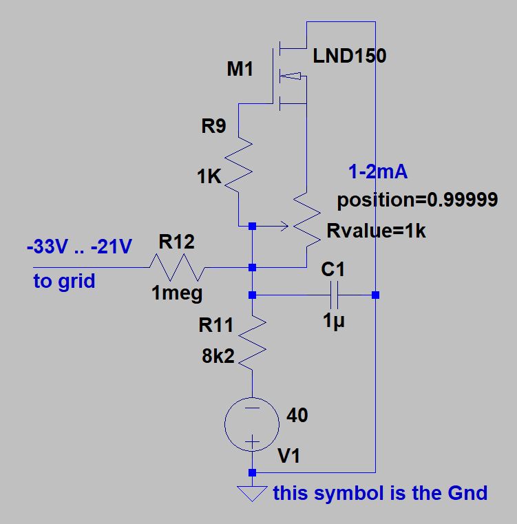

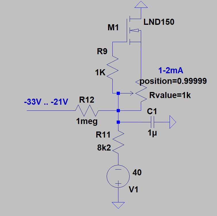

Can you please describe me which leg of the circuit is input, output, gnd, etc? Thank you very much.
khmmmm....
