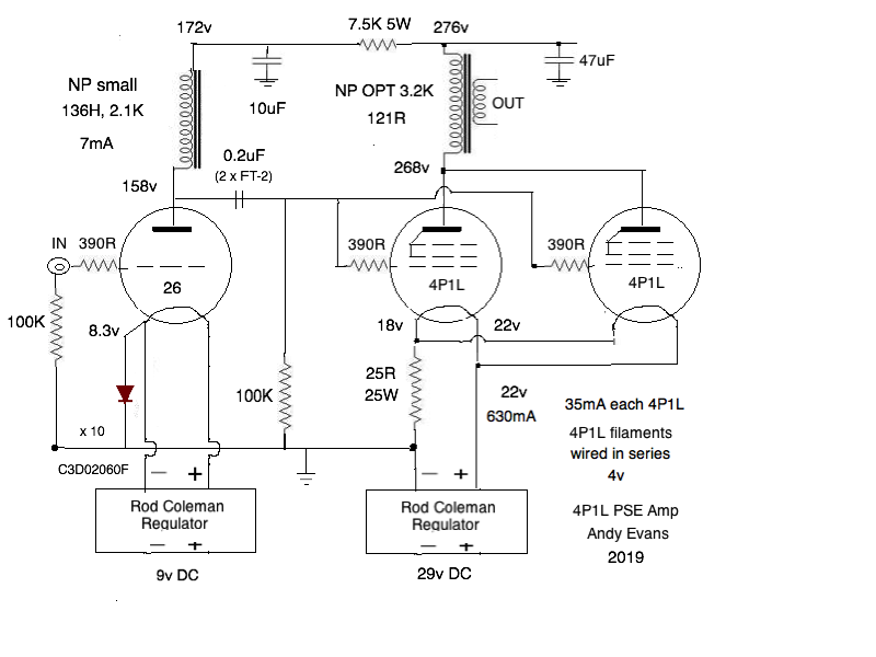

The Schematic is 4 posts back, 1183. My standard driver stage is 26 in SIC bias. I've also used 10Y which is very nice. I only use DHTs as drivers, and just 2 stages total.

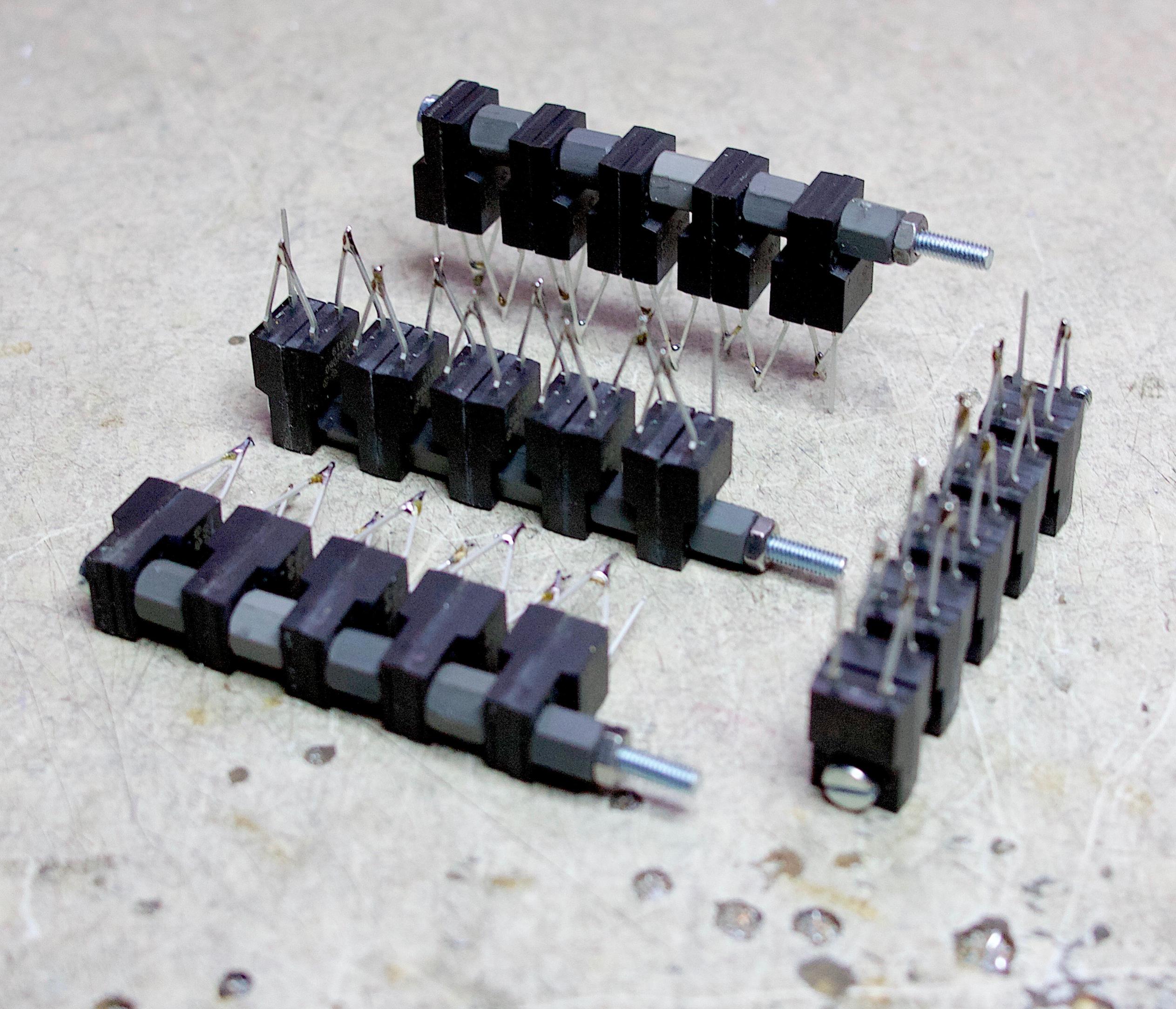

Mine couple stacks of 10 C3D02060F + 120R Shinkoh ready to bias the 26 preamp.
You don't need the resistor. Try with and without. Mine sounded better without.

Schematic is back in post 1138.
You can work out your preferred operating point using the curves and Ohms law. The schematic above shows one version. I'm shooting for 7mA since this is driving the outputs. More current in a driver would be better but I like the sound of the 26. You can put more current through the 10Y, but that gets expensive.

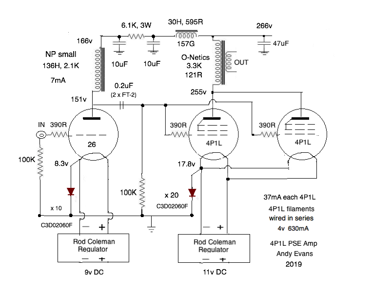

For the PSE 4P1L output stage, a string of 20 C3D02060F SIC diodes gives me 17.8v. Just tried it. I'm just finishing off the 26 input stage. Eager to hear this amp, which has the small "Commercial" 3.3K O'Netics OPTs instead of the Level 1 O'Netics 3.2K shown above.
Well, finished the build with O-Netics 3.3K "Commercial" OPT. The output stage is now in SIC diode bias. I have mixed feelings about the result. Using these SIC diodes you get more clarity and low level detail, but the sound can take on a certain hardness, almost stridency. For the input 26 stage this seems acceptable, as long as the outputs are in filament bias.
I was pretty comfortable with the amp outlined in post 1183. When you have 2 stages in SIC diode bias the sound gets more edgy. This is a shame because the added low level detail is most welcome, and voices can sound very intimate. I was liking it more on jazz vocals. Orchestral music was less satisfying - I lost the sheen on the strings and the overall sound wasn't smooth enough.
Right now I think I'll be going back to filament bias in the outputs unless I can come up with an ultra smooth driver stage. I can use the 10Y here and that would give a lot more current as a driver than the 7mA I'm using with the 26. The 6C4C stage I built was the smoothest (all in SIC diode bias here) but wasn't very exciting. I'll listen some more to this new amp but I'm not convinced, unfortunately, even though it does some things better.
