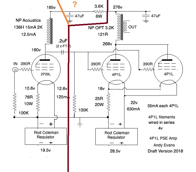

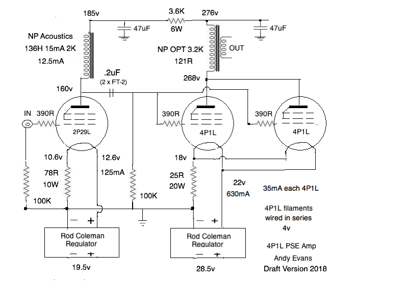

My slow ride to 4p1l nirvana is at the beginning. I bought the 4p1l and 2 Rod Coleman DHT Filament Regulators. What kind of transfers do I need for SE and PSE tor Mr. Coleman Regulator? 14V / 2A?
I prefer parallel-connected 4P1L filament (2.1V 650mA), and for SE or PSE you can use 6.3V 4A transformer. But, as Euro21 says, we need to know if you are using Filament Bias. Please post the schematic, if you have filament bias.
With any DHT, please use a separate 6.3V 4A transformer winding for L-channel and R-channel.
When halves of the filament are connected in parallel distortions are lower. 4П1Л is a directly heated tube, so the voltage drop on the filament in each articular point adds to the control grid bias. You can view each wire in the grid as a separate triode, so the more the difference between bias points is, the better they match each other. However, they are pretty linear in this particular tube, so the difference would not be audible, but still, theoretically it is better to connect halves of the filament in parallel.
I can only try to copy something like andyjevans amp

It makes total sense then to build the first stage and output stage in separate chassis, pre amp/power amp set up, I think Andy Evans advocated that.
I did that, works very well. For me now it's 01A in one case, 4P1Ls in two small monoblocks
It has been published by Andy Evans in various places. Do a basic search and you find the schematics. Basically everything to the right of the 100K resistor (including it) is the "power amp" Common bias point is 20V, so you need a pre-amp/driver that swings this voltage (40Vp-p) or just short of it to use the full power if 4P1L's
