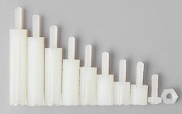

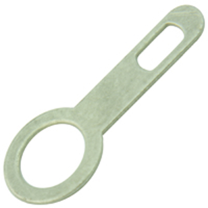

I use hex nylon spacers with solder tags on top for all my interiors and that's frankly all that's needed.

Here's some pictures. I mostly use M3 15mm spacers but carry a stock of shorter and longer. You need the Nyloc nuts to hold the solder tags otherwise the nylon overheats and the nuts come loose. Nyloc nuts hold well. I secure the spacers with a M3 bolt from the top of chassis through the 4mm top plates. So you do end up with visible bolt heads as you can see from the top of the chassis. Underneath it's all point to point.

Bear in mind also that if you use a lot of filament/HT/plate chokes or interstages you don't have much need for a PCB. I use hex nylon spacers with solder tags on top for all my interiors and that's frankly all that's needed.

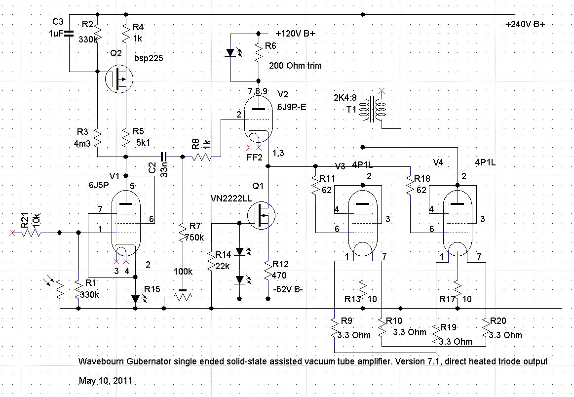

Just finished my first 4P1L PSE. Very Must like Andys schematic, but with gyrator and PSE wired in serie. I have only 10 hours on it and I can say for sure It just beat my belowed 2A3. Even if I have my huge Monolith Summit S-9 on it.
I'm using my Sowter S9, 5K as output transformer and it works very nice. I have separate PSU for HV and filament in 2 boxes. I have ordered better Caps for the gyrator and I'll consider to use my V-Cap CuTF 0.1uF, I have as a spare.

Current for filament bias solely depends on how much filaments draw. 325 mA +/- 25 mA per tube when halves are in series, or 650 mA +/- 50 mA per tube when halves are in parallel.
Current that each anode draws you should estimate by load lines, according to your B+ and output transformer primary impedance.
Then you should calculate the value of caathode bias resistor, summing both current supplied by ande to cathode current and filament current, according to the bias voltage you've selected from load lines.
If you want total current consumed from B+ source, you need to add what the driver consumes. If you want to use Ale's design, you should read carefully what he wrote on his webpage.

Go to Aly's web page and you'd easily find it. My plan is to use up all the parts I have in hand. The ptx is Hammond 300-0-300 200mA, 5U4 to clclc, Lundhal 1623 60mA and two seperate ptx for 6p1l filaments, Ron's filament boards, nothing special really.
That sounds OK. Incidentally, it's Ale not Aly. Short for Alejandro. If you don't need the gain of the 6E5P (around 30) consider the 2P29L (around 9). Depends how sensitive your speakers are and if you have an input voltage of over 2v.
In my original design I used 6J5P. They are as good as 6E5P in triode, the same amplification around 30, but still real "sleepers". One more option is Soviet 6J4, in a black metal case. However, today I would use a MOSFET source follower loaded on a CCS, with 1.5-2 times higher negative voltage source, instead of a cathode follower. Why I used a tube then, to avoid capacitances of MOSFETs.

So I also built a 4P1L PSE amp courtesy of Andy Evans posting this beautifully simple schematic. Filament bias via Rod Coleman's regulators, Silk Audio output transformer, 290V of B+, 40mA per tube
The thing sounds gorgeous with vocals and instrumental music. I built one channel only so far, and listened to it mono for a few hours. It's driven by Aikido preamp and speakers are Mission M73 connected to 8R tap
Now is it me, or does this set up fall a bit short on rock music with more (heavy) bass? B+ so far is unregulated 50uF - 7H - 50uF supply. I have space in the chassis to add a regulator, SSHV or Maida, will it improve my bass?
I am really on the fence, wrap it up, build 2nd channel and enjoy, or keep tweaking. I know this is DIY and I have to try it all myself, but I would appreciate some nudge in the right direction

With a 5U4 or other valve rectifier?
The 50µ-7H-50µF storage is too low for hard bass, you are right.
But with thermionic rectifiers, increasing the C values is not a good idea.
Changing to the Wolfspeed SiC rectifiers, and using high quality industrial capactors is one way forward. For my SE, I use 1200V 8A diodes (in a bridge), and 2x 820µF 550V ALS60 (Kemet) per channel. These caps are much better than low-value items, including fancy «audio» types.
