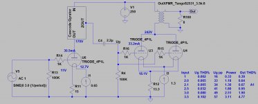

Here's my output stage. For the input stage you can use Ale Moglia's gyrator. Either 01A Gen 2, or 2P29L. Details on his Bartola Valves site.

I am taking the 4P1L plunge. It's been a few years since I built a power amp for myself so I have an itch that needs scratching.
I got Pete's A2 driver board which I will use to directly couple to the output stage. I am certainly going single ended but I have 3k:8 output iron, I should parallel two 4P1L's for this load correct?
Now for the voltage amp section...........I read these are easy to drive no? How much drive signal do I need? The voltage amp will be a common cathode triode with a CCS anode load. Can I get away with a 6SN7 stage or do I need more gain? I was also thinking of triode wiring a 6AU6A as I have a bunch laying around.
I am going to order Rod's regulator boards for the filaments. Are you guys running each parallel channel in series and then the two channels in parallel? Or are you running them all in series? Or all in parallel?

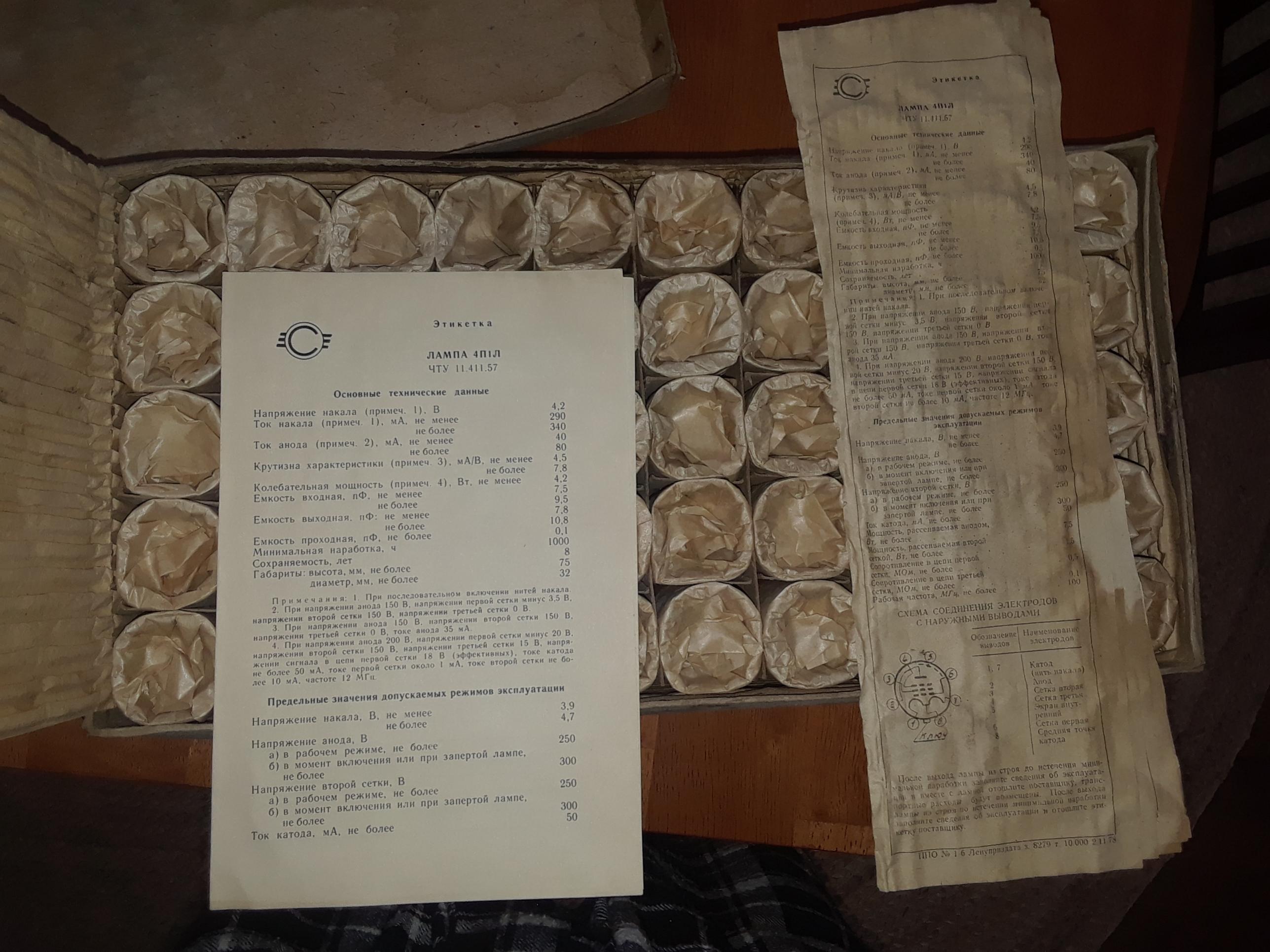

I bought a whole box of these babies. From Russia with love <3

How much gain you need? With 4P1L PSE output stage you can use any DHT of 8-10 mu. I’d go for 2P29L,4P1L, 10Y, 01a. All gyrator loaded cap coupled to your mosfet follower for A2 with fixed bias
DHT Drivers with filament bias
If you need a tad more gain: 6e5p or 6e6pdr are my best and favourite drivers
You can degenerate the stage with an unbypassed cathode resistor and works like a charm!

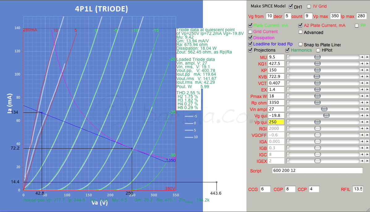

My sources are about 2v peak so my gain is dependent on A2 to reach say 5 watts from two 4P1L's in parallel. I was thinking I need gain of 20 or more for the voltage amp section?
From the curve tracer on your site I see 30mA @ 250v is roughly -18v bias

You need 20Vrms input for 6W output. Therefore a mu of 10-15 should be minimum.
You could push the 4P1L to 300V, which can work fine but keep them on the 9-10W limit. Otherwise they will run noisy and lifespan is reduced.

Okay so 20vrms is pretty much ballpark for what I thought to get that power. I don't plan to go to 300v, 250v was what I have iron for.
Those curves look like for two in parallel. Wow, 6 watts and 2.5%THD that is great I can't wait to build.
Curves are for one 4P1L but I adjusted scale and model to simulate a pair of valves
