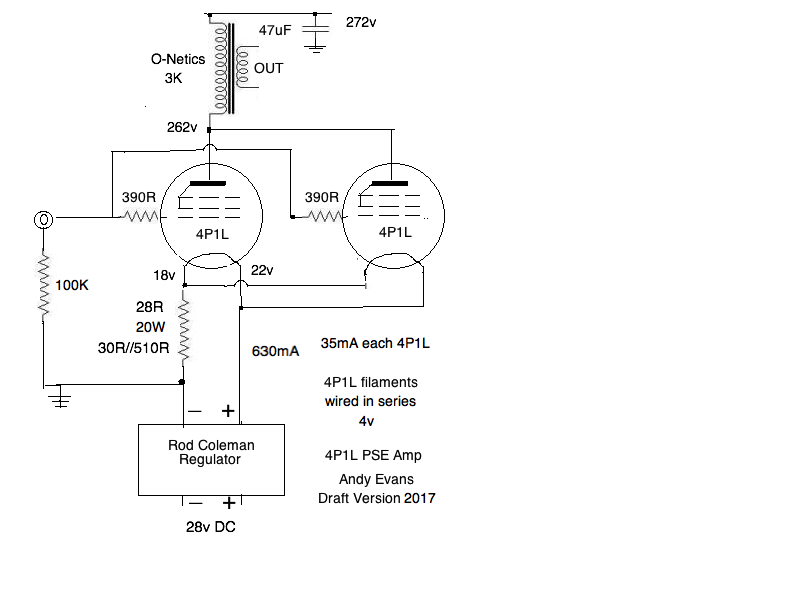

Andy, I'm intrigued with your PSE 4P1L amp. Will it work out ok with the two FSO-30 MQ transformers I have from a not finished set of Welborne Laurel kits I have? I'm hesitant to finish the Laurels, given the price of good 300Bs....... And, where are the O-netics OTs available?

I can't find specs on those, but anything designed for a 300b SE should work. Just needs to be 3K to 5K and capable of 70mA current. That's many SE OPTs. Yes - 4P1Ls are much, much cheaper - buy a dozen and have tubes for many years to come! Use them in filament bias and preferably with a choke input filament supply. Regs from Rod Coleman. It's a great sound - clarity will bring a smile to your face.

Those Dynaco transformers will be "gapped" for a push pull amp which will have a very low net DC flux since it will cancel between the half windings but may saturate with the DC bias current of an SE amp. Maybe not a good fit although I've heard of folks using PP transformers for SE at much reduced bias currents.
You'd be better of selling those and buying a budget pair of single ended transformers.Hi Andy

You can think of a 4P1L as a 45 tube and a pair of them as a 2a3. Not far off, though different operating points. So 5K Sowter SE09 95ma would do for either 2 or in fact 3 of 4P1L.
The Dynaco push-poll transformers would do for 4 of 4P1L in PP - a pair either side. Think push-pull 2a3s. Filament bias isn't impossible in push pull - I have a half-finished amp exactly like this with a 6K OPT. I don't need PP, but it's an interesting experiment. I have loads of 4P1L.

How about PPP 4P1L's with your transformers but run them in pentode with plate to grid local feedback? Could use a CCS in the cathodes for good differential amplification. You might even also use the UL taps on the primaries to feed the driver stage for the local feedback aka e-linear.
Here's a nice PPP example using a 5k output transformer which isn't too far from the 4.3k of the Dynaco's. This one is triode connected 4P1L's. I expect you could make a very nice sounding amp.

You could also try the PP outputs in parafeed SE with either a CCS/gyrator for the plate DC load or a choke. Then you have no DC in the output primary.

Some thoughts. Yesterday I wired a pair of 4P1L as PSE and hooked it up to me Lab Powersupply.
As I'm properly the only left who runs my 4P1L with 8R as Cathode resistor, build it a long time ago, and I'm very happy.
I fired them up, and gave them 1.2 Amps on but 8R and 16R as the cathode resistor and saw a huge different in the required voltage.
The 8R requires 11.8 volt and the 16R requires 21.8 volt + the 3.5 volt for Rod Coleman 7 boards.
Shouldn't it be possible to run it on 8R instead of the 15-16R I see on all schematics ??? It's a lot less heating to handle.
8R*0.6A= 4.8V
This is quite low bias, curve's operating points (for example about 115V, 30mA) not so optimal (below 4V bias the distortion is growing).
With double filament current (PSE), the op. points -about 9.6V bias- provides greater reserve (for example at about 140V, 30mA per tube).
First: what is the goal (operating point).
Second: how much bias voltage requiring to achieve around this op. point.
