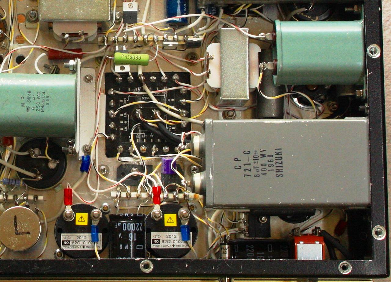

Hi
I use a very old Shizuki cap(8mF 400V 1968),but good at leak resistance.

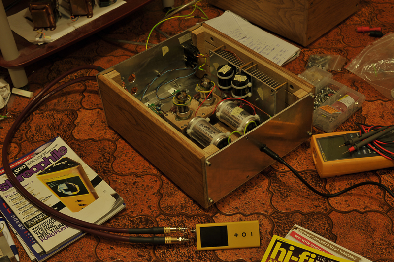

Some time ago I made a two chassis 4p1l parafeed SPUD headphone amplifer for use with my Grado headphones. It uses CCS'es for anode load and Magnequest EXO-45 and paper oil capacitors in the output. And with filament bias of course. With more than 1V rms input it gets plenty loud. I tried out the 5842 and the 6N6 tubes first, but soundwise they were left in the dust by the almighty 4p1l. The most noiseless amp I have ever built and with superb bass.

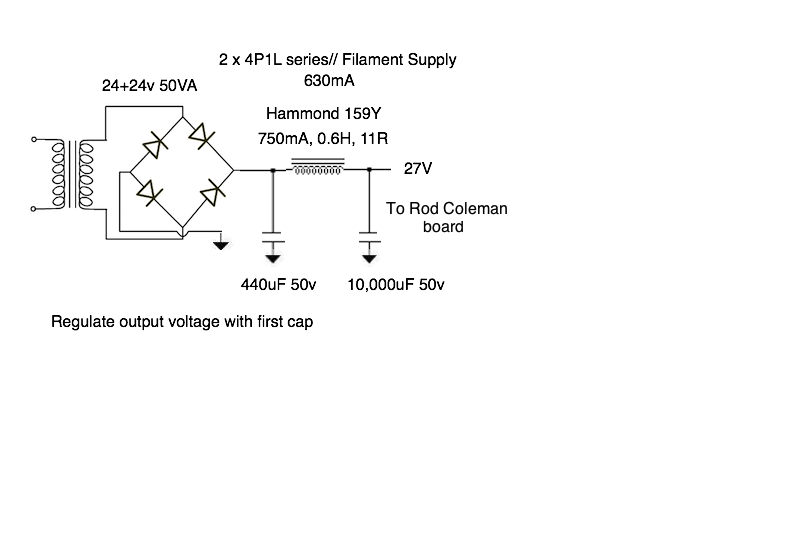

Here's some hopefully useful information on a filament supply for 2 x 4P1L PSE, wired each in series then in parallel for 630mA at 4v. I used basic components, nothing exotic.
Transformer is a 50VA 0-24v 0-24v, twin secondaries, so 1.04A per secondary. This covers the 2 supplies. Choke is a Hammond 159Y rated 750mA. Main cap is 10,000uF at 50v. I regulated the output voltage with the first small cap. 220uF gave me around 26v, 440uF 27v and I could go on up for more output voltage. Using the first cap to regulate the voltage gives a bit of a quasi-choke input so better than a dropper resistor on the output.
I'm shooting for 17v to 18v bias for 30mA to 35mA per 4P1L, depending on anode-cathode voltage. Here I'm looking for 240v to 250v. I'm after an anode dissipation of 8W to 9W (9W max for 4P1L). It's on the bench right now so haven't made it all up and listened to it yet. I hope there's enough headroom and the transformer and chokes don't get hot. I could size it all up
Further bench testing of the above filament supply shows the maximum it will produce whatever the size of the first cap is around 26v. I had hoped for a bit more flexibility, like up to 30v. The Hammond 159Y is 11 ohms and this drops 7v at 630mA. Too much for me. Alternatives are the Hammond 159ZA, 300mH at 1A which drops 3.8v and the 159ZC 60mA at 2A which drops 0.5v. Both of those would give some more volts if needed. The other way of doing it is to use a 0-30 0-30v transformer but that's not a standard voltage.
