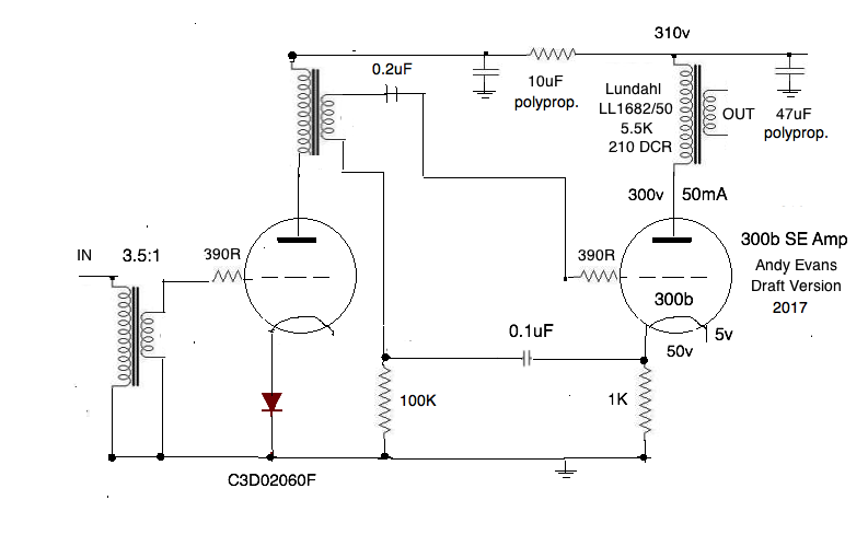

Today I finished off a 300b amp. Not optimised, but a decent build. Lundahl OPT, Rod Coleman regs on the filaments, cathode bias with large polypropylene bypasses. 2 stage, with a EF180 with a gyrator and SIC diode bias.
Not even in the ballpark with my PSE 4P1L build with 26 first stage. I abandoned 300b amps years ago and this hasn't really changed my conclusion that an all-DHT 2 stage amp with filament bias on the PSE 4P1Ls will out-sound a 2 stage 300b build with the inevitable indirectly heated driver.

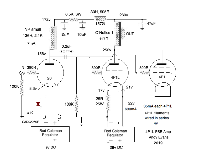

Here's my current 4P1L PSE:

There is no inevitability about an indirectly heated driver in a 300B amp. Why don’t yo do what Vinylsavor and others do, use a stepup input transformer and a DHT driver. A 1:4 stepup and a 4P1L would probably do.

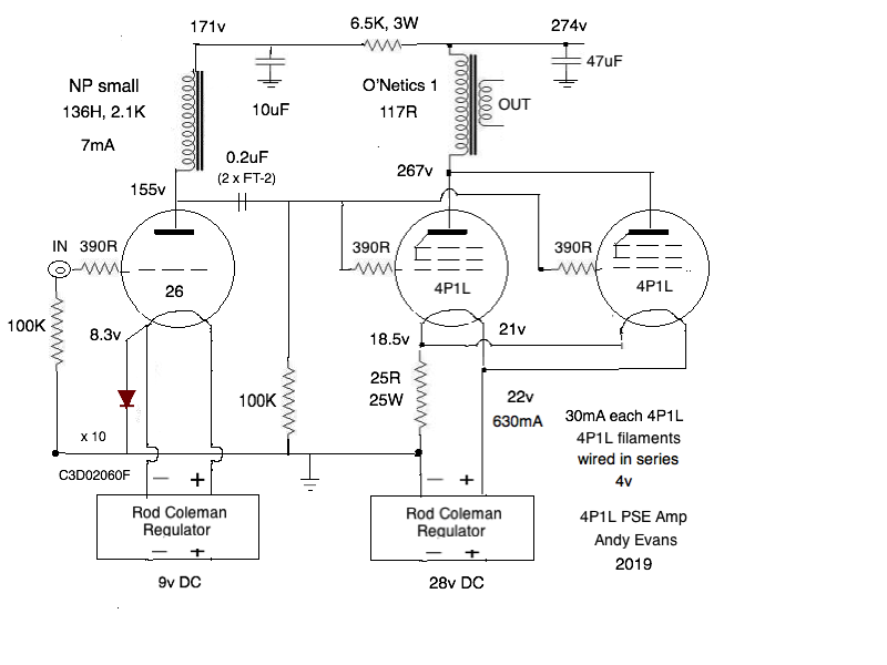

As for a "simple" 4P1L SET, the minimum I would build is a PSE output stage in filament bias. Anything else is false economy. You need to plan these things from the start. Preferably with outboard power supply and filament supplies. Here's a slightly different version of my current build

to a single 26 tube with filament bias , and CCS load at 4.5ma
with the low gain of the 26 i only have 1w output max but i have a 98db speaker i don't care. i will try the lundahl choke input step up option later.
Thanks! yes i agree planing to do it right from the start would be ideal. However i was really just planning to kill a bit of time while we are confined, and ive been itching to build something new for quite a while now

thanks Andy , that's the same i have with E55L sSIC bias vs Resistor. another thing , what is the exact model and Price of your 26 amorphous choke load ? best regards rohan
I have 3 amorphous core plate chokes, all really good and the best I've used. All from NP acoustics. Prices are very good value, and he is a really nice guy. The only cost you have to deal with is shipping. Best to contact him. He's on Facebook a lot for instance. Search for Phuong Nguyen Nguyen, Phuong Audio Reference, NP Acoustics. Send him a friend request. With the shipping, it's probably best to buy at least 2 chokes. I have a big one 40mA and a small one 15mA. The big one is slightly better, more detailed. Strangely they were the same price. Tell him you want the ones he made for me so he knows what, or otherwise order what you need. I should think he would be glad to make some plate chokes right now.

For best results you should use the highest quality input transformer that you can lay your hands on. I may be partial as I live 50 miles from the Lundahl factory and use a lot of Lundahls in my gear, but I usually use the LL1674 (amorphous core) and the LL7903 (mumetal) for power amp input duty.
There is also something you can do to get rid of the pesky cathode bypass capacitor. This method was often used in the 1930-ies when large caps were not available. Instead of bypassing the cathode to ground you bypass it to the grid. This means that you can use a cap that is MUCH smaller than the cathode to ground capacitor. You do have to use transformer coupling to make this work, though. This is how it is done. You connect a small cap (C) from the cathode to the ”cold” end of the interstage transformer secondary. From this point you connect a resistor (R) to ground. The capacitor is smaller than the cathode bias cap in the ratio RkR+Rk), (RDH4, p. 538). Example: Let’s say that the cathode resistor (Rk) is 1000 Ohms and R is 100 KOhms. Then 1000:100 000+ 1000=0.001. If you use a 100uF cathode bypass cap you multiply it by 0.001 and you get a 0.1 uF cap. Or you could use a 0.2 uF cap and a 47 Kohm resistor. This is russian teflon cap territory.
