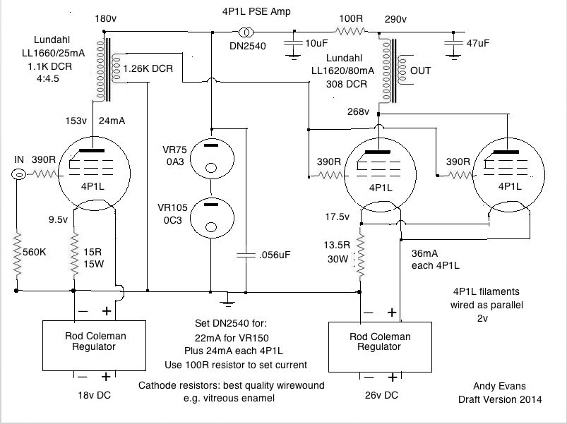

I have read everything on your "shiny eyes" blog. According to your schematic I can
see that a huge amount of power is going throught the cathode resistors...
Is it really these numbers ???
power - 280v*120ma = 33.6 watt
driver - 15*560ma = 8.4 watt
PSE - 28*1300ma = 36.4 watt
And for a Stereo (33.6+8.4+36.4)*2 = 156.8 watt.
I thing I have read that Andy's power consumption on his 4P1L PSE was about 100 watt.
Have you tried to measure yours ??
I can see on both of your schematic that you're using huge resistors, don't the get really really hot ??

This is why fixed bias is a good idea... Filament bias has it's uses but I wouldn't do a power amp using it
316a
316a
316a
Well, yes if fixed bias sounded as good as filament bias. In both cases we don't have the cathode bypass cap, so that's progress. I have tried fixed bias but haven't yet got it to sound as good as filament bias. I do have a kit that Rod Coleman kindly sent me, but I haven't had time to build it yet - I've been very busy with work. I'm personally not worried about the power consumption - since my outputs are 4P1Ls I've saved a ton of money over using 300bs, so I'm well ahead.

Hi Michael,
The power consumption is about 270VA ( I measured using an energy monitor such as thishttp://www.amazon.com/P3-P4400-Electricity-Usage-Monitor/dp/B00009MDBU/ref=pd_bxgy_hi_img_z)
I know it is a huge consumption ( prety much the energy efficiency of this device is close to zero) but the sound is rewarding. I am happy to use it in the winter though...radiates a good amount of heat.
The resistors in the cathode ( filament) circuit dissipate about 27W ( for the final stage ) and they get very hot ( can't be touched). I can run the amp 24 hours continuously and after an hour or so the temperature reaches a stabil point and things are not drifting anymore.
All. I can say is that I am very happy with the amp except for its weight.
Best,
Radu

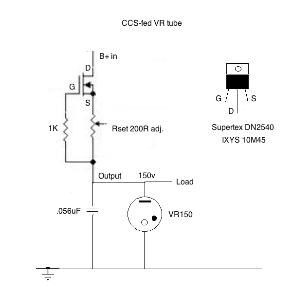

Andy can you please post schematic of your DN2540 CCS in your posted schematic?
Are you using two cascode DN2540?
Is there any difference between your CCS and regular DN2540 CCS in tube anode?
Thanks.
Thanks.
Thanks.
This is for smoothing the B+ before the Glow Tube VR, not as an anode load. I use interstage transformers. The device is mounted on a small heatsink which is isolated from the chassis.

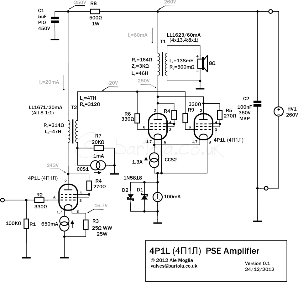

I´m working on following designs:
https://simplepleasuretubeamps.word...e-all-4p1l-prototype-amplifier-final-testing/
http://www.bartola.co.uk/valves/wp-content/uploads/2012/12/4P1L-PSE-version-01.png
... more to come...
... more to come...

These are more or less the circuit I built with slight variations - Radu is very close and Ale has fixed bias for the finals. Voltages and currents are all similar. Let us know how it goes. You get very good sound from this circuit.

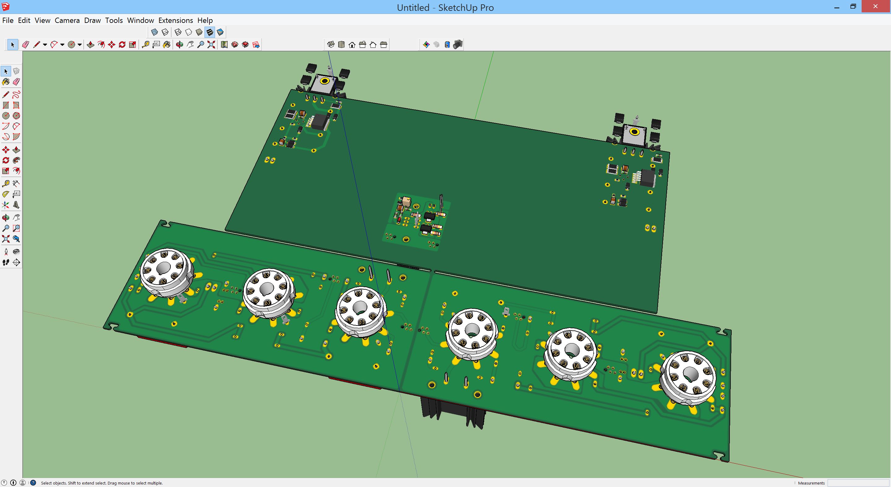

... octal have to be replaced by loctal (3D definition pending: will order some PCB loctal sockets from Loktal Gold Print - röhrenhaus.de).
2 Maida regulators placed.
First CCCV regulator placed (needs 3 more and the raw DC voltage!).
... more coming...
... more coming...
