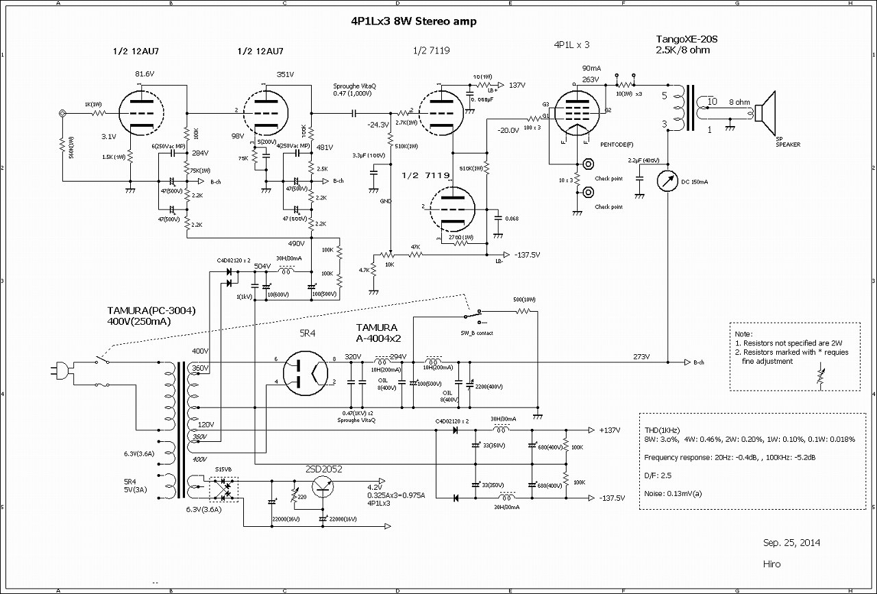

A modified version of the previous introduced 4P1Lx3 amp
In order to set up for lower voltage input e.g. lower than 1V, I attempted to insert 2 stage voltage amplifier to the former 4P1Lx3 single stage amp (#746).
As a result, it was made known that the distortion (THD) level has lowered considerably, because of cancelation of 2`nd harmonics worked.
At the same time, it was confirmed of the wider frequency response with no NFB amp.
For the first week I have been listening high resolution sources with this amp and I feel it comfortable at warmth and clarity.
THD: 8W:3.4%, 2W:0.21%, 1W:0.11%, 0.1W:0.028%
Frequency response: 20Hz:-0.4dB, 100kHz:-5.2dB
D/F: 2.5
Residual noise: 0.13mV
Hiro
I replaced the battery biasing with a7119 as a direct coupling cathode follower with CCS on my experimental 4P1L PSE amp and that the plate voltage on the 4P1L raised to ca 280V in A2 class.
As a result, the output was increased to 10W with non clipping and that its THD has been improved in all output ranges.
The 4P1Ls in use are running in between 8.5W~9W of plate dissipation.
For verify the durability of 4P1Ls, I shall continue to run on the above conditions for the time being.

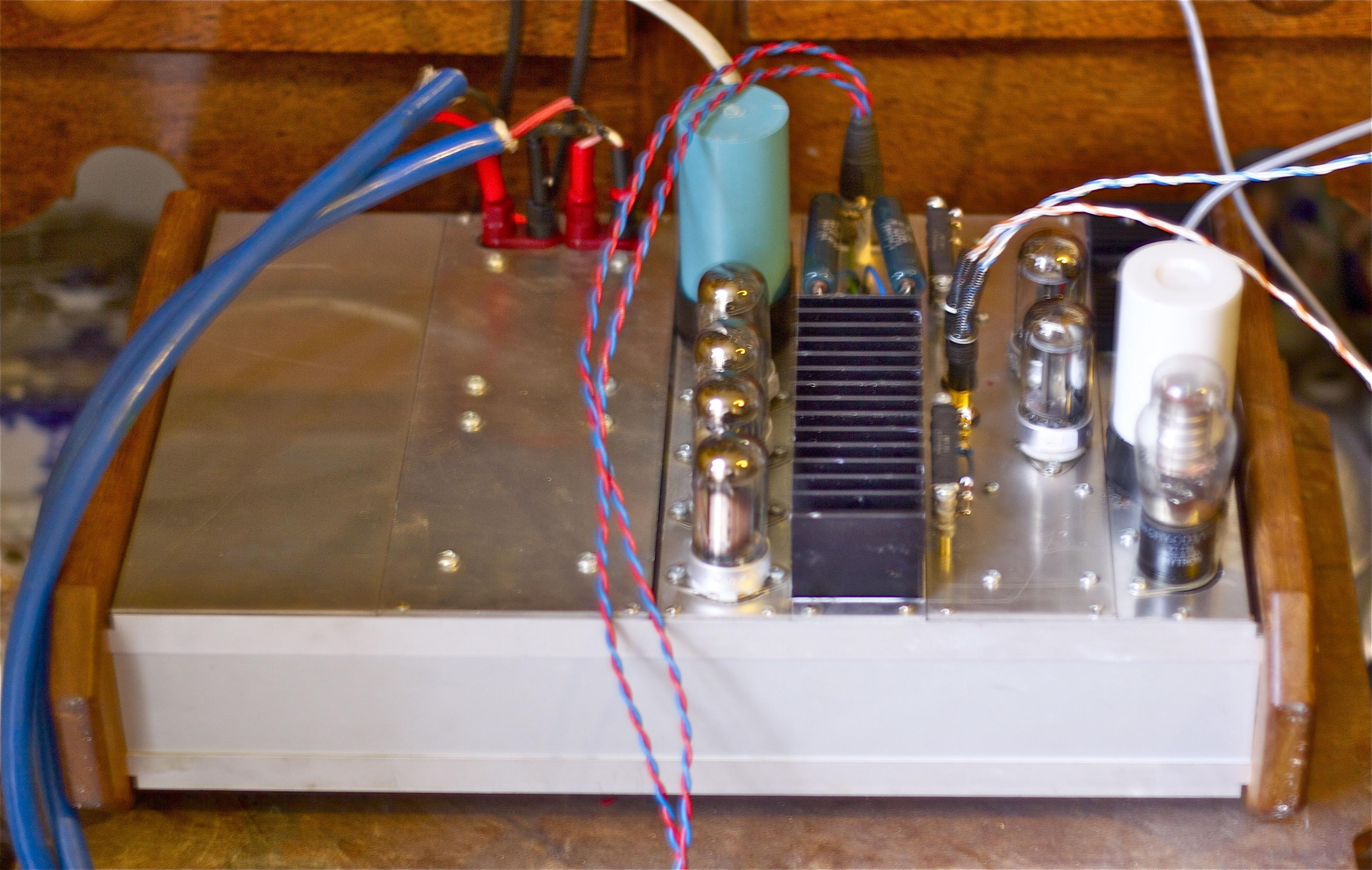

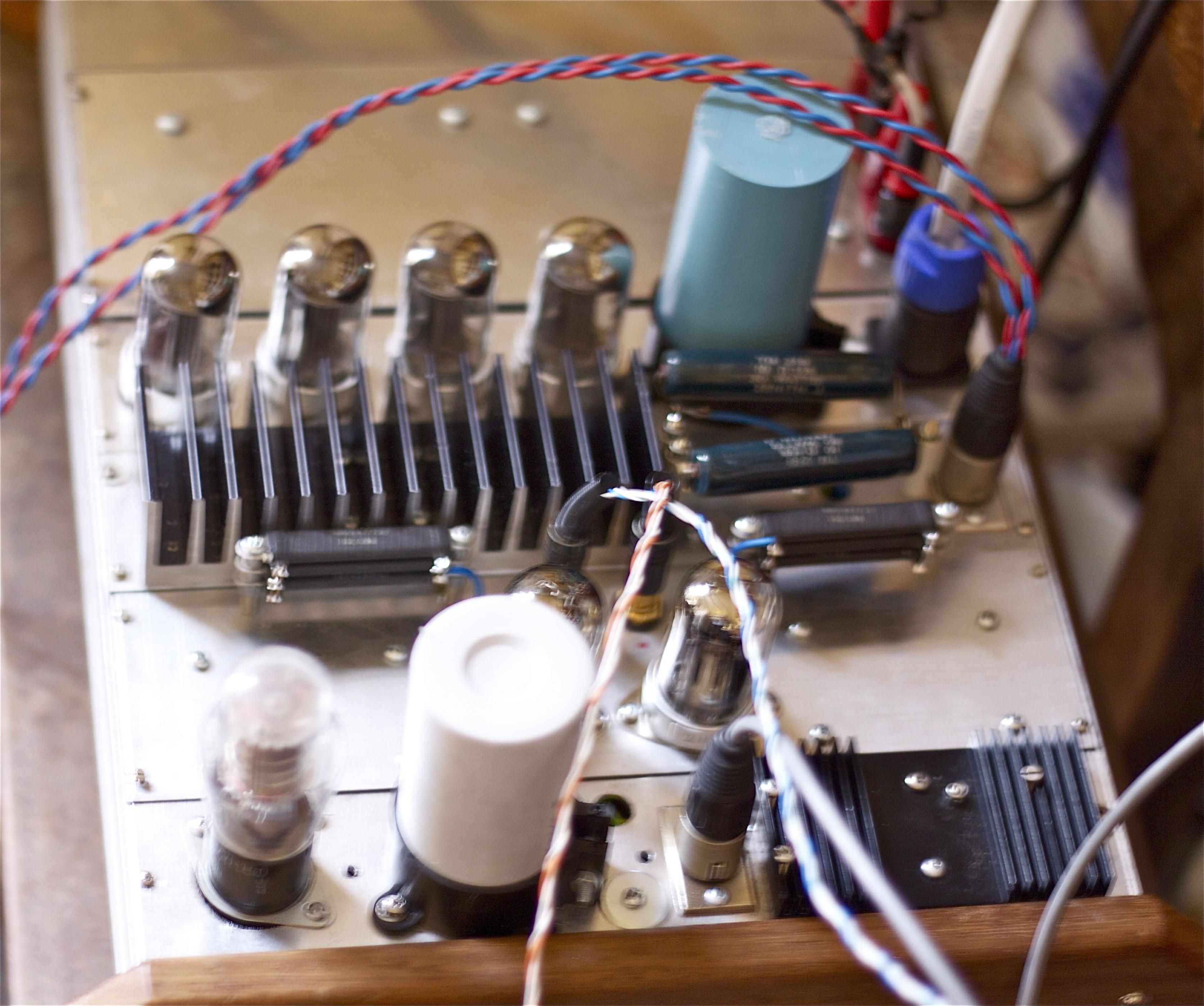

Looks like the Sowter is gapped for 95mA so that will be fine. You could even use 3 x 4P1L if you decreased the current to 30mA on the output tubes, but with that it would be better to have a 2.5K OPT. It has 4/8/16 ohm taps, so you could play around with those depending on what impedance your speakers are.
Here's the amp. It only has one VR tube by the white capacitor because my LL1660 is 18mA not the preferred 25mA, so I have 150v going into it. The 25mA version is the one to have. The power supplies are in different chassis of course. The connectors are XLR 4-pin for the filaments and Speakon 4-way for the HT.

Can see that you have mounted the 4P1L tubes directly on the chassic. And this is not a problem with microphonic I guess 🙂

I use Beyma 15XT which are 97dB sensitive . I mount my 4P1L on those little black steel 'shockproof' plates which use grommets for isolation . You can find these on Ebay . I get noises if I tap the valves with a screwdriver , although I do find at times when I pause the music there are some ringing noises through the speakers . I now use either multiples of viton 'O' rings on the valves or Pearl coolers . There is some mechanical noise from the 4P1L themselves at warmup but apart from that , these valves are fine if correctly treated . I would suggest if not using a subchassis for the 4P1L , to add some damping on the underside of the top plate . Rubber roofing underlay is good for this (and cheap)

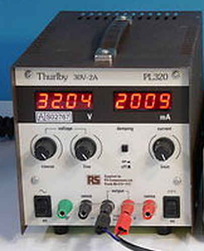

I use these a lot - Thurlby Thander PL320 bench supplies 30v 2A. I get them off ebay. Or you can use a similar one. Good for experiments and sound as good as a choke input supply.

I have a labor PSU myself, but I was thinking of a Filament PSU, more convenient for build in.
