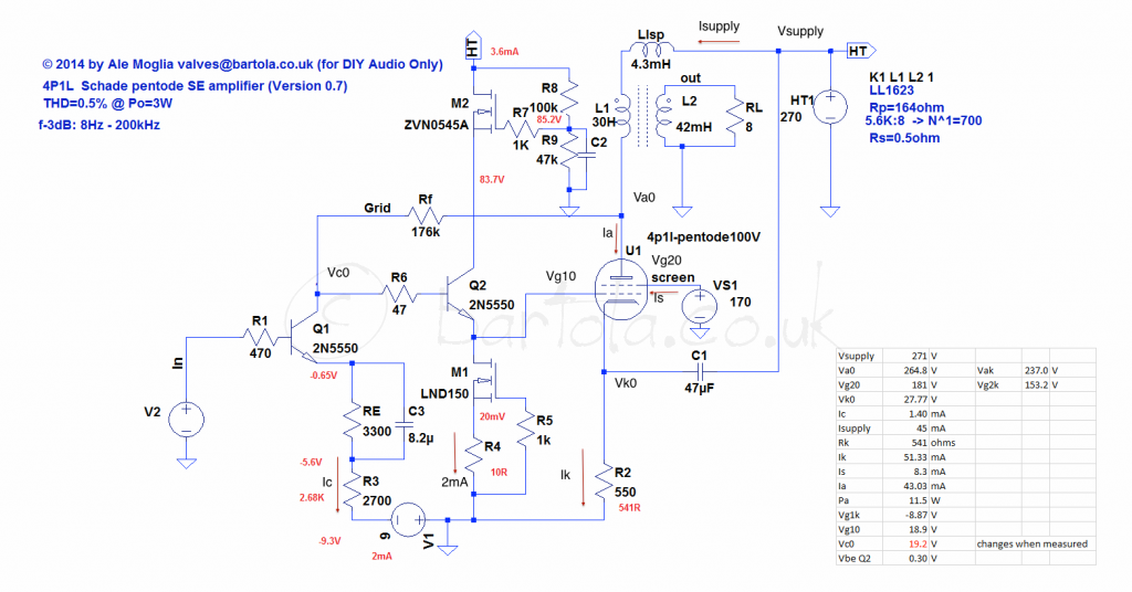

Very Good, Ale,
Don't worry too much about the driver bypass capacitor - it is small enough for film, and unlike a endstage bypass cap, it passes only a small current, in series with 2,7K. This will mean little degradation, in practice.
Lower bias supply for the driver is less desirable, both from the distortion viewpoint (the difference in 5th is not trivial) - but - as the simulation will not reveal - the dc stability will degrade.
BJT performs better in simple circuits like this, because gm is higher, and Cob is lower, for a given operating condition.
Personally, with cathode-bias endstage, I prefer the WE cap connected network C1, C2, (C1 = effective mu * C2) for best sound and supply rejection.

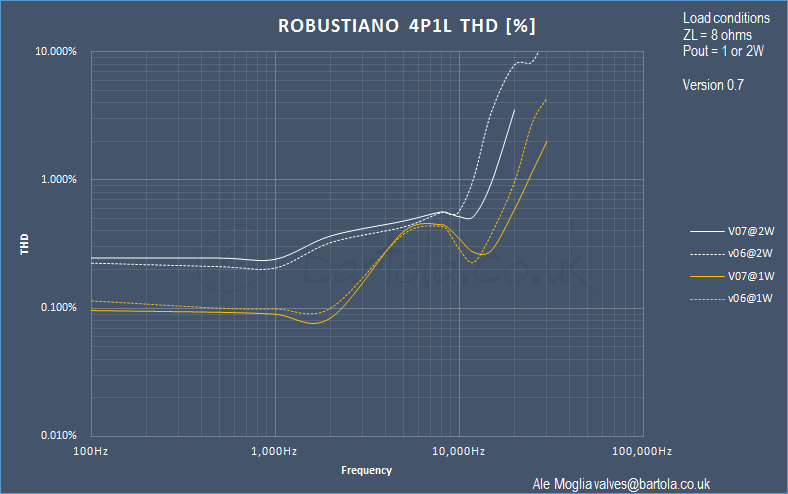

As Rod suggested, the circuit is very stable and easy to dial the right feedback with the potentiometer. The 4P1L is biased about -9V and is slightly under the max Pa in this case.

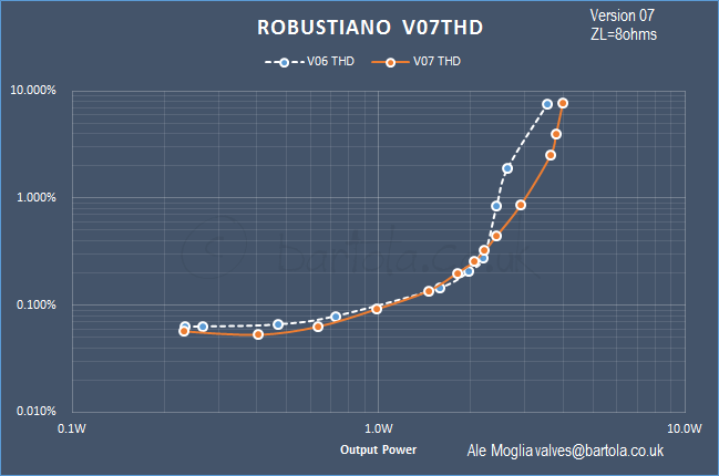

Distortion is as predicted in the simulation (e.g. 0.1% for 1W and about 0.2 - 0.25% for 2W). Just above 2.2W distortion creeps up rapidly given grid current, which is not modelled properly by the 4P1L pentode model:
Looking at distortion versus frequency, it's interesting to compare the BJT performance against the depletion FET. With lower Cob compared to the Coss of the FET, the BJT should be able to drive better the 4P1L. In fact, the BJT is more linear when swinging many volts compared to the depletion FET, so the proof is in the pudding:
The BJT is indeed more linear but if we compare the THD vs frequency of both drivers when providing 2W output power, we can see that the BJT is suffering as much (and even more given poorer slew rate) than the FET at frequencies above 12kHz. Also FET's THD versus frequency is more linear up to 10kHz, whereas the BJT has a peak around 6kHz and a dip closer to 10-11kHz. Either way, the BJT outperforms the FET in overall THD up to 11kHz.

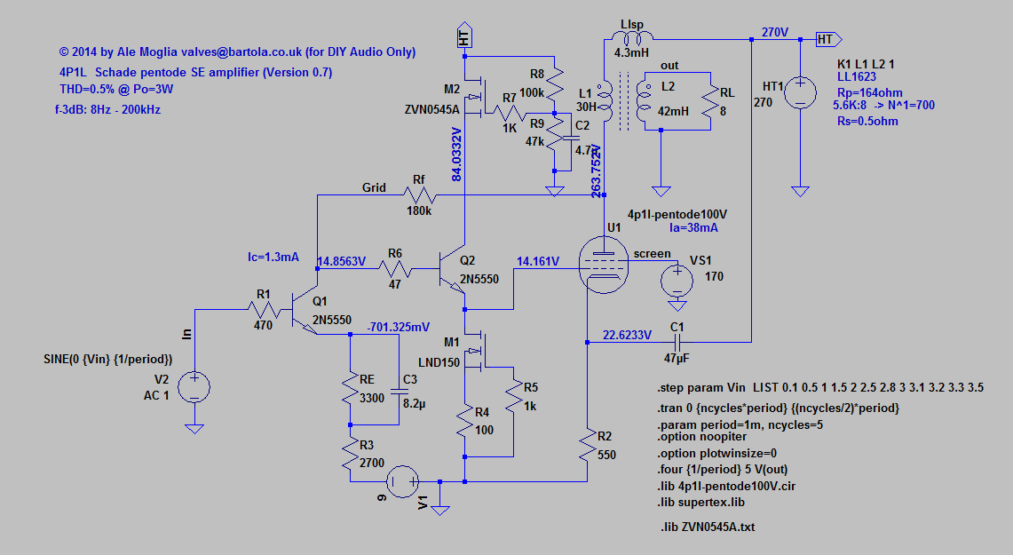

Hi Ale,
Splendid, it's coming along.
If the grid is drawing current, altering the resistors and Ic is unlikely to overcome the load problems faced by the driver. So a follower stage will work better, and may allow a little positive grid excursion, and a little more output power.
MPSA42 is again used, for low input capacitance this time: 40pF or less. A ZVN0545 MOS FET may work well too.
Beware though - may need to limit the grid current with a stopper, to avoid breaking the follower MPSA42.
Here's an example.
C4 is added to show that it can withstand high capacitive loads without failing.
The follower must be supplied with 70-100V to avoid breaching the Safe Operating Area of an MPSA42. A resistor divider + FET follower is easiest.
An MJ350 for the follower could be used, but that will probably load the driver too much with capacitance or base current.

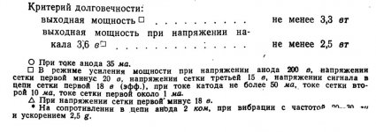

Interestingly, the 4P1L data gives an operating regime with 3.3W output, judges as the minimum available power after rated lifetime of 1000 hours :
Regime:
Va= 200V; Vg3 = 15V; Vg1 = -20V [Vg2 not given]
Ik = 50mA max; Ig2 = 10mA; Ig1 = about 1mA
Could easily set Vg2 to satisfy the 10mA condition.
The data also gives a "Maximum oscillatory Power, at wavelength of 10m" as "about 4,5W".
With these is mind, we should probably aim for more power from Señor Robustiano!
To achieve it will require some more changes, though:
- higher voltage supply for 2nd grid, with sharp cut-off current limiter;
- replace cathode resistor with stabilised negative bias regime.
These can easily be added later, if the current design shows some definite promise of sound-quality.

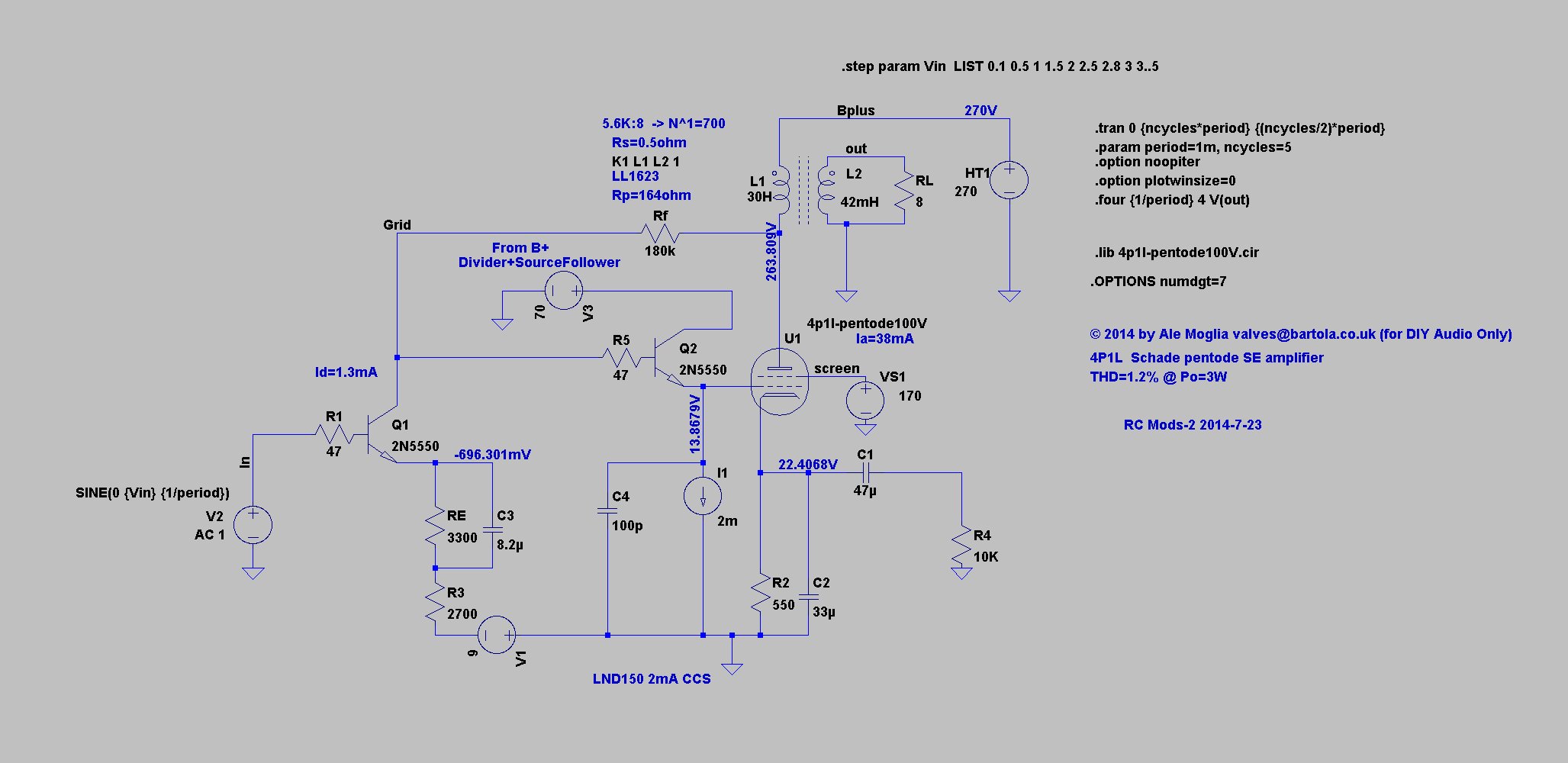

Brilliant ideas Rod! I will try the attached, thoughts?
Do you think a 100ohm stopper should be added to the 4P1L grid?
I think I should dial the feedback to get a more triode-like harmonic profile...
Interesting findings about the 4P1L's operating point. I wasn't aware of your Russian language skills 🙂
I could try lowering the anode voltage and readjusting the feedback network. The screen bias should be a follower with current limiter using a BJT?

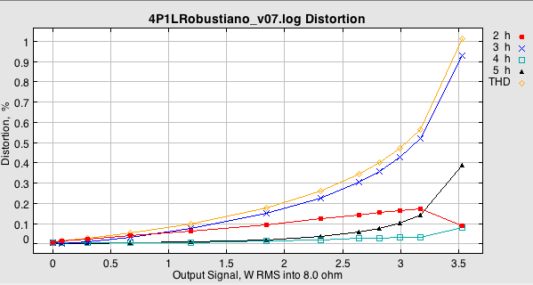

Ale, is it possible setting where 3H is not so strongly pronounced in the entire power range?
I'm not sure that is so extremely dominant 3H meet auditory tastes.
Hi Rajko,
Absolutely and thanks for raising the point. I meant as well this on my post above.
By dialling the Rf you can get the H2 closer to H3 levels. Of course when grid current kicks in near A2 you will get H3 and H5 raising exponentially.
I think in practice it may be easier to make R3 (non-degenerated Re) variable (i.e. trimpot) and also adjustable the negative supply so you can tweak the feedback level whilst running an FFT.
Ale, the circuit looks good.
LND150 needs to give near to 2mA to give best performance, please take care.
Yes, 100R stopper will do for starters... I'll do a screen circuit when I get a minute.

Hacked a simple PCB to build the follower to drive the 4P1L as suggested by Rod. I had to play with the LND150 setting resistor (R4) to achieve the 2mA of idle current. I ended up biasing the 4P1L rather hot at about 11.5W which exceeds the specs. The Q2 VBE was not possible to measure as the Q2 would oscillate I guess when I place the tester lead on Q1 collector and the voltage seems to drop when I try to measure it. Should have added a ferrite bead:
When measuring distortion against frequency, I was surprised to see that the follower provided some impact in reducing the HF distortion. For example at 20kHz, THD reduced from 0.96% to 0.59% @1W output power and from 7.84% to 3.52%:
What is nice to see now is the effect of the follower providing sufficient source current to the 4P1L grid. Above 2.5W, the grid current kicks in and we can see how "Robustiano" can deliver 3W at less than 1% until starts to clip about 3.5W:
I found that if I were to reduce the Rf further and therefore increasing the collector current but obviously exceeding the 4P1L power dissipation too much as collector current was about 45-48mA, the distortion at 20kHz falls significantly. I suspect I should increase the collector current to enable better drive of Q2 due to its Cib (30pF). To keep the current feedback arrangement this could be done by reducing the negative emitter voltage source (V1). Should try this I guess...
